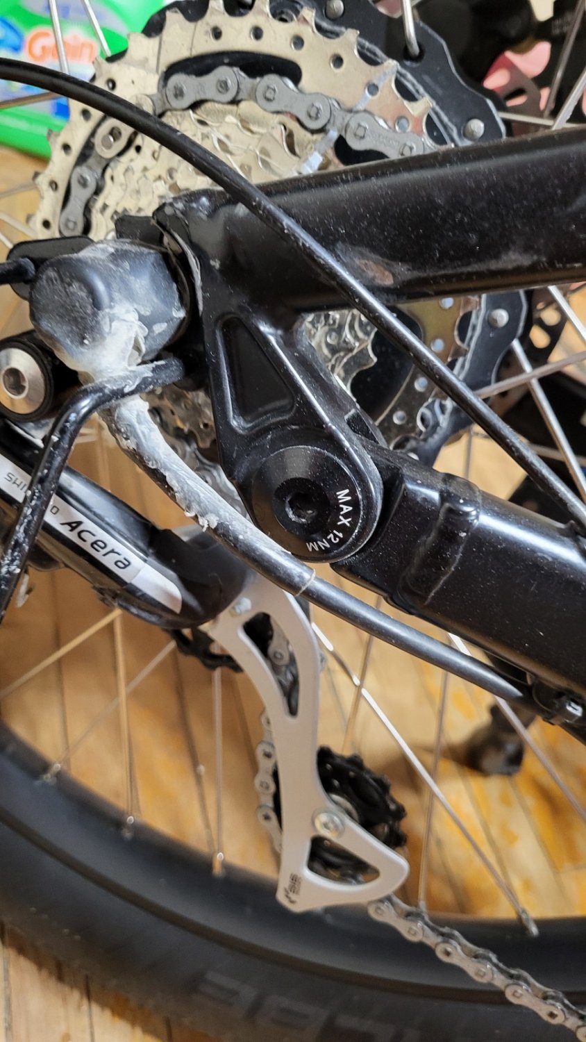

And my speed sensor is almost fully installed.
Just gotta connect the cable,..
I also managed to NOT Try to use first gear during my test ride yesterday.
I'm pretty sure I'd have a Serious Problem if I tried to force the chain into first gear with the chain being too short?
My favorite brand of hub. Bulletproof, but if you need support, they are always there. They are local to you, so you can probably just stop by. 😁
The guy last week was in the shop that was building the wheels asking about how they are progressing when the owner of White Industries approached and spoke up, 'Yes those tandem hubs are ready'. He was there for a Vado update. The bike has given its owner lots of stories and connections. Since stopping riding his bike he has gained some weight. Hence the extra strong rims and hubs. Having some assistance will get him out more. It is a handmade Ti bike by Tom Kellogg, who you mentioned that you knew. It has been sitting here without wheels for three months. The wheel builder took them home to lace in peace and quiet with total focus. The shop always has too much going on.

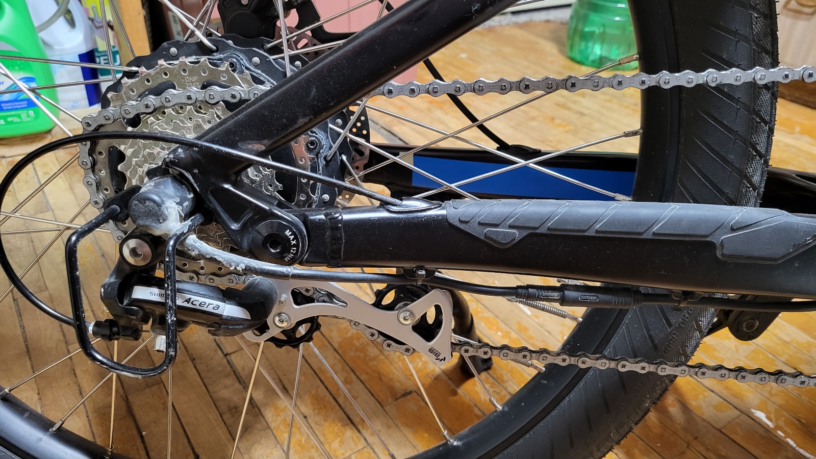

Ahh Crap !! The damn cable is too short !!
So I installed the sensor on the other side,..
Had to move the sensor and magnet further up the swingarm (or chainstay as you guys call it) to get them close enough together.
I'm still outta spec, but it is working,..
The whole thing looks like crap, and it looks Way Too percariously perched.
If I ever drop my chain, I'll probably take out the sensor?
I'm gunna try it, then probably extend the wire and swap it back to the other side.
What a PITA. 😁
I can at least move it to the other side and further up the swingarm without extending the wire, but I liked how the sensor was tucked away nicely beside the rotor.

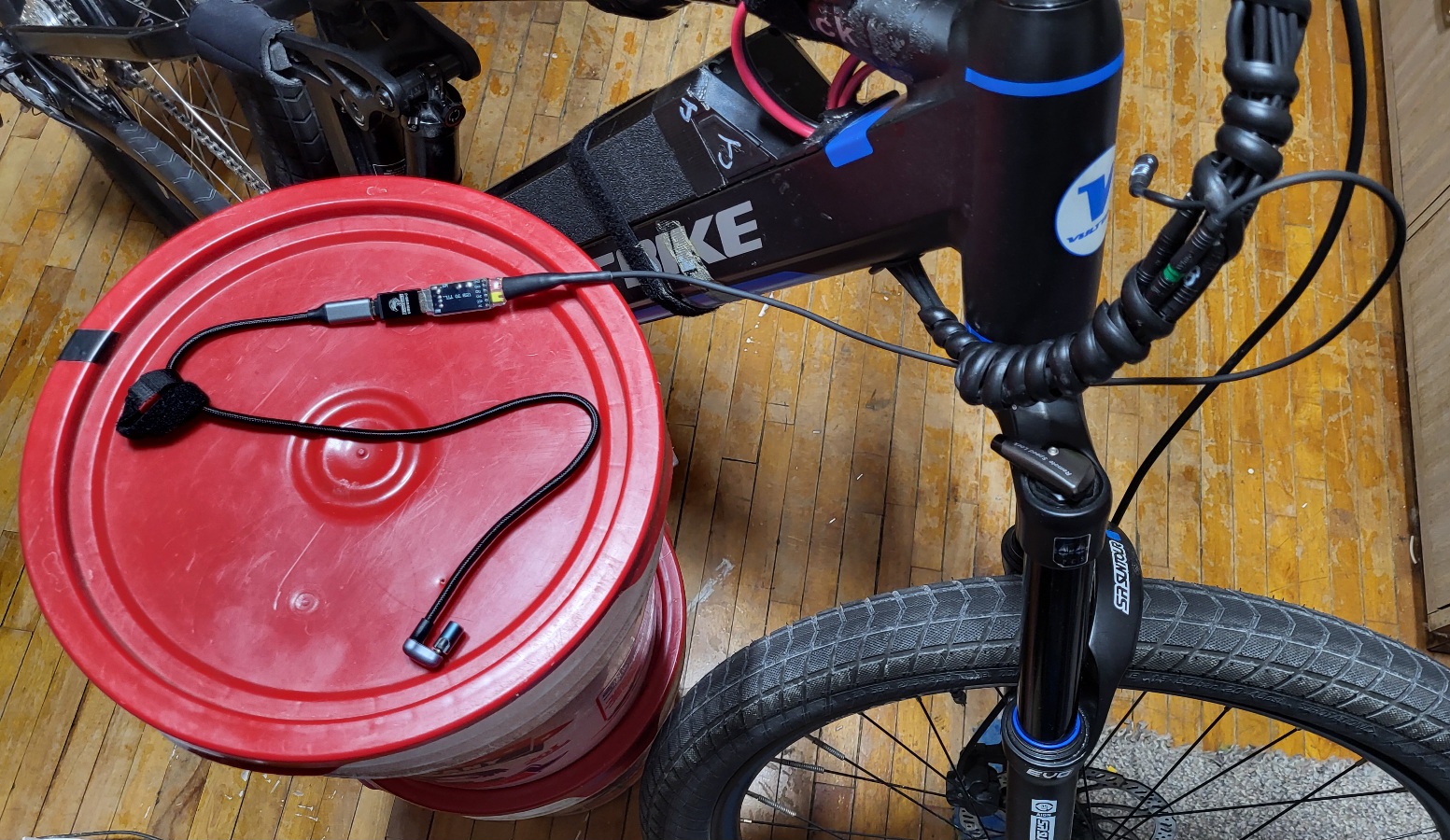

I bought a 5 pin Y-connector so I can use my display buttons with my programming cable connected.
I'm stuck in PAS 1 with just my programming cable connected.
Thanks @Gionnirocket for that idea.
I trimmed the rubber around the connector like you showed as well,..

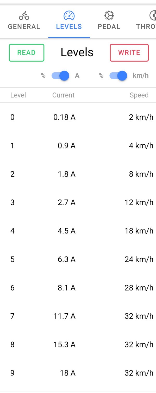

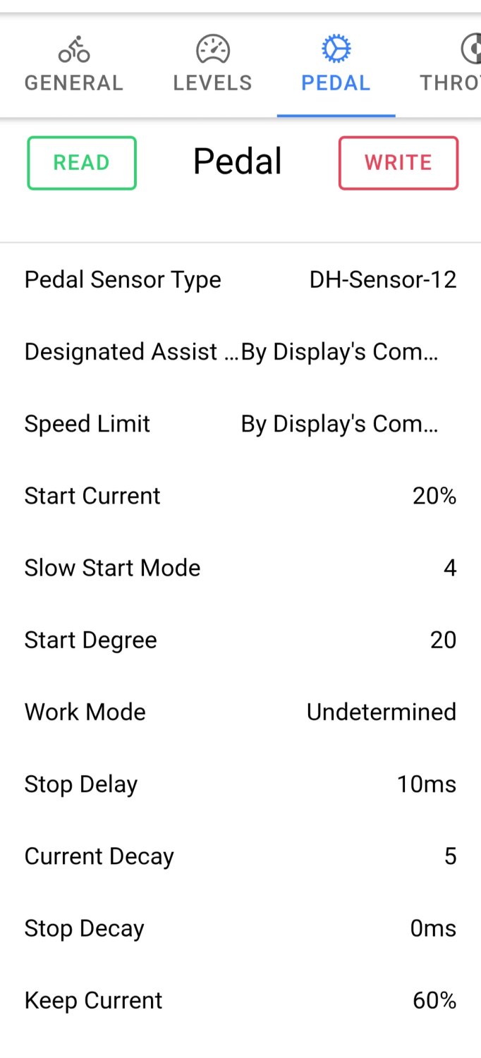

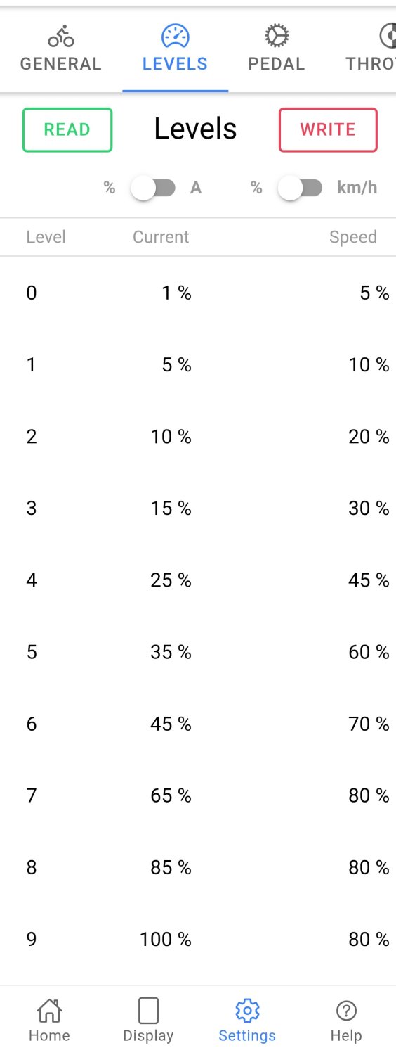

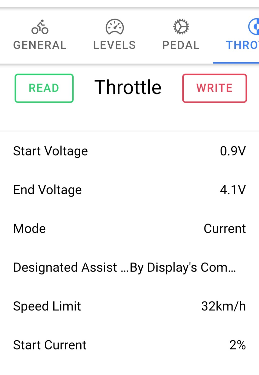

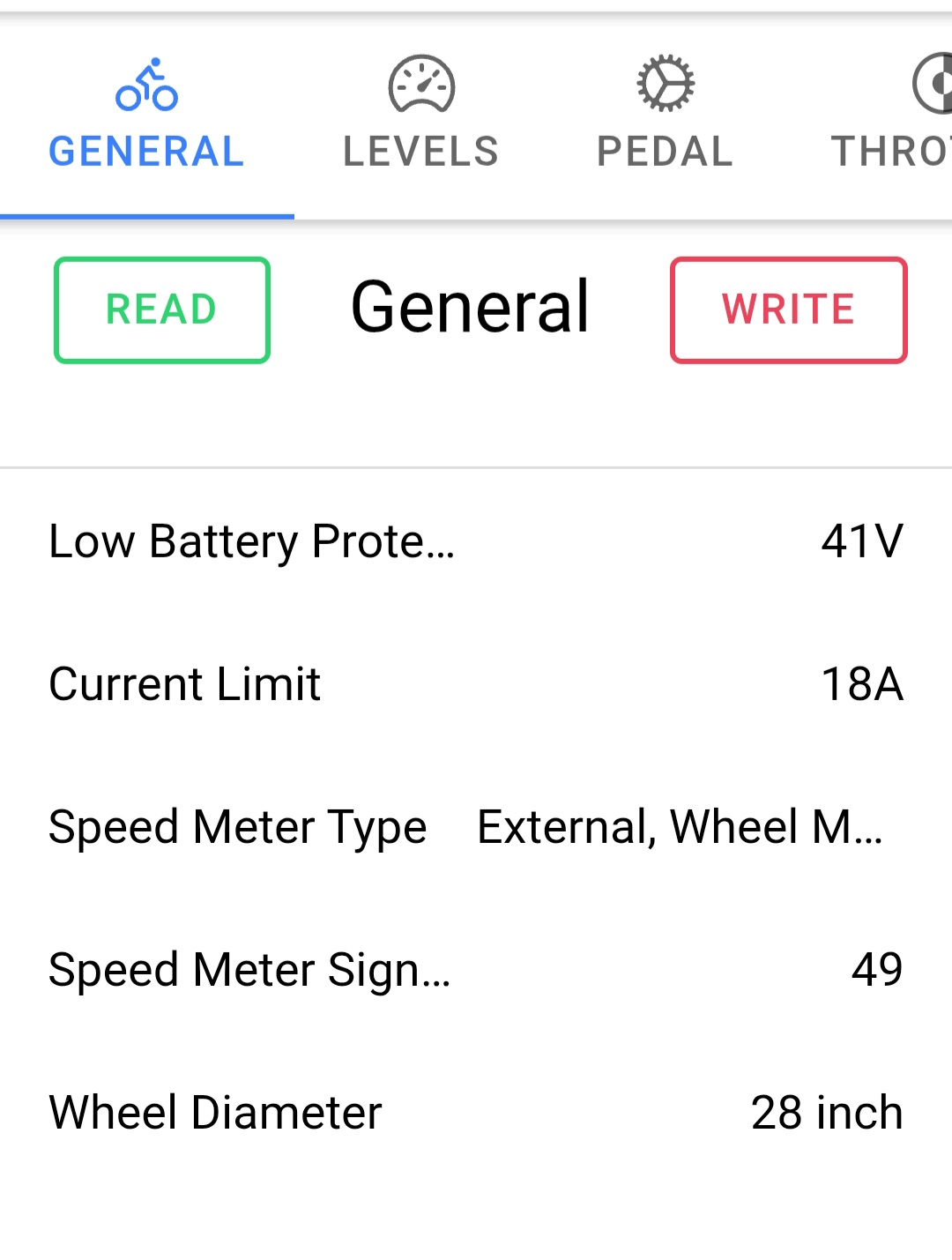

Another thought is to set the throttle to By Displays Command. This will give you 9 different maximum throttle outputs (matching PAS) and you can just hold it wide open instead of trying to vary rotation.
I ended up doing exactly that.
At first I thought it would be easier to just have 3 different maximum throttle outputs, and make 4-9 PAS settings at max,..
It worked but it struggled to hold a steady 32 kph and the power would surge from 1 amp to 18 amps to try and maintain a constant speed.
I would turn down the throttle a bit, and the next throttle setting appeared to be ~13.5 amps, and then 7 or 8 amps, so not as granular as I'd like.
So I redid my settings to what @Gionnirocket said but set all the maximum speeds (except the first few) to 32 kph.
That worked great.
The surging was limited to the PAS mode setting, and after the first couple of tries at maintaining the 32 kph speed setting, the controller wouldn't back the power off as much.
So I would just keep hitting the PAS up button until I got up to 32 kph.
Then if I started to slow down (more wind or whatever) I'd hit the up button again.
If it started surging again, I'd just hit the down button.
It was kinda windy, so the current draw was bouncing around between 3 and 18 amps, so I did need to use the PAS buttons a lot, but if the PAS setting was close to the amps needed at the time, then I couldn't feel and surging.
And the rest of my settings,..
