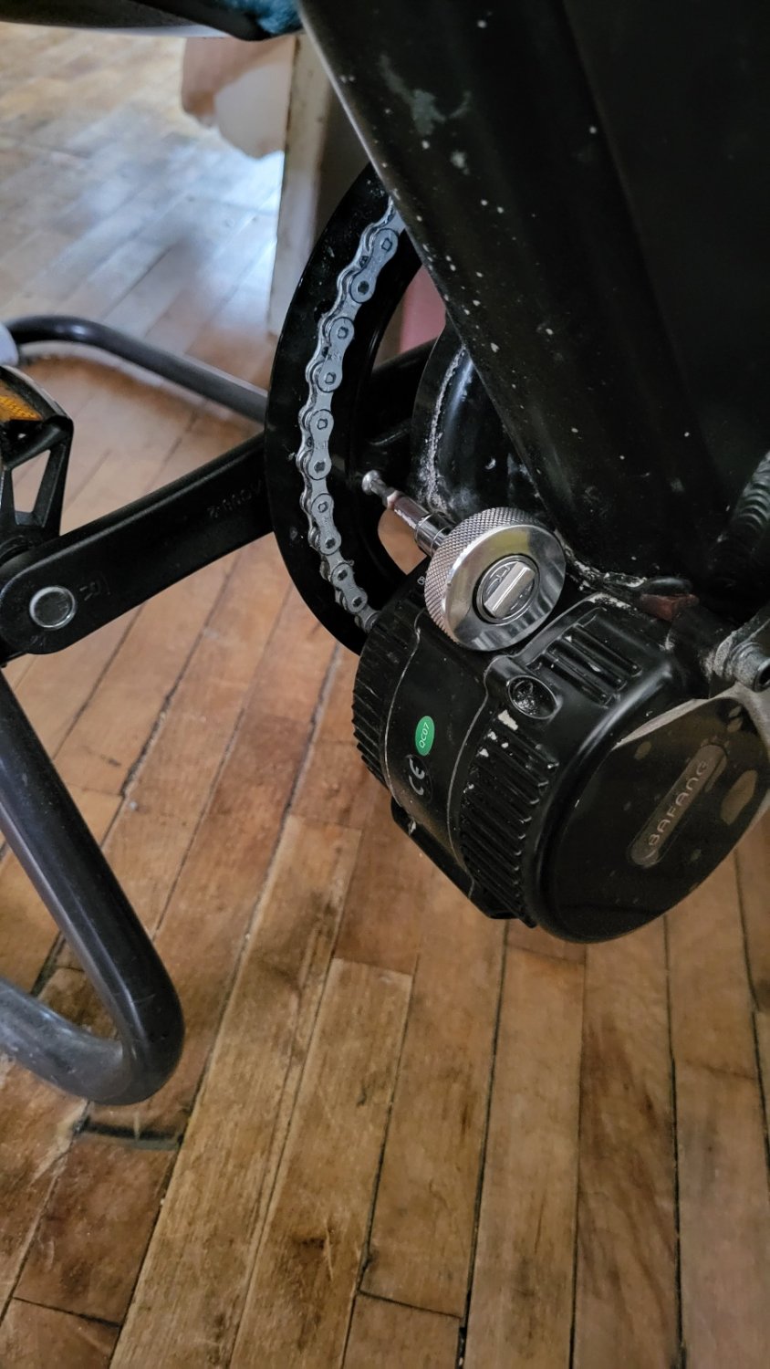

There's plenty of things to use as a chain guard, including an actual chain guard like @RunForTheHills posted,..
The issue for me is installing it.

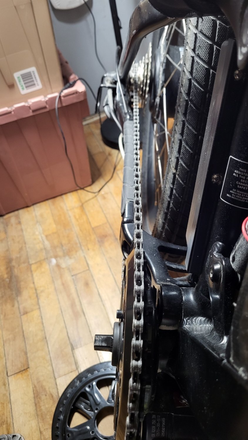

Do you have any experience installing a chain guard on a BBS02B and a full suspension frame?
How the hell am I supposed to mount sleeve loom or corrugated tubing?

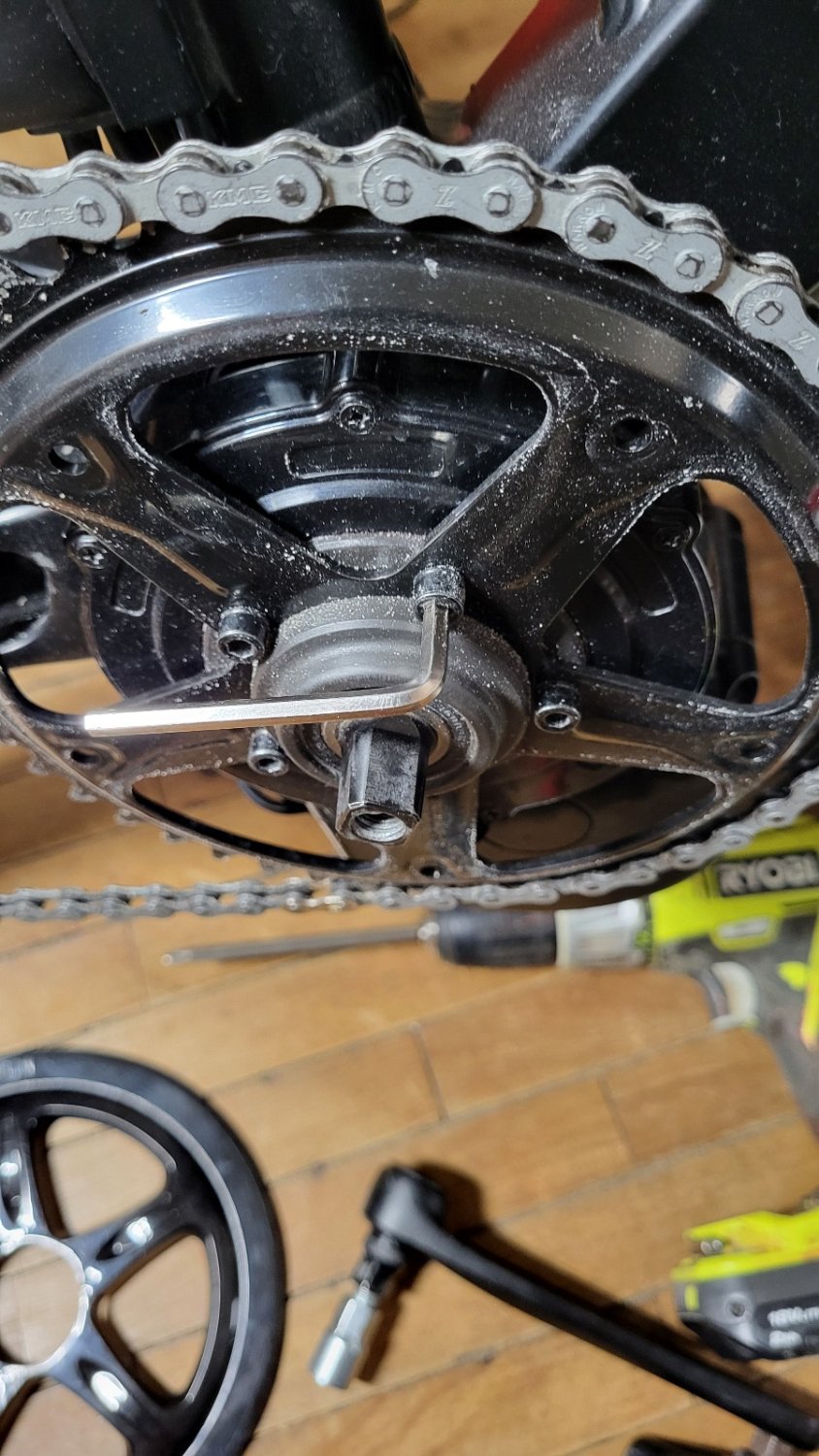

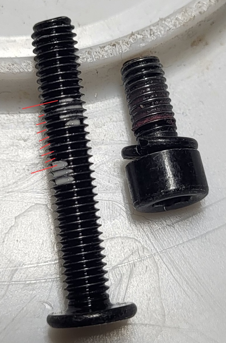

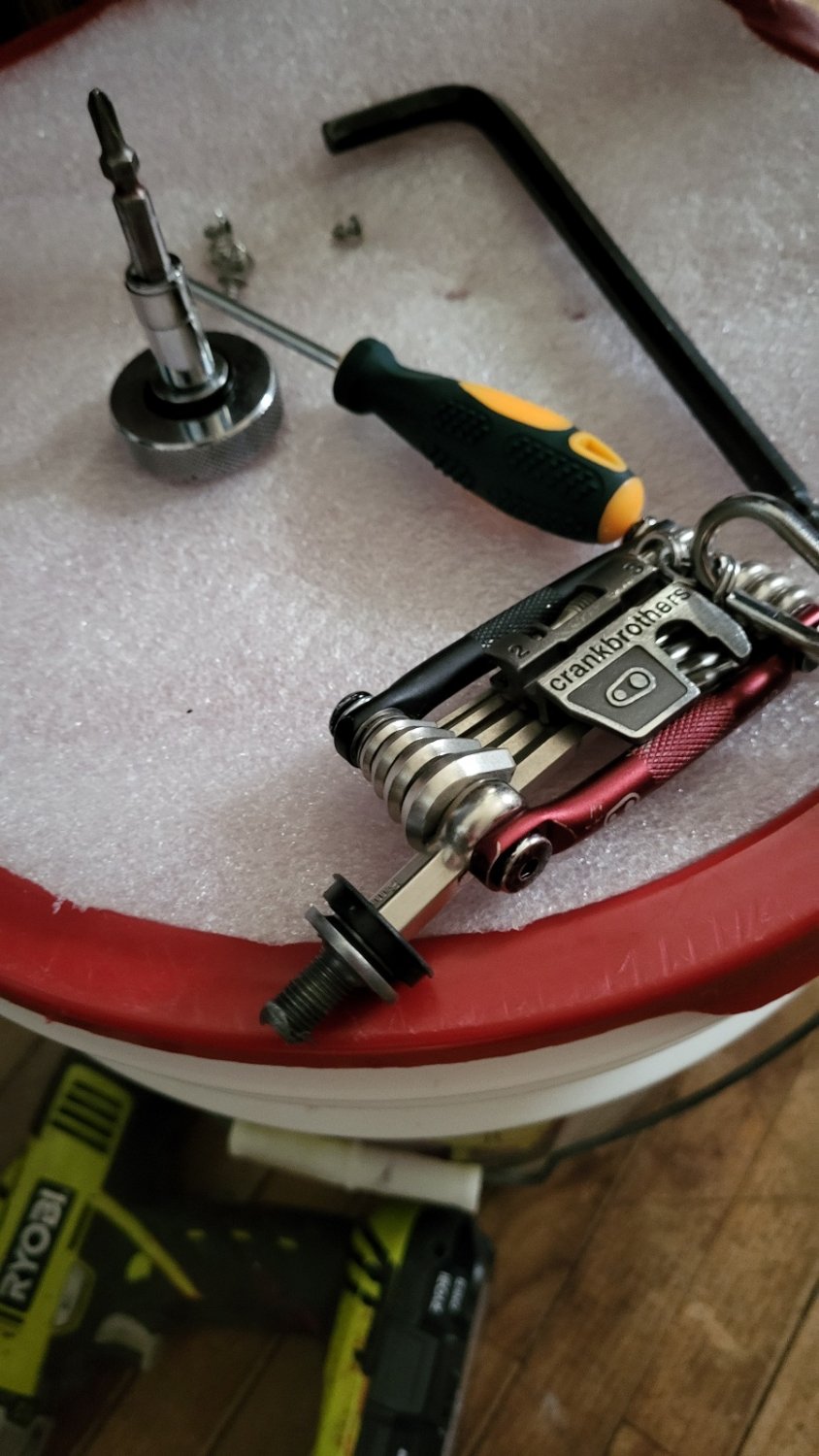

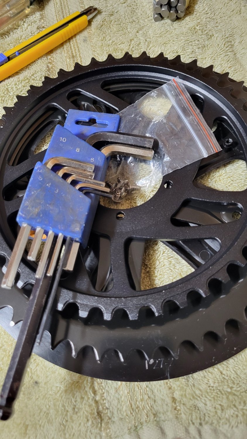

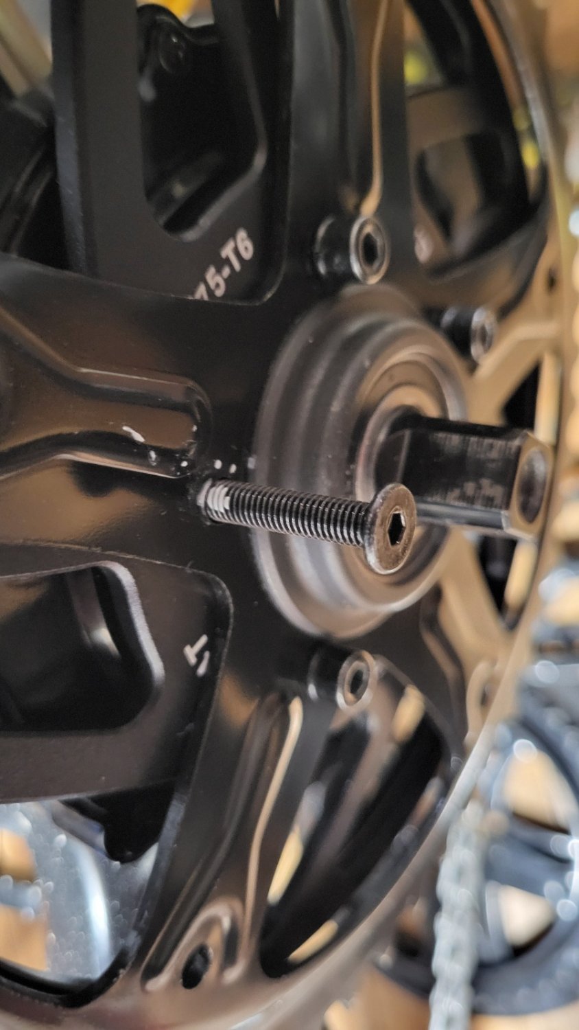

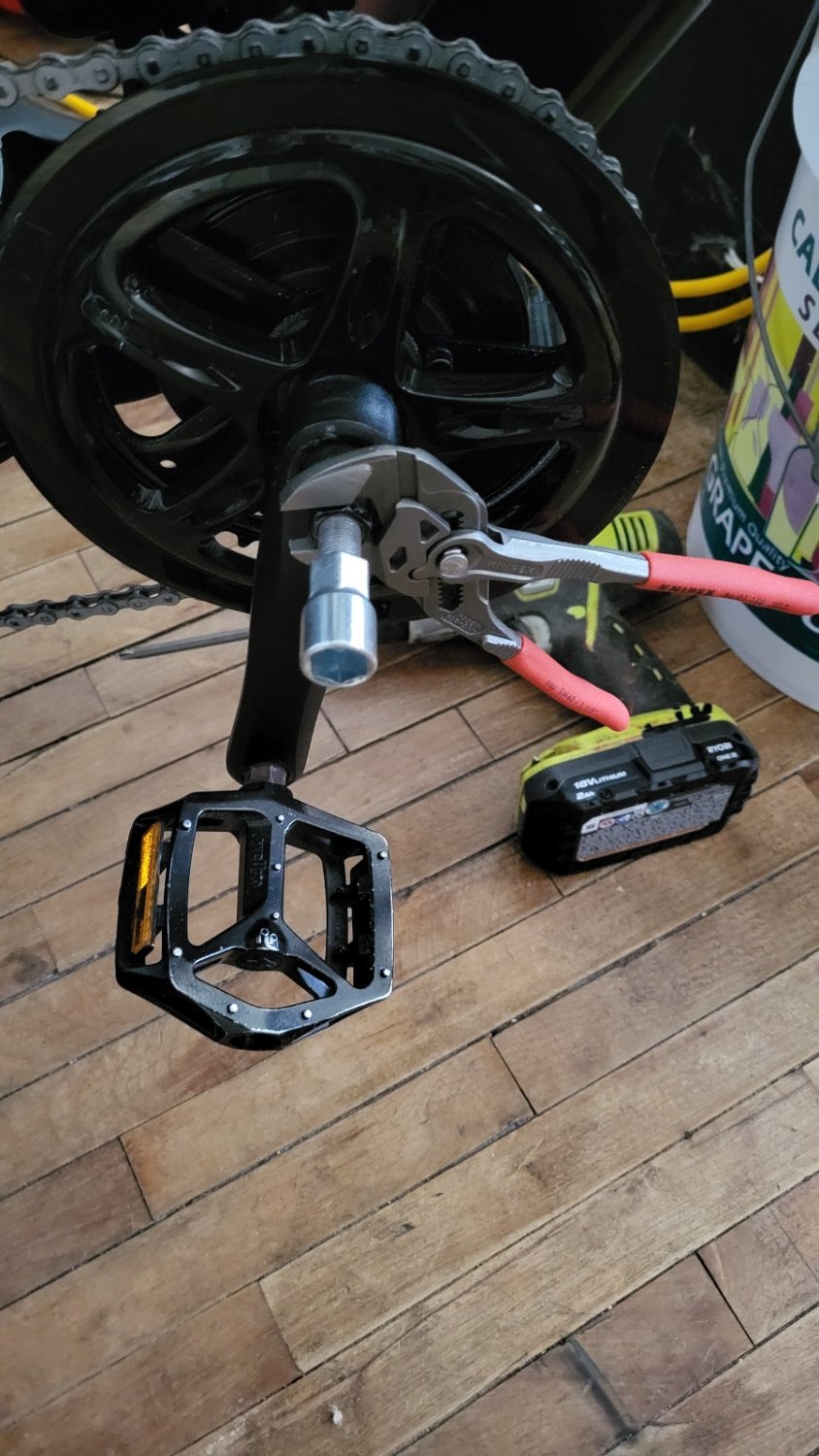

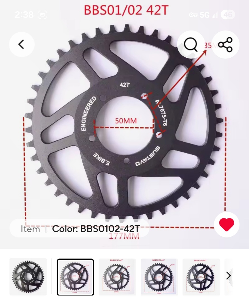

I bought some stuff today,..
I took some measurements of the hex bolts that came with my motor kit and bought grade 12.9 hardened steel 5 mm hex bolts, 16 mm long to mount my two chainrings on top of each other.
I thought it would be smart to buy washers and lock washers for the bolts as well.

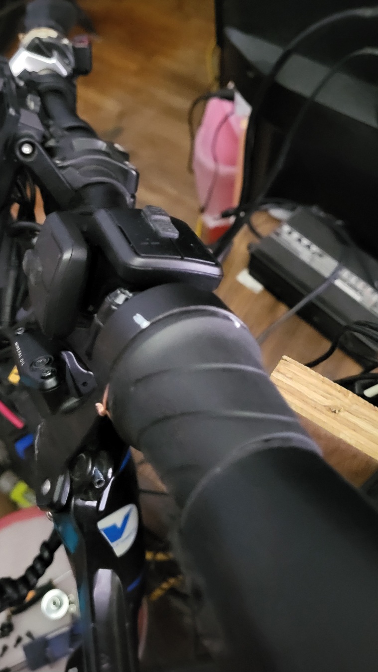

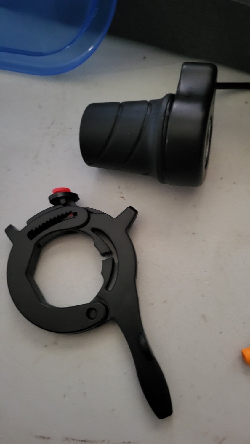

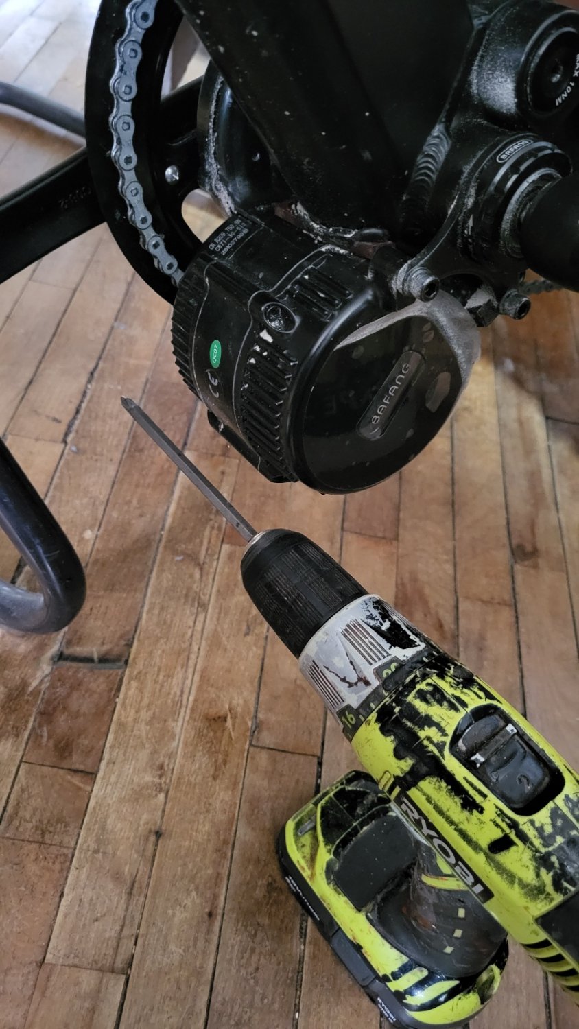

HOLY SHịT !!!

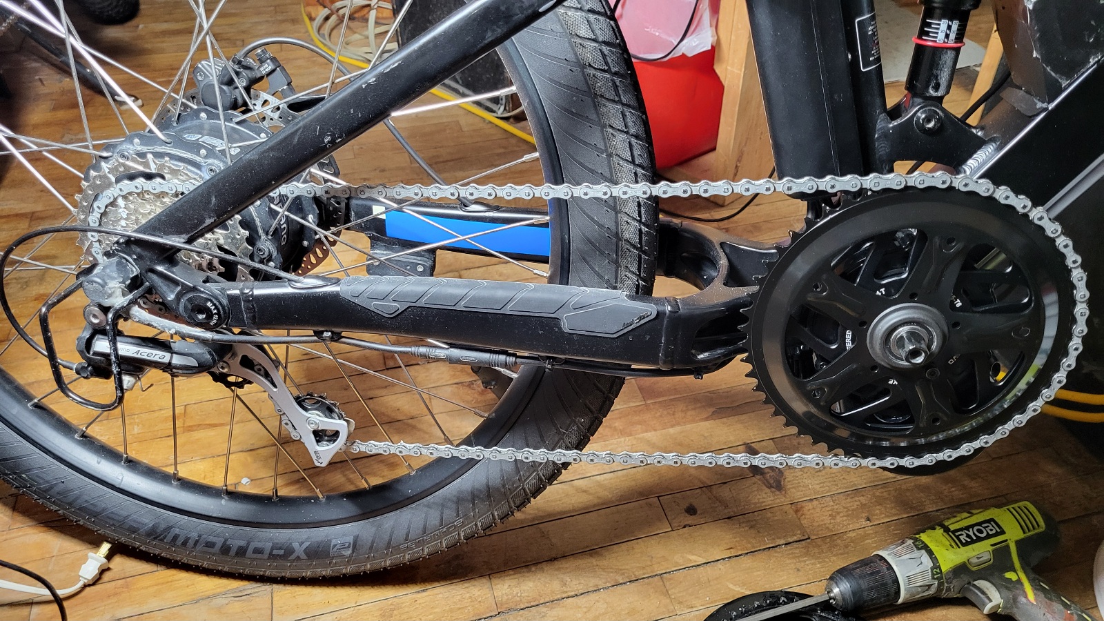

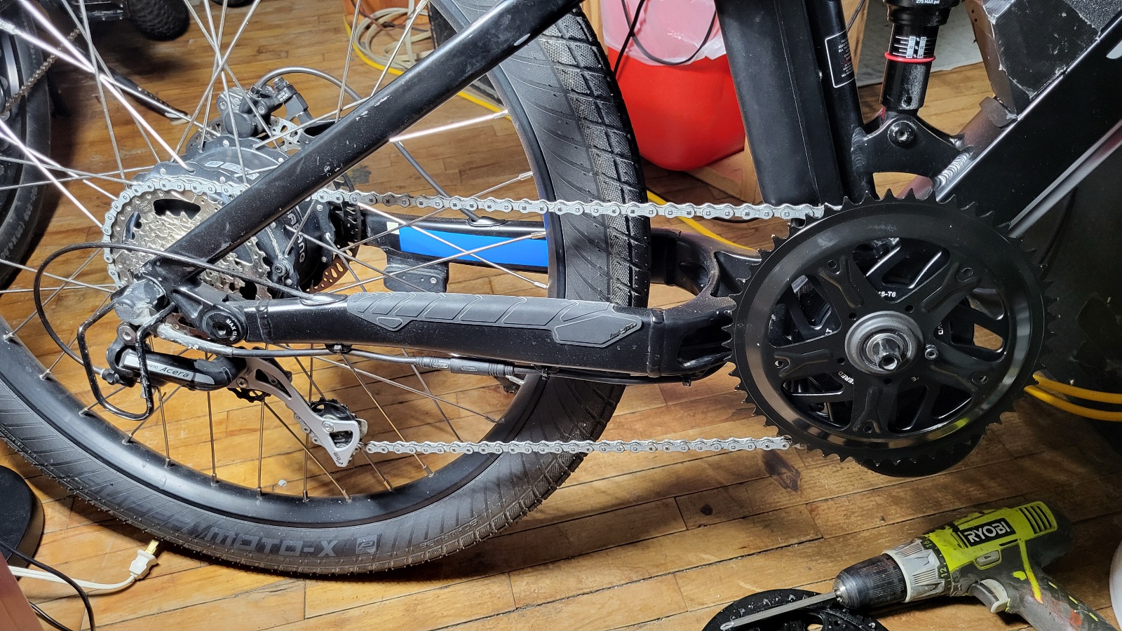

I had my display unplugged and my programming cable plugged in, getting ready to check my settings.

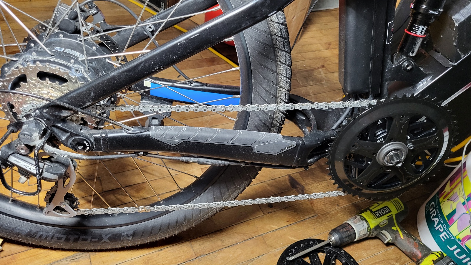

I realized that I hadn't checked to see if my 46t chain would work for first gear with my 52t chainring.
It was in 7th gear, so I leaned the bike over on the kickstand to get the wheel off the ground and started cranking the pedal to work the derailleur into low gear.
I can go up one gear at a time by pushing the shifter button then cranking the pedal.
(I can go in to high gear all at once with repeated presses)
As I was changing from 5th to to 4th gear, the Damn Mid-Drive Powered Up !!??
WTF !!???
The Fricken Display wasn't plugged in, and neither was my smartphone.
So to make sure that I'd remember the incident, I did it a few more times and stopped at 3rd gear, and unplugged both batteries.
Then I cranked the pedals again to make sure it was dead.

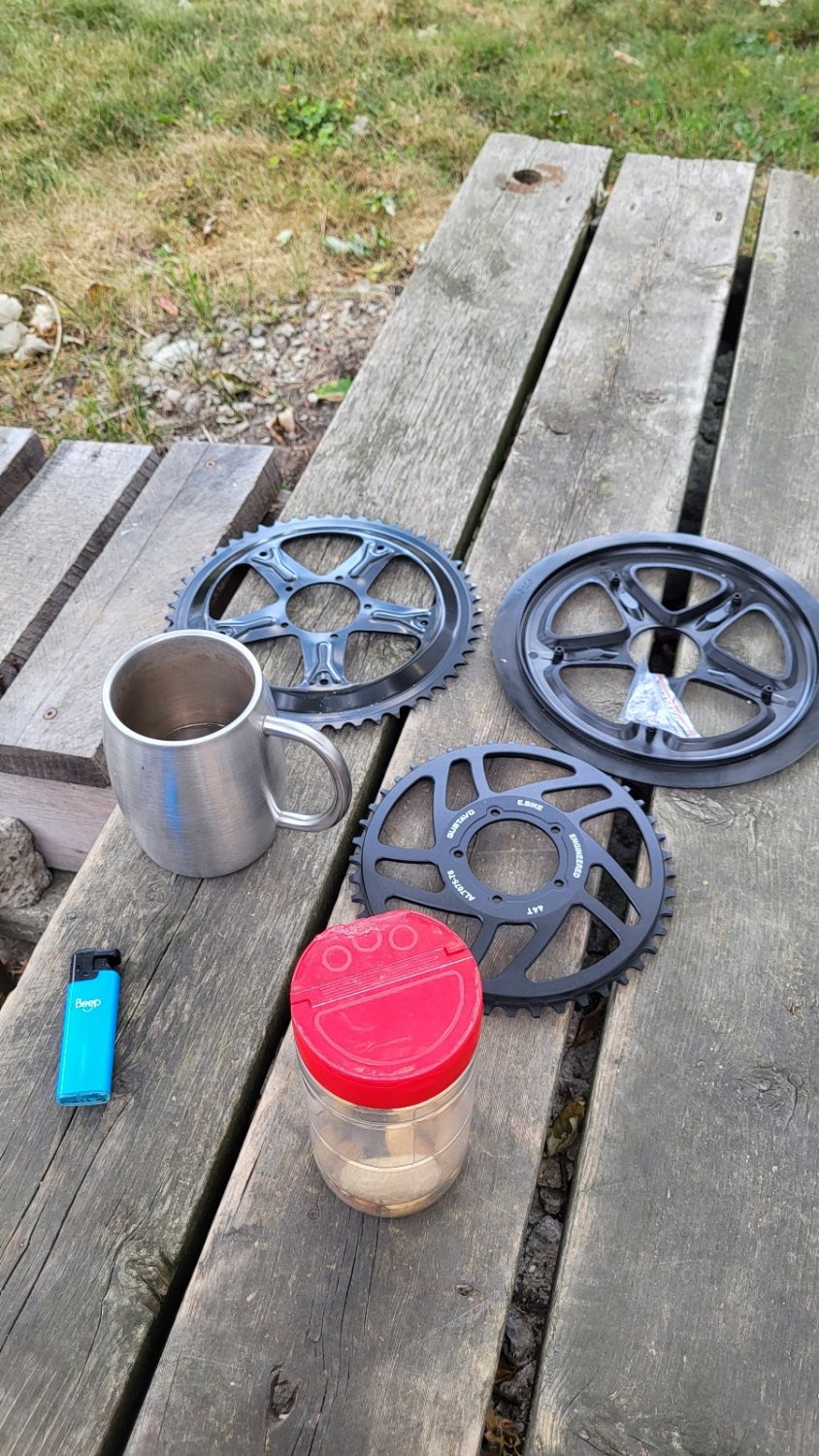

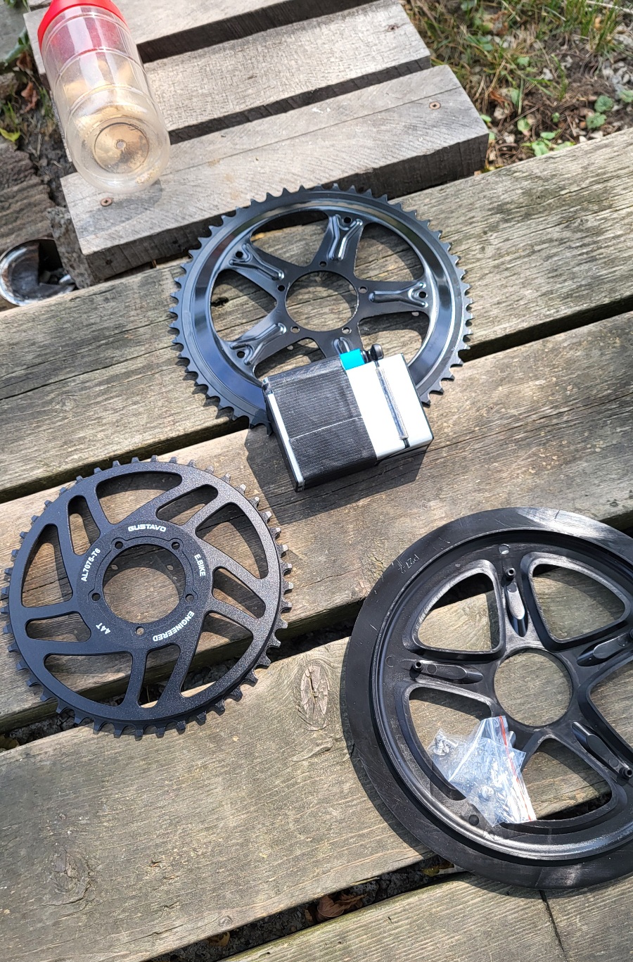

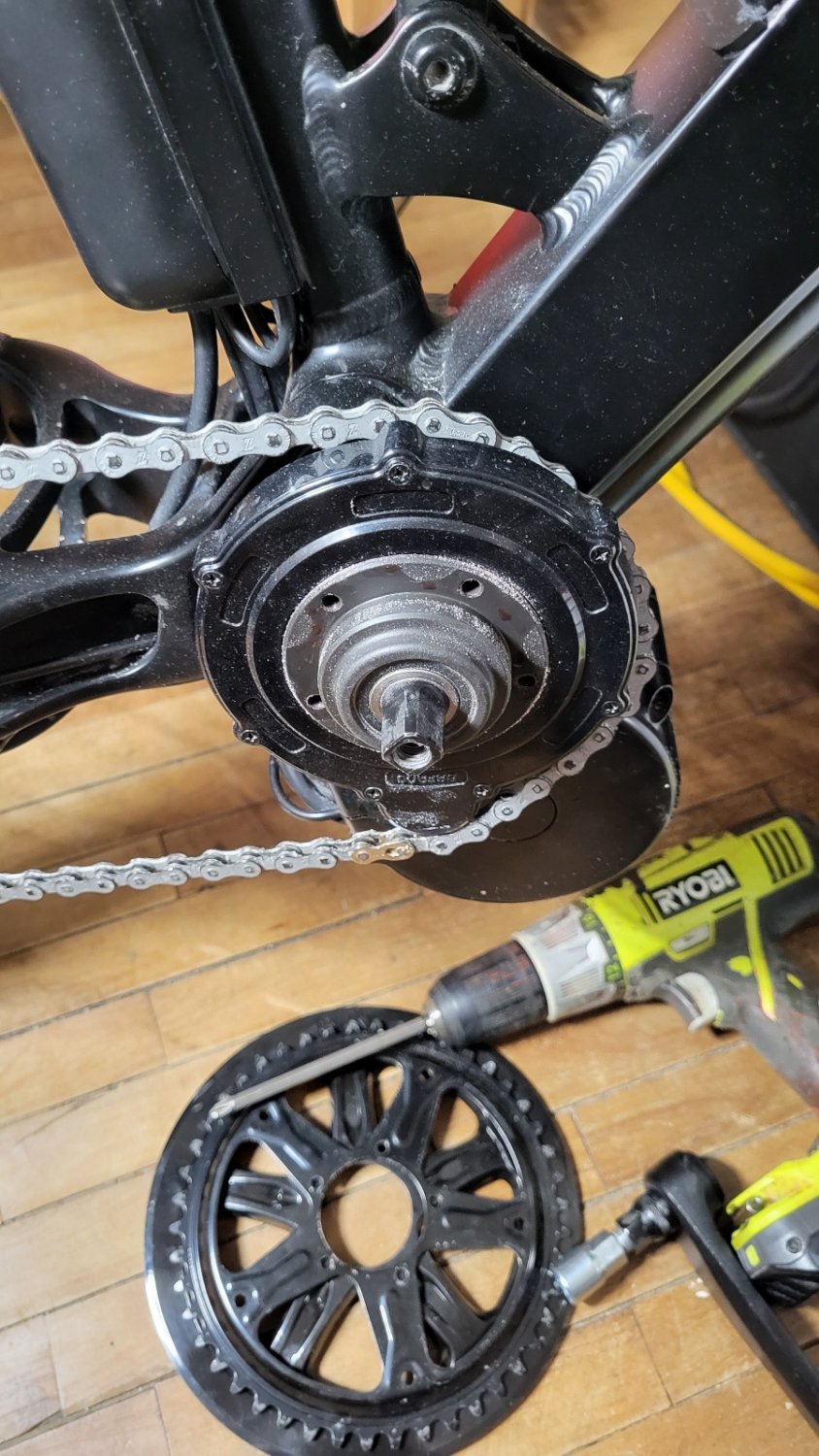

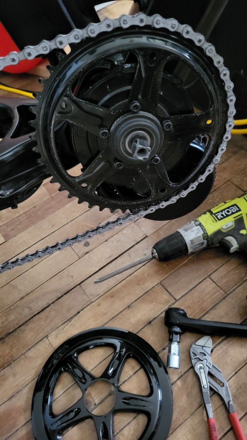

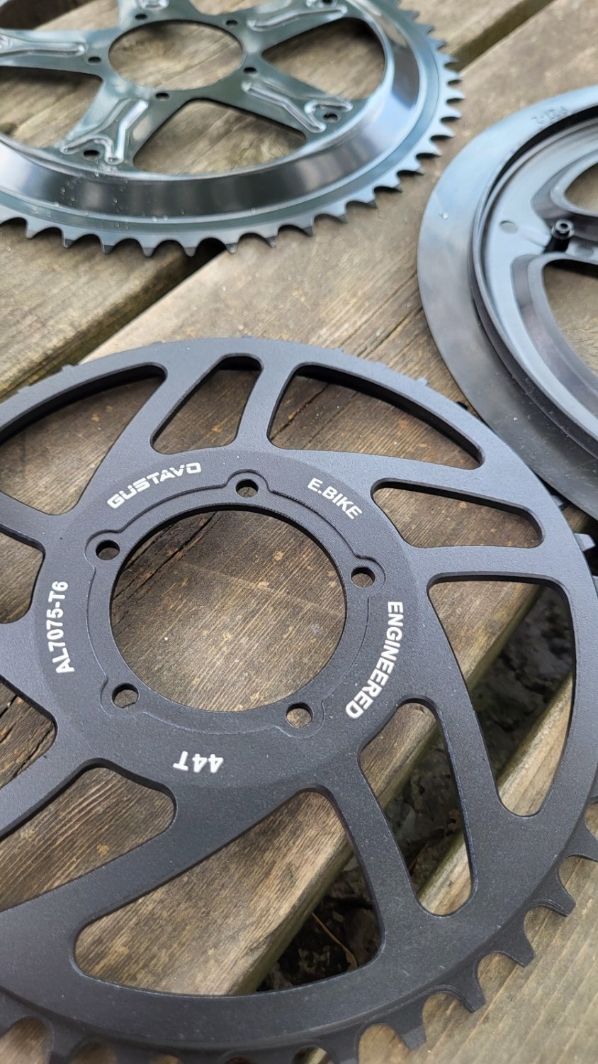

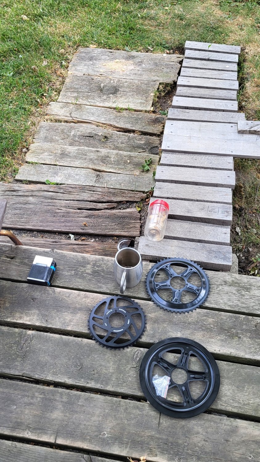

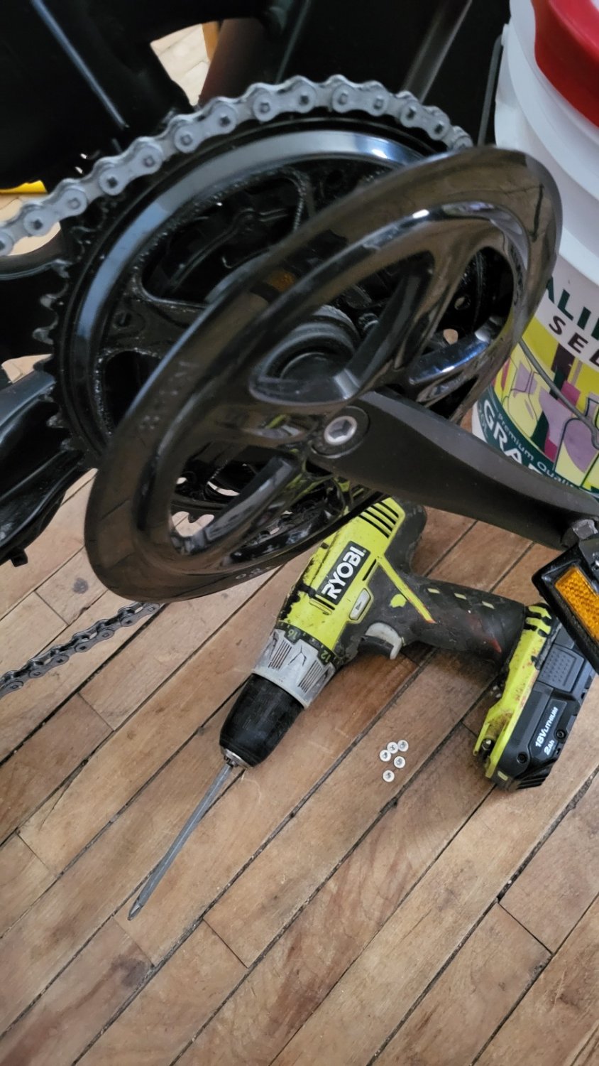

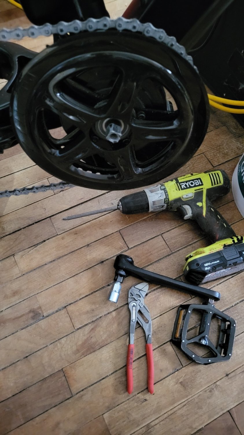

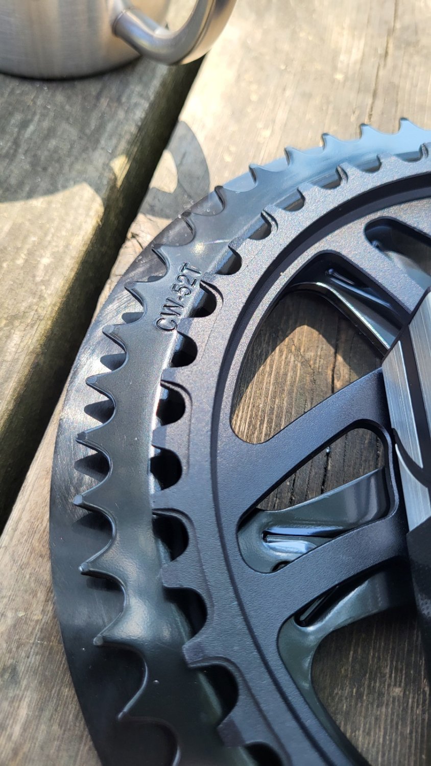

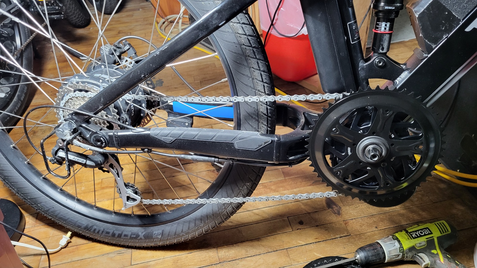

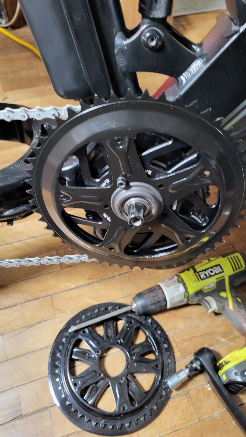

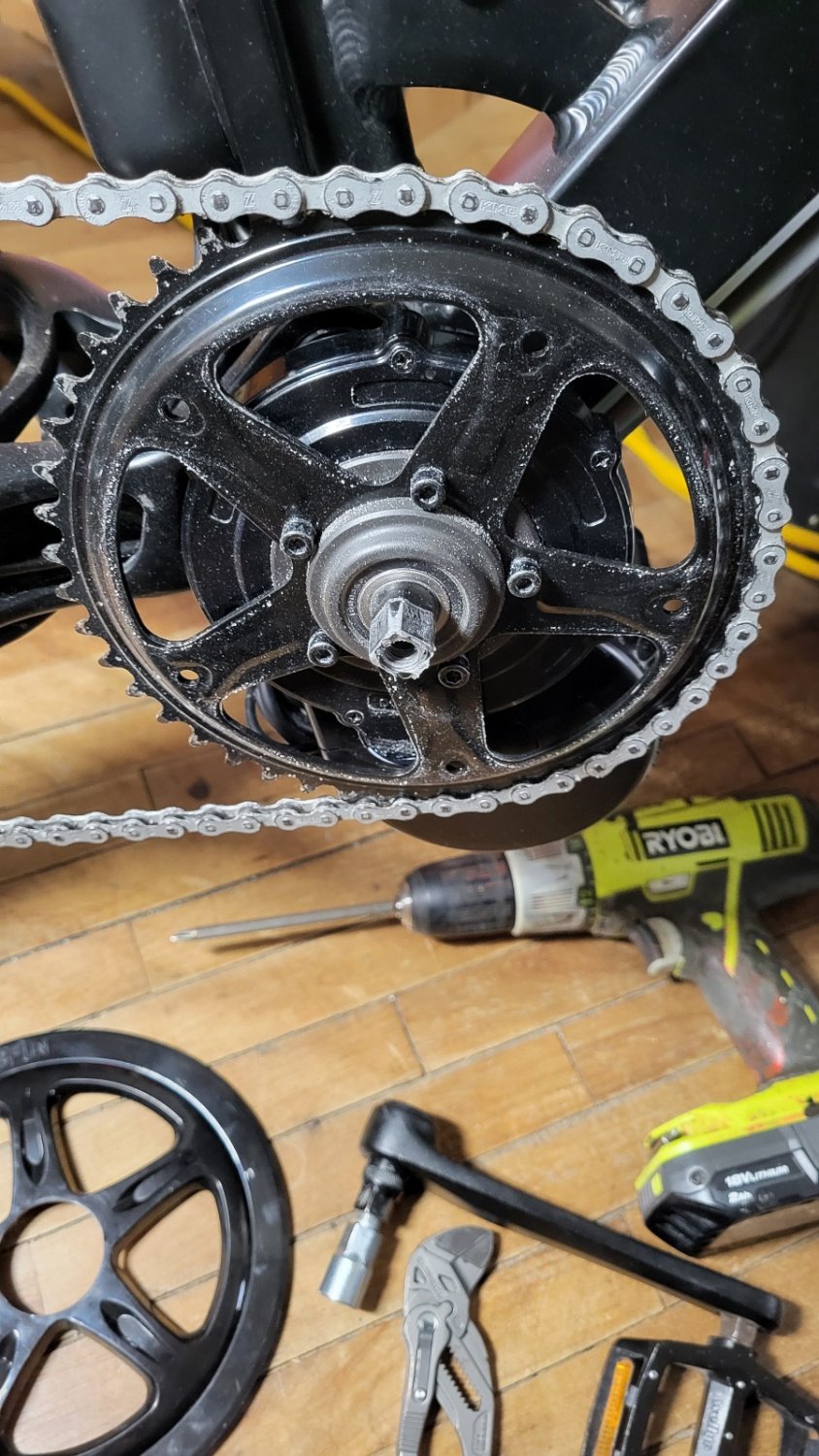

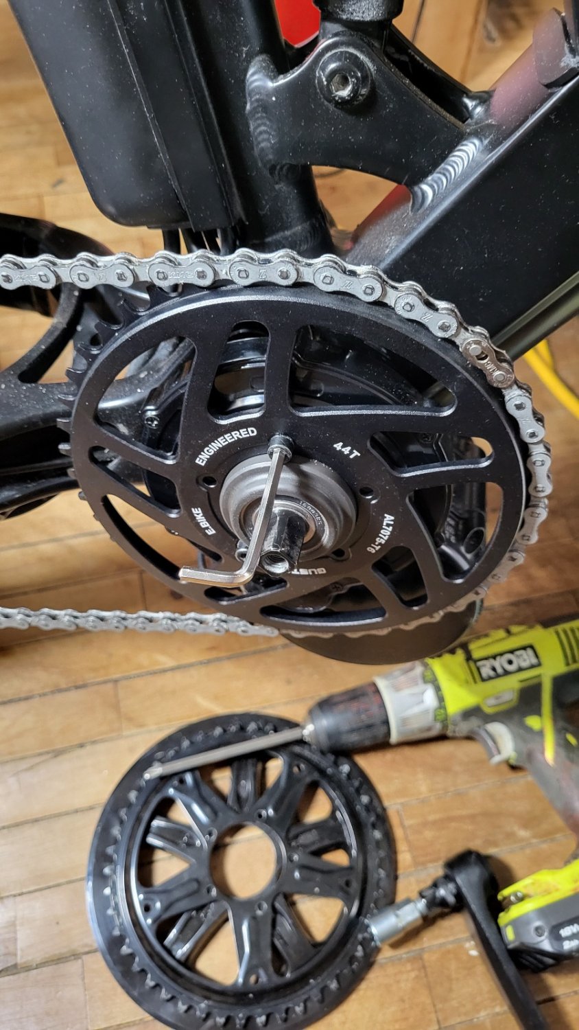

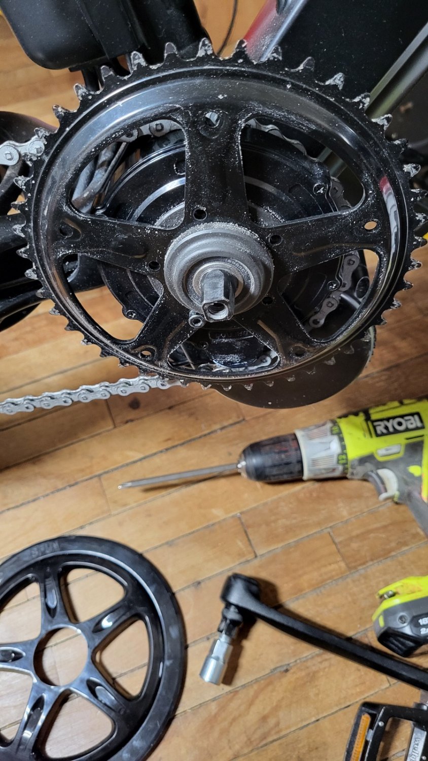

So my original 46t chain is not long enough to go into 1st gear,..
Second gear is fine though,..
So now I need to reinstall my 44t deep dish Bling 💍 to see if my original 46t chain is too long for 7th gear.

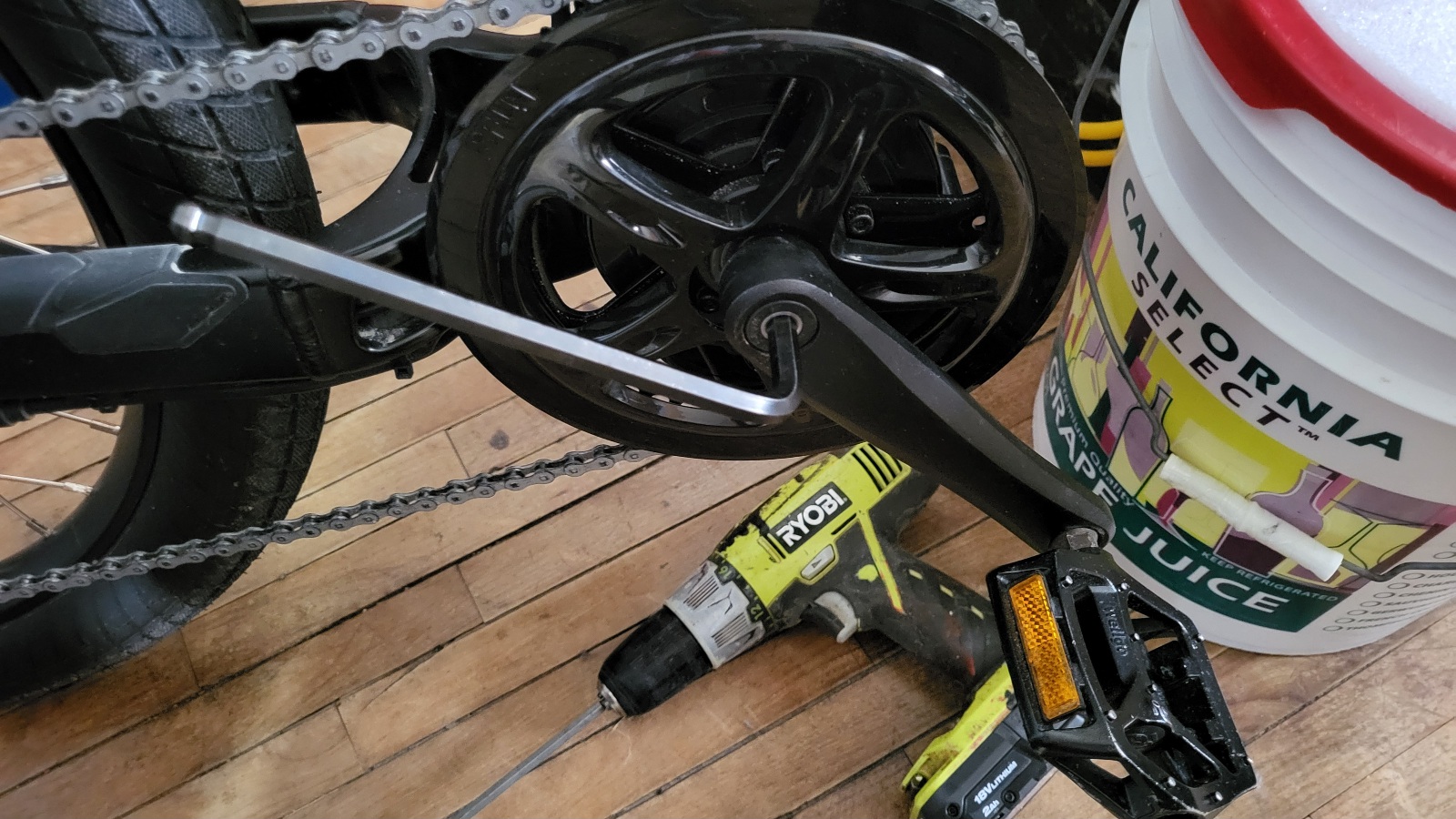

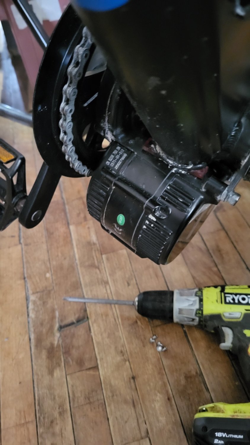

I'm gunna wait for my new bolts and washers to arrive, before I take it apart and break something again. 😁

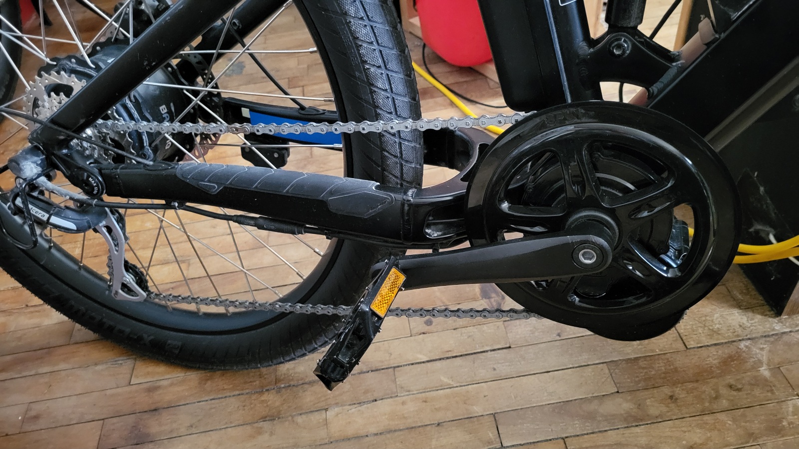

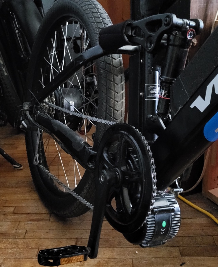

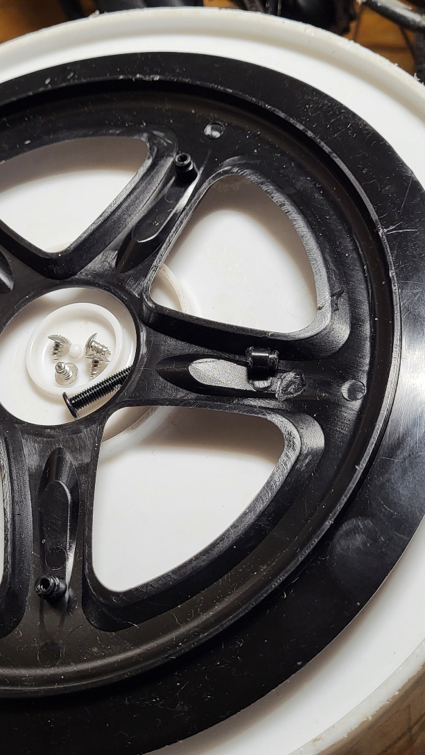

I took another look at my e-bike and it looks like that fender might fit my e-bike?
It looks like it mounts around the bottom bracket like a Big washer?
I might have enough clearance with my swingarm?
The bracket on the other end of the fender would need to be mounted creatively with a spring or something, because my swingarm moves.

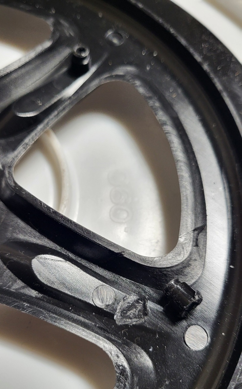

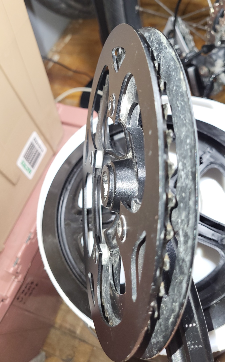

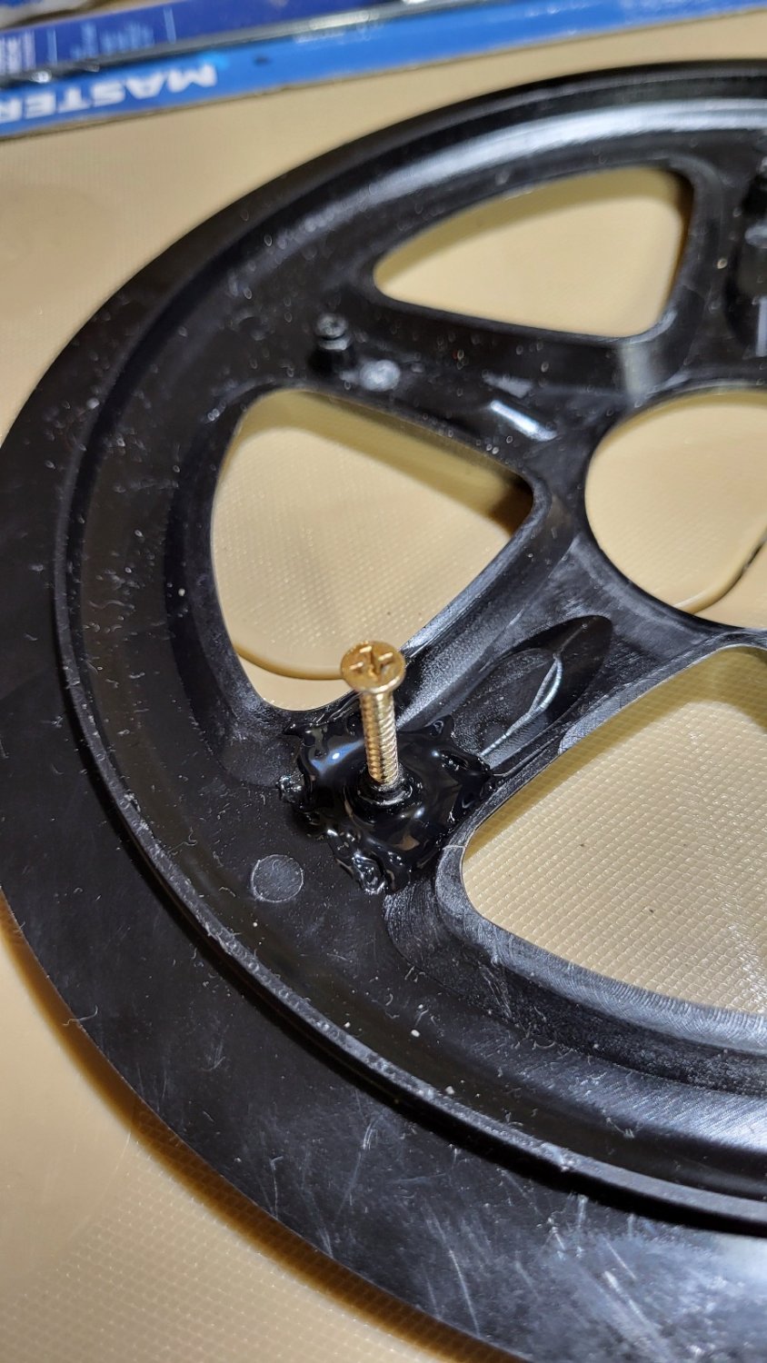

Meanwhile, the plastic chain guard is working, but it's a little warped now.
