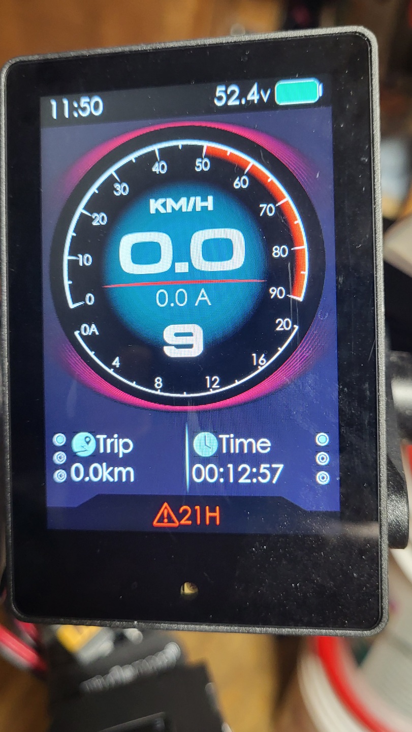

The throttle for the mid-drive is on the left and twists in the normal direction.
I was standing in front of my ebike looking at my voltmeter, twisting the throttle with my right hand.
Yeah, I was probing the wrong wires,.. 😁

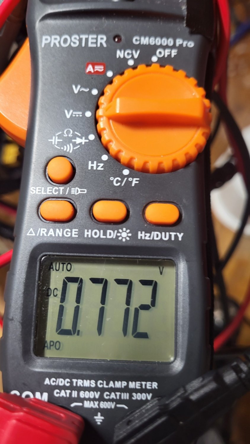

So,.. Here's the redo.
Power on, no throttle,..
Motor turns on,..

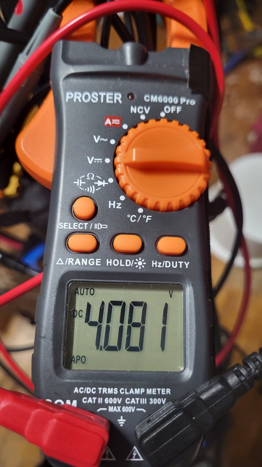

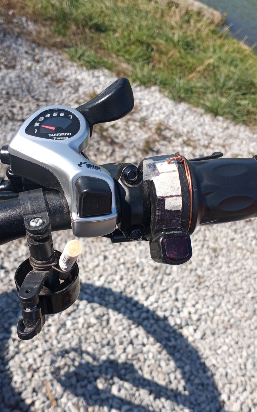

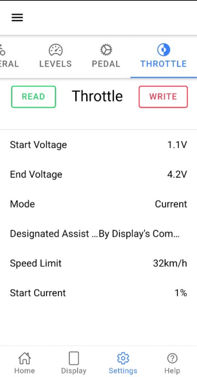

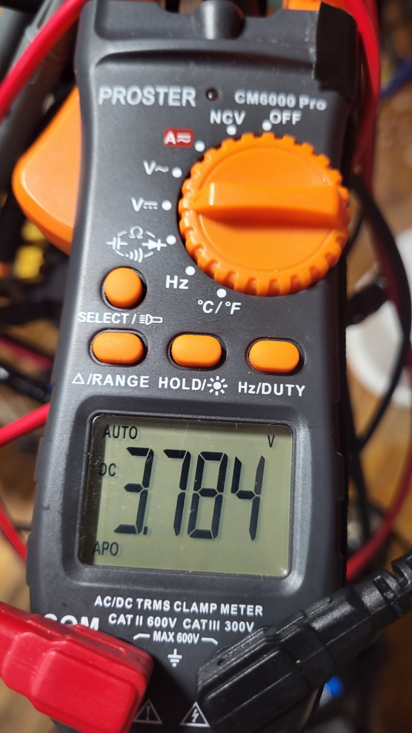

Then the throttle voltage gradually increased to this, using Way more throttle rotation than my hub-drive throttles.
That 0.820 V throttle output at startup would throw a code, and shutdown the throttle with my KT controller (and I think all hub motors and throttles?).
The voltage needs to be above ~1.1 V
You should be able to set Start Voltage at 0.9...
If that throws an error... 1.0v should definitely work.
End V should be 4.1
This will give you a little more working rotation range and have it start sooner.

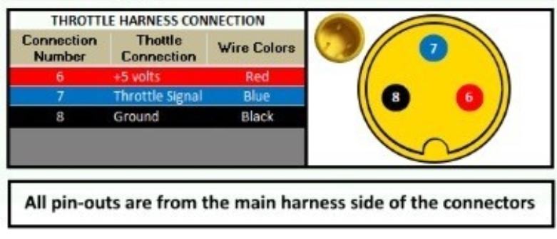

Where do you have the test leads connected to?
This thing,.. 😁

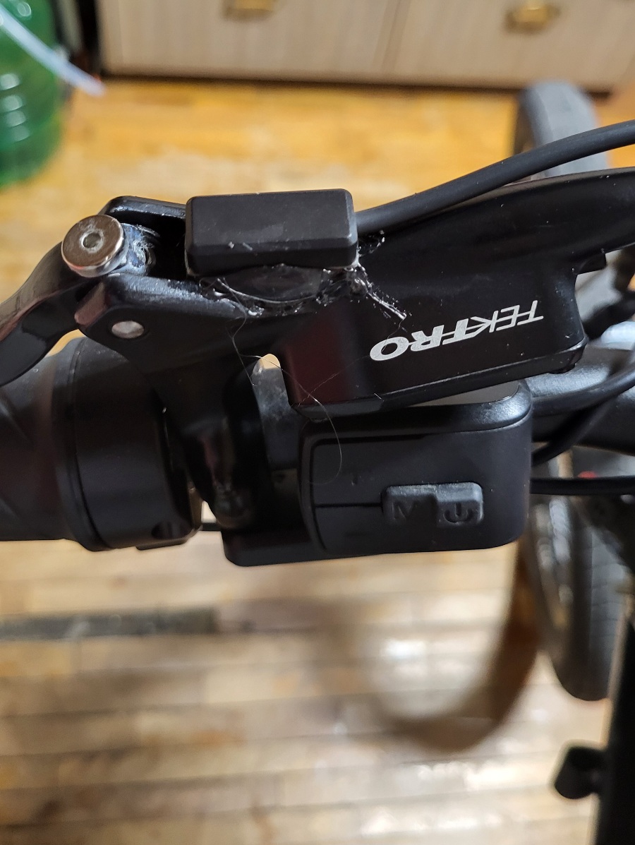

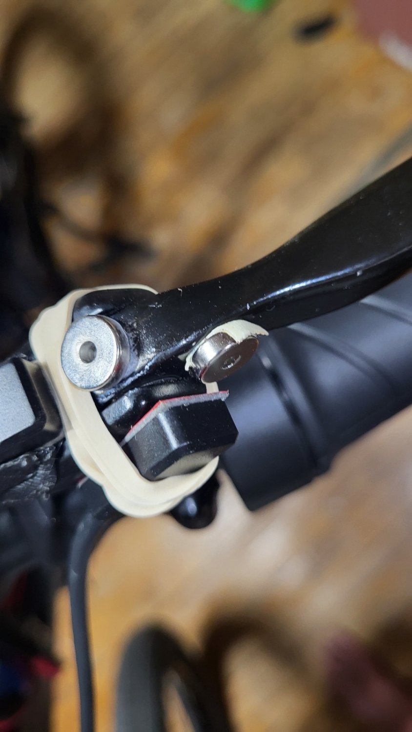

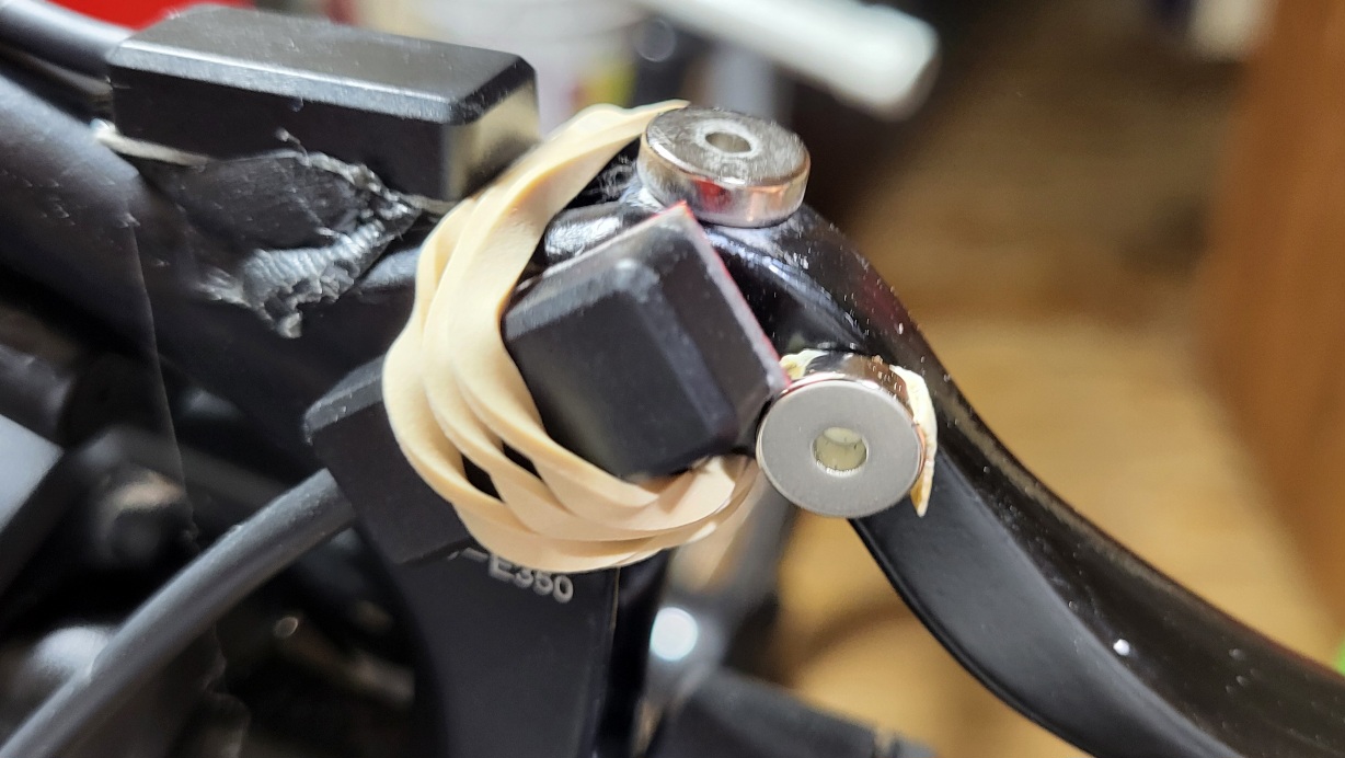

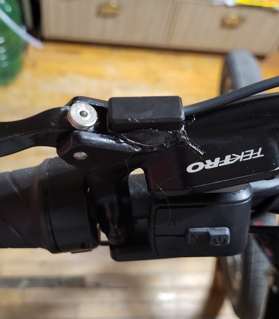

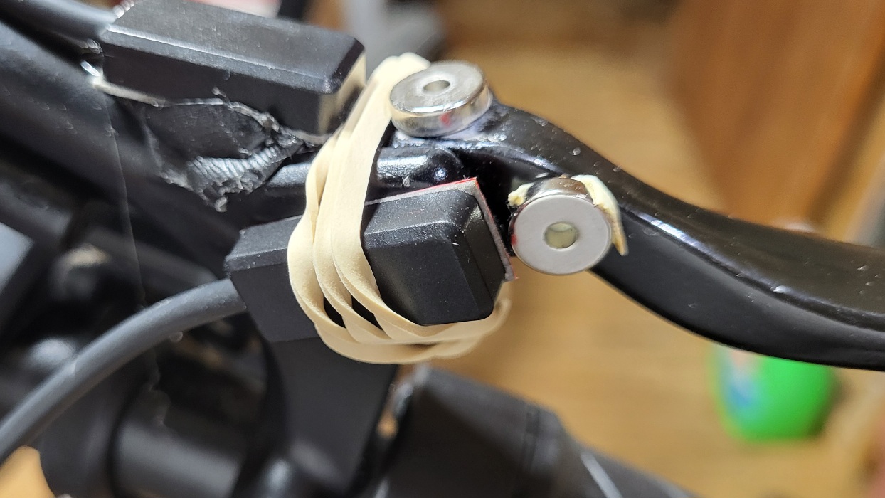

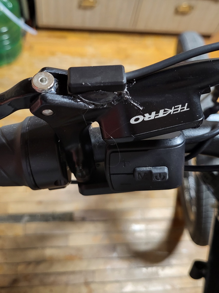

I got the second brake switch installed,..
And I reprogrammed the start and end voltages for my throttle.
The throttle starts a bit sooner but I need to do a road test to see how it feels under load.

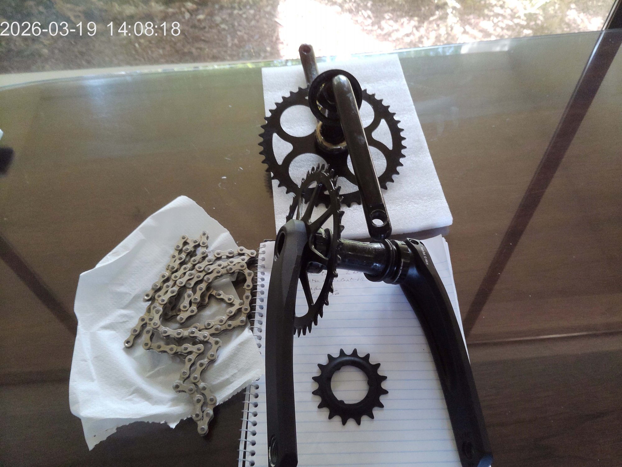

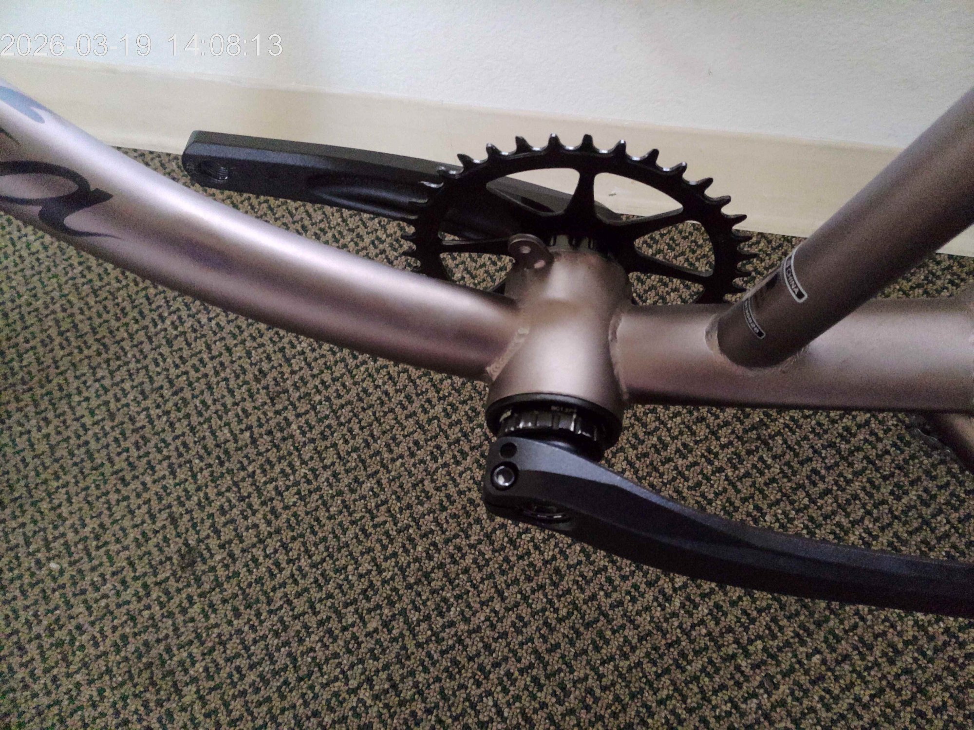

Ditching the cast iron crankset and loose bearing American BB
We reinstalled the loose bearings.
That was a real PITA.
We had to grease up the cups and cones so the ball bearings would stick to the grease and not fall out.
It took us ForEver to get it put back together.

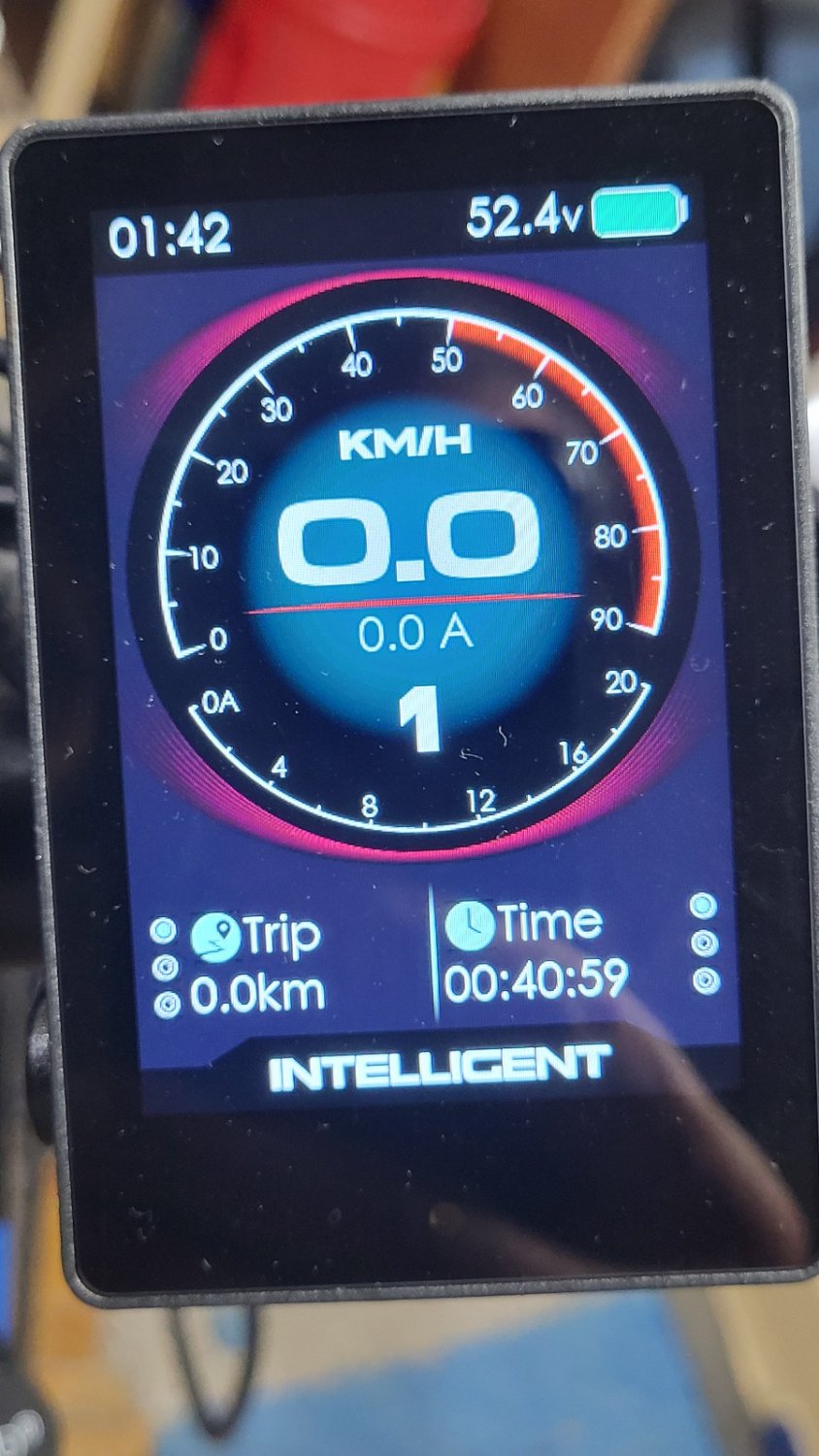

@Gionnirocket
Is there some way that I can monitor the rpms of the motor itself?
I want to try to get my motor at the sweet spot of around 80% maximum rpms, but I'm not sure that I can monitor that directly?
It shouldn't have anything to do with my zero cadence or any tooth count.
I want to know the RPMs of the motor itself.
Do I need to install a Tachometer of some sort?

@Gionnirocket
Personally I never carry my shock pump with me unless I'm setting up a new shock and then only for the first few rides.

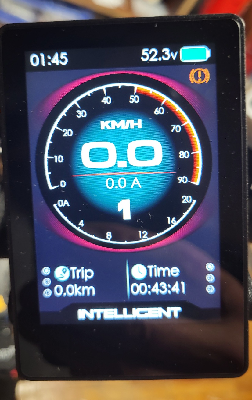

If you set your PAS Speed (page 1) to %, then you can set it to 80%. I believe the max output RPM of the BBS02B is around 140.
The 13" long shock pump works Awesome as a regular tire pump.
It's Way Faster and easier than the other stupid little pump I bought that would take seven days and nights to pump up a tire. 😁
I don't bring my rechargeable compressor with me anymore.
The shock pump is all I need.
(It took me less than 5 minutes to pump up my Fat tire to 10 psi, and it pumps Real easy until you get up to ~60 psi. You need to brace yourself to pump up to 250 psi though, but it only takes a few pumps for shocks or forks.)
Ohh, OK
I didn't know what the "80%" was referring to?
I'll just keep them all at 80%

The newly added brake switches were working great, but I realized that I didn't want to use them like a clutch to shift gears, because the chain line stops moving the instant the switch activates.
I could pedal at that point to shift gears, but all I need to do is back off the throttle to take the pressure off the chain instead.
