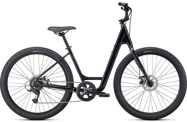

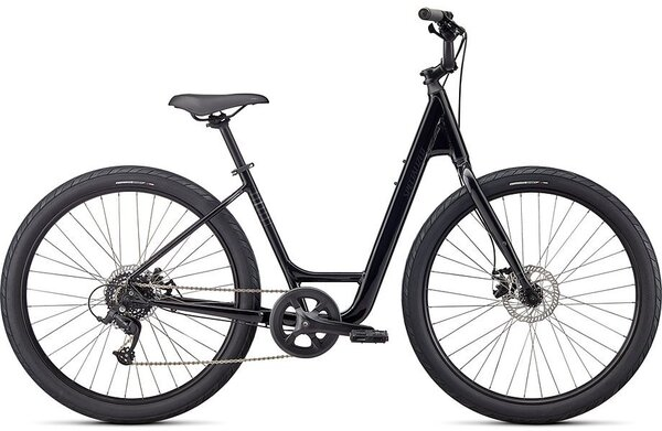

@6zfshdb, You may like a foot forward bike. They are super comfortable. You can get full leg extension and still place your feet on the ground. Putting a mid-drive on a Specialized Roll does this. You are upright and it has a lax geometry. The wheel base is also long for stability. It can come in a low entry model. See the angle of the seat tube? That lowers the distance to the ground. But full leg extension is a bit more like a semi-recumbent with the foot forward. Race bikes have a nearly vertical seat tube. And they have twitchy handling. Note the distance from the bb to the rear tire and the rake of the fork. Just like a longer boat better handles choppy seas, this bike give a smoother ride.

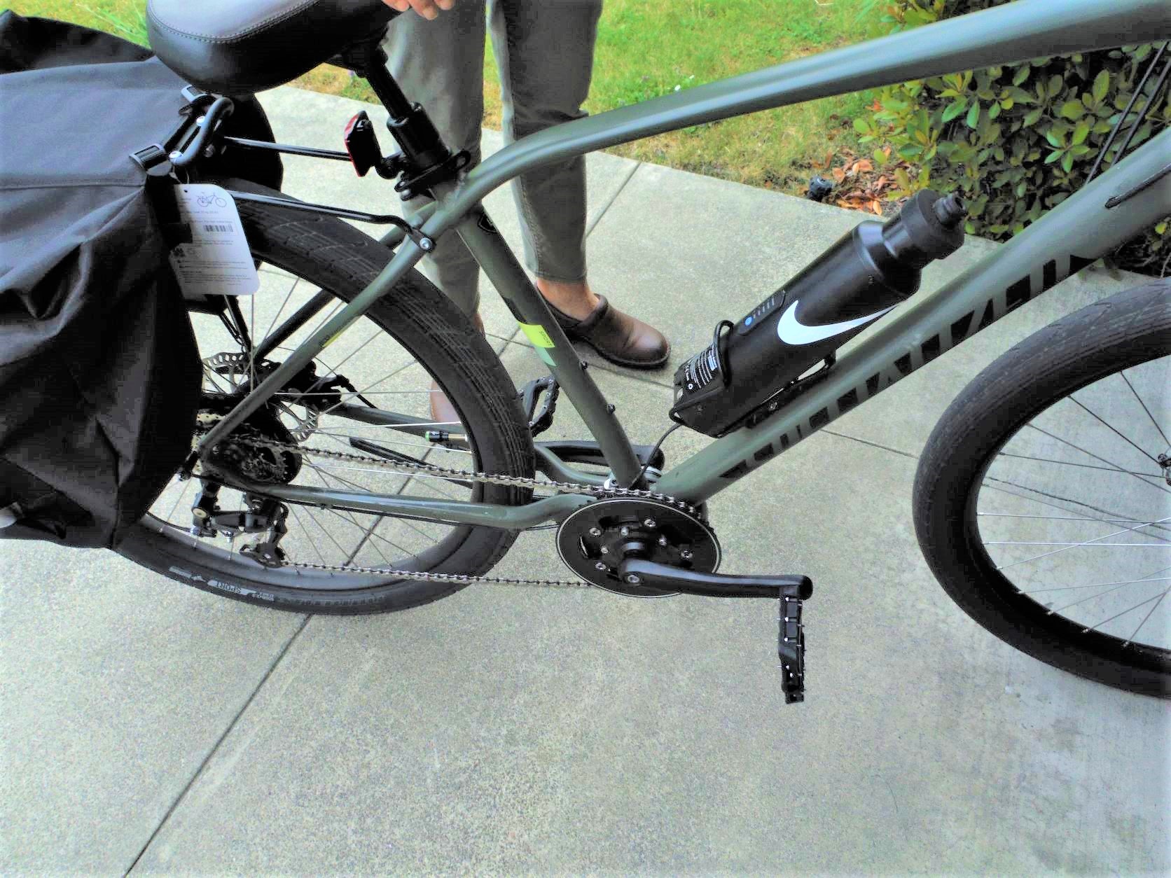

One of my last conventional bikes, a Diamondback Sorrento, had the crank considerably forward of the vertical and at some point it began to bother my back. I switched to a Trek Shift 4 with a more vertical alignment and found it much more comfortable.

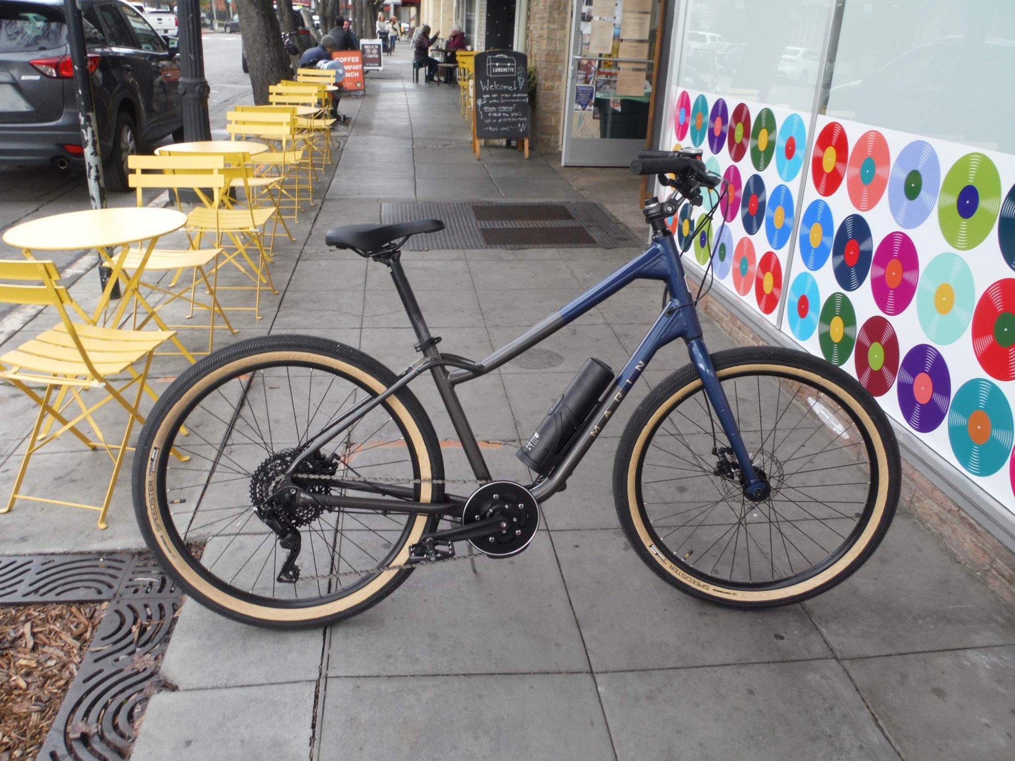

The Marin Stinson 2 has a similar foot forward geo to the Roll, in a mid-step for casual in-town rides. It also comes with a wide range of gears for hills.

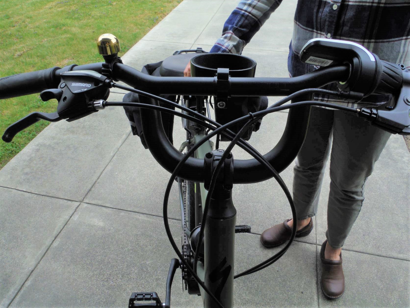

Yes, like the full grown man riding, with a cowboy hat and boots, a 20" child's BMX with his knees at his shoulders! A few years ago a woman who had a road bike that I converted earlier wanted a more comfortable, casual bike. She went to the corporate store where thay are trained to upsell, like the casket salesman pitching the bronze one to a widow. She lives in a coastal town called Inverness, on a huge hill overlooking the Pacific. She told them it had to climb. They sold her the most expensive Gazelle. It could not make the hill. She had to walk it two miles up hill. She called me. I got her a full refund. Then we walked across the street to the Marin Store and purchased a Stinson 2 that I then converted. It is comfortable and climbs her hill like a goat. She also saved thousands. Here is a converted Roll.
