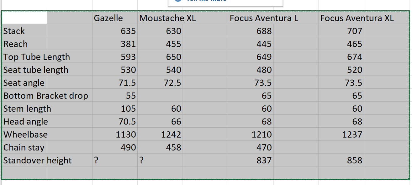

Geometry, I have found some stats and appreciate anyone who can compare to my current bike and my other choice which is the Focus Aventura 2 in large, although I have figures for Focus Aventura in XL as well. The gazelle figures came from some of my measurements and a website to compare bike but I think it is fairly accurate and representative of my current Gazelle Ebike. I have dropped the idea of the Riese Muller Charger for the moment due to cost. First choice now is currently the Focus Aventura 2026 model Bosch gen 5 motor 800 WH battery. No reviews of 2026, and believe geometry slightly different, these are the geometry for the 2026 Focus bikes. Focus bikes very popular for touring bikes in Australia and more agile and sporting than the Moustache.

I do not really understand all of there measurements regarding stack and reach.
One thing that may be helpful with standover height is that the Moustache has a dropper post
Thanks for anyone who can make some sense of this chart. I am 184 cm tall and my current riding position on the Gazelle is upright. I could happily reach another 2-3 cms to handlebars if necessary.
Kevin, have you ever measured your own Standover Height? The 837 or 858 mm are figures for a person of at least 190 cm body height and having long legs. You might not be able to straddle the bike top tube at all! The second thing is dropping the seat-post might leave you with your arms in an unnatural position... Any chance to demo ride that e-bike? Please do not make a grave mistake here!
