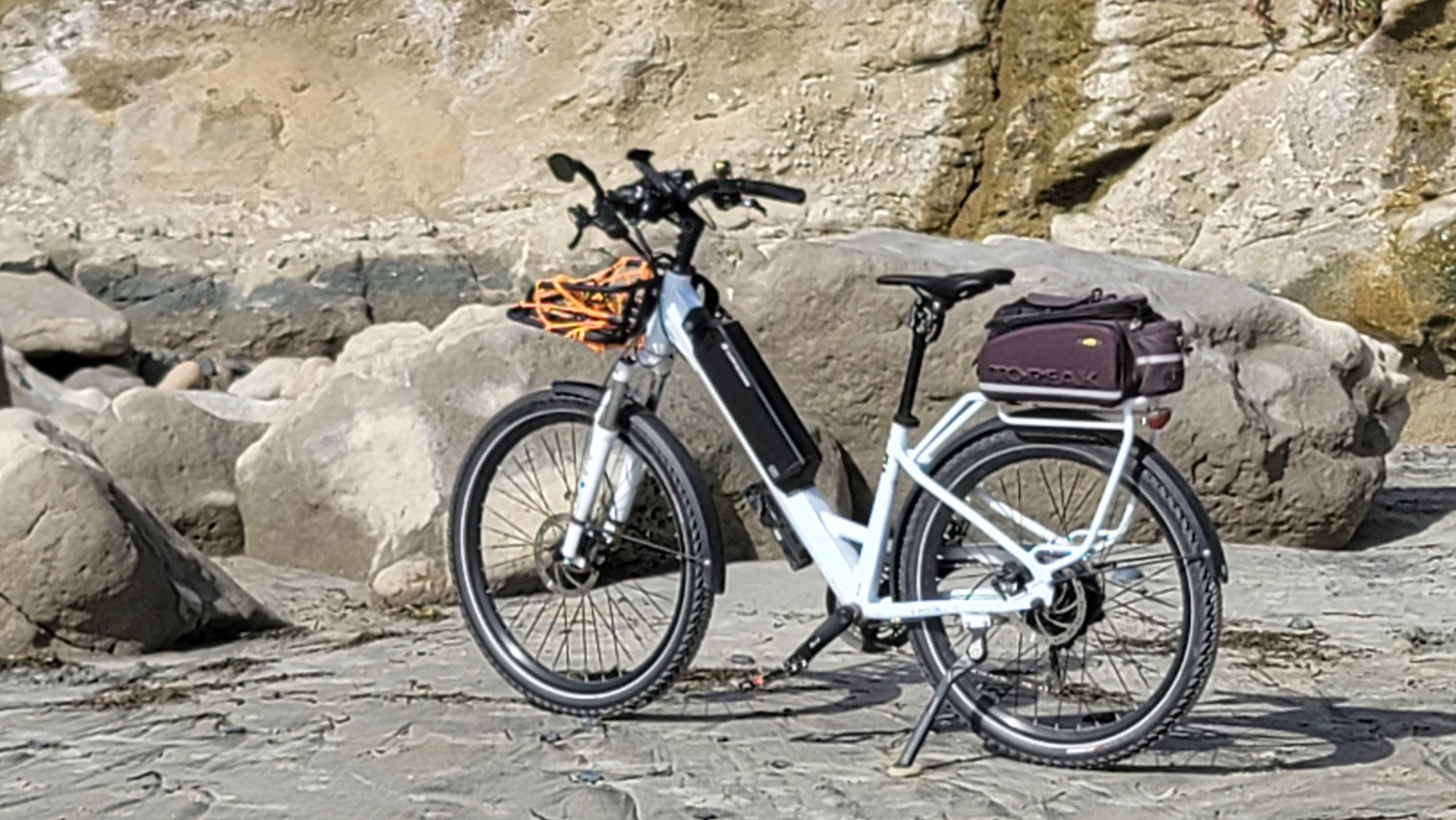

Just as a baseline observation, I never felt any clearly identifiable indication of frame flexure on this 70 lb lower-middle-tier aluminum step-thru hub-drive in nearly 3000 mi of riding — about 10% of which was on rough hardpack. That was with an 87 kg rider and at most 10 kg shopping loads in panniers. The shopping loads were mostly on pavement.
You're contemplating heavier rider and touring loads on much more expensive bikes. My only point is that a step-thru frame doesn't have to degrade handling.

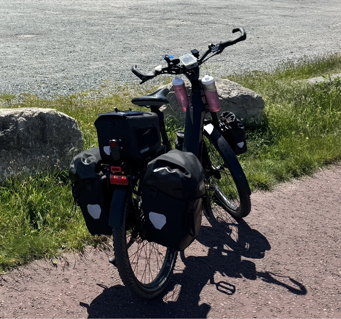

I have the Nevo3 GT Vario GX and use it on tarmac, gravel trails, forest tracks and stones tracks.
Presently I weigh 100kg but at my heaviest was 133kg. Never had any issues riding on the above conditions whilst exploring all day. Also had two Ortlieb panniers, two fork bags and trunk bag which were usually full.
It has never let us down with any significant issues.

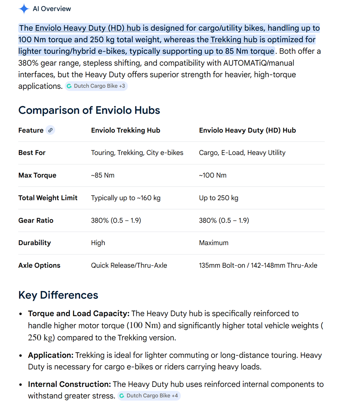

If I buy current stock it will be the enviolo rear bub on Nevo is a trekking model yet on Charger it is Enviolo heavy duty. Do you know which enviolo hub you have?

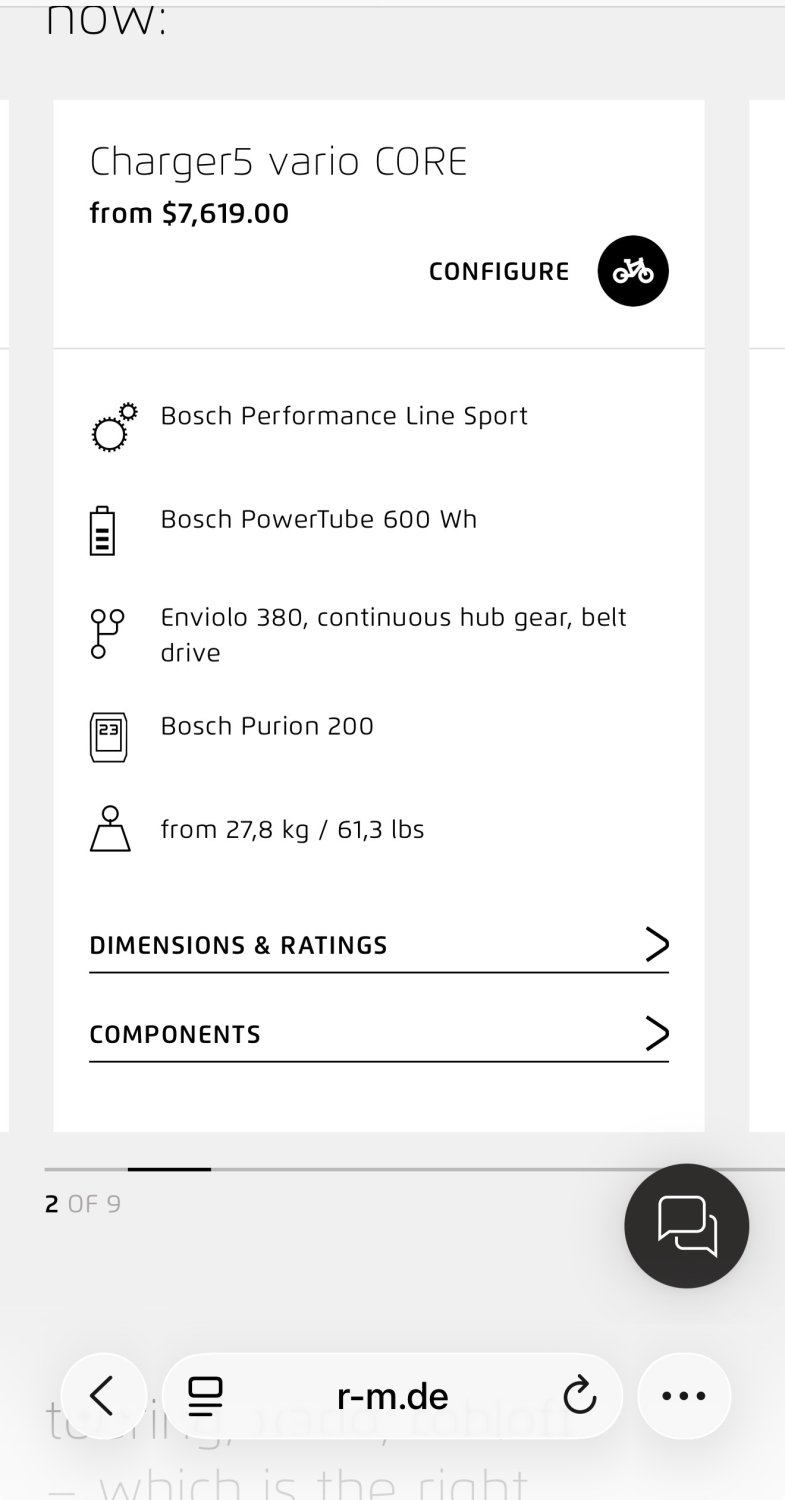

I’ve had a look on the R+M website which states that the Nevo and the Charger are both fitted with the 380 Hub.
Nevo
Charger
DG…

I believe there is a big label on each hub showing trekking, heavy duty etc.
Would be interested to know what yours is. They have a Nevo older model on a sale here and it has the trekking version Enviolo hub, where as the Charger has the heavy duty version Enviolo hub

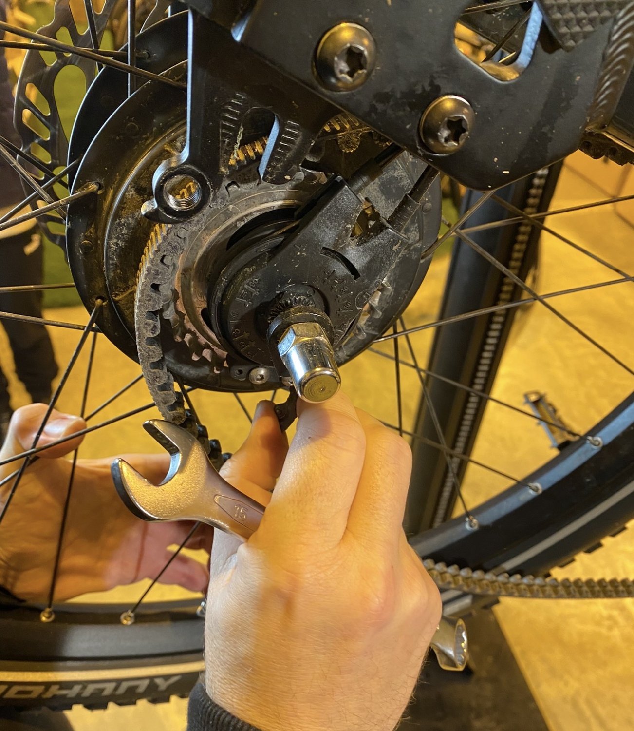

Thank you for the details.
My bike is in storage in the UK and we are in Poland waiting for our house to be, so cannot physically check the bike.
However, I can confirm that the method of fixing the rear wheel is bolt on and, not quick release / through axle.
This was from when the LBS was showing how to take the rear wheel off.
DG…
