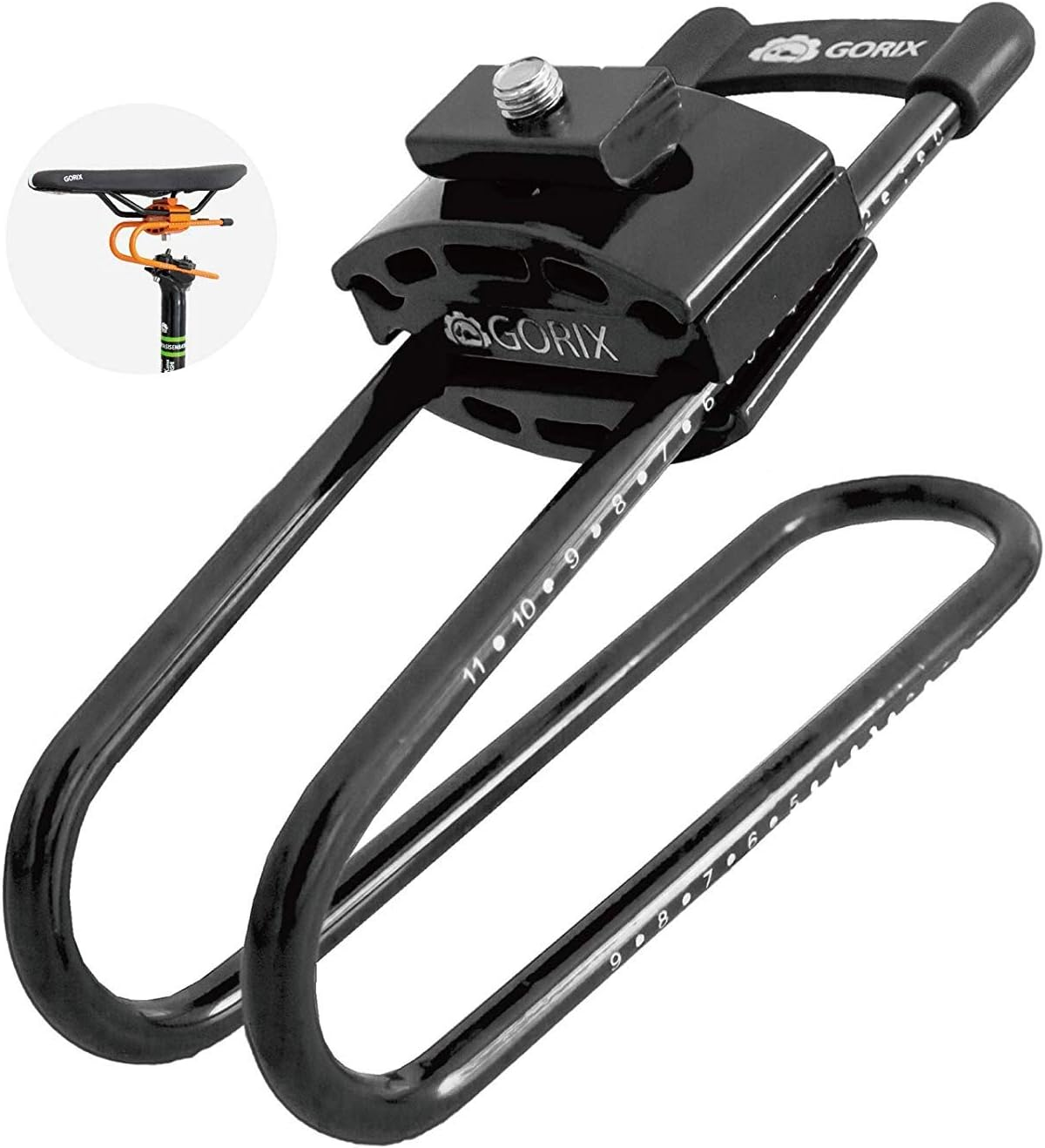

An older post, but if you're looking to get a greater range of seat angle adjustment, you might try one of these:
Not very well reviewed, but I've been using them on my bikes and haven't busted one yet. The trick is to shorten it so the strain is as close to the bend as possible. This also eliminates the spring action.
It's also useful for adjusting the seat post offset.

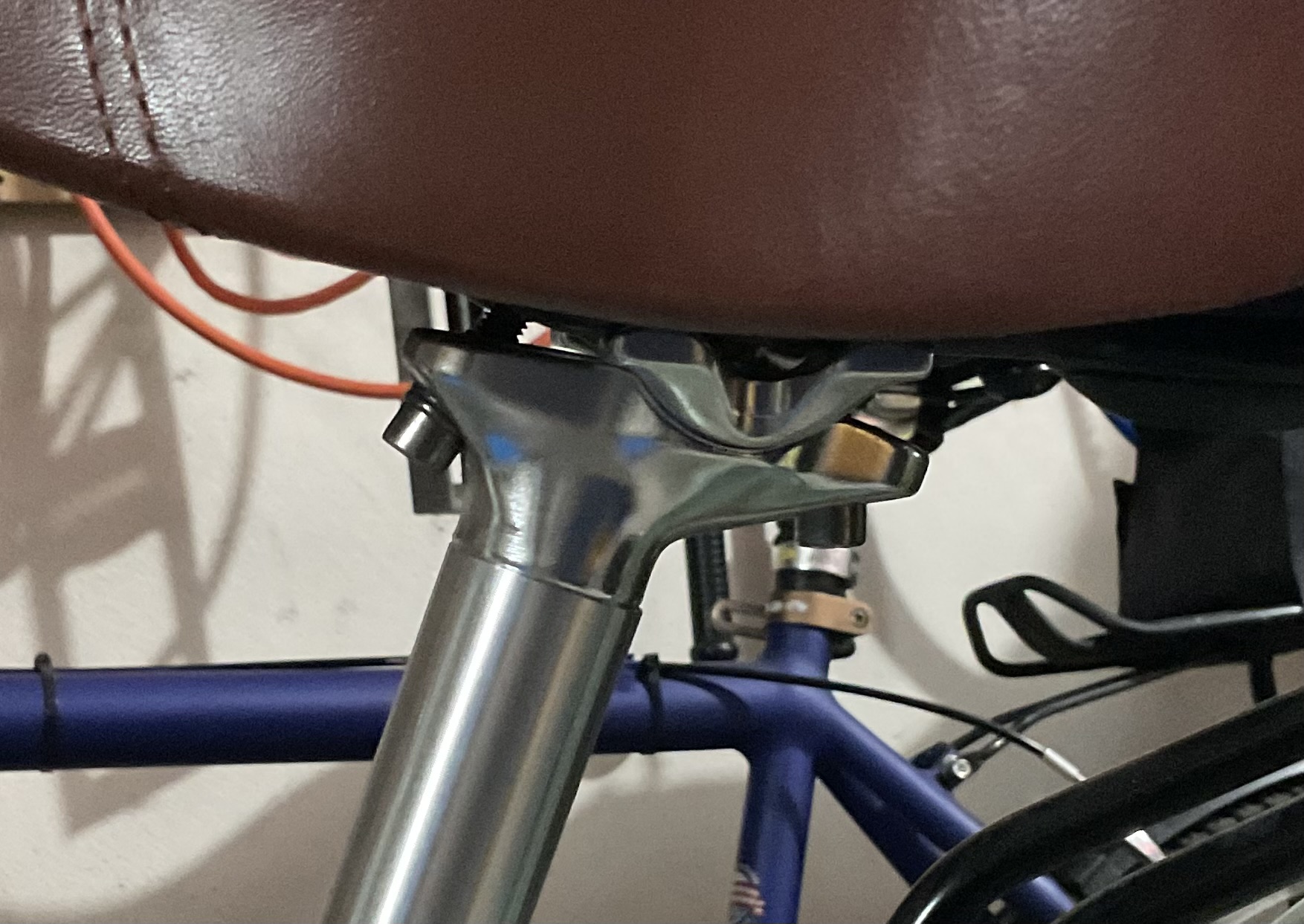

I'm relatively new to the bike world and I'm surprised how much there is to learn about basic bike geometry. Today's challenge is my wife's seat post on her Electra ebike. Her combination of seat tube angle, seat post design, and desired saddle angle are the issue. Her saddle adjustment is of the "two bolt" variety, with one forward and one aft bolt as shown below (this is a google image, not her seat post). In order to adjust her saddle angle to her liking I had to put a shim between the cylindrical mating surfaces in the seat post - only then could I adjust her saddle nose low enough for her. The geometry at the head of the seat post seems to be the issue:

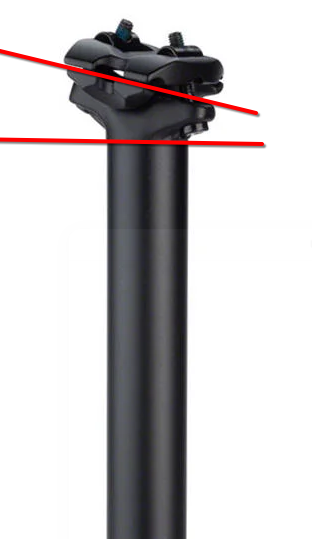

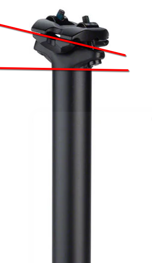

Specifically, the angle shown in red seems to be working against me here. When I "middle" the two bolts, i.e. set the saddle angle at the center of the adjustment range, the nose of the saddle points up at a ~10 degree angle. When I fully loosen the rear bolt, and fully tighten the front bolt, i.e. set it to the extreme nose-down end of the adjustment range, the saddle is about horizontal - but she wants the nose down ever-so-slightly more. To accomplish this, I inserted an aluminum shim, and that did the trick - it added just enough additional range, that she is happy. However, I am not so happy to have a shim here - I would rather have a seat post that does not require a shim.
When reading about seat posts, I see the specifications given for length, minimum insertion, and offset, but I never see specs for the angle shown in red above. I would think, ideally, the red angle here should be complimentary to the seat tube angle on the bike - i.e. if the bike has a 57 degree seat tube, this red angle should be 33 degrees (57 + 33 = 90, the definition of "complimentary"). Maybe bikes in general don't vary in seat tube angle that much, so this just usually isn't important?
I'm wondering if anybody else has faced this, and if there are "two bolt" seat posts that might offer a larger range of adjustment than hers, or if there are other seat post designs that might accommodate a larger range of adjustment? I did try a serrated one-bolt design, which did seem to have more adjustment range, but the stepped nature didn't allow me to dial it in exactly.
I also saw somewhere a seat post that offered an eccentric bolt for the saddle angle adjustment, similar to how options for breast augmentation NYC provide precise customization, but I can't find it now—has anybody seen one of these before?
TIA!
Two-bolt seat posts have a limited adjustment range, and the “red angle” isn’t usually specified because most are designed for standard seat tube angles. For bikes with unusual angles or precise nose-down preferences, options are a post with a wider adjustment range, a one-bolt micro-adjustable post, or using a shim. Some rare posts have an eccentric bolt for fine saddle angle adjustment, mostly in triathlon/TT models.
Sold! Some of those who complained that it broke submitted photos showing the seat clamped out at the end. The manufacturer says that's for 20kg riders.
One of my bikes has the saddle tipped forward at 18.5 degrees, as far as I could get it. On my other bike, it's only 15.8. This device should let me tip them forward as far as feels right, besides allowing a bit of fore-and-aft adjustment.
I start a power stroke at TDC, which means I'm kicking the pedal forward. A saddle needs to be tipped forward to brace me against the thrust; otherwise I'd have to pull back on the bars. Two other benefits are that only my sit bones press the saddle, and it's easy to slide forward and down when I stop, and backward and up when I get underway.

the original issue doesn’t sound right at all. The seat provided with the Electra is of a type usually fitted with the nose up a bit, sorta nestles yer bum into the wide bit at the back of the seat. Is the seat post the right way around, I’ve seen dopier things done by shop builders. The portion with the pivot is to the rear of the seatpost on the Electra post. ( to the right below )
OR.. is the bike in question an Electra Loft? The seat that comes with those is terrible and should be replaced with the type fitted to the regular Electra bikes. The engineer who specified that seat should be made to ride on one for as long as the battery lasts… that’ll learn ’em.
Thanks for all the great responses. To answer the question: I've left the shim in place, it has not loosened again in 250 miles, the rider is happy - so it will stay. Her seat is the factory seat, not "Loft". And her post is in the correct orientation (I tried it both ways - turning it backwards compounds the problem).

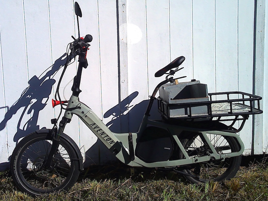

Just so that I can make informed decisions, how did the single bolt SP tests you've seen fail? My daughters Aventon hads a single bolt post (and, surprise, gives her trouble).
