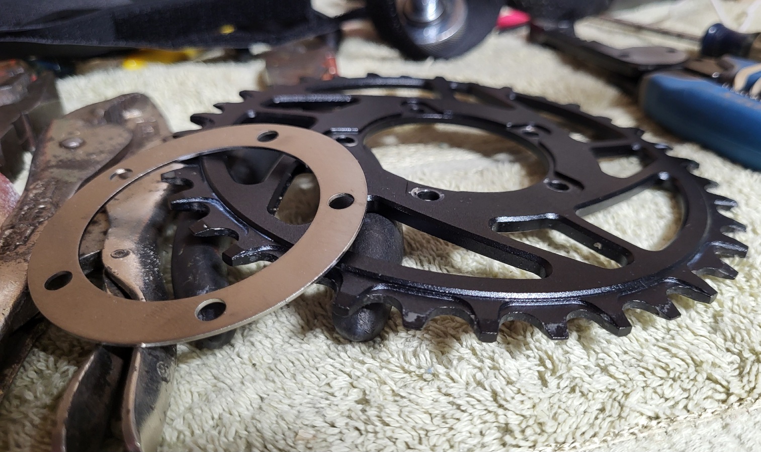

I finally took my ebike for a test ride.
I'm leaving my chaingaurd on.
It does serve a purpose (but it doesn't provide concrete curb protection)
I'm all about function over form, and the uglier and stupider my ebike looks, the better.
Who'd wanna steal sumthing so stupid?
I don’t want a toothed chaingaurd grabbing my pant cuff and feeding my leg into the motor.
I'd rather have no chaingaurd than one that's specifically designed to feed me to 750 Watt motor.
That's just stupid.

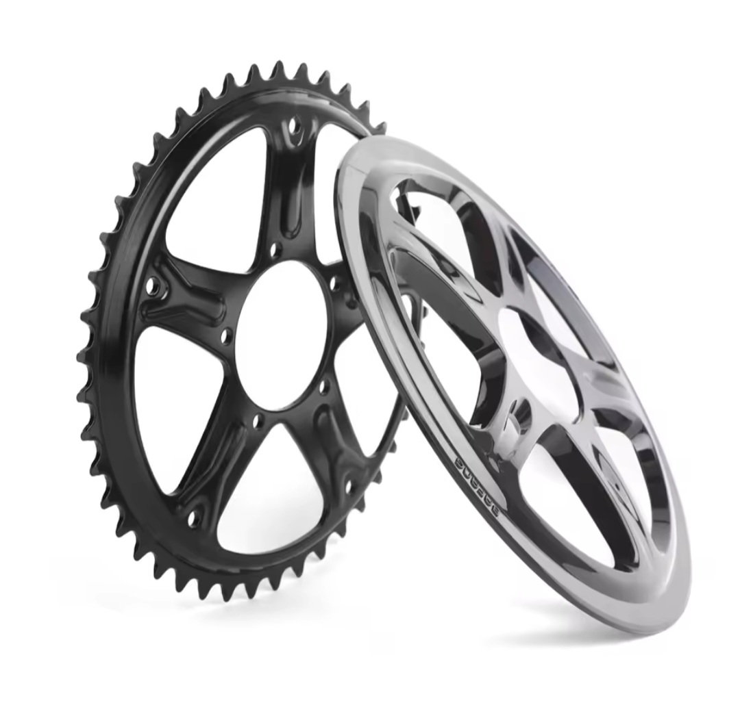

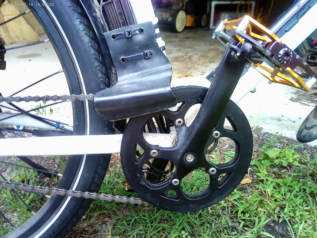

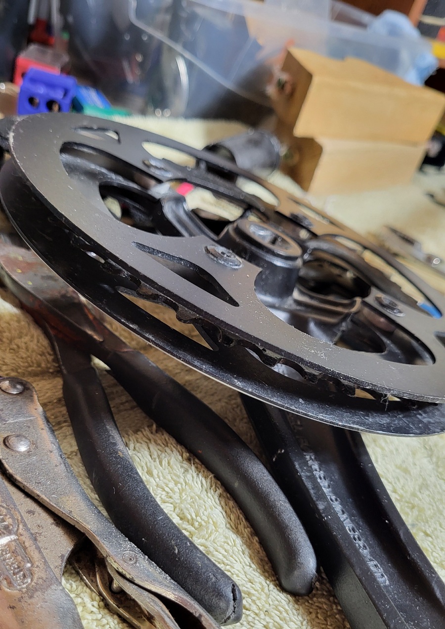

Is your chainguard the smooth ring outboard of the chain ring? I did something like that with my Radrunner. I got a bigger chainring, multiplied the diameter by pi, cut a length of maybe 1/2" vinyl tubing that long, slit it lengthwise, worked it over the teeth, and secured it with little zip ties. I fastened the bigger, smoother, softer chainring outboard of the driving sprocket.
My Radmission came with a similar outer disk. I don't know if it ever worked, but I know it didn't always work. The chainring could snatch my cuff if I forgot to wear my elastic velcro strap. It looked enough like a conventional bike that I bought a universal chainguard. There was no way to fit it.
I cut my own from a piece of 3mm polyethylene lawn and garden edging. I used a heat gun to bend it and a thermostatic soldering pencil to make holes for big zip ties. Never again did my cuff get snatched.

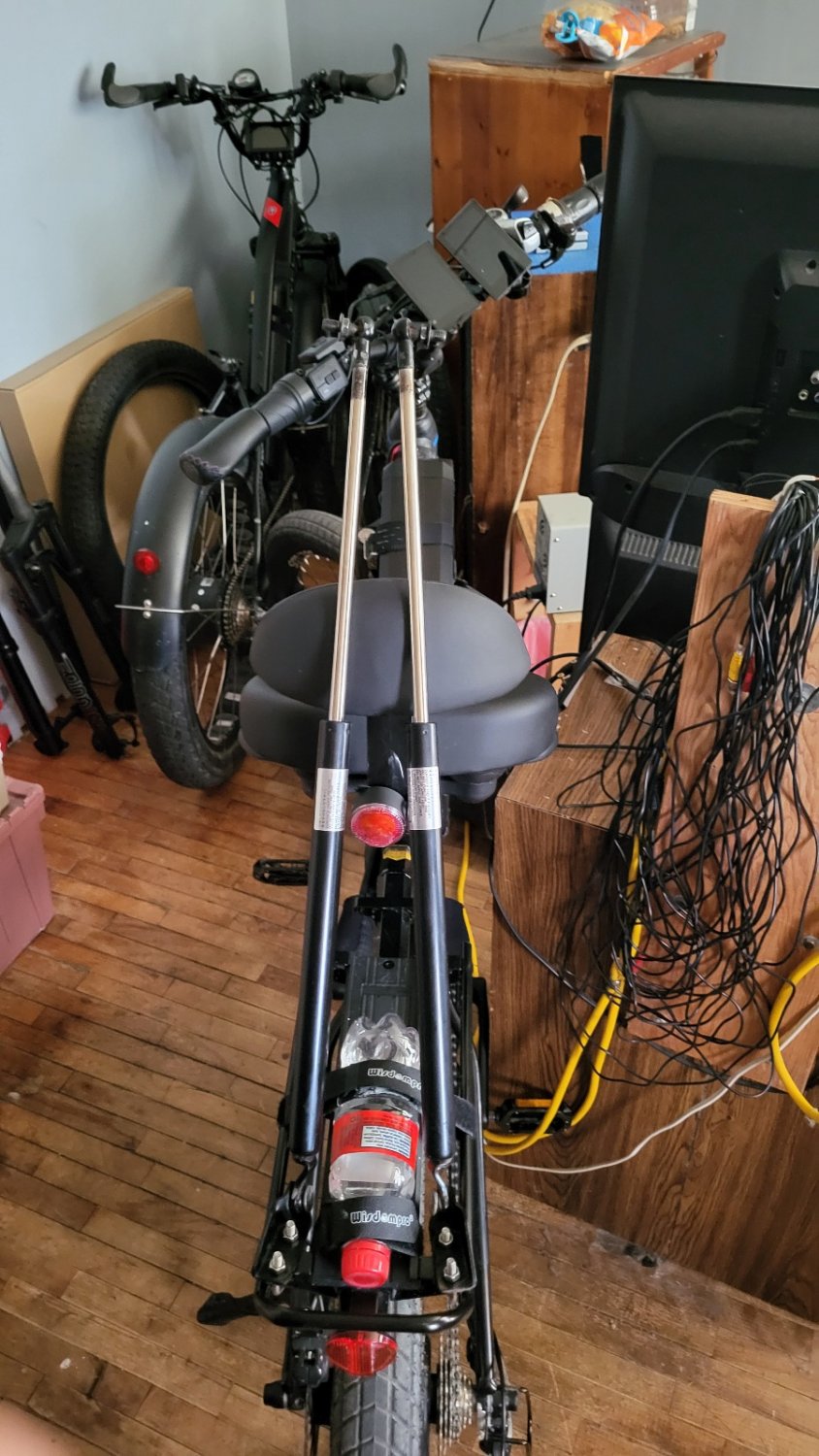

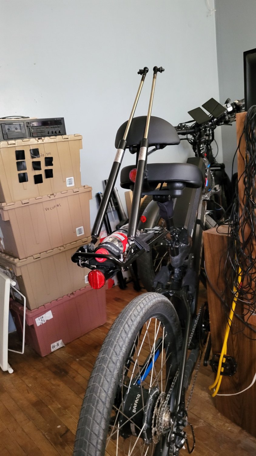

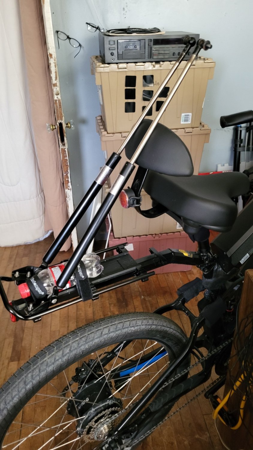

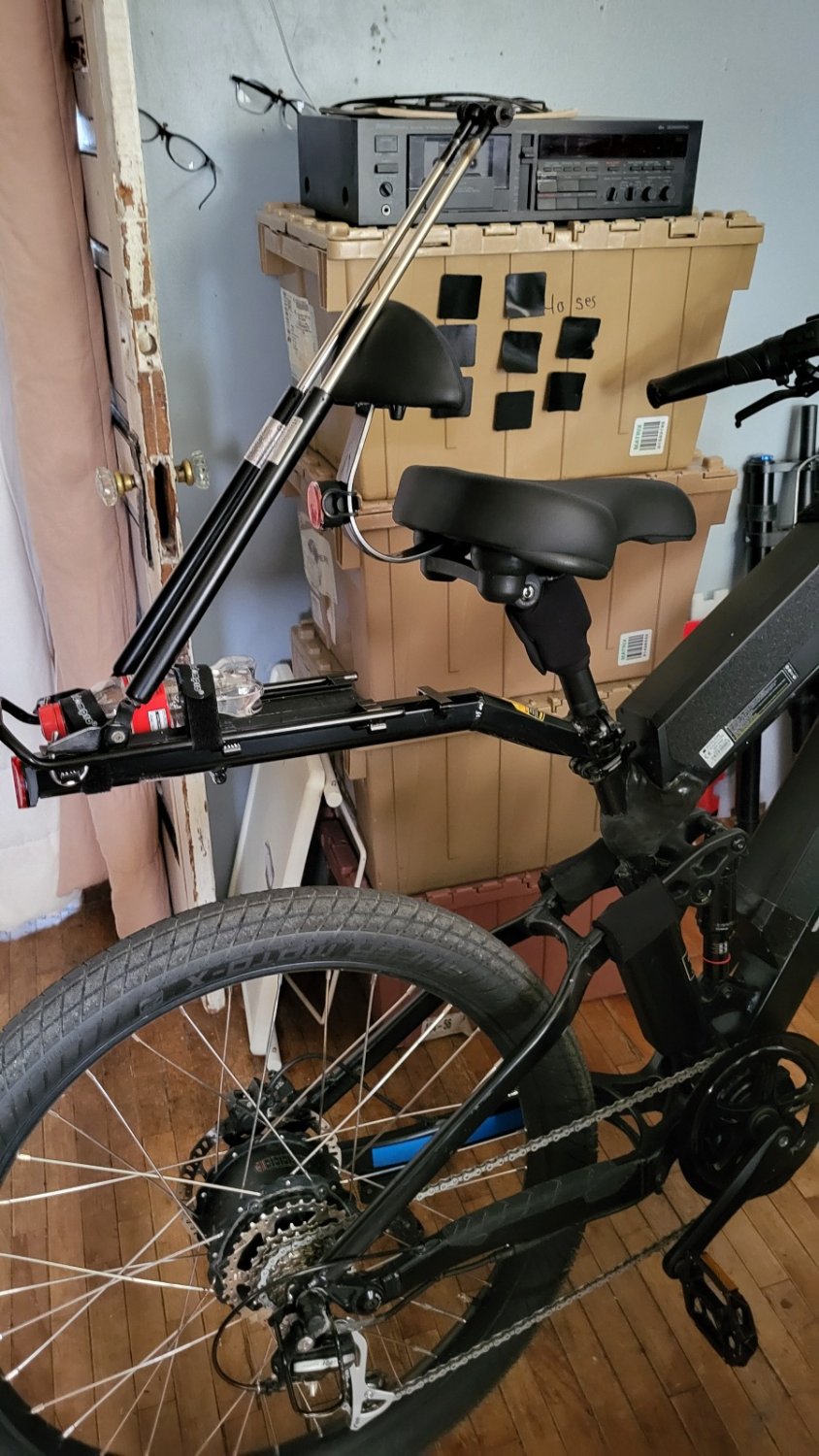

I'm more than willing to spend close to $1000 CAD to buy a seat that works for me,..
I don't like sitting up straight, and I have little use for handlebars.
A seat like this might work for me?
I can mount the seat stanchions to my rear rack,..
I've already got gas filled stanchions from my car that I can use.
They appear to be about the right length ??
My gas charged stanchions will help to control the pulsing of the rear rack bouncing into my back, as the seat moves in and out and up and down.

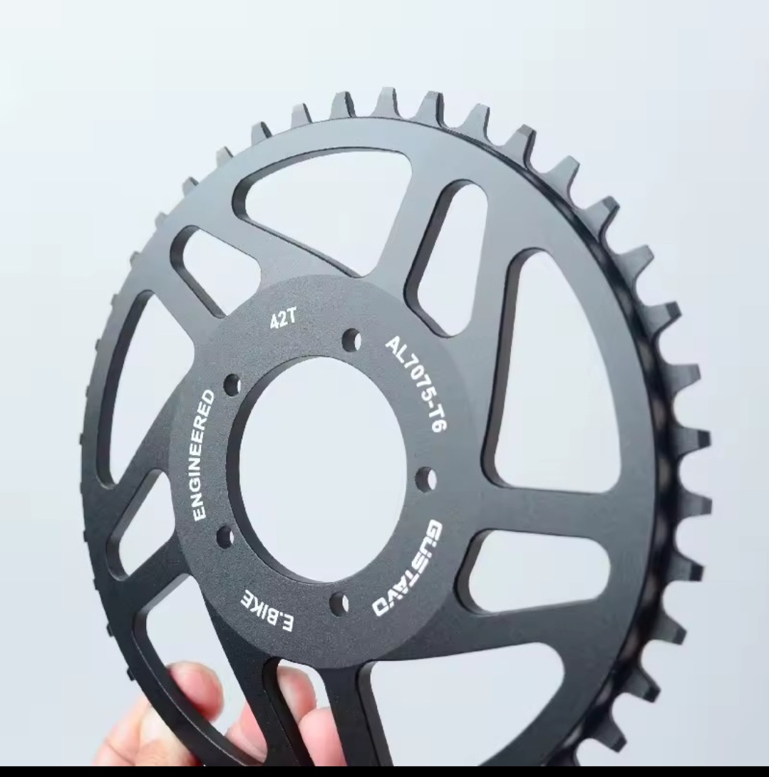

I don't need a chain, and my hub-drive doesn't need a chain, but my new mid-drive needs a chain,. and sprockets, and a Big Chainring to go Really Really Fast.
And a tiny Chainring to go Really Really Slow with lots of torque.

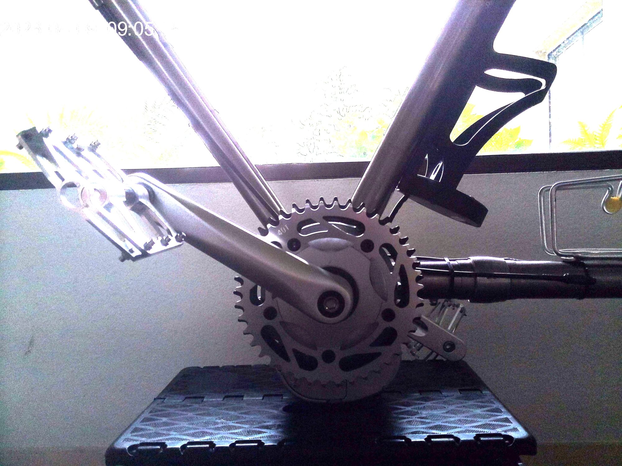

I had a hard time finding a UART BBS02B with 100mm BB spacing.
I couldn't find Any 500 Watt versions, and had to buy a 750 Watt motor to get the spacing I needed.
The BBS02B, especially a UART version, is almost extinct.

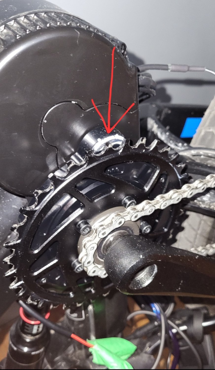

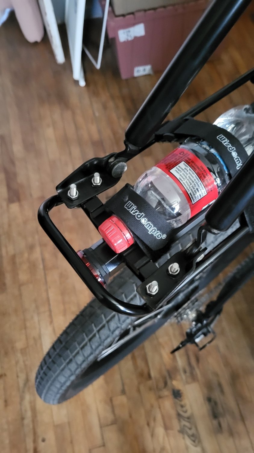

Here is what happens when BB spacers are not used on a MTB,
I got the spacing right, but I wanted to "cushion" the impact point between the motor housing and my downtube.
The motor was only making contact with about ¼" of the downtube, so I put a piece of urethane (cut from a piece of my skateboard truck "shock absorber" from 1978) between the housing and downtube, then "preloaded" it with a pry bar while I tightened up the BB nut/fastener.
Then I put hot glue on it to help keep it in place.
It is pinched in there pretty good, but it could loosen up I guess?

I used a rolled section of used tube for that. I cut an oval in the middle to fit the round of the down tube and levered it in hard while tightening the left side with tons of locktight.
Yeah, I remember you posting a picture of that.
I don't think that would work for my motor?
There's no bolt where the motor contacts the downtube.
I didn't want to use an innertube thinking it would be too soft and would get mashed and cut by the downtube.
The piece of urethane is really hard rubber.
The contact point was only about ¼" wide, on the outer motor housing,..
And the motor housing wasn't contacting flush with the downtube.
It was hitting the edge/corner.
Yeah one solid piece is better than folding up soft rubber.
I used a piece of sprinkler funny pipe that I manipulated with a knife and a heat gun. It fit perfectly with minimal give and looks as if it was supplied with the kit the way it wrapped the downtube.
I cut it kind thick thinking that the ¼" contact point would be "absorbed" and the pressure would be spread across the motor housing more evenly.
I didn't over think it..

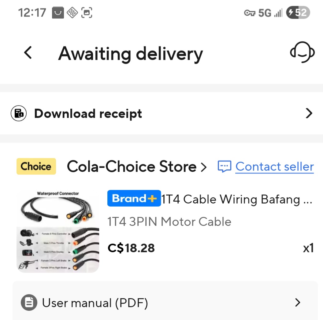

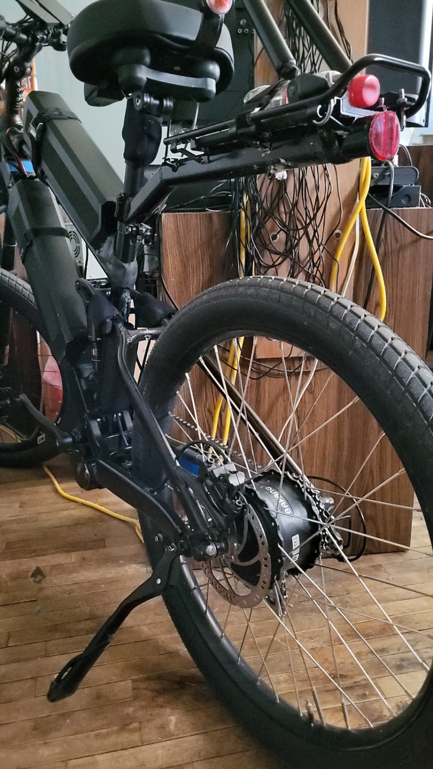

It's Fixed !!!

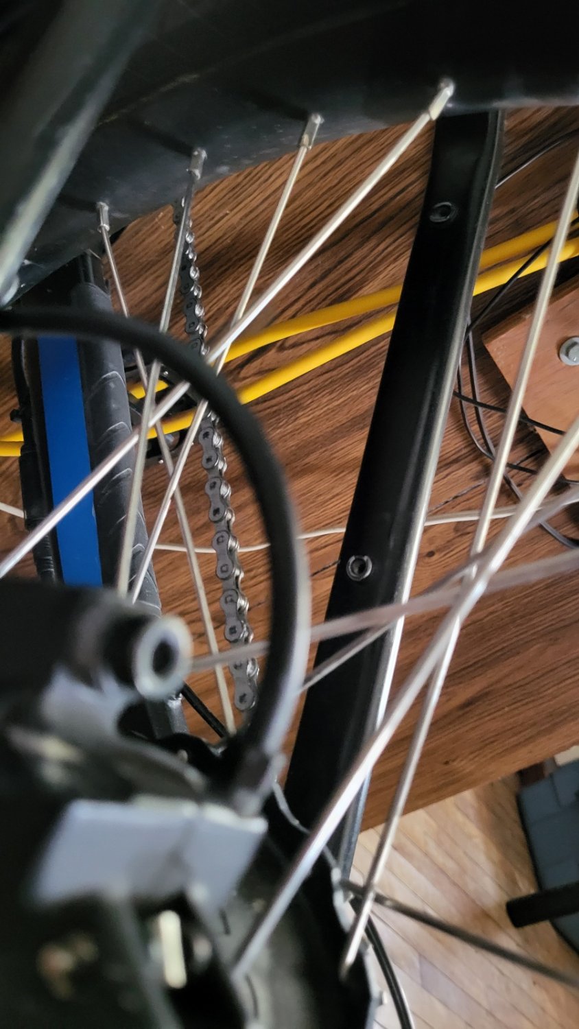

My cable just needed to be reconnected inside the downtube,..
Turns out "Somebody" put some sort of grease all over the connector and it pretty much just fell apart !!
So now I have a spare cable.
I think that I'll store it inside the downtube so I don't lose it?
I'll just grease it up good, and jam it in there. 😁
