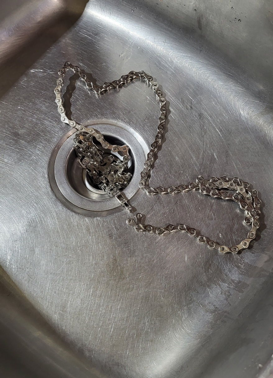

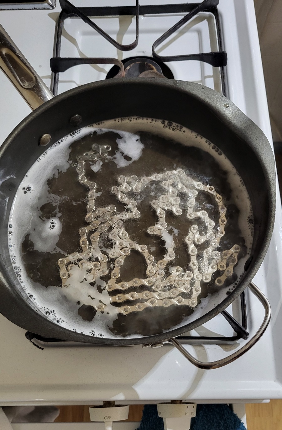

I've got two new KMC e8 chains that need to be cleaned and waxed before I install them.
I just spent 5 hours cleaning and waxing one of my new e8 chains,..
The chain was Really sticky with the "oil treatment" on it.
I started with hot water and Dawn detergent, then dried it, then rinsed it in Naphtha, then Dawn and dried again, then Acetone and dried again, then a final hose down with Brake cleaner outside on the back porch.
So I'm now ready to start waxing,..

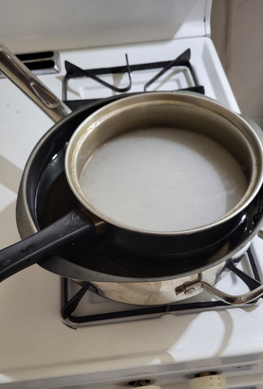

The last time I used my wax, I got it Way Too hot and it started smoking.
Then all kinds of crusty bits formed on the bottom of the pot.
So this time, I set the pot of wax in a bigger pot of water so that I don't over heat it.
I've got Molybdenum Disulfide and Teflon Powder in the wax, but they separate out and sink to the bottom of the pot.
I melted everything, stirred it up, then poured it through a strainer to catch the crusty bits, then cleaned the pot and heated up the wax again.

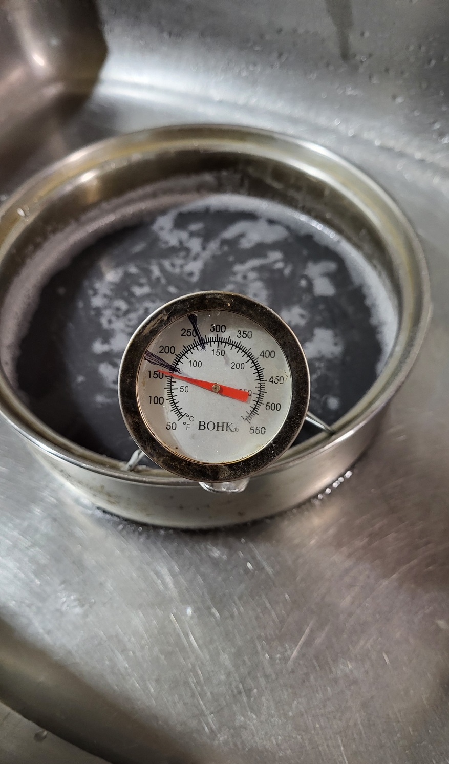

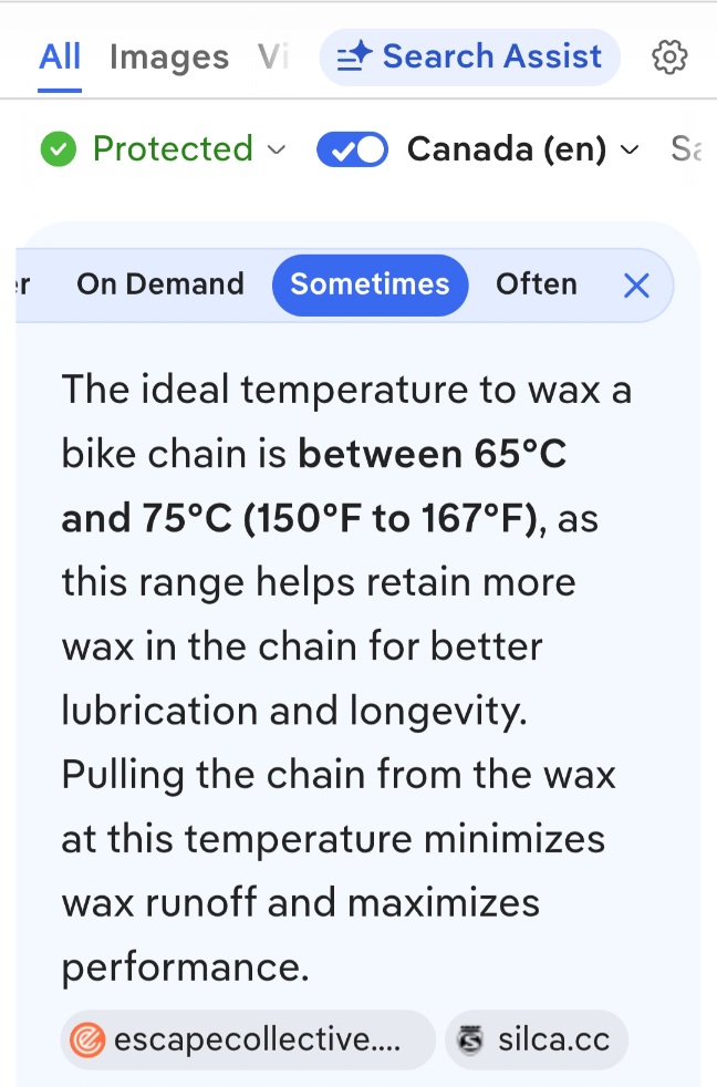

This time I checked to see what the proper temperature was supposed to be,..
I kept stirring while flipping the chain around, and removed the chain at 150°F,..

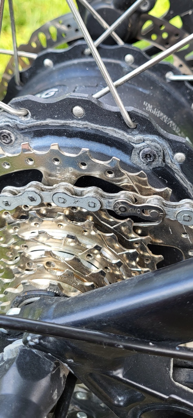

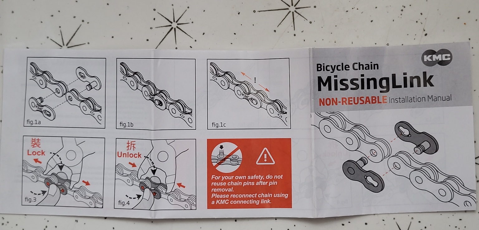

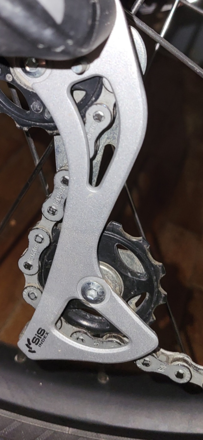

So now I'm ready to install my fancy new Ebike Chain on my ebike, and it looks like my 1-4 cable should be here in a couple days.
The new chain came with a quick-link, but this particular quick-link apparently can't be reused??
I dunno??

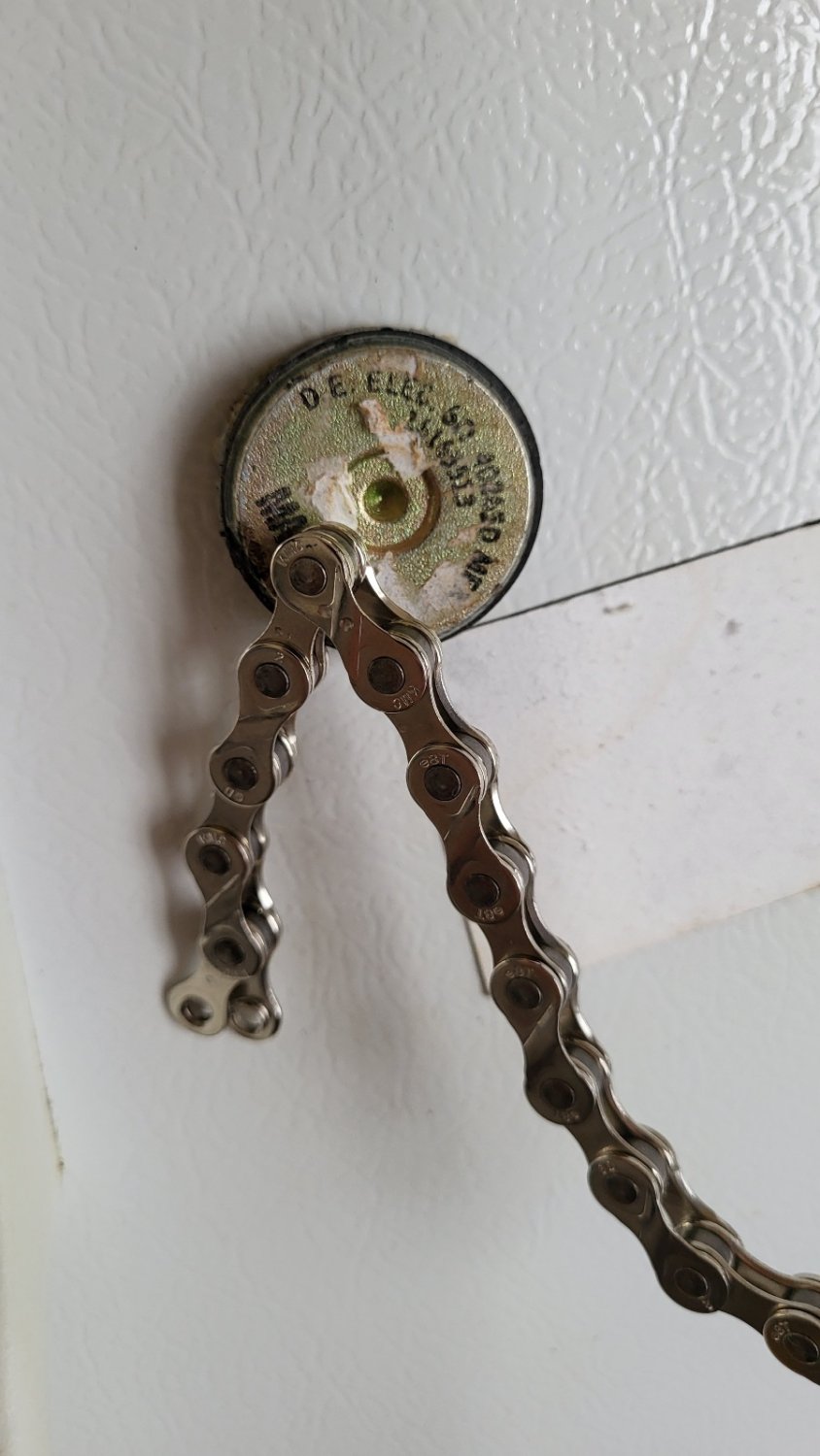

And the chain sticks to a magnet so it’s got iron in it and it can rust.
But a "Real" chain needs to have iron in it to be strong, and if it's got rhe proper alloys and ratios in the mix, it can be almost rustproof.

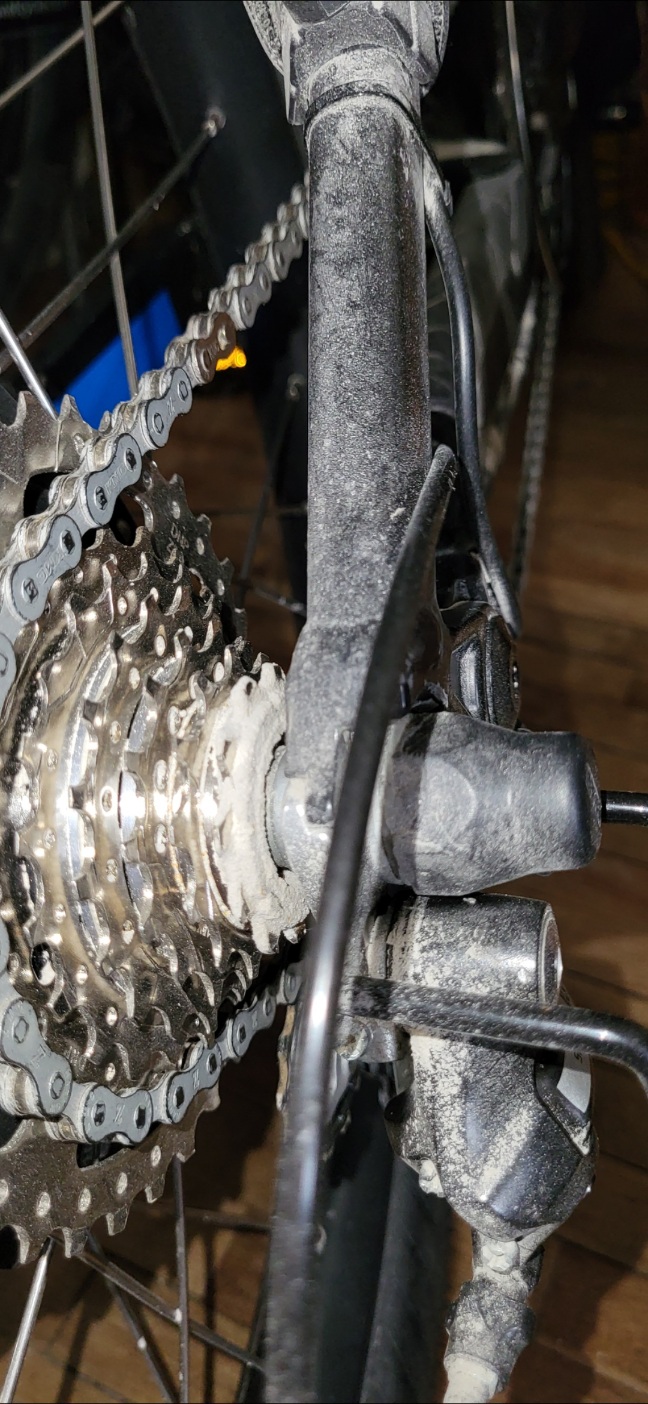

Not just the greasy hands (and pant cuffs), but also the Entire drive-line is greasy crud free.

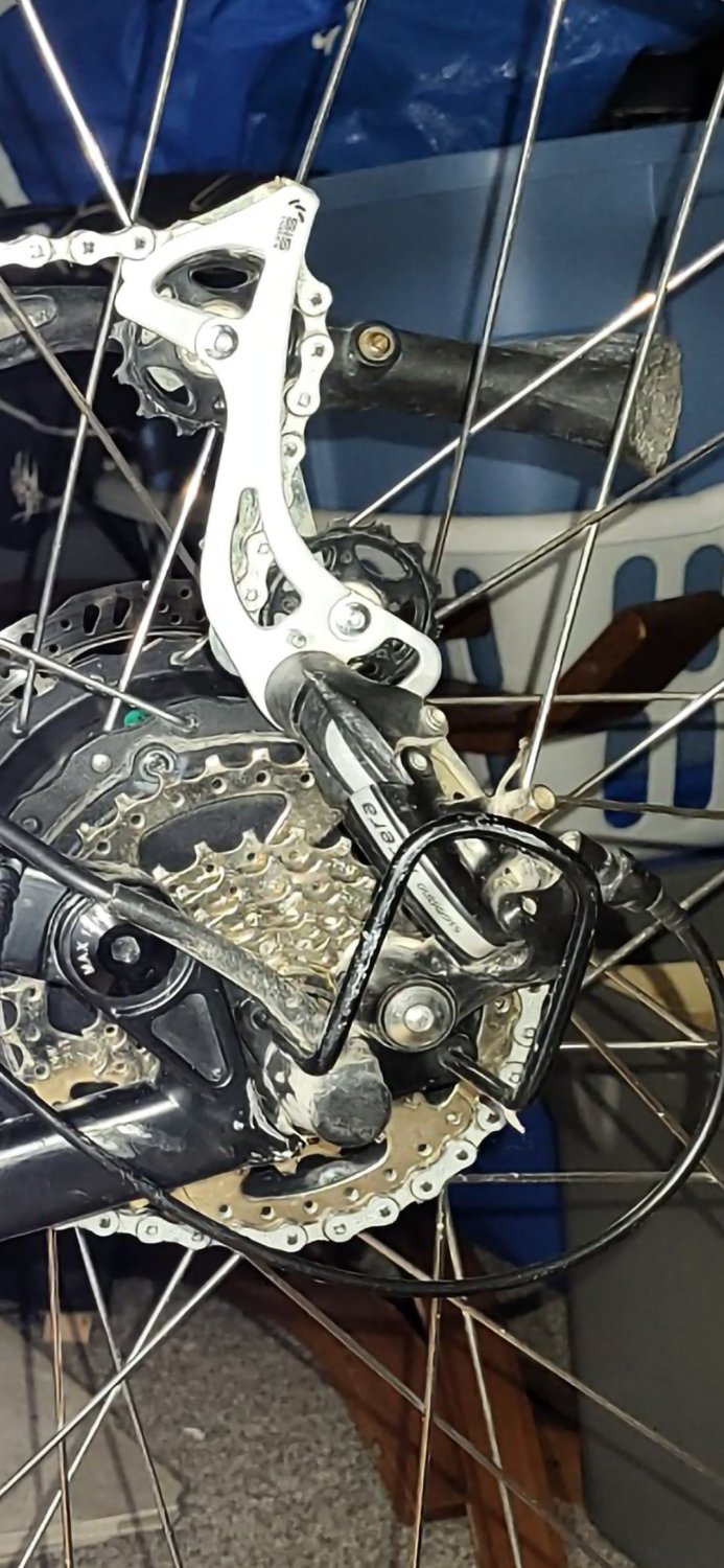

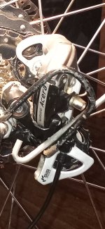

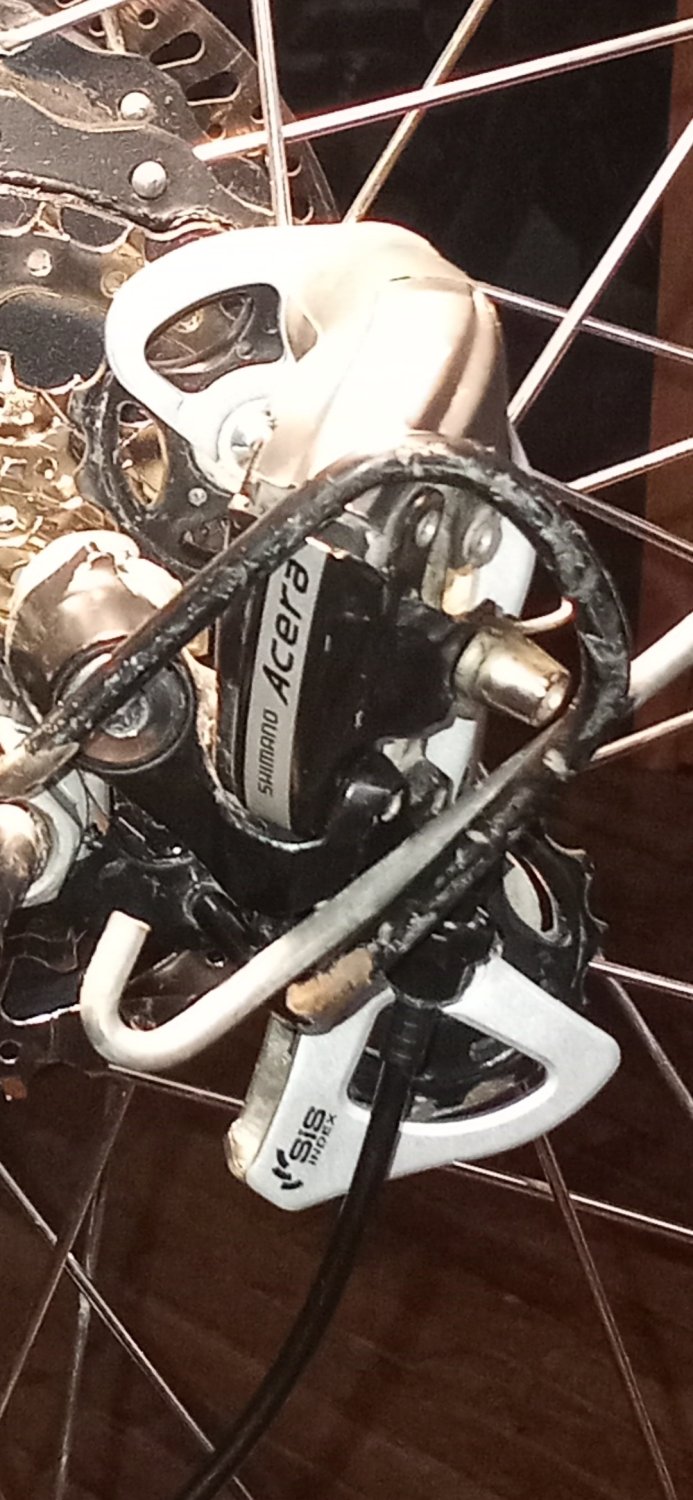

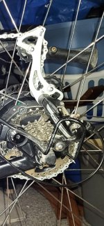

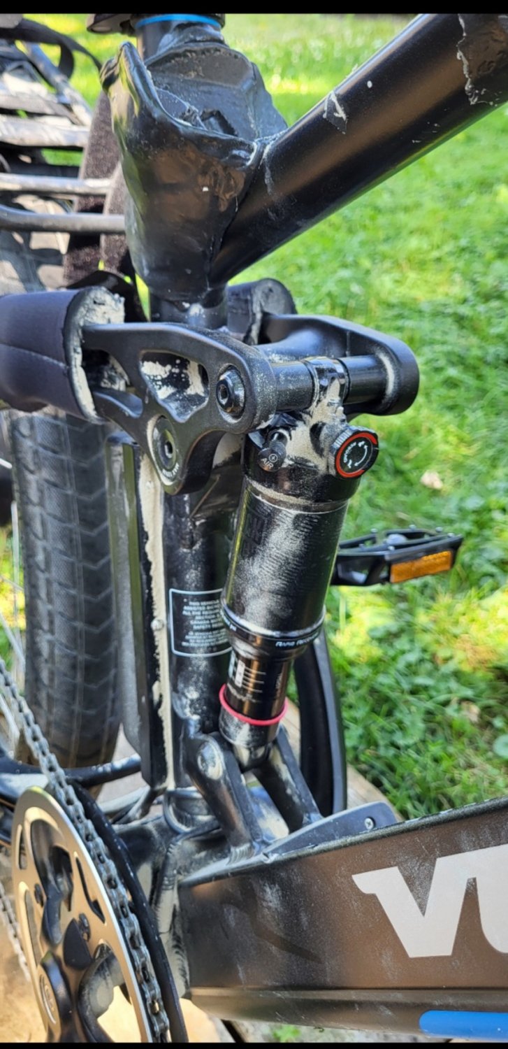

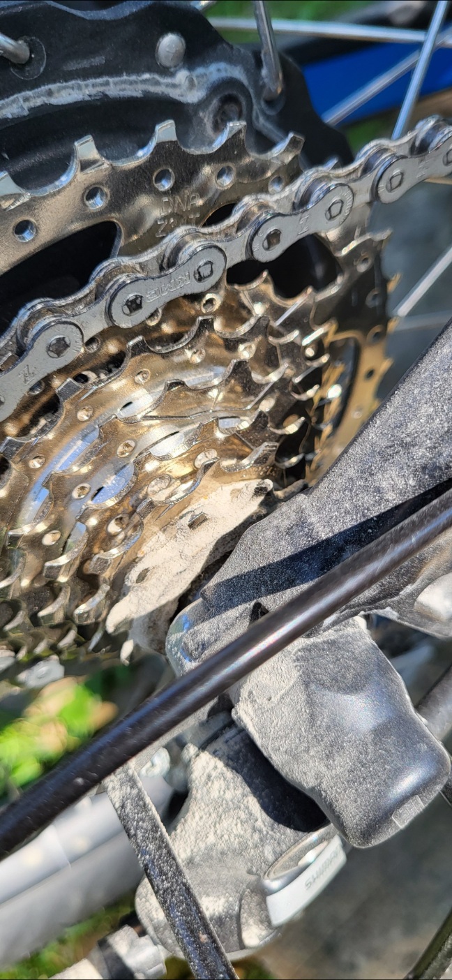

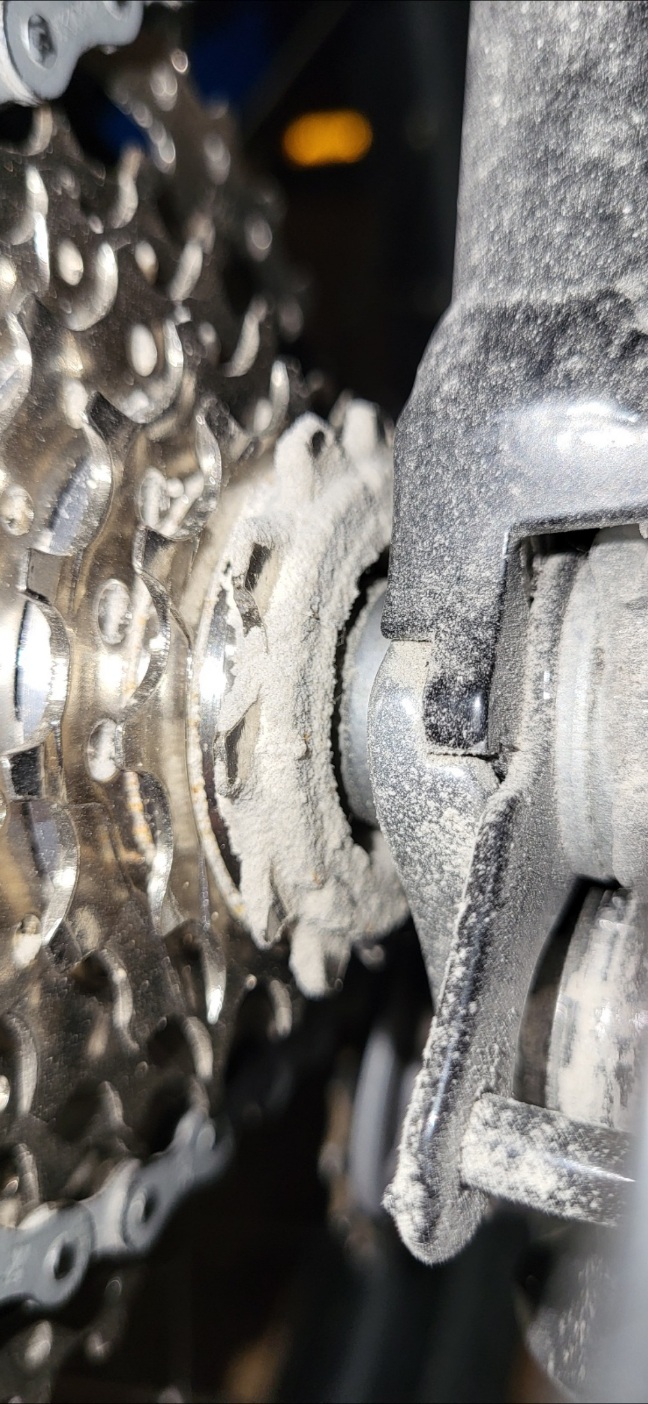

These are pictures of my e-bike before I washed it,..
Completely Covered in dust, but No Greasy Crud.
And after a simple spray with the hose (with no soap),..
Even the derailleur works better without all the buildup of tar-like grease all over the plastic cog wheels and all the moving parts of the derailleur.

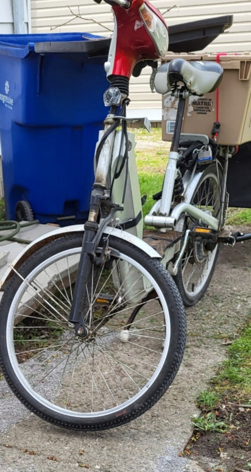

I even spent $10 for a new High End bike chain for my old POS ebike, and an hour cleaning and waxing it simply to have a clean chain, pant cuffs, and hands after I drop the chain.
Gotta love the High-End brand name SHUIMAO bike chain. 😁
My old chain was all rusted to Hell, so I greased it with chainsaw oil, but then I was getting rusty greasy oil everywhere.
Well worth the $10, and an hour or so cleaning off the packed on crud from the sprockets, chain wheel, and derailleur.
My old ebike feels Brand New !!
It even goes faster. 😁

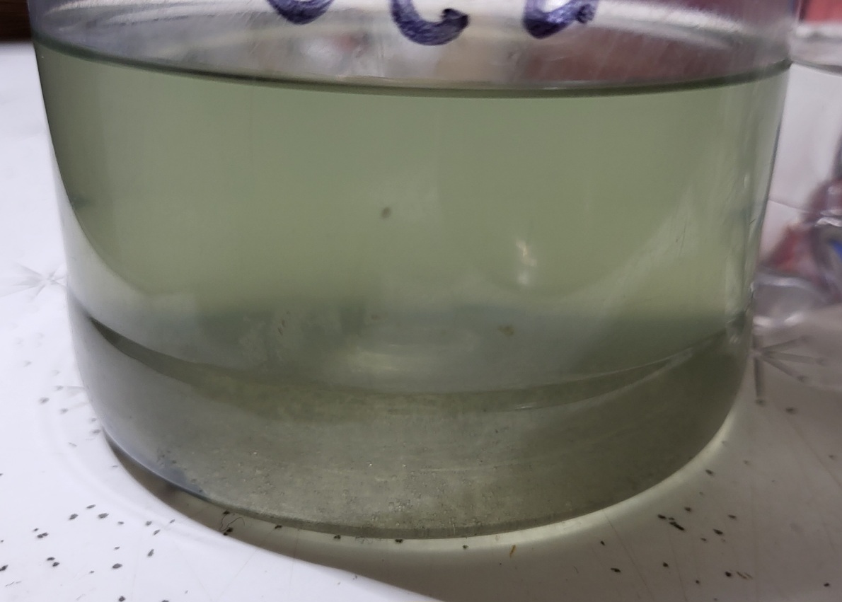

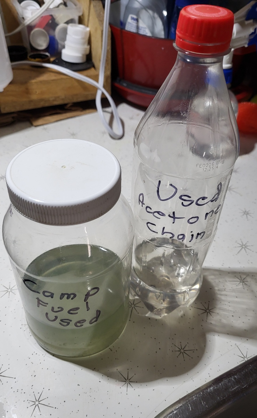

I saved the Camp Fuel (naphtha) and Acetone to use on my next chain,..
The camp fuel was clear before having the brand new chain added.
It's already starting to settle with the crud sinking to the bottom.
I'll use it a few times before filtering the crud outta it.
It's only for the first stage of a deep cleanse.
The Acetone remained Completely Clear.
It doesn't even have an oily taste to it. 😁

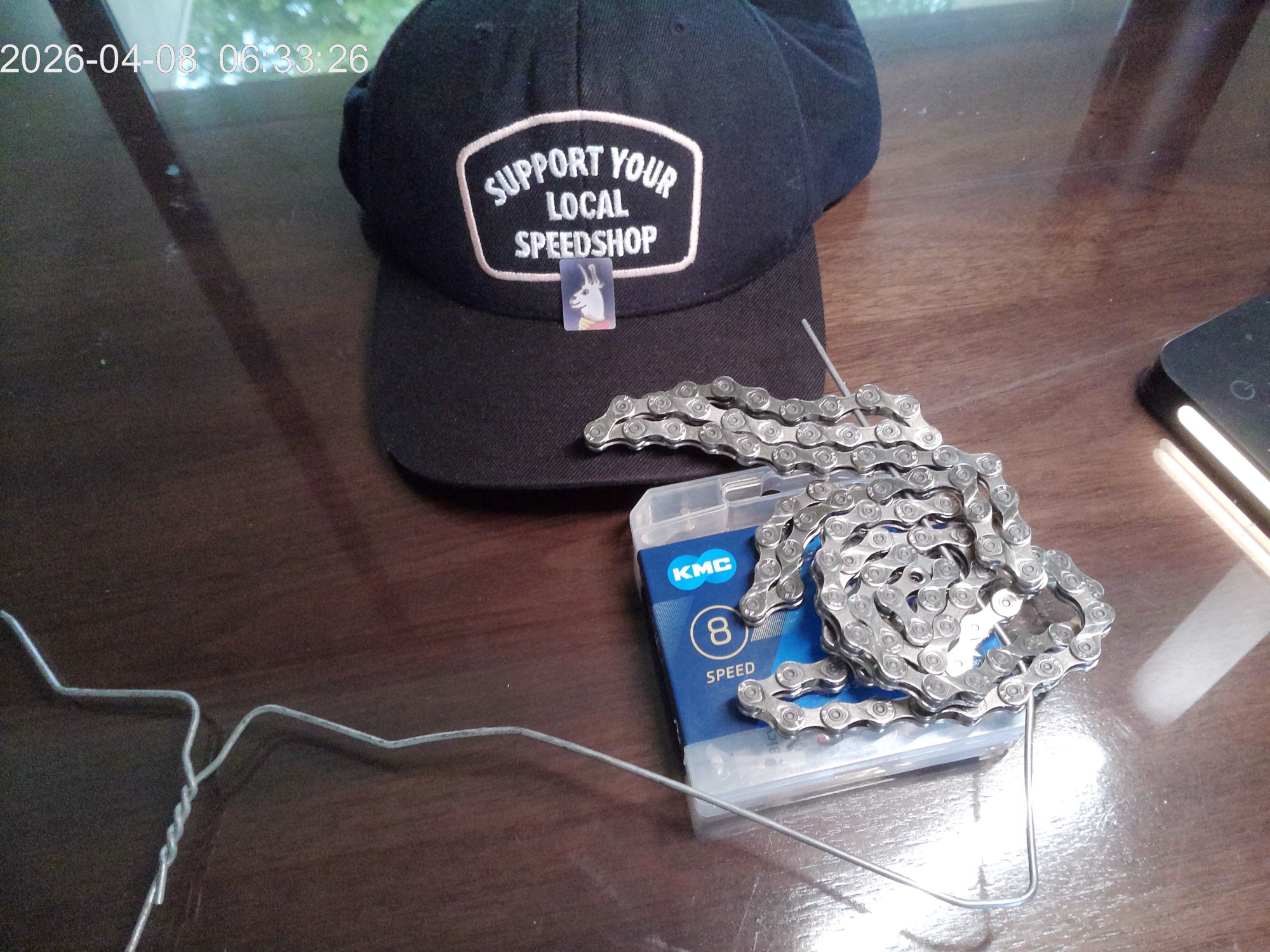

I just took off the old chain. The bike has been through a set of tires since I last replaced the chain and 11-34 freewheel. What is great is that the old chain still looks new, the drivetrain it totally clean, and handling the old chain was mess-free.
I run a piece of coat hanger through a chain at several points.
That's a good idea.
I was struggling with trying to hook in at one spot on the chain.

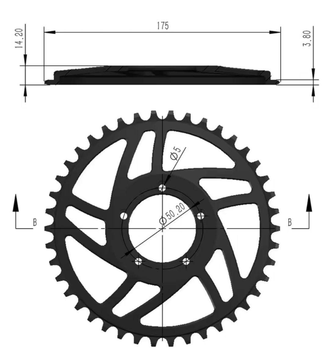

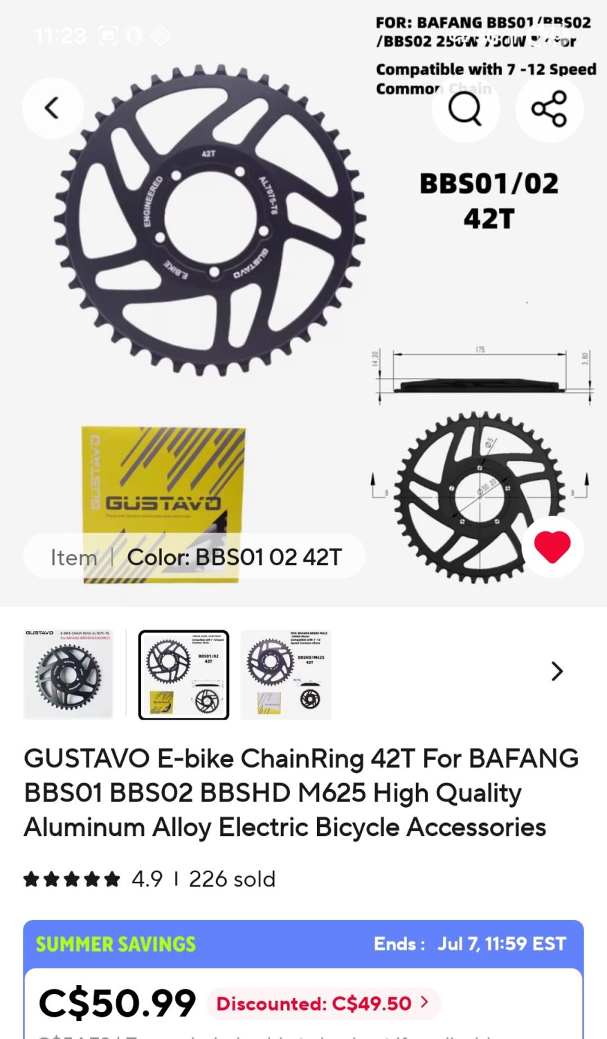

I just checked my chainring and it turns out to be a 46T.
It's the same as the original.
It was my first ebike that had the 52T chainring.
So, I decided to spend another $90 and bought a 42T chainring with a 14mm offset, and a 52T regular Bafang steel chainring, with a 6.5mm offset to stack on top of it.
I'm going to need longer bolts, but I want to make sure I get the proper hardened steel hex bolts.
I'm pretty sure that I need 5mm bolts (the chainrings are drilled for 5mm).
I'm thinking maybe brake caliper bolts would be the right choice?
I'll be able to reduce the offset of the 52T chainring by the thickness of the 42T chainring, and I can add the spacer as well.
That will give lots of clearance between the chainrings for the chain.
I just found this on AliExpress:
Bafang BBS01B BBS02B Mid Motor Chain Wheel Chainring 44T 46T 48T 52T Electric Bicycle Conversions 8FUN Parts

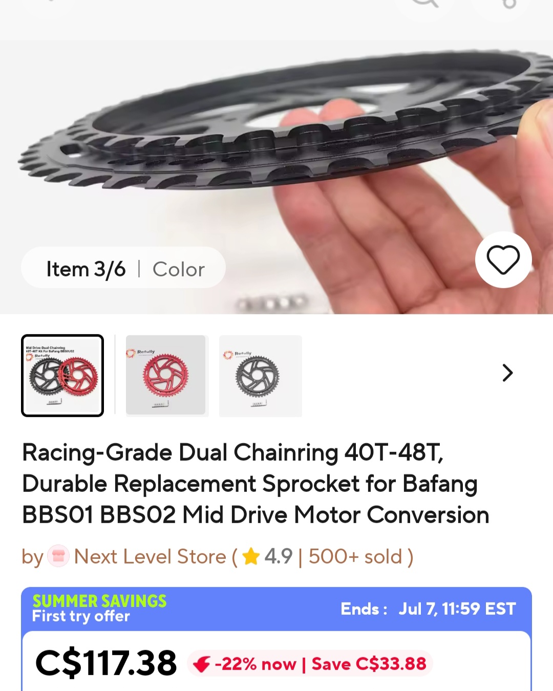

BAFANG 42T/44T/46T Chain Wheel for BBS01B BBS02B BBSHD Mid-drive Motor Chainring Sprocket Electric Bicycle Conversion Kit Parts

Then I can install its chain as the final step.
Yeah me too.
I'm still using my old chain till I get my s*it together.
I switched to a Canadian dry lube because I hated getting grime on my pants or hands.
That's why I use Squirt wax lube. Easy peasy...
Yes I had to do the deep clean first, but after that it's smooth sailing.
I probably could have just gave my new chain a good cleaning, and then used my T-9, but I've already spent over $100 on Parrafin Wax, Teflon Powder and Molybdenum Disulfide.
I really don't think that the 5 hours I spent was a waste of time and effort, and I Really Doubt that my new chain would have been better off Without my treatment and simply waxing each link with the T-9 instead.
But we'll never know.
I lack all kinds of empirical evidence for those that need that kinda s*it.
