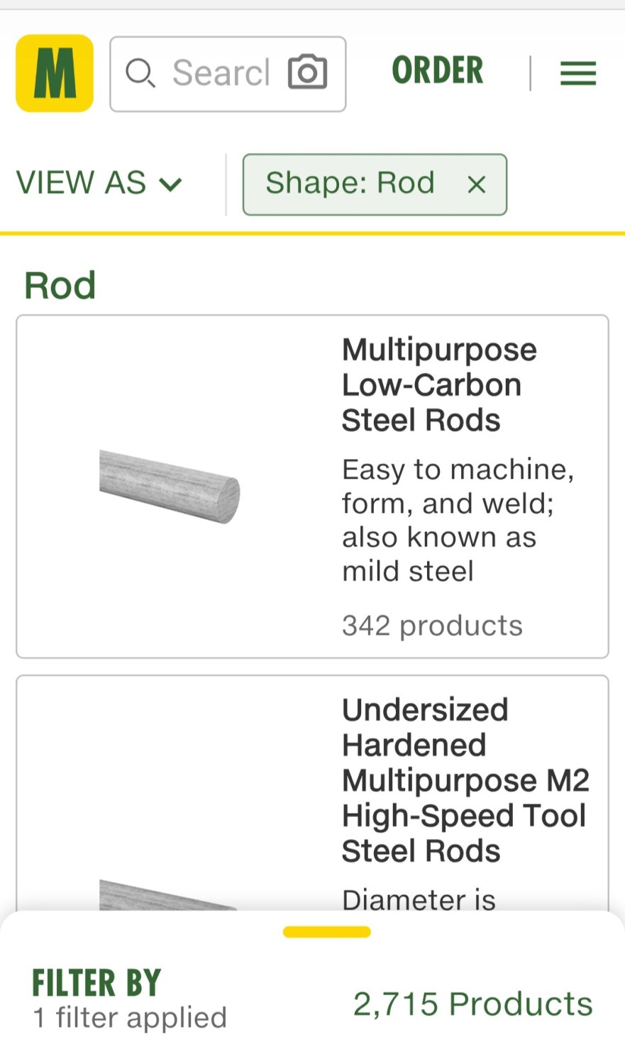

I finally took my ebike for a test ride.
For your perviewing pleasure, click the about steel at the top and make a choice.
Yeah, I already did that.
I counted 66 types of steel rod to research.
That's too much homework. 😁

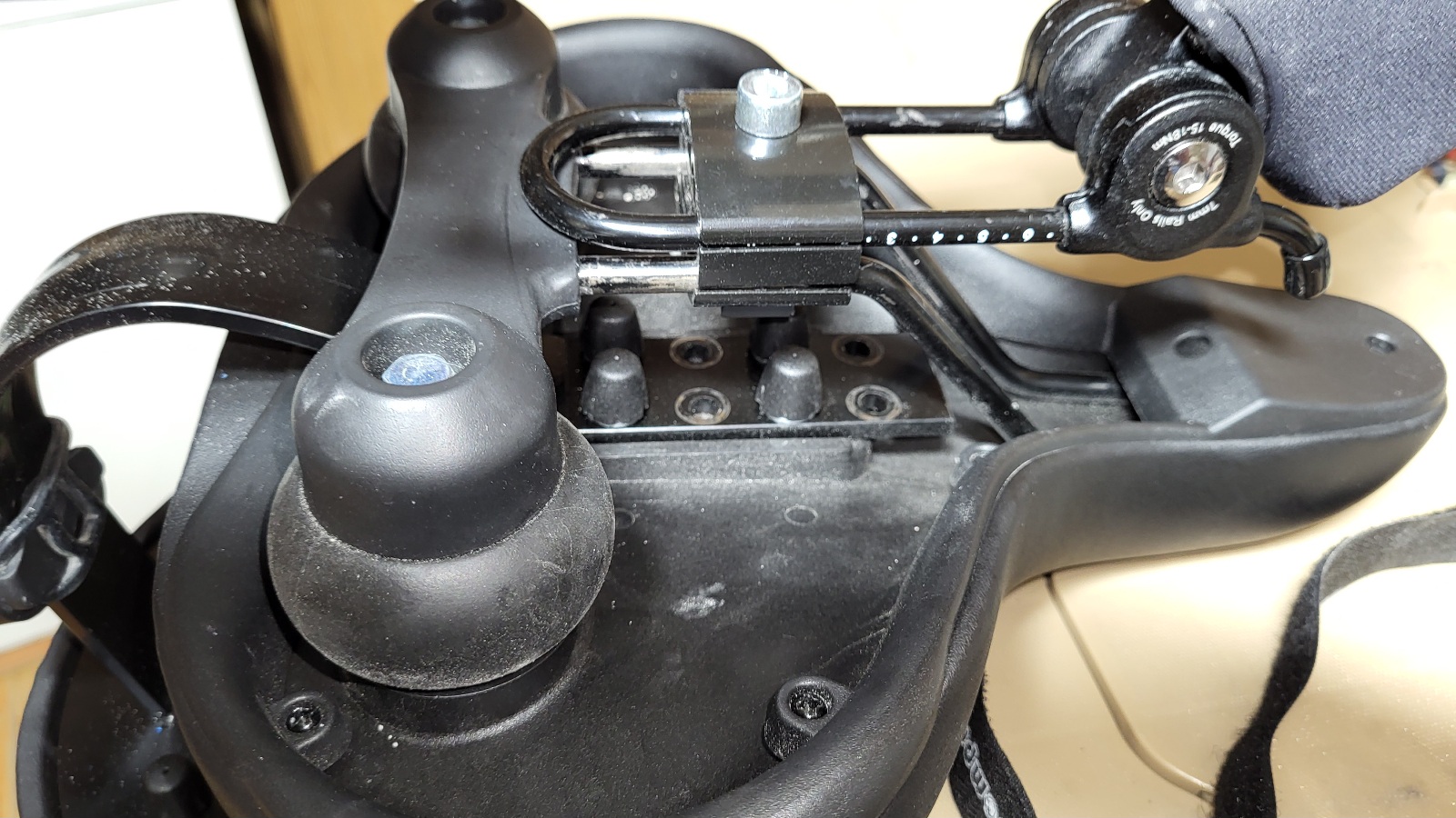

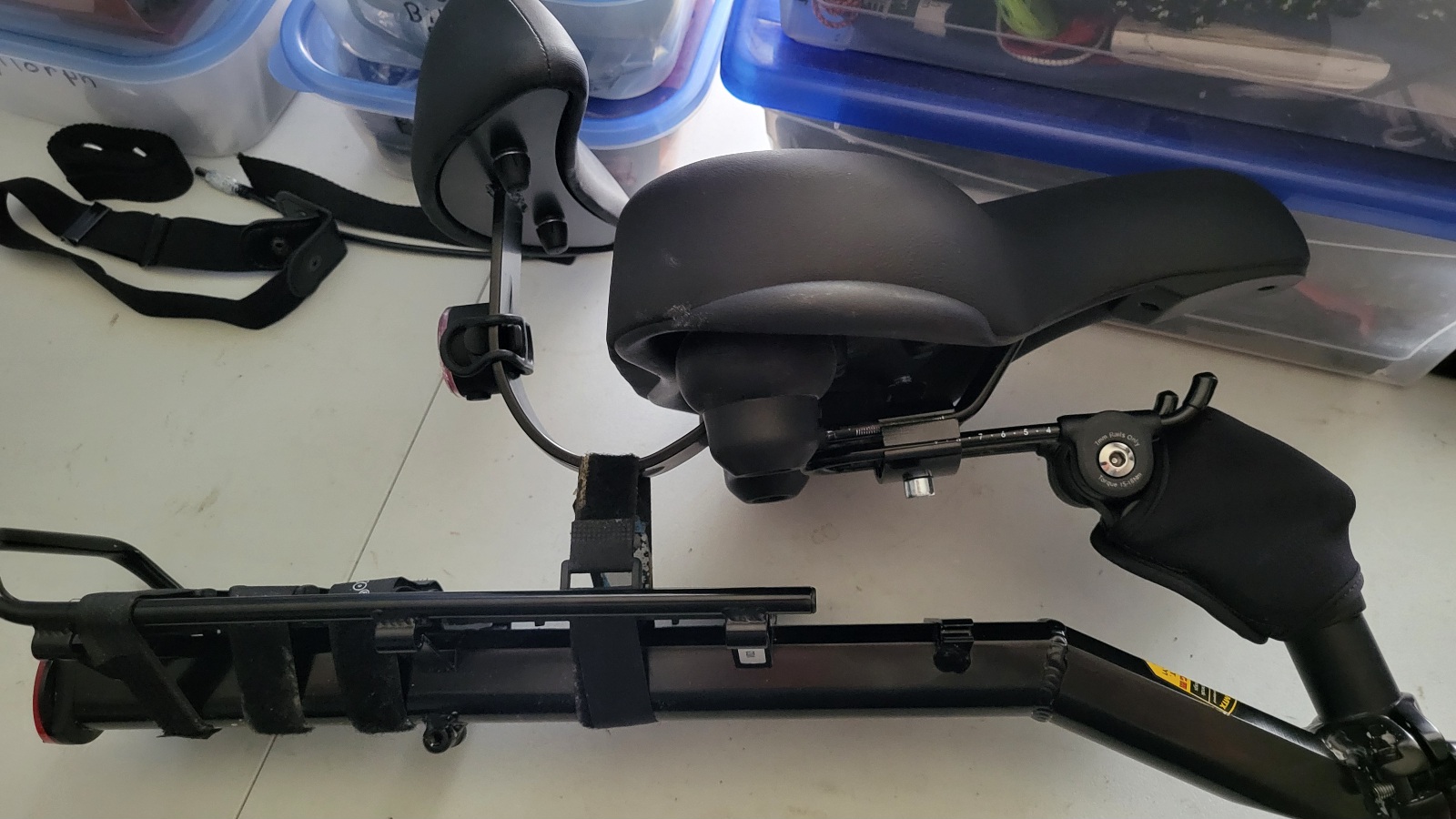

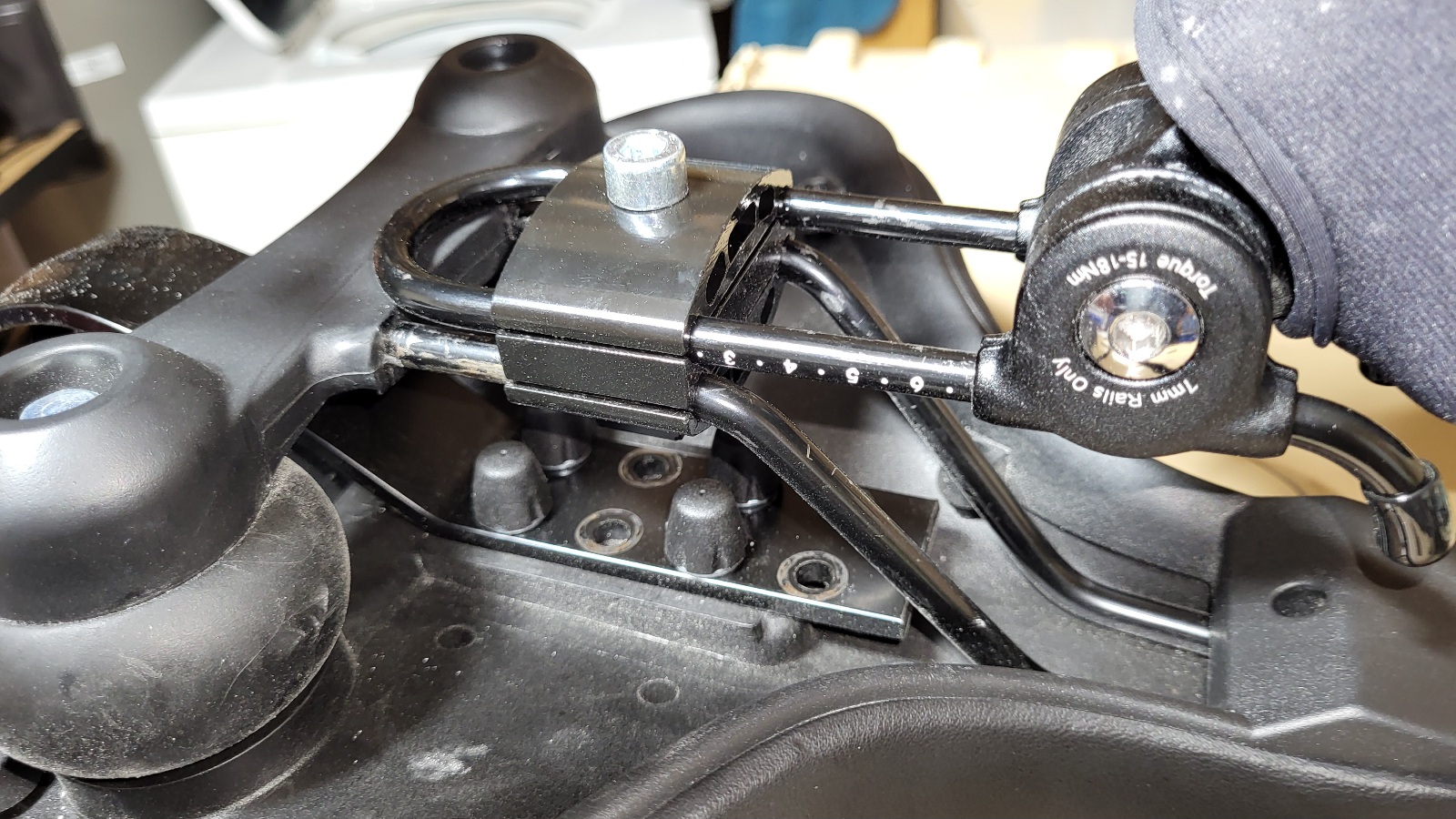

This is what my seat looks like with the spring released and the backrest tied down a bit,..
When I'm riding I've got about an inch of space between the backrest bracket and the rack.
The backrest bracket is attached to the plastic underside of the seat, and not the seat rails.
The whole plastic underside of the seat is bending when I push back on the backrest.
It does work though, and the plastic seems quite durable, but I wonder how long it's going to last??
I moved the backrest forward a notch in the bolt holes, and that helps a bit, and I moved the double bracket forward to not be using as much of the spring steel length.

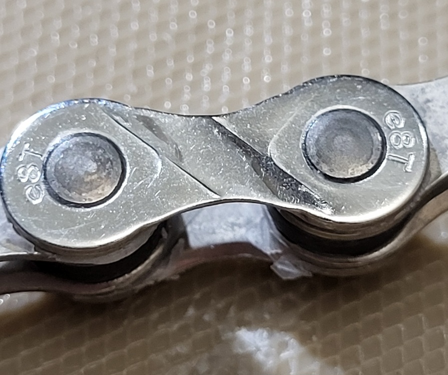

I'm going to answer this post of yours here where I can post LOTS of pictures to waste everybody's bandwidth. 😁

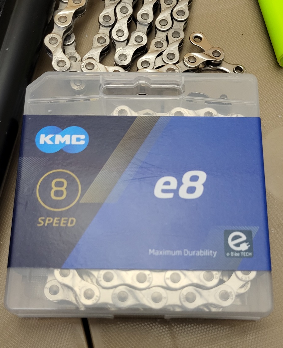

"There are plenty of fakes on these Chinese marketplaces. Do you know how to tell the difference? You should."
No, I didn't know how, so I checked out a few YouTube videos.
My packaging looks good with the proper font on the "S" in speed. (the fake "S" is more curled)
There's no missing spaces or printing mistakes,..
The chain came with instructions were in a sealed package to keep them from getting all greasy,..
The instructions were in 16 different languages, But No Chinesium!! 😁
They even got the grammar right by spelling "other's" properly !!

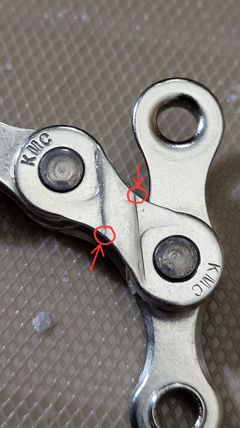

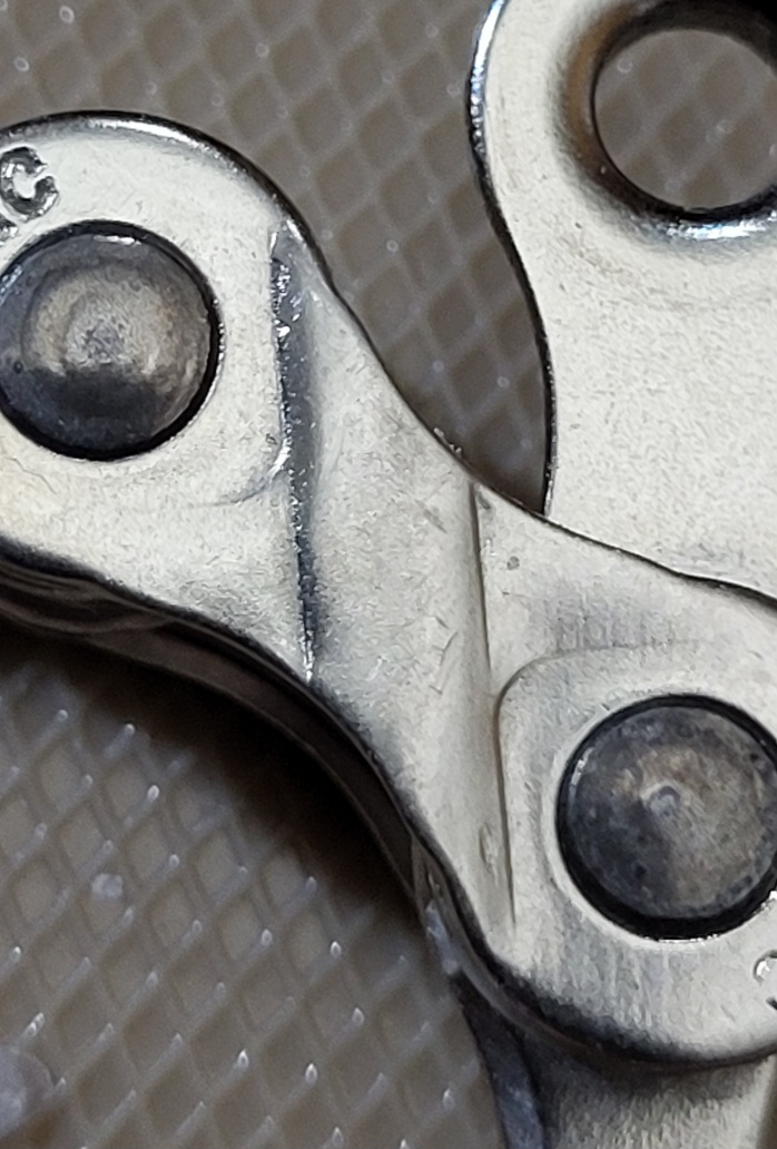

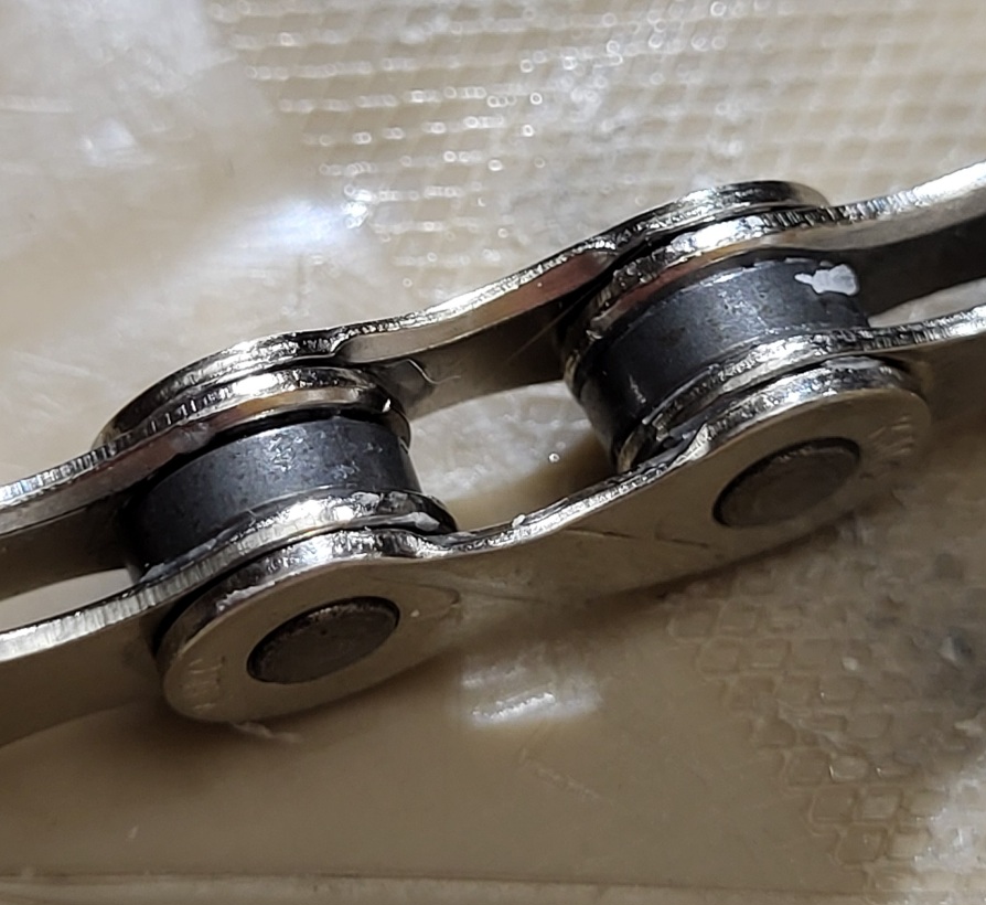

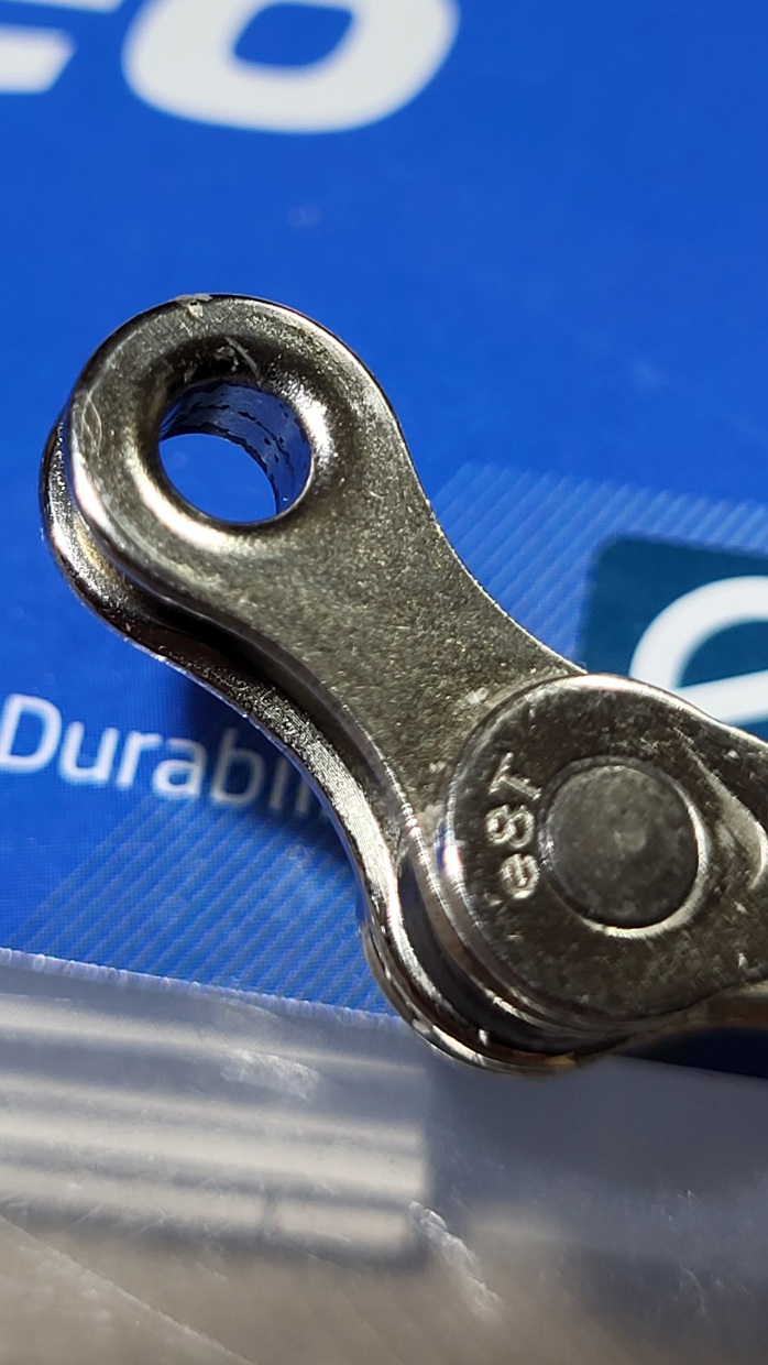

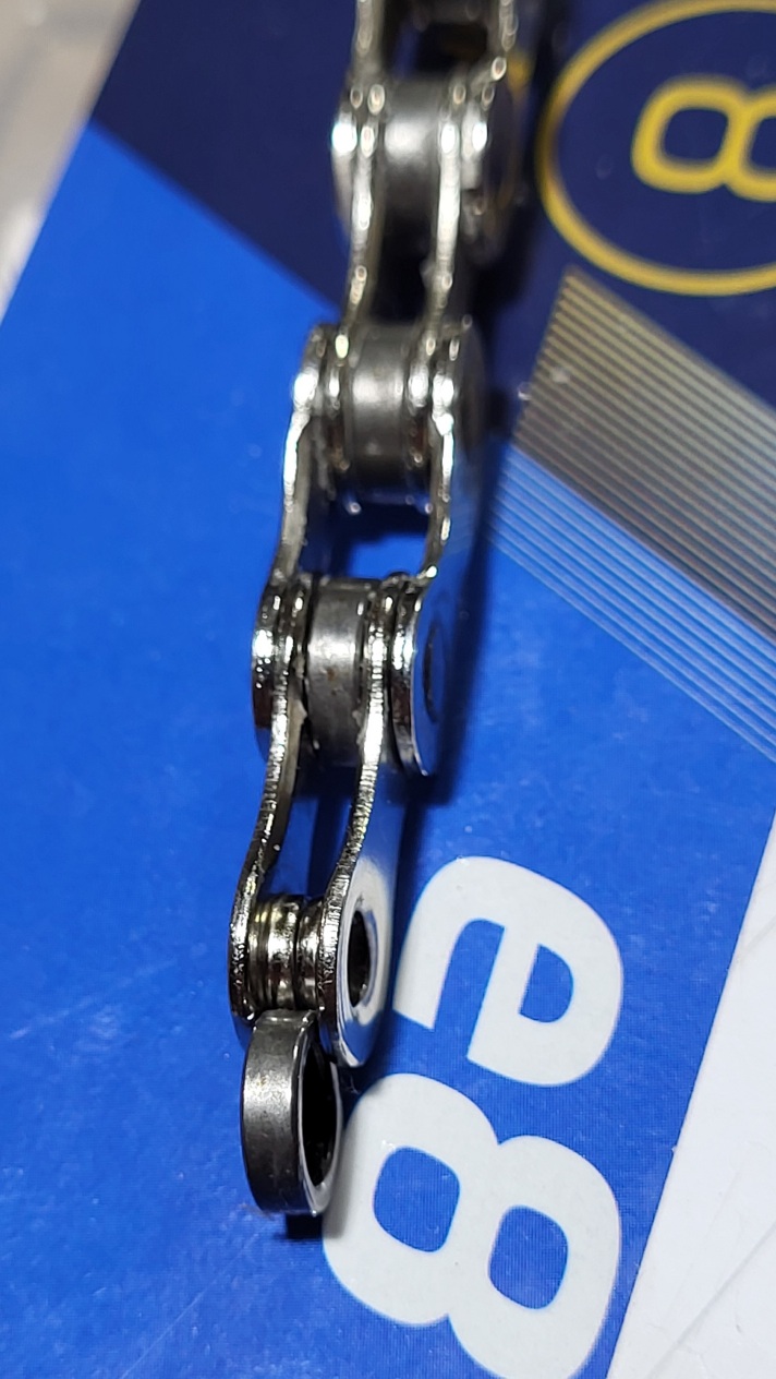

The chain itself looks good,..

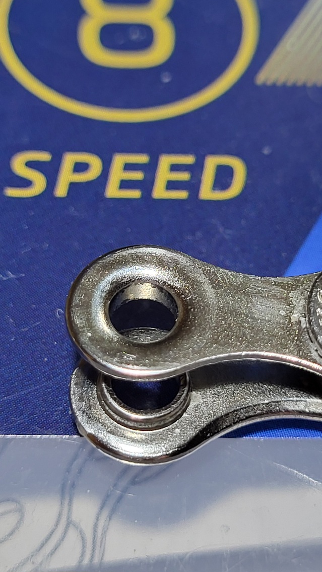

The inner and outer plates appear to be properly beveled,..
The only possible issue might be the "X" shaped stamp on the outer plates.
The stamp itself apparently isn't supposed to go all the way up to the edge of the plate.
That creates a weak spot where the plate could break.
That looks pretty damn close to the edge of the plate, but it appears to be rounded up a smidgen right before the edge??
A YouTube video showed the stamp mark Clearly not going all the way to the edge, but that was for a different model of chain.

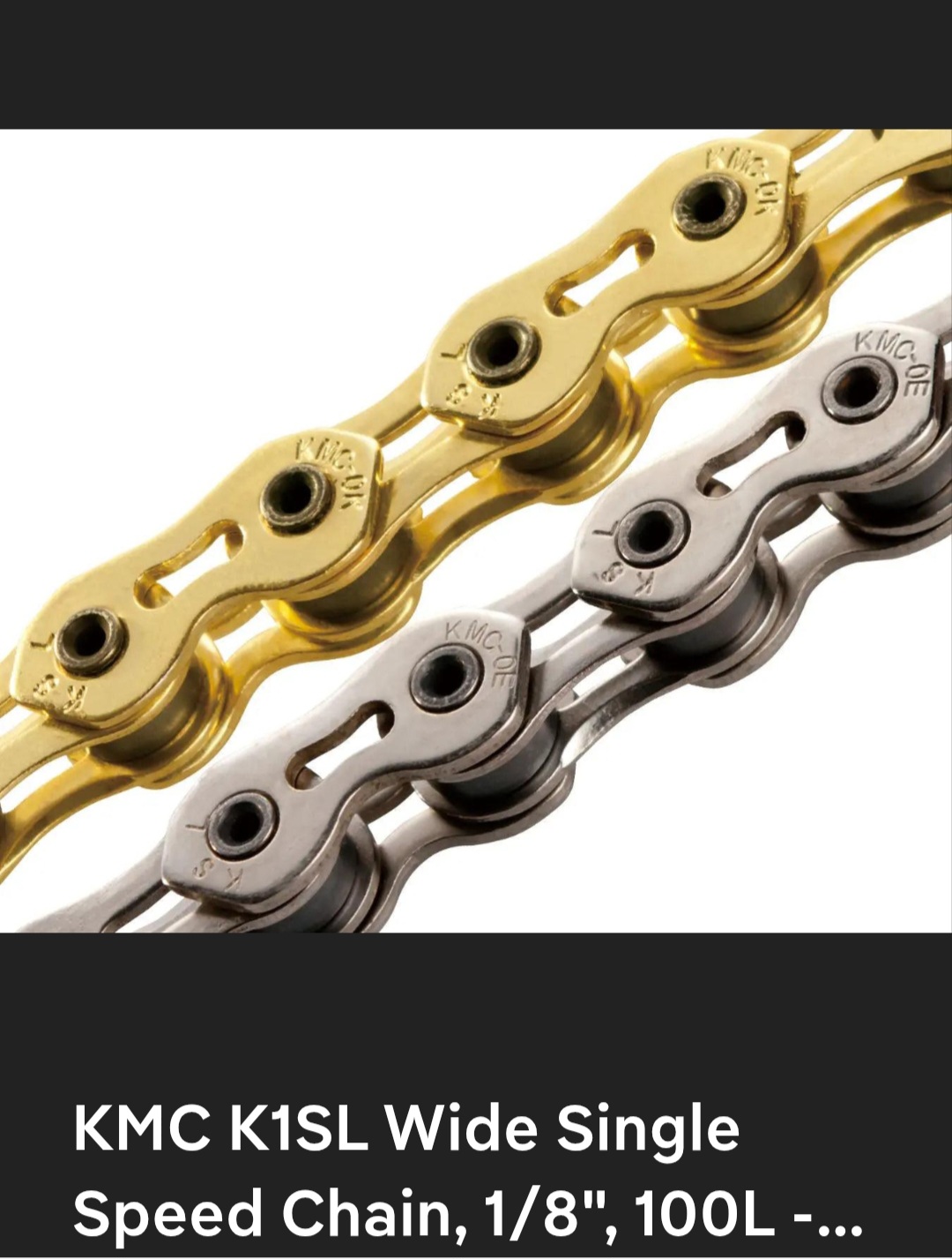

The different types of KMC chains are all built differently, so it was hard to find a specific YouTube video for an e8 chain.
The different e-series chains (e8-e12) may be built differently from each other as well? (other than just chain width.)

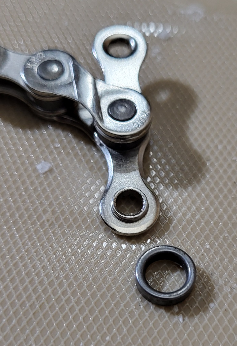

" Need to have a feel for when pin is pushed out enough without completely removing it (although the pin can be replaced if accidentally removed), "

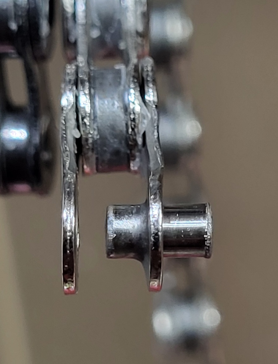

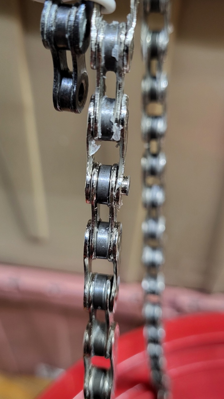

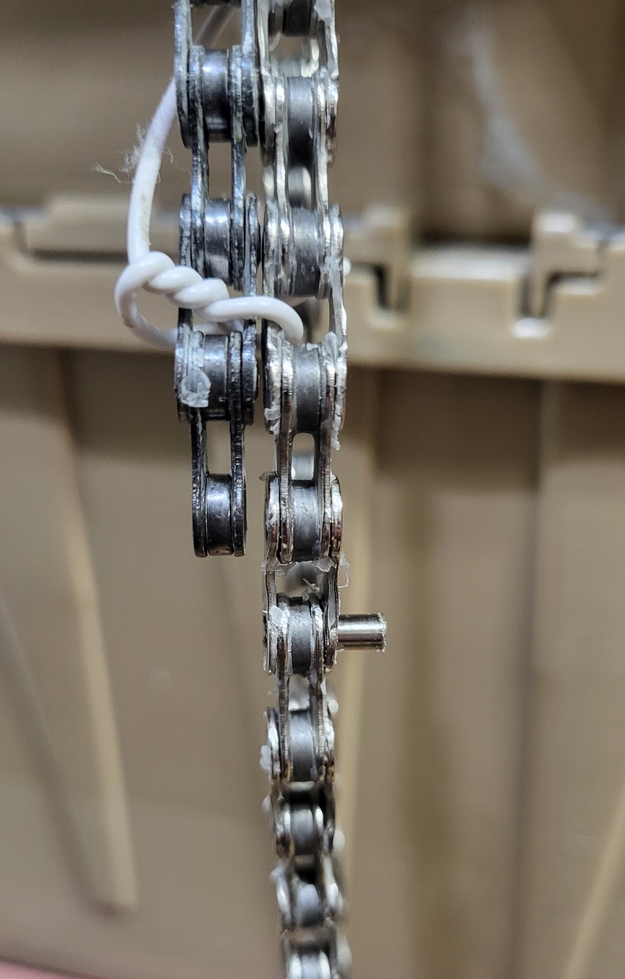

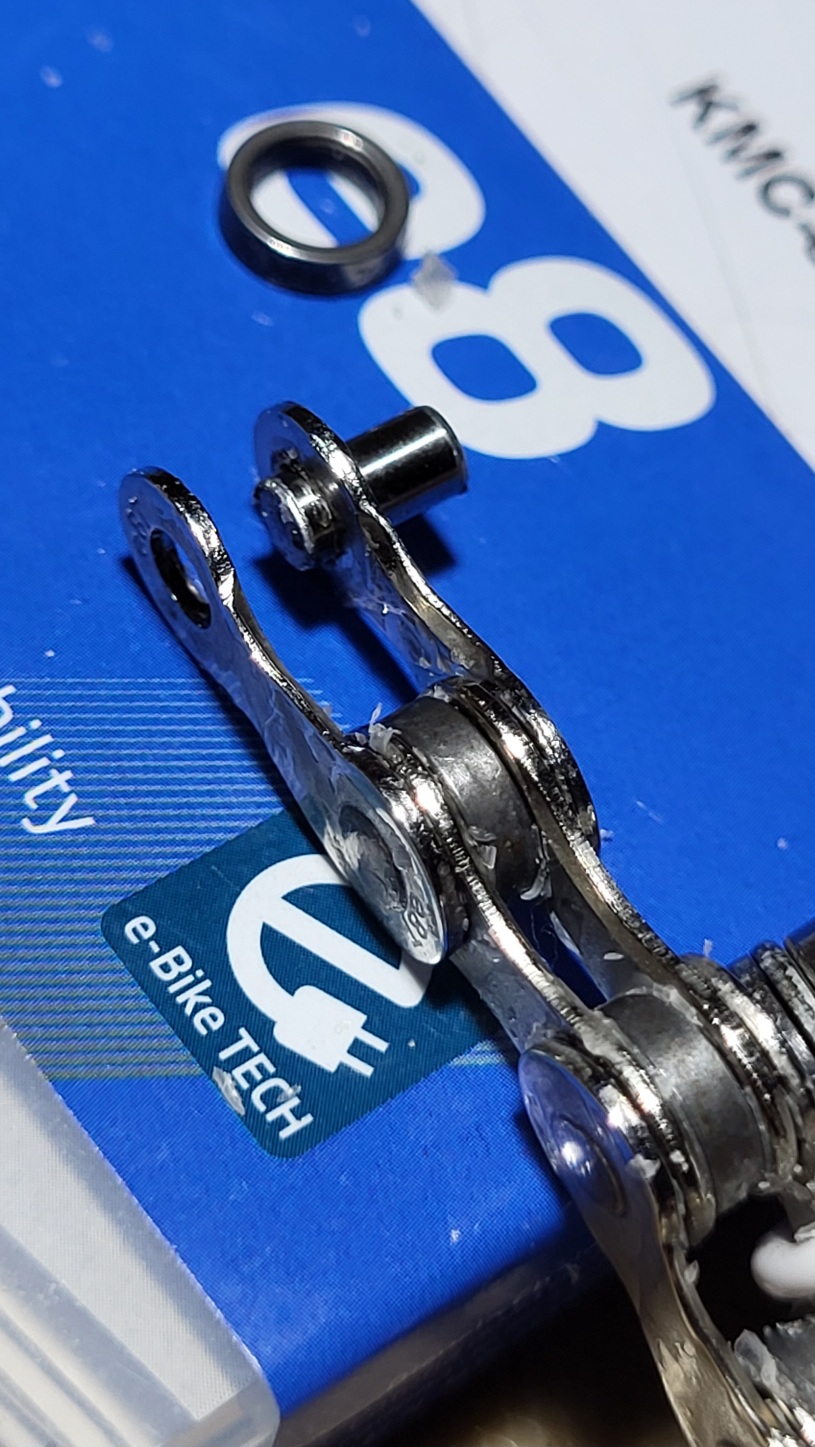

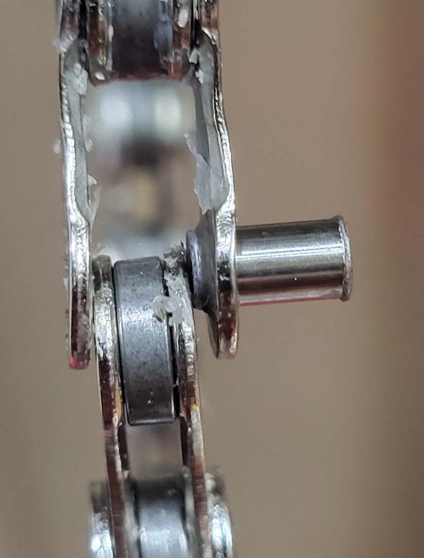

I finally got around to installing my new chain, and decided to reinstall the pin instead of using the QuickLink.
And I took some pictures to piss everyone off. 😁
I didn't bother counting the links again, and just hung the two chains on a nail and tied them together.

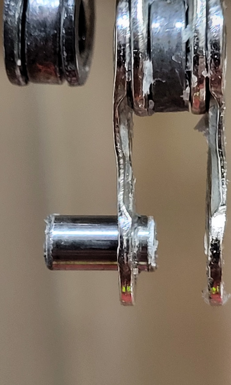

The pin appeared to have a lip on one end and beveled at the other end, so I thought it was a directional pin?
The chain was almost back together when I realized that I forgot to put it on my ebike first. 😂
Then it occured to me that maybe it's not a directional pin, and I broke the lip off when I pushed the pin out??
So I pushed the pin all way through to the other plate,..
There's definitely a lip that breaks off the pin when it's pushed out.

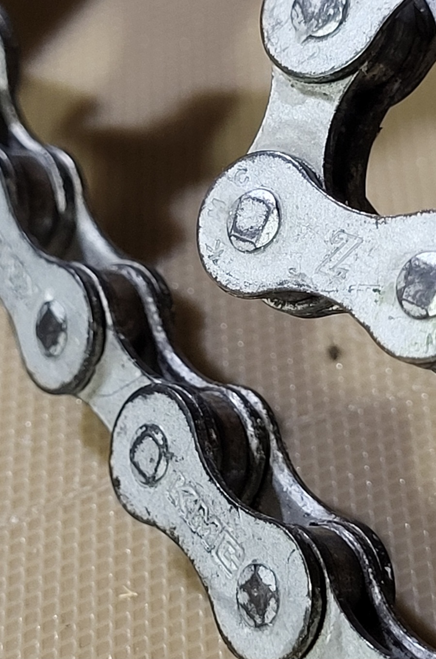

But that is my e8 chain.
My original KMC Z series chain has peened pins, that are completely different,..
There's also hollow pins on some KMC chains, as well as hollow/slotted plates,..
So I guess that it all depends on what type of KMC chain you have when it comes to reusing your pins?
My chains came with a Quick Link, so I'm just gunna use them.

All I can say is that it always works for me (fingers crossed) done on many chains and brands over several decades without a failure (so far). I do use quick links when that seems the easiest option.
You do not have to use a quick link on a KMC chain. You will have to make sure that the pin is centered on the link that you disconnected, and that the link isn't tight. If this is not the case, the chain can break.
I was more worried about the chain falling apart than breaking.
I was thinking that the pin could work it's way out of the plate since the mushroomed end is missing🤔?
But that pin is Pretty Damn Tight in that outer plate,..
I tried to rotate the outer plates on the adjacent pin, but they won't budge.
I put two pliers on the plates and tried to twist them and it wasn't gunna happen (partly because the plates have beveled edges and are hard to grab.)
I'm still probably gunna use the provided Missing Link even though it's a non-reusable version?
I remove the chain every year for a cleaning and rewaxing, but I've got a couple reusable Missing Links to reconnect it afterwards.

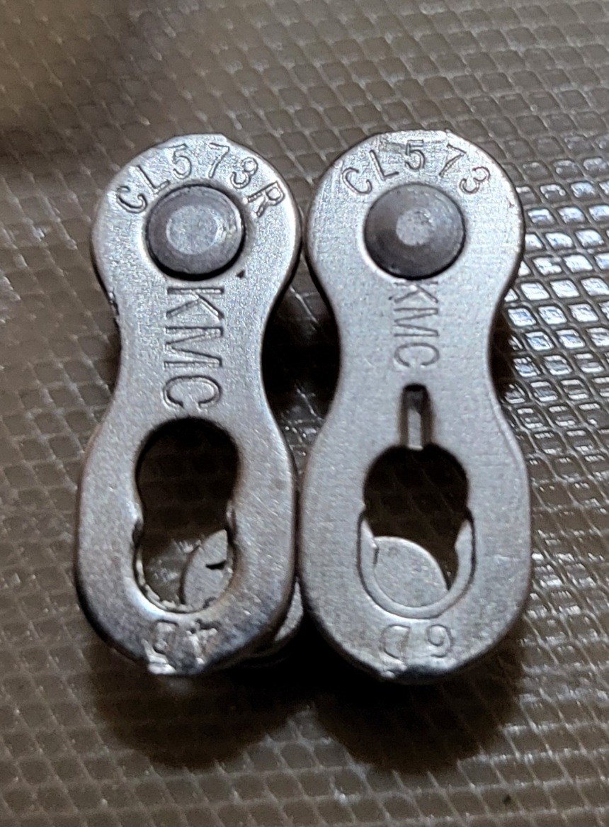

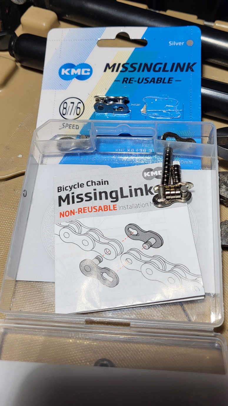

It turns out that the reusable Missing Link has the same CL573 serial number with an R added at the end.
The non-reusable link has an added dedent.
I wonder how hard it's going to be to get it apart?
I might have to break it or something?
My reusable Missing Links have been a Royal PITA to get apart.
I wonder if the non-reusable links are gunna be even worse??
I might have to use the chain breaker?

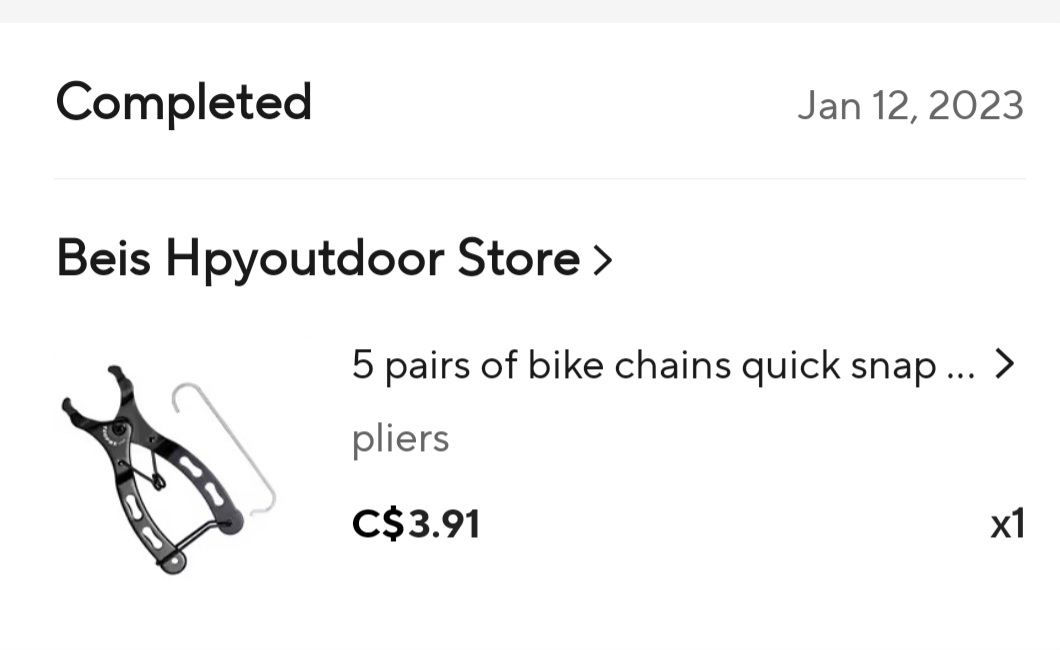

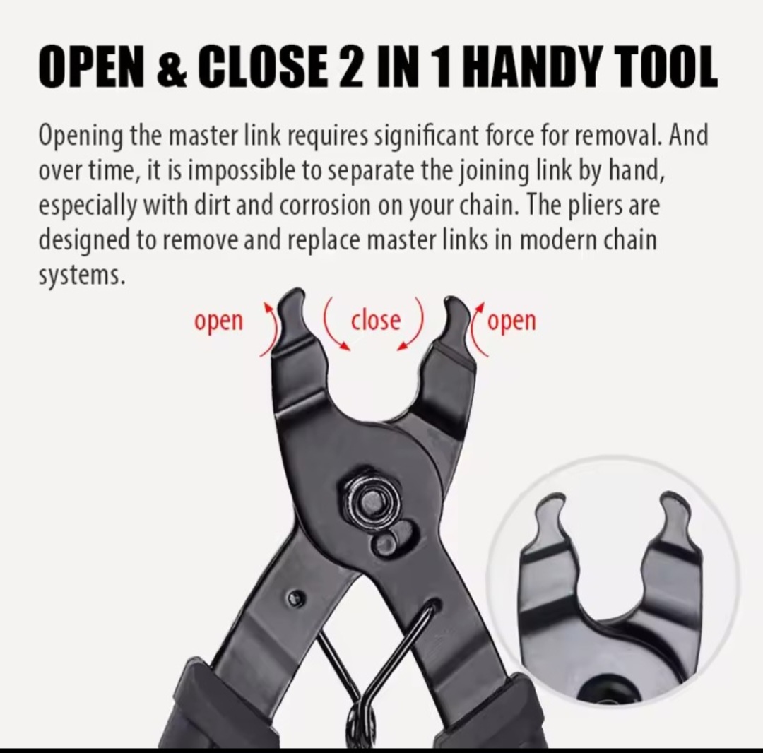

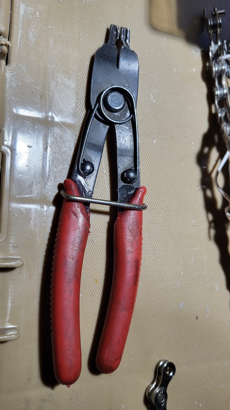

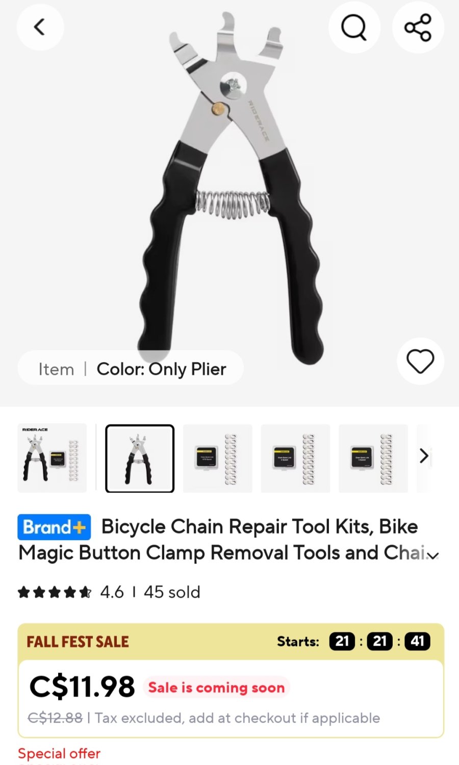

I bought a better Quick Link tool,..
I bought a crappy $4 link tool a few years ago but it's a piece of junk and it's too small.
I also made my own quick link tool that Works Great, except it's made outta crappy metal, and I bent the handles into a pretzel shape when I tried to remove the "removeable" KMC Missing Link.
(I bent the handles back straight again for the picture, and had to use my adjustable pliers to remove the link.)
The new one is supposed to be "Certified Brand +" and it's apparently "Chrome Vanadium Steel" so I won't be bending the handles.
This is what was said about removing quick links for a different quick link tool.
They're not kidding about how hard a used quick link is to remove.

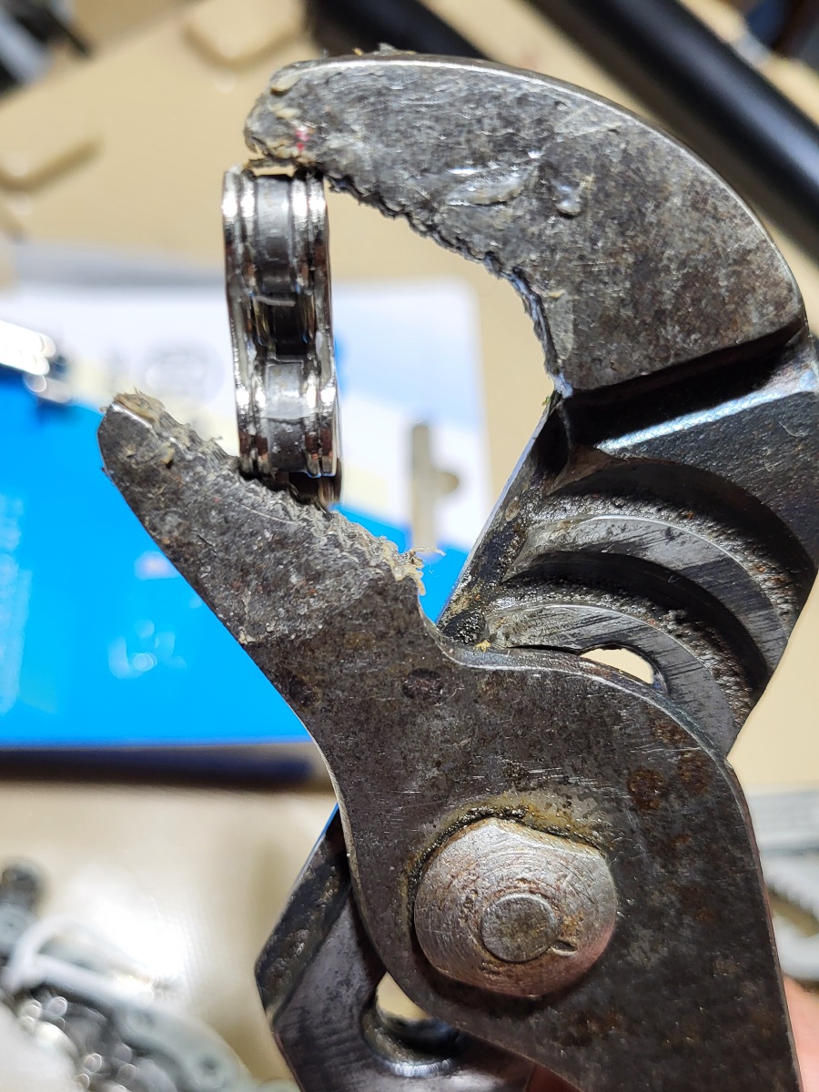

This is the only way to open a quick link after you bend the handles of your two dollar tool.😁
You've gotta squeeze the link together diagonally on the corners.
Even with the 10" channel lock pliers, I had to squeeze the handles Pretty Damn Hard to pop it open.

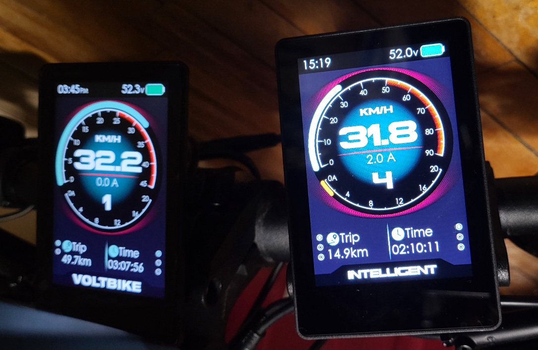

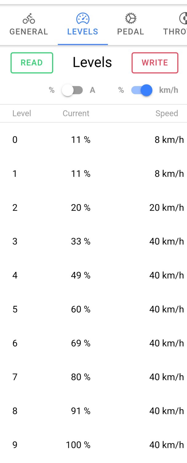

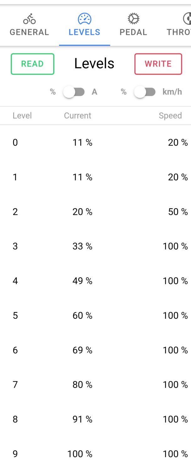

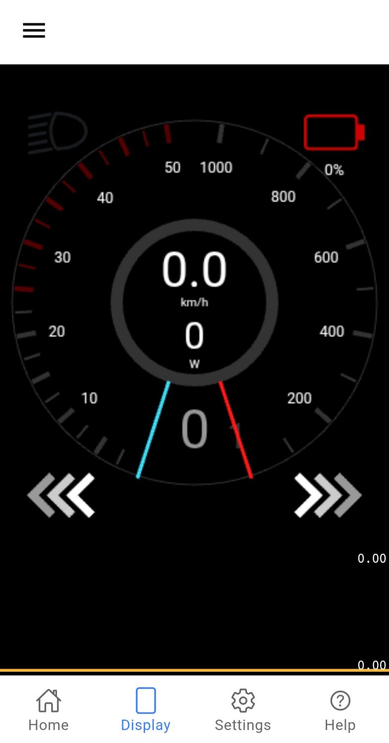

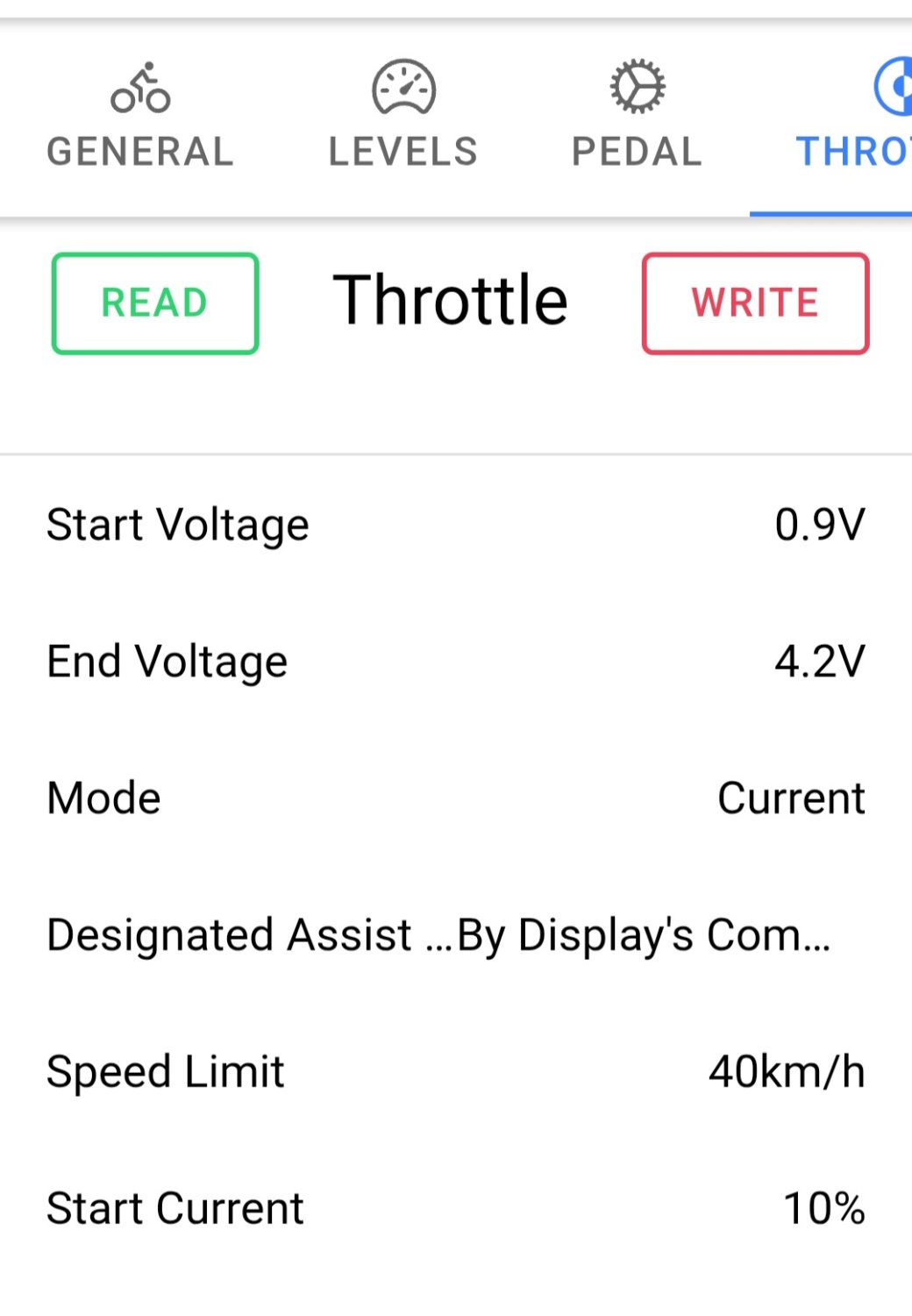

My speedometer is messed up Real Good. 😁
I don't know what's goin on ??

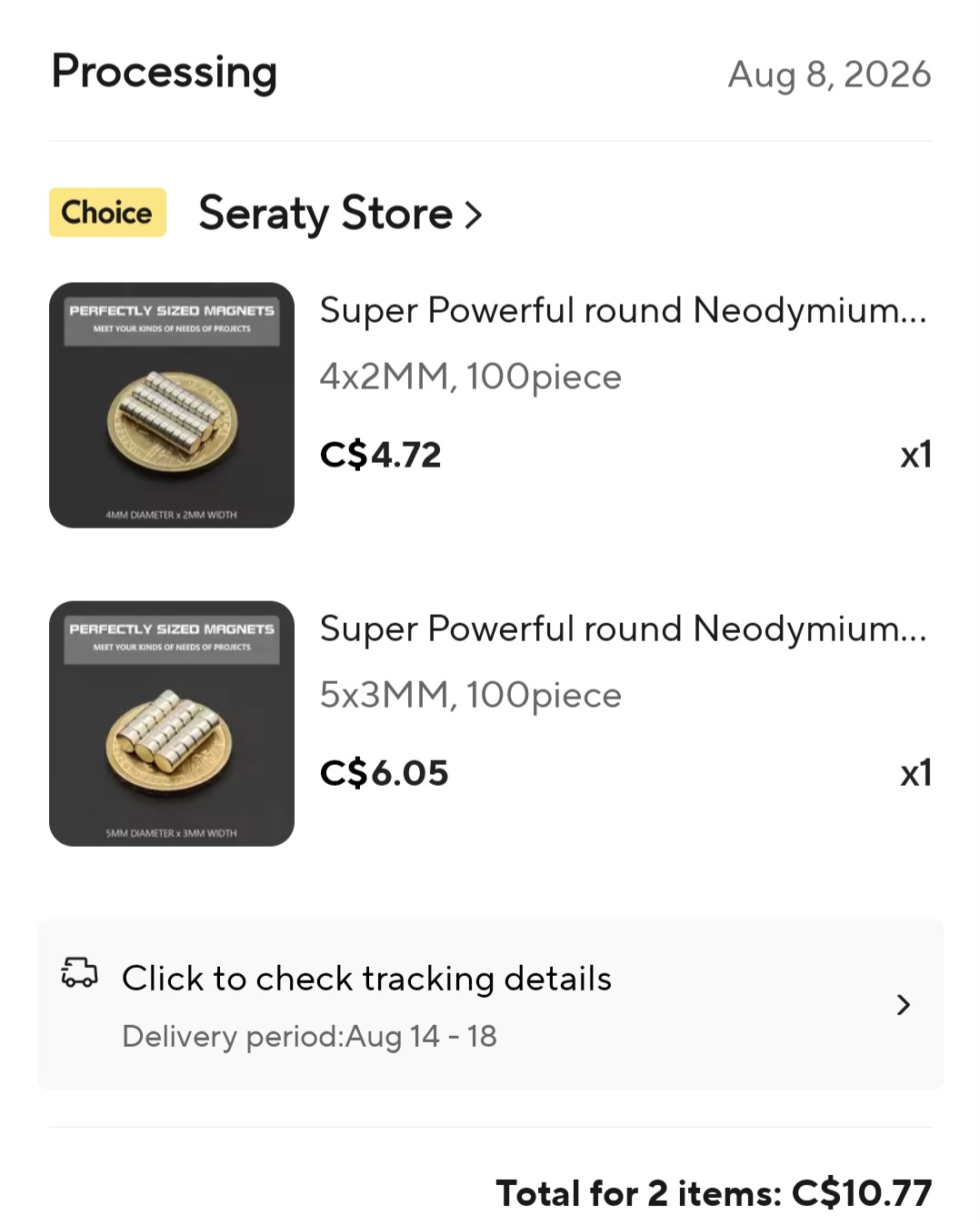

I Got My Speedometer Figured Out !!!

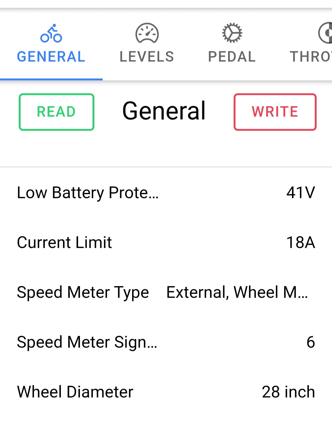

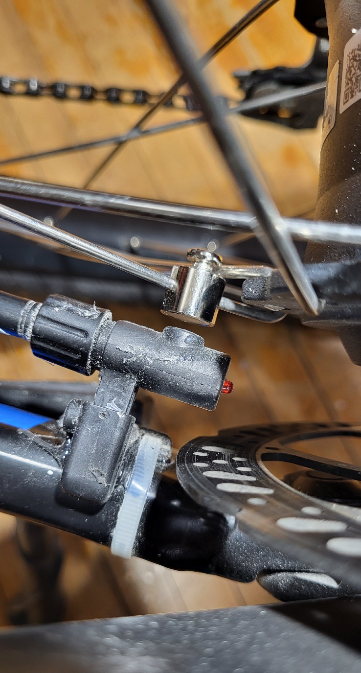

My speedometer is all messed up again. 🤪 😁

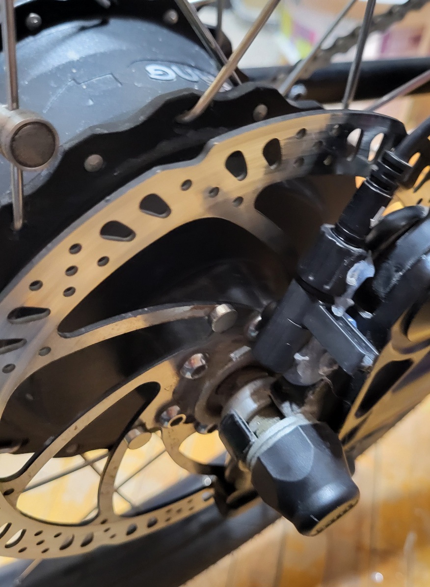

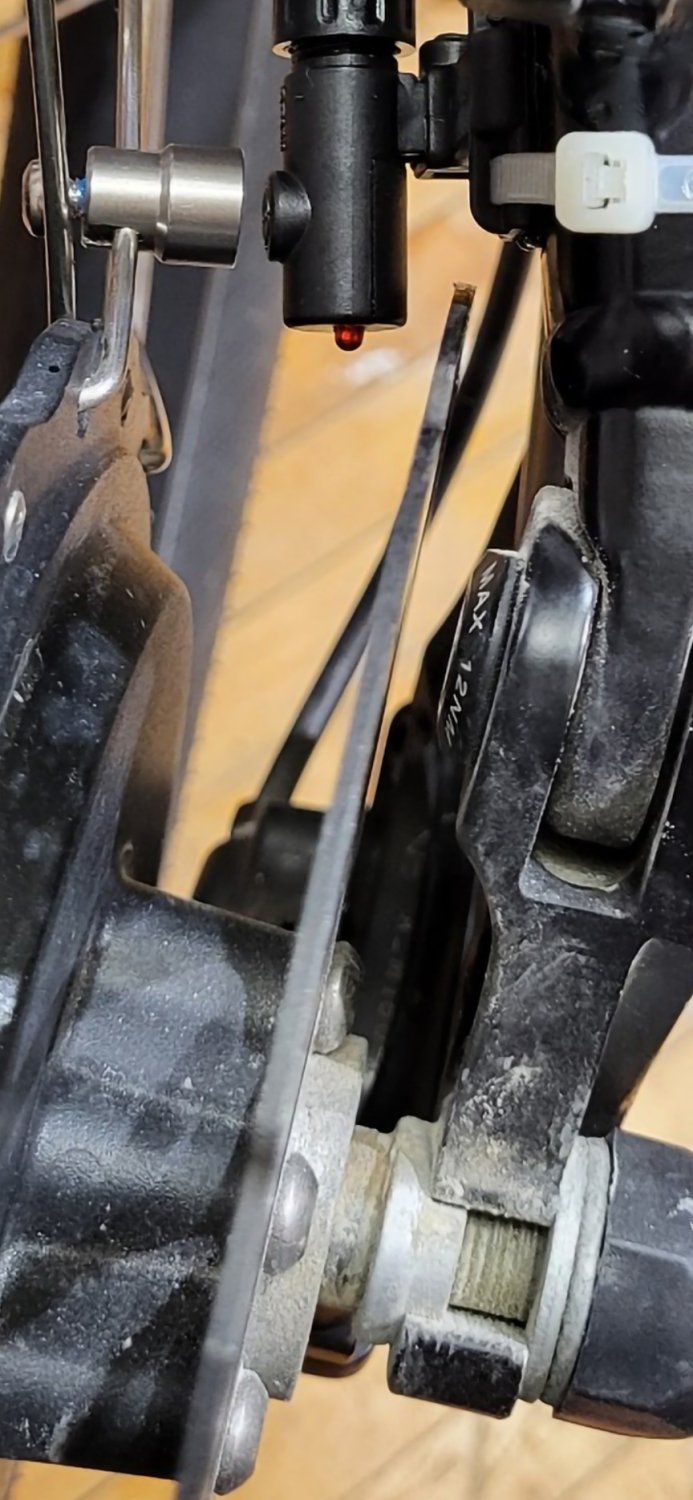

I couldn't seem to get the "cruise control" to work without surging, and the speed kept bouncing around all over the place.
When I got home, I checked my speed sensor by spinning the wheel.
I managed to get 3 evenly spaced magnets on 3 of my spokes.
When I installed the magnets, the speed sensor would flash when each magnet passed the sensor, so 3 flashes per revolution of the wheel.
I checked the sensor again, and the first magnet made a flash.
The second magnet turned the light on, but the light stayed on until the third magnet turned it off?
WTF ??
I removed the second magnet that would leave the light on.
Then the remaining two magnets pulsed the light normally.
I thought maybe something was wrong with the magnet I removed so I installed a different magnet, and it went back to one flash then on then off again 🤔
So I gave up and now I just have one magnet and my speedometer is reading about ⅓ of my actual speed.

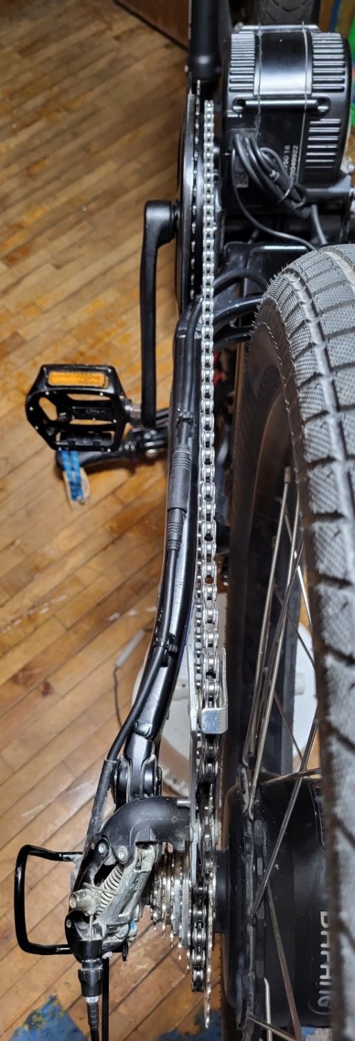

I got my new chain installed using the missing link provided.
It sounds good and shifting is fine.

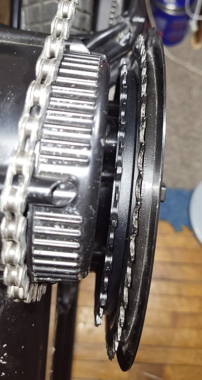

The chain is skipping a bit on the 11t cog with the 44t chain wheel but I don't need to use that gear.
It has the worse chainline with the derailleur having the most slack to deal with.
So now I can't use my 34t rear cog with my 52t chain wheel or the 11t cog with the 44t chain wheel.
In my ten speed days, I'd call what I have a fourteen speed.
In my case, 7th gear is a bit sloppy and noisy, but 8th gear would probably break something?

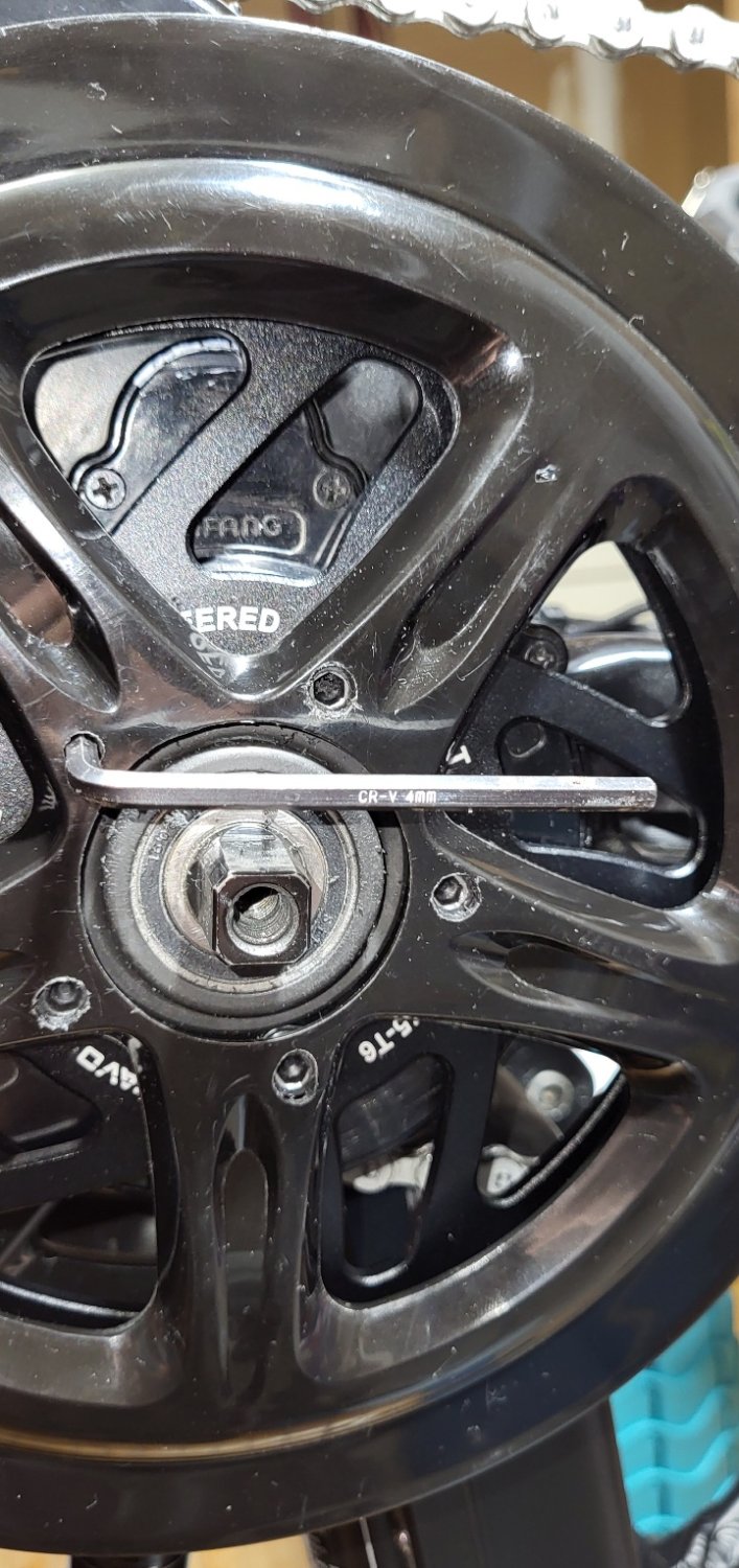

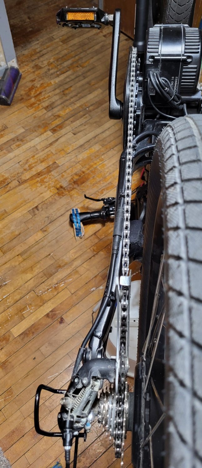

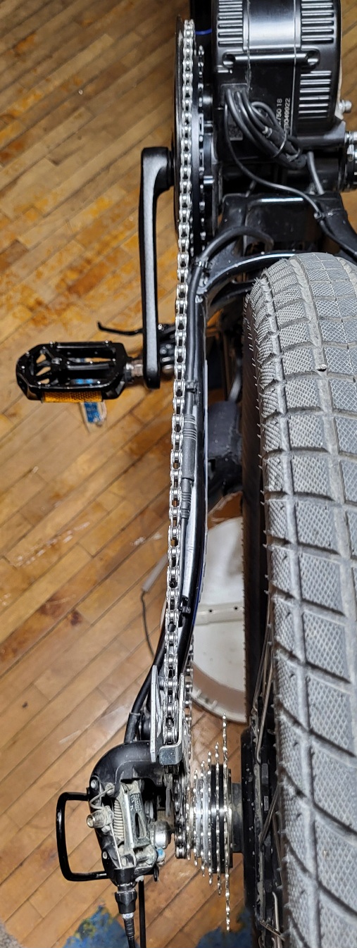

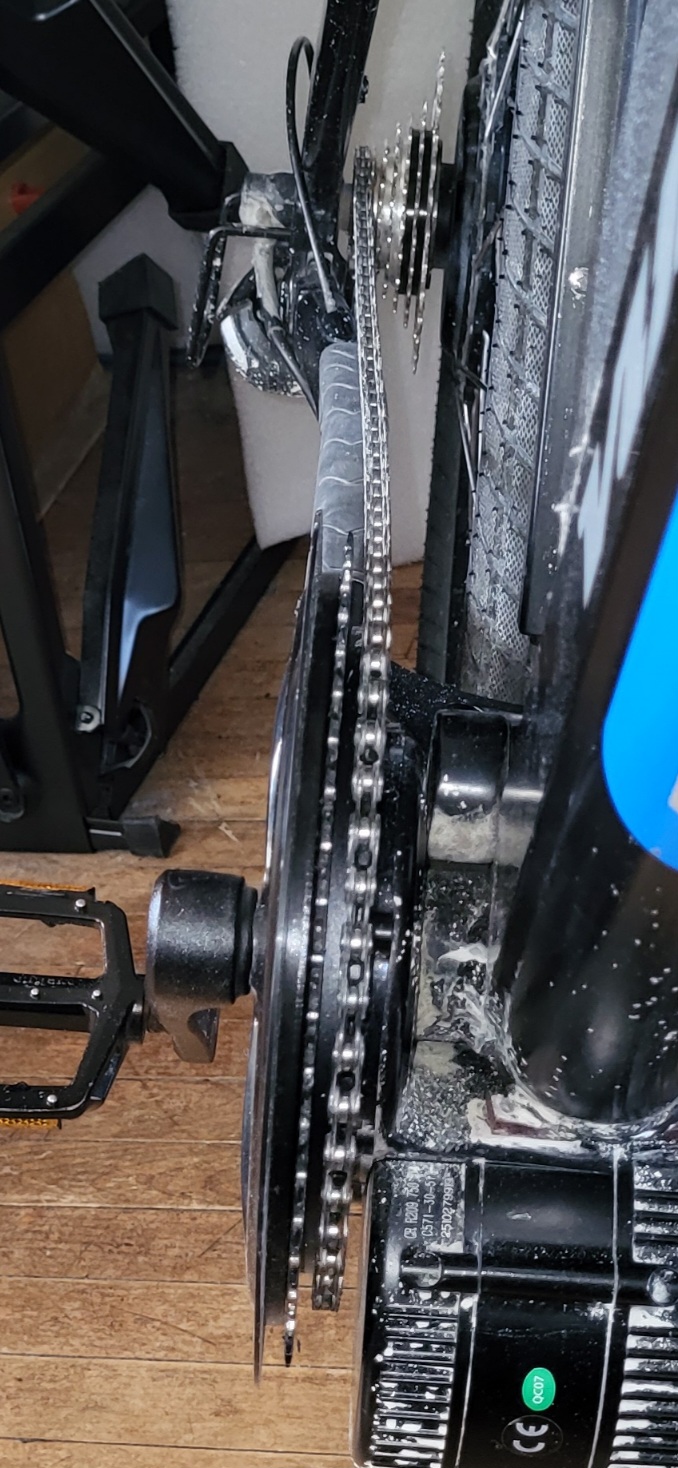

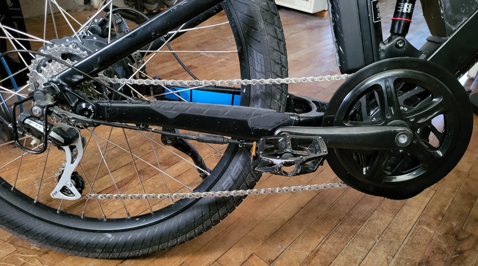

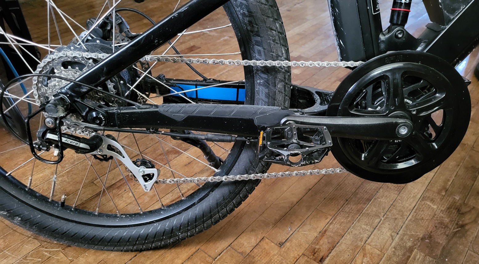

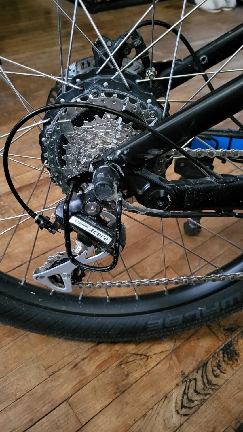

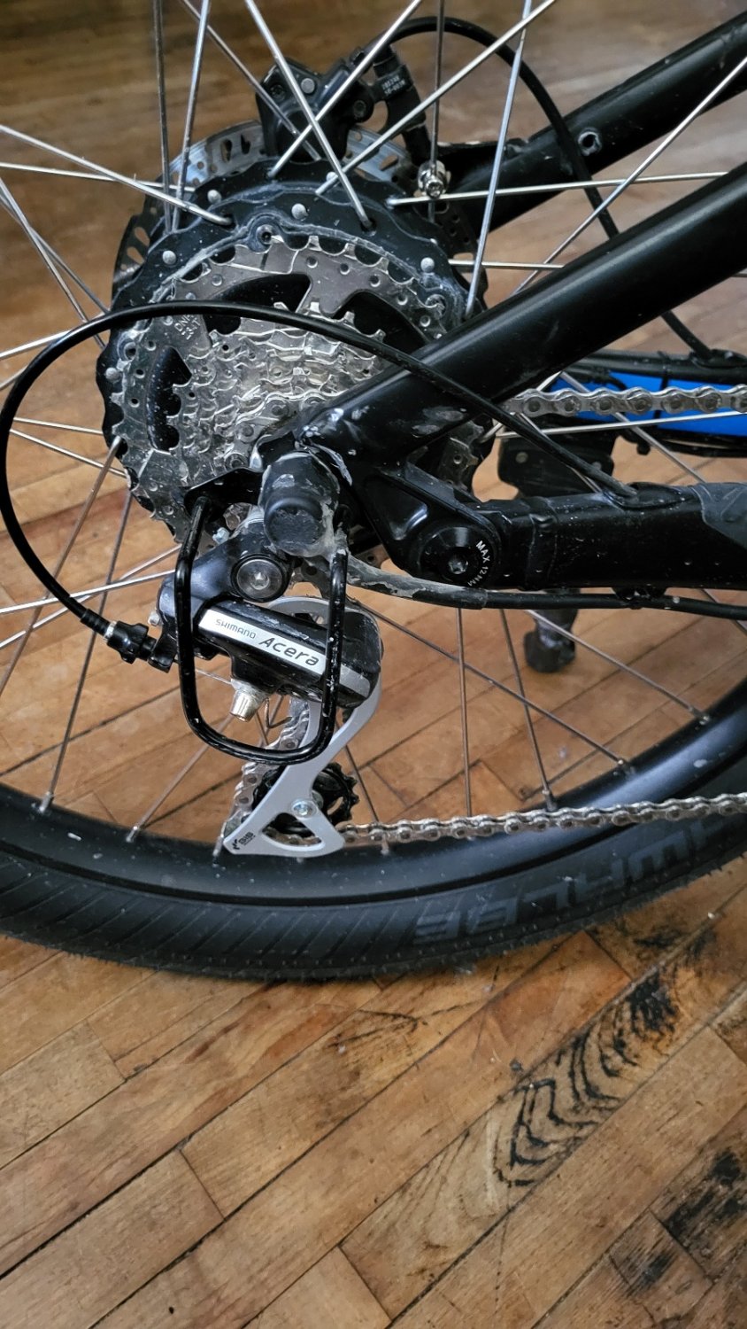

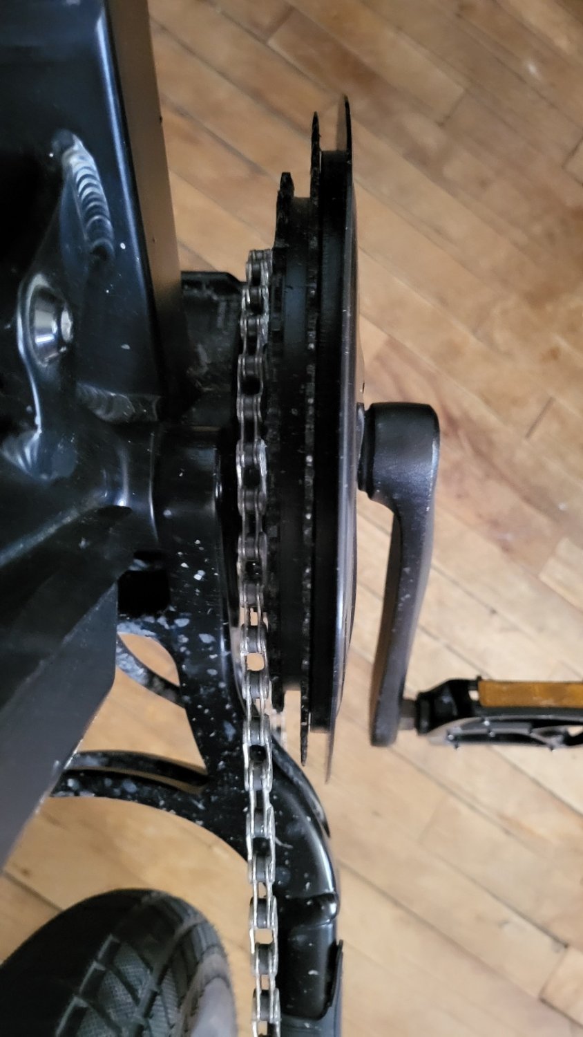

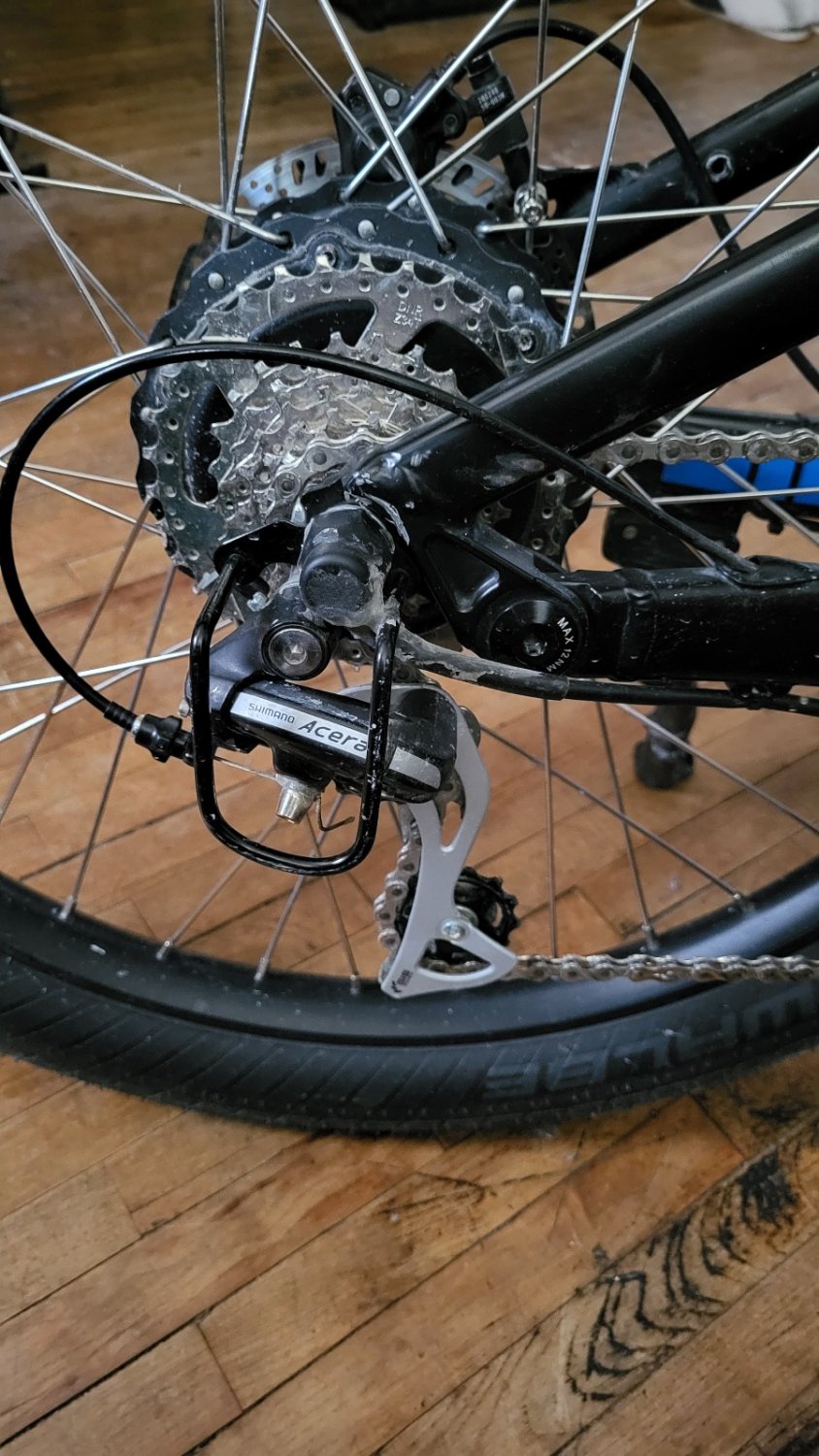

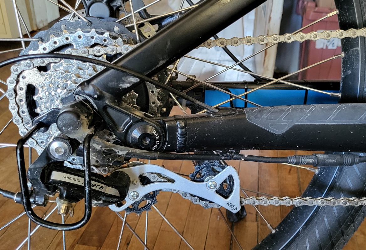

I can do for you what I did for Stefan. Post pics of your chain, including chainwheel and cassette, with the chain on the largest cassette cog, then the smallest. Make sure any derailleur clutch is off.
My original chainring was 46t.
I installed a 44t and 52t chainring on my mid-drive.
I reused my original chain for a road test, and that chain seemed a little sloppy in 7th gear with it being 2 teeth (1 link) longer, so I didn't want to shorten it.
The original chain was too short for 8th gear (11t --> 52t).
I have an entry level derailleur that has no clutch.
@PedalUma describes it as complete garbage.
It is however, working OK 👍.
So,.. pictures,..
1st gear
7th gear
Attempting to get into 8th gear.
Ain't gunna happen.😁
And 14th gear

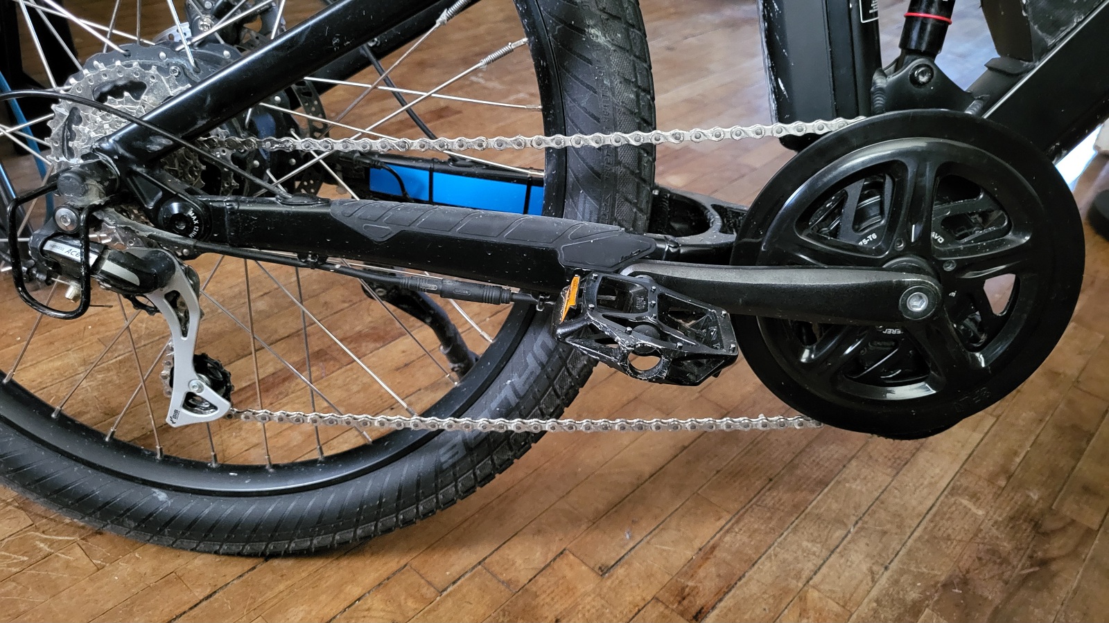

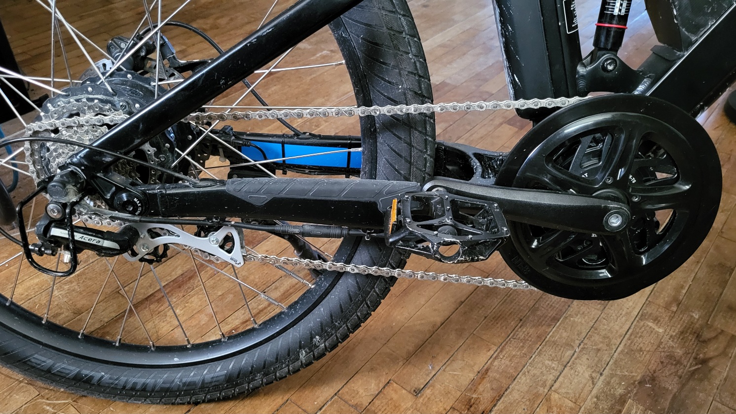

This is my derailleur cage position on the 52t chainring,..
And on the 44t chainring,..
And this is with the chain resting on the motor housing with a sprocket equivalent of about 36t or so,..
So, it appears that my derailleur will actually be able to accept a longer chain?
But the chain line is crap in 7th gear anyway because of my offset 44t chain wheel, and it's also crap for my 8th gear because I mounted the 52t chain wheel on top of my 44t chain wheel (I had to use longer bolts), so the chain line on the 52t ring is pushed out as well.
It all seems to work nicely together by giving the lower gears on the freewheel a better chain line with the offset 44t chain wheel and the higher gears have a better chain line with the 52t chainwheel.
I remember taking a freinds mountain bike for a spin about 25 years ago.
I don't remember whether it had two or three chain rings, but I didn't know that you couldn't use all the gears.
I did exactly this when I pedaled the bike down the laneway and back,..
I was just pedaling along and everything jammed.
It was a brand new mountain bike, but luckily I didn't break anything by forcing it too hard.
My mid-drive is different in that chain and chain ring are always moving even when I'm not pedaling, so if I ever screw up and try to go into 8th gear, something really bad will happen 🙃 😅
I've got a ~1000 watt motor with all kinds of spun up inertia pulling a Super Strong Ebike chain on a Super Strong freewheel.
Maybe I should install a couple of my shitty quick links on my chain that were like three for a dollar?
I could use them like shear pins on a snowblower auger ? 🤔😁
