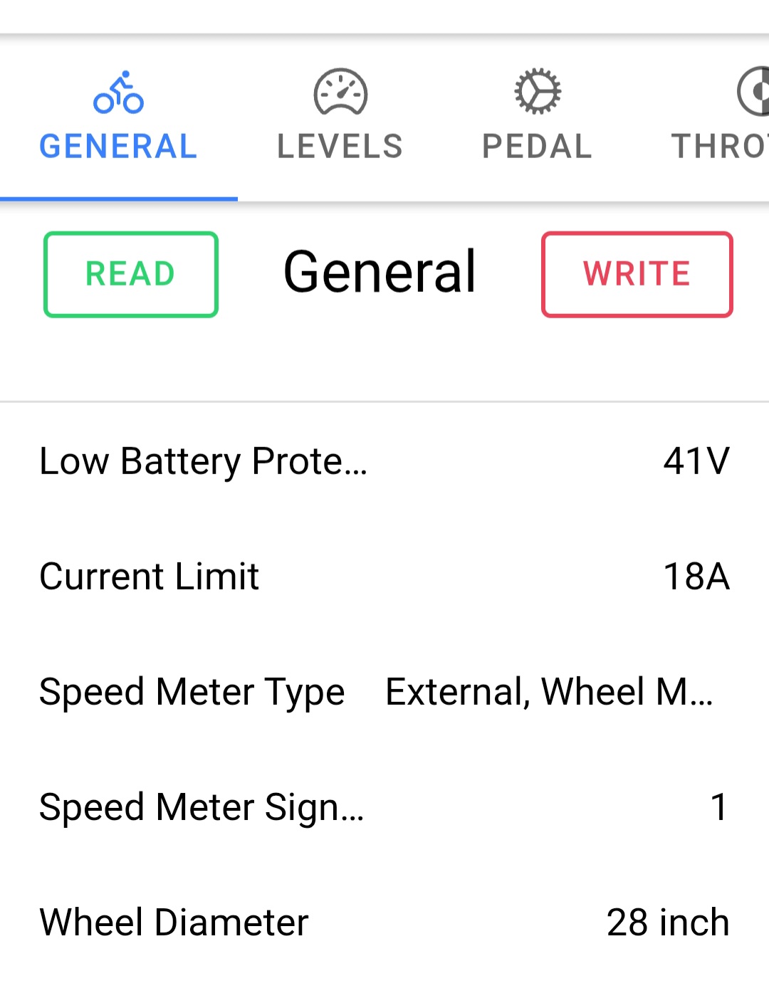

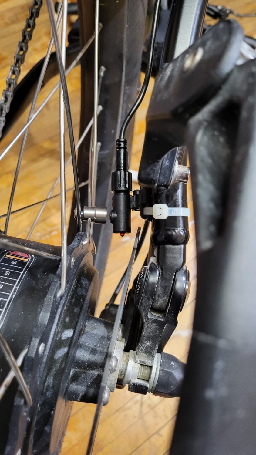

I'm pretty sure that I can glue 8 magnets to the rotor, then set the "speed magnet" setting to 5,6 or 7 to try and "dial it in" with some accuracy using the throttle and the maximum speed setting?

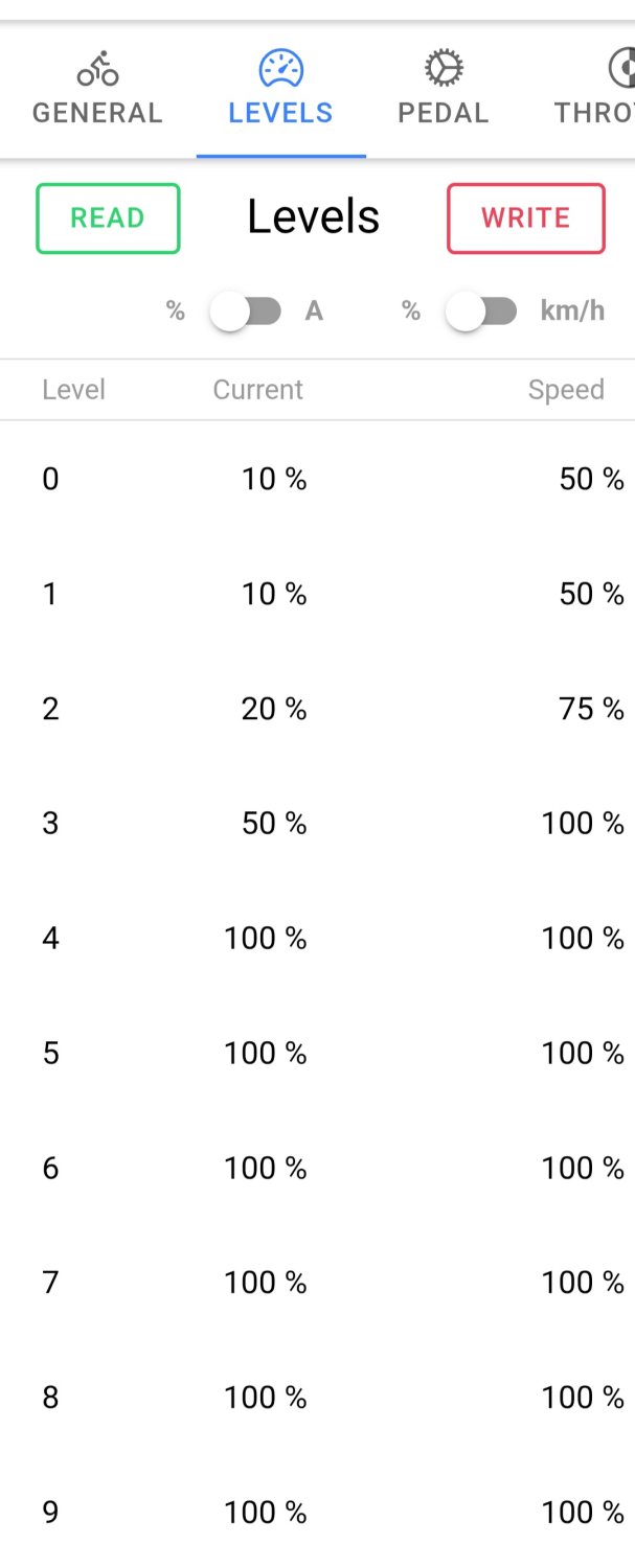

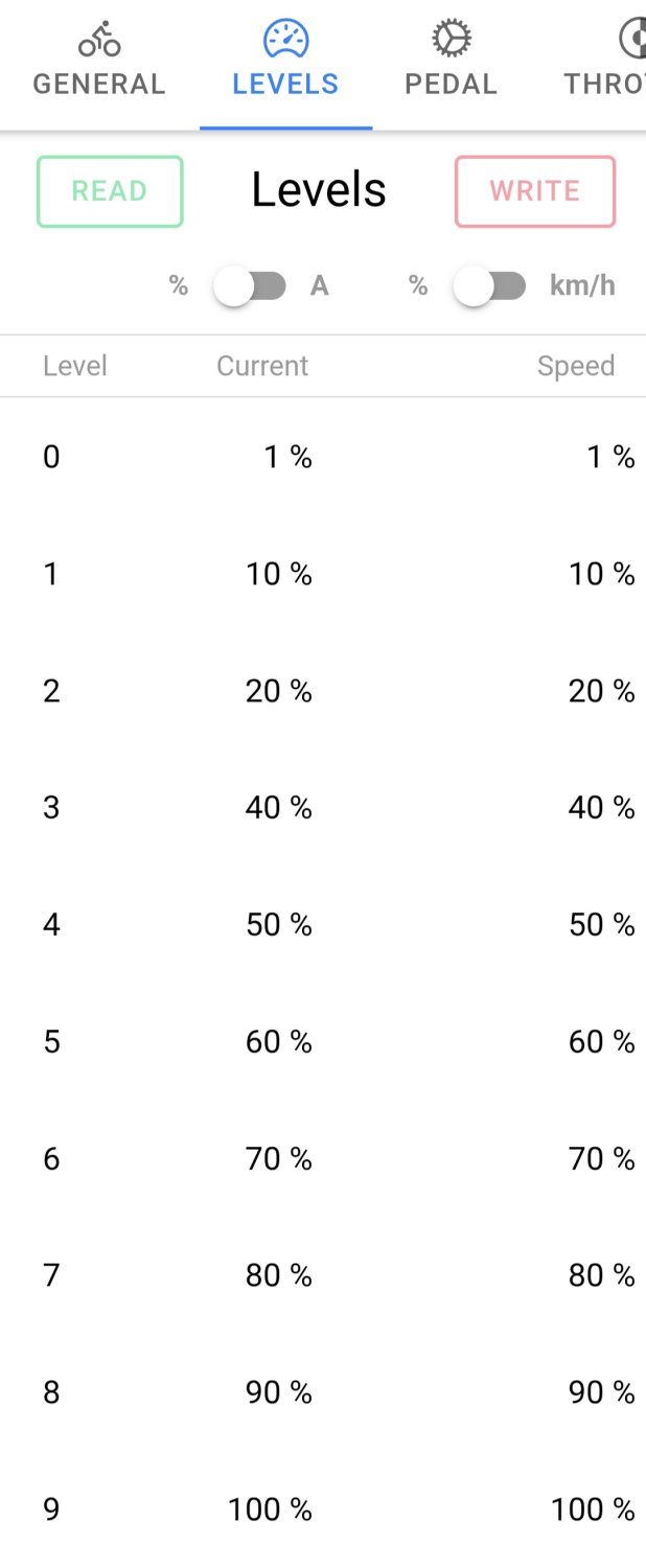

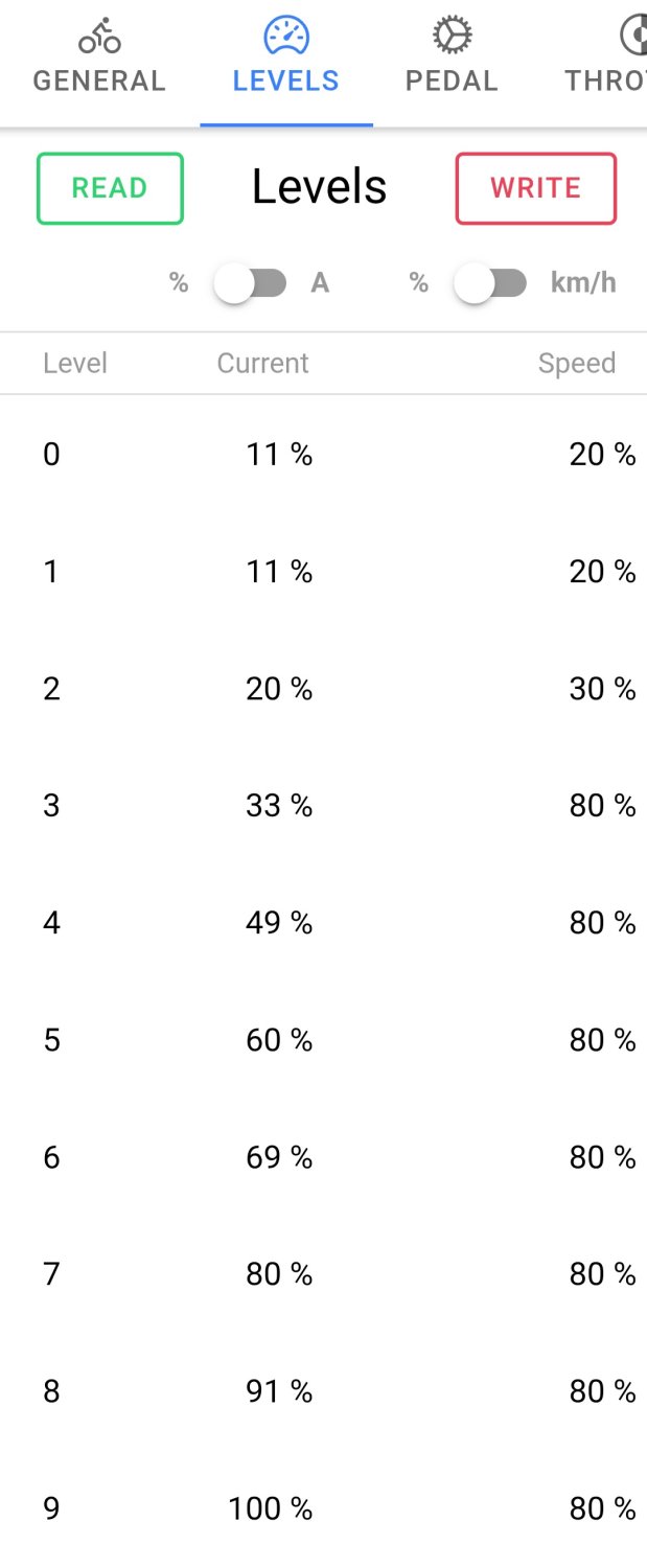

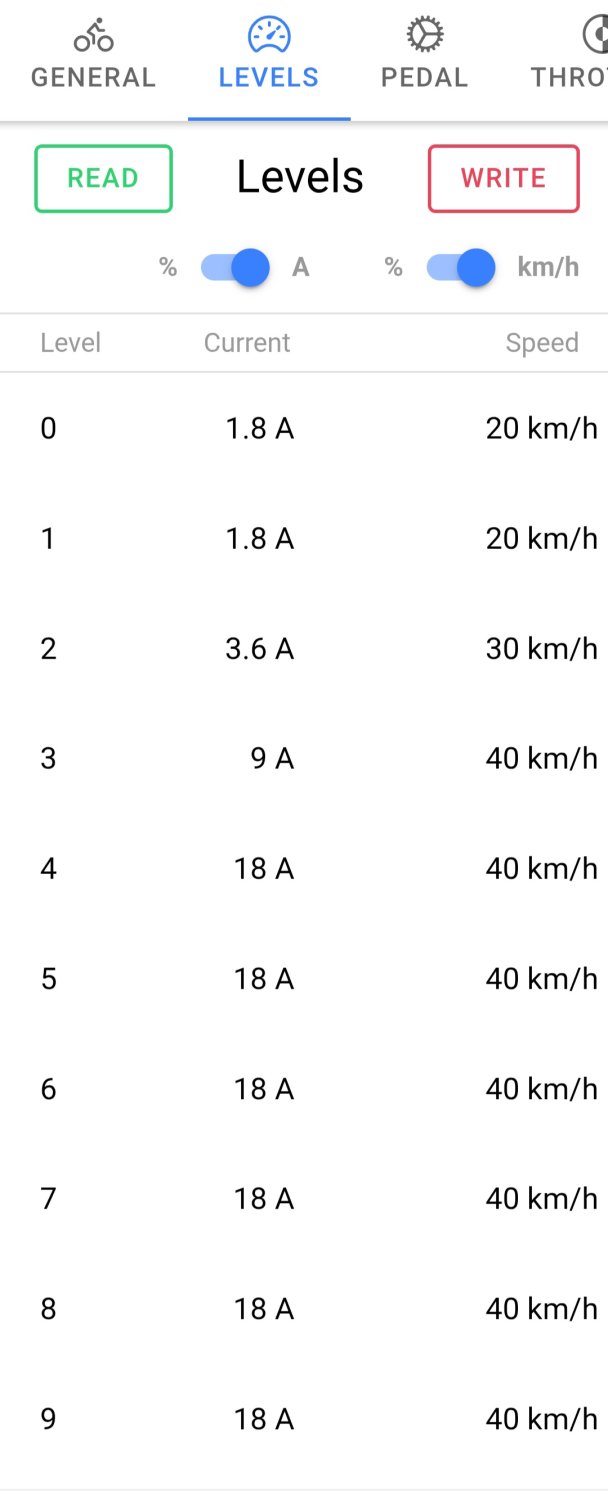

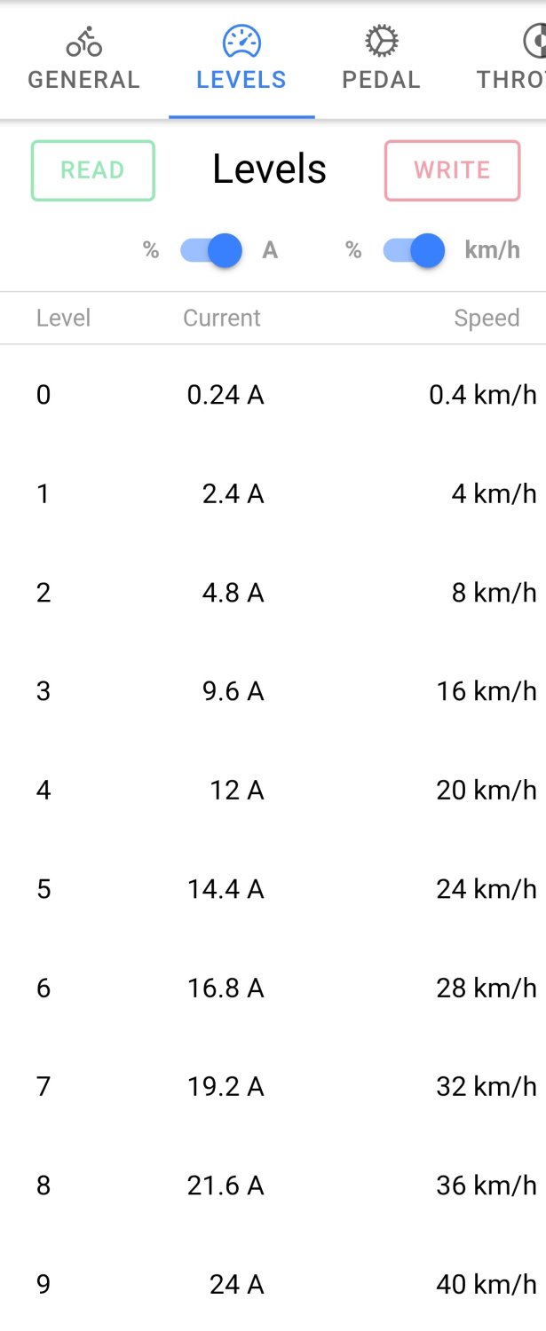

These are my settings with the current set to 18 amps, and the speed set to 40 kph for PAS modes 4-9,..
It's not going to go 40 kph in PAS 4 with less than 9 amps, so I should be able to change PAS modes to keep it near 32 kph?
If that doesn't work I'll reset everything to the factory settings,.. Again. 😁

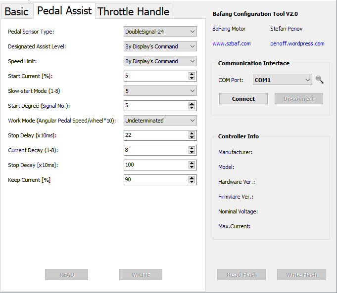

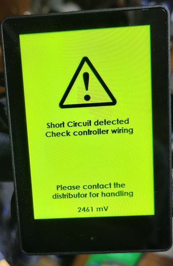

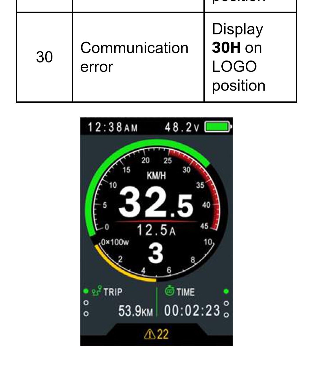

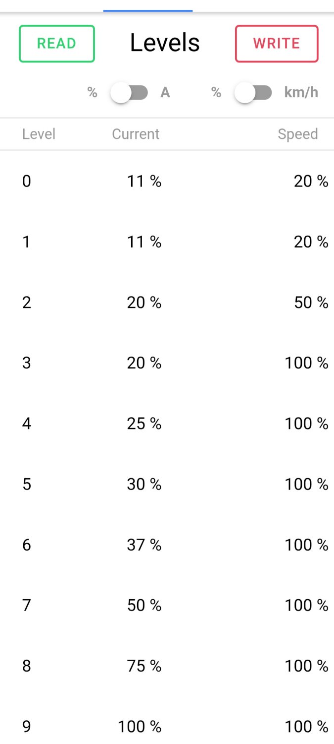

I did Piss Off my Display though, and the settings are different now with different adjustments ??
I don't know what happened??
Only this,.. 🤣

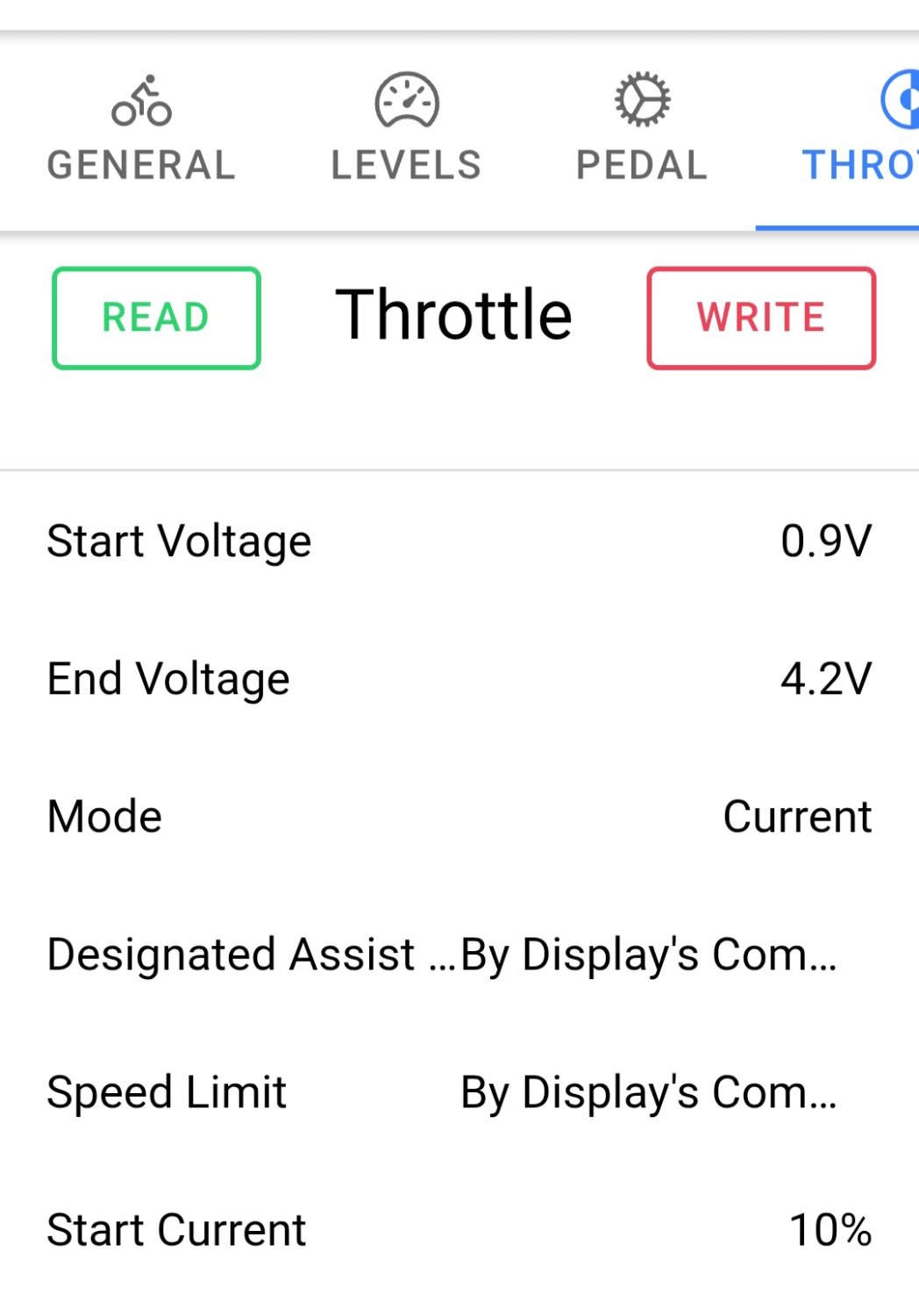

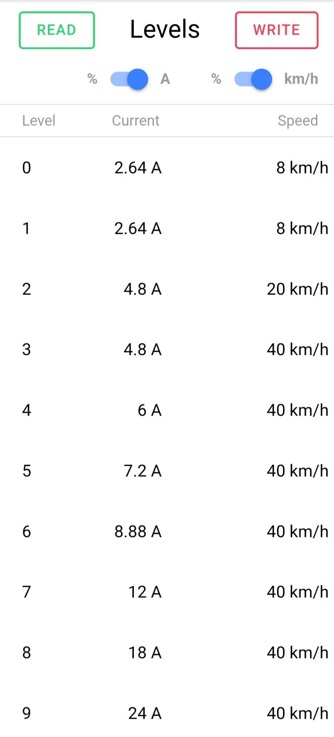

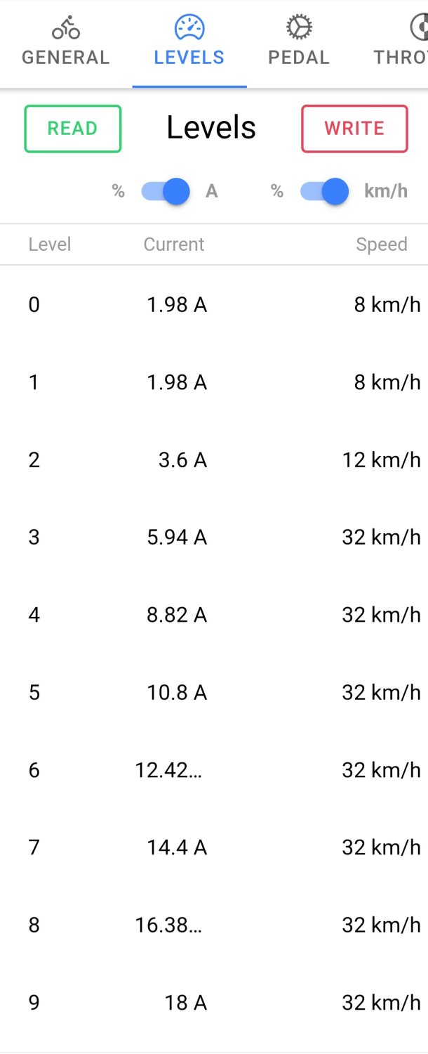

I adjusted my settings again before my next test ride,..
When the "cruise control" was kinda working before, I only needed to add about an amp to stabilize the speed.
If the jump in amps was too much (when starting from a low amp PAS setting), the ebike would start surging.
Adding ~3-4 amps when it's already getting ~10 amps doesn't make ad much difference.

I agree and that's how I've been programming mine as well as the Ultra now. Lower PAS have smaller increases between as I want precise power and smooth transition between. Once I get up around Pas 5 I need power for hills and such and want to feel it. And once you're already powering the bike heavily the increases up feel less aggressive and more natural with the larger jumps in current.
That's why I've always disagreed with what most do and program it to look neat on paper... 10 - 20 - 30...

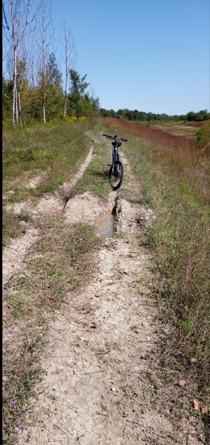

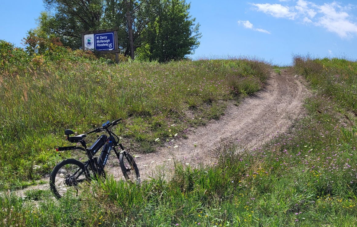

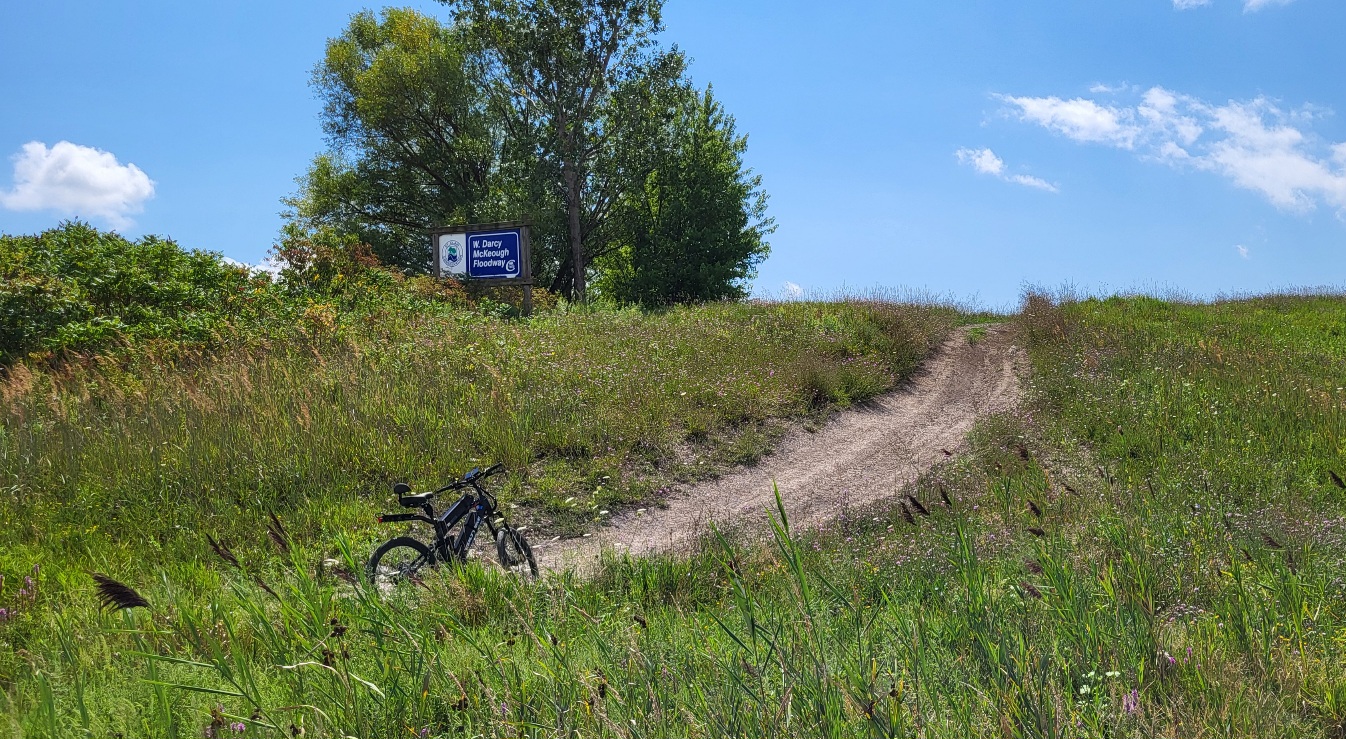

I spontaneously decided to do some off-roading today and try my mid-drive motor on some hills,..
I already had it on my 44t chain wheel, so I put it in 1st gear (34t on the freewheel), and Hammered It !!
No-go.
I had to put my feet out to the sides and walk it up, with the wheel pushing and spinning.
So I tried again 🙃
This time I locked both throttles (mid-drive and hub-drive, 18 amps each at ~48V) while holding the brake lever.
Then I "dumped the clutch" and managed to climb the hill standing on the pedals.
(I couldn'ta pedaled anyway, cuz the rutts were too deep)
I ended up falling over once further on down the trail, when I was in a rutt that I couldn't see (grown over with grass) and I also ended up dropping my chain.
I didn't realize it at the time because I was using both motors.
The BBS02B chain wheel was spinning with the chain sitting on the plastic motor cover.
Fortunately, nothing was damaged, so I just grabbed the chain put it back on to the chain wheel and carried on.

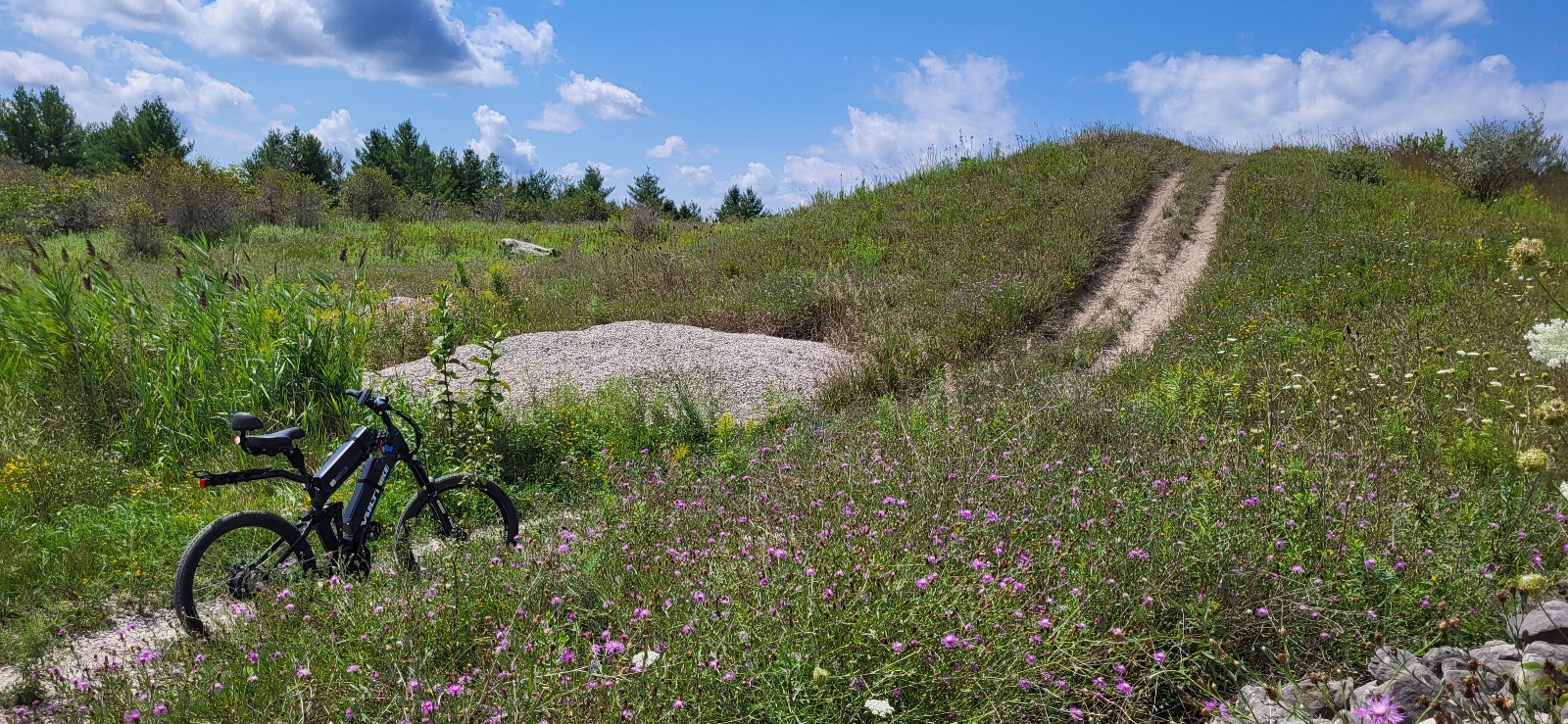

Then I got to this part of the trail,..
That's called a wheelie bike.
That was never my intention, cuz I don't know how to do wheelies, and then I went ahead and did this,..
I just installed a seat extender and launched my seat back a good three inches or so.
I get on my ebike, which is already angled uphill, 🔨 Both Throttles, and my front wheel comes off the ground almost a foot.
So I roll back down the hill to try again, but this time I decided to stand up and lean forward.
Which is of course what I should have done in the first place, but I didn't think of that before hand 🤔 😅
Quite the adventure!!
I didn't ride that trail At All last year.
The rutts were up to 8" deep and my pedals would hit the top of the rutts.
And there was mud and water in the rutts as well.

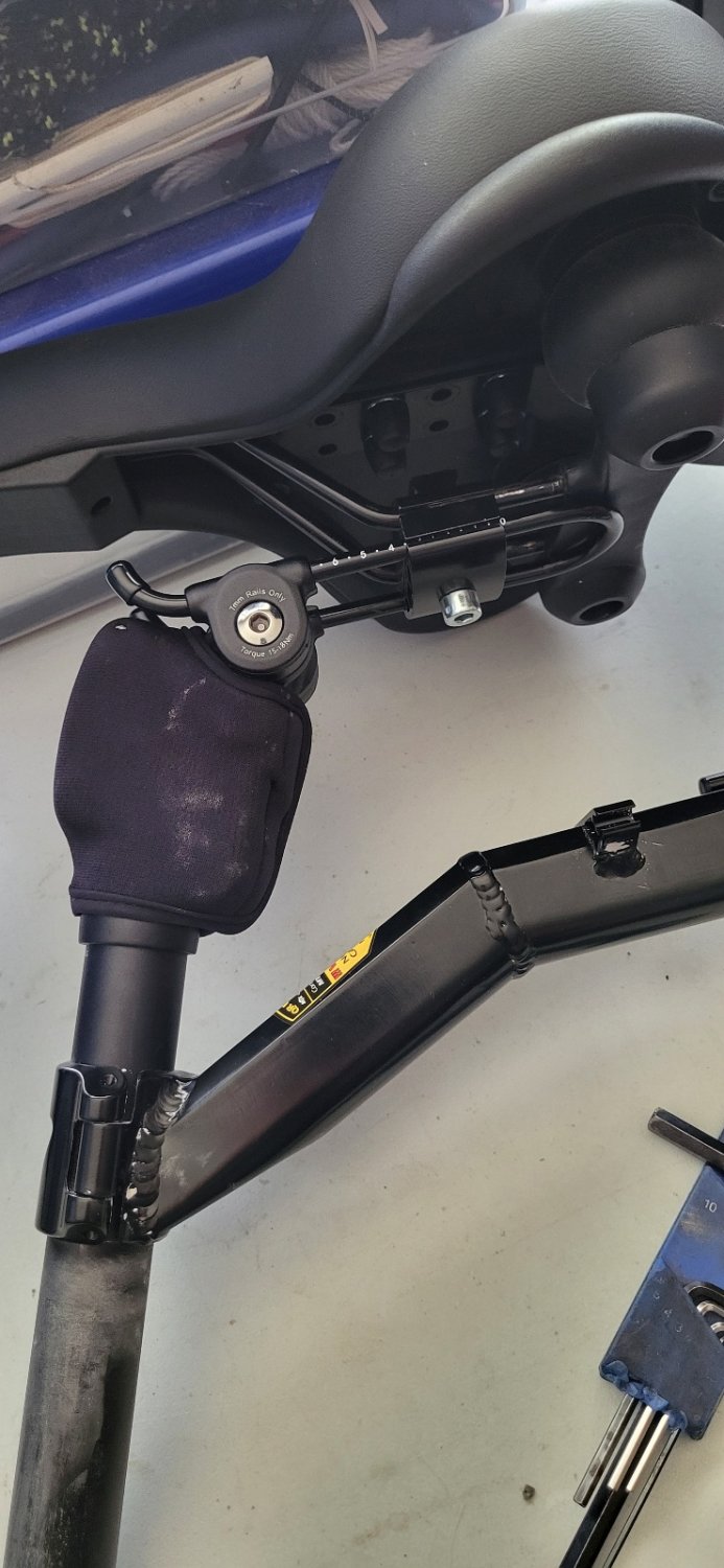

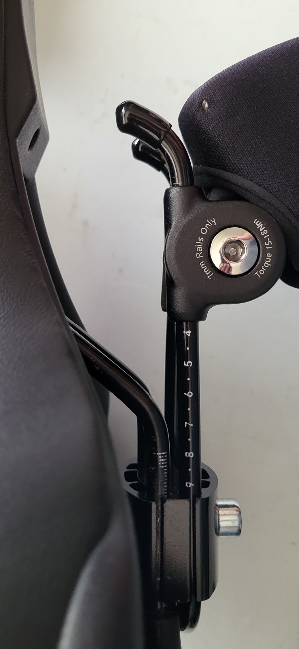

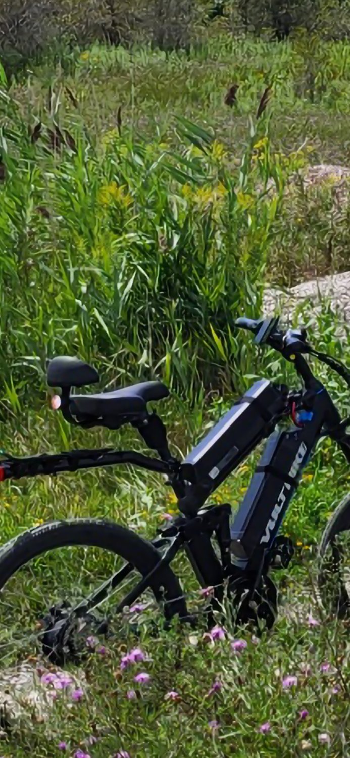

I had to realign my seat.
I adjusted it on the side of the road, and got my seatpost notches off by one notch.
The seat was leaning to one side.
And I was torquing the Hell outta my Suntour seatpost with my seat Way Back, so I cranked the Snot Outta my seatpost spring.
I torqued it till it bottomed out.
Just like the instructions say. 😁
I Really Am Digging the seat further back.
I'm more comfortable in my seat, and I can lean into my backrest.
My handlebars are Way Too Forward now though, so I might need to do something about that?
I don't use the handlebars much, but I'm leaning over to reach them now.
That SUCKS !! 😁

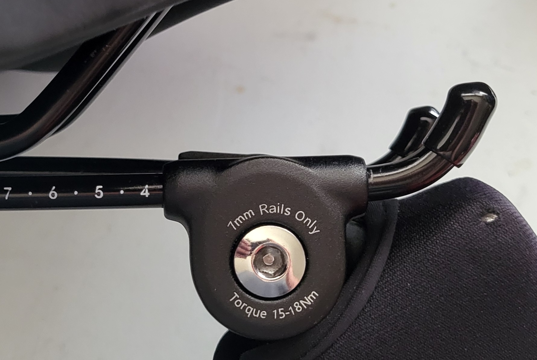

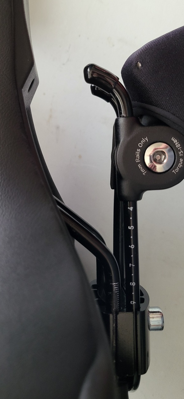

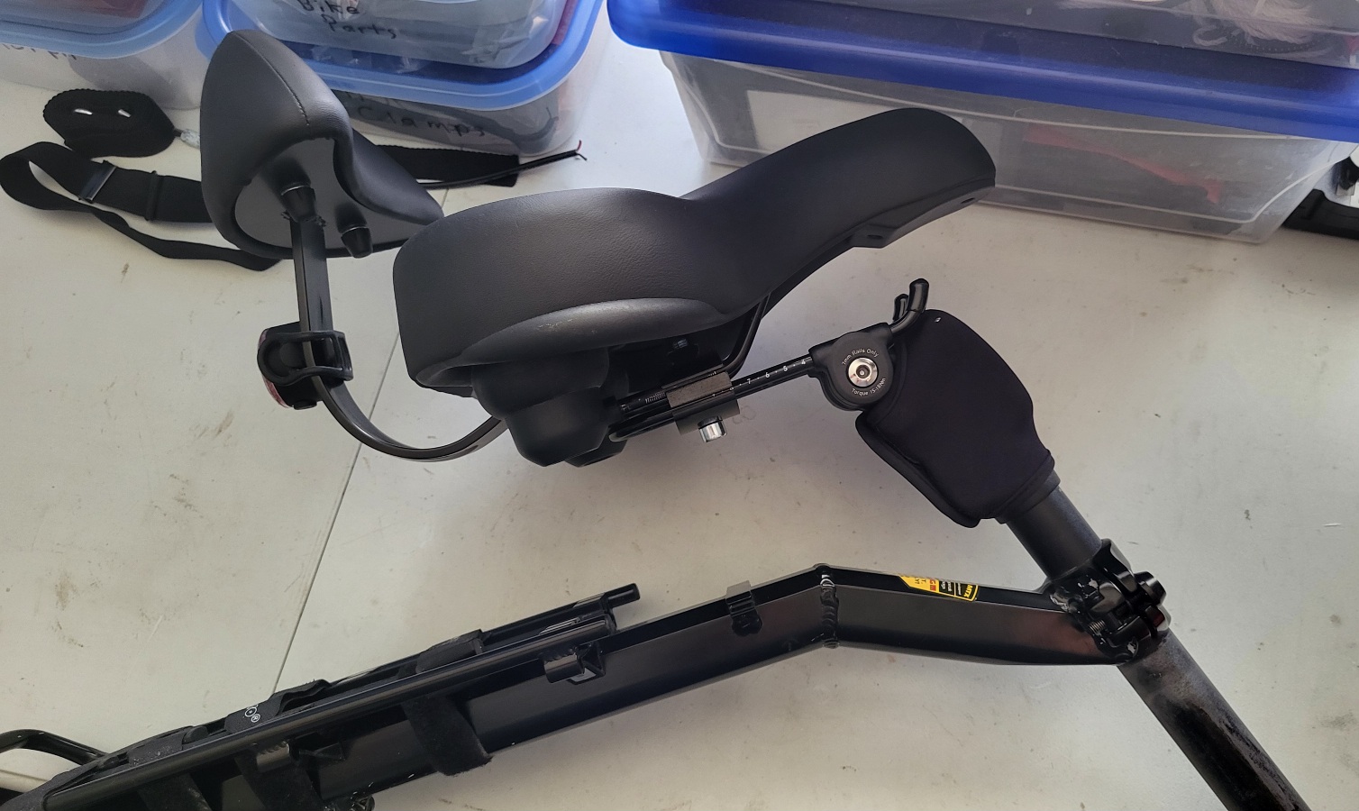

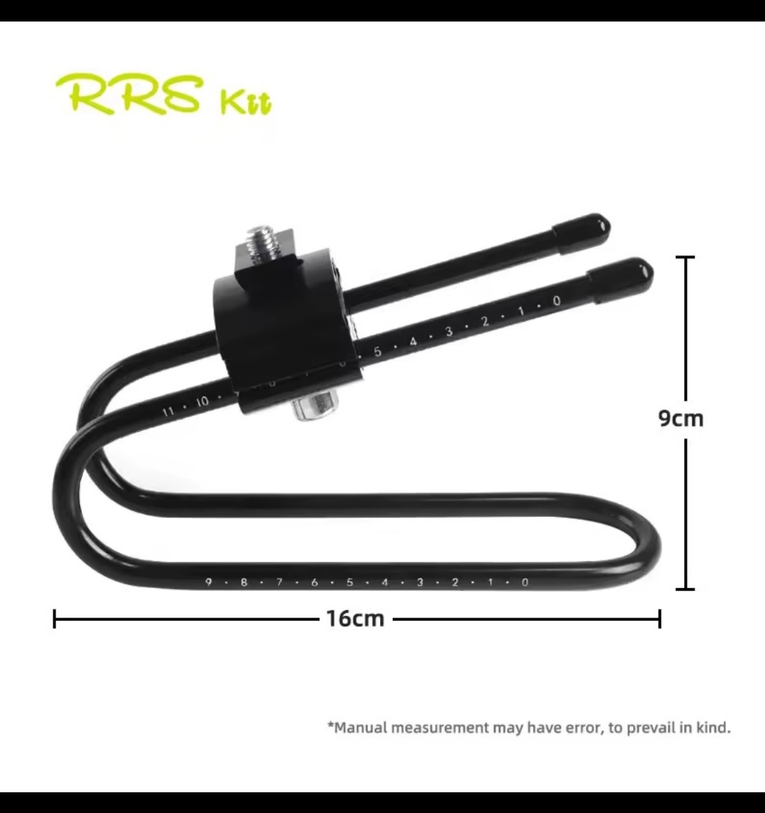

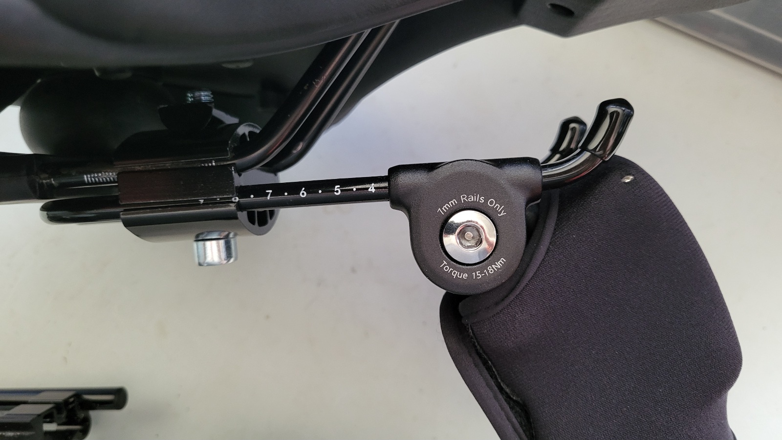

I cut this spring seat gizmo to extend my seat back,..
I'm not sure that I want to trust it to not snap (it appears bent now ??), so I bought a half meter long, 7mm diameter stainless steel rod to replace the seat extension.
I don't really care if the seat spring breaks, but it might cause an accident depending on how and where it breaks, so I'm gunna replace it with something stronger. (hopefully?)

I Got My Speedometer Figured Out !!!
First I got the speedometer reading the same as my Voltbike speedo by adjusting the wheel size, (30" wheel diameter was the most accurate) but it still wouldn't get to 32 kph and stay there?
Then I remembered that changing the wheel size changes the speedometer reading, but not the actual speed.
So I used my display settings to increase the maximum speed to 35 kph, which FINALLY got the set speed to stay at just under 32 kph.
I could get rolling in a lower PAS mode, then crank it up to 9.
If it started surging in PAS 9, (18 amps,.. then 2 amps,.. then 18 again,.. ) I'd turn down the PAS mode until the maximum amps for that PAS mode closer matched the power needed at 32 kph. (depending on wind)
So it wasn't too bad, but it was still kind of a PITA.
My hub motor has No Problem maintaining a Constant Steady speed of 32 kph, and I don't feel ANY Surging or pulsing at all.
And I don't have to hit any buttons.
Just full throttle and it goes to 32 kph and stays there.
I don't even notice it adjusting the power to maintain the set speed.
I don't think that I'm going to bother gluing magnets to my rotor, but it would probably help with the surging?
I'll make do with the way it is for now, before I explore that 🐇 🕳 any further.

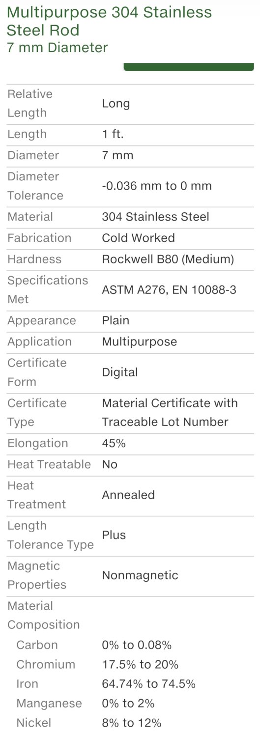

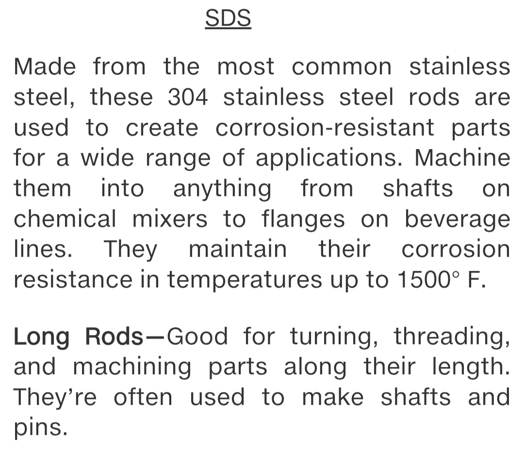

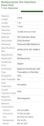

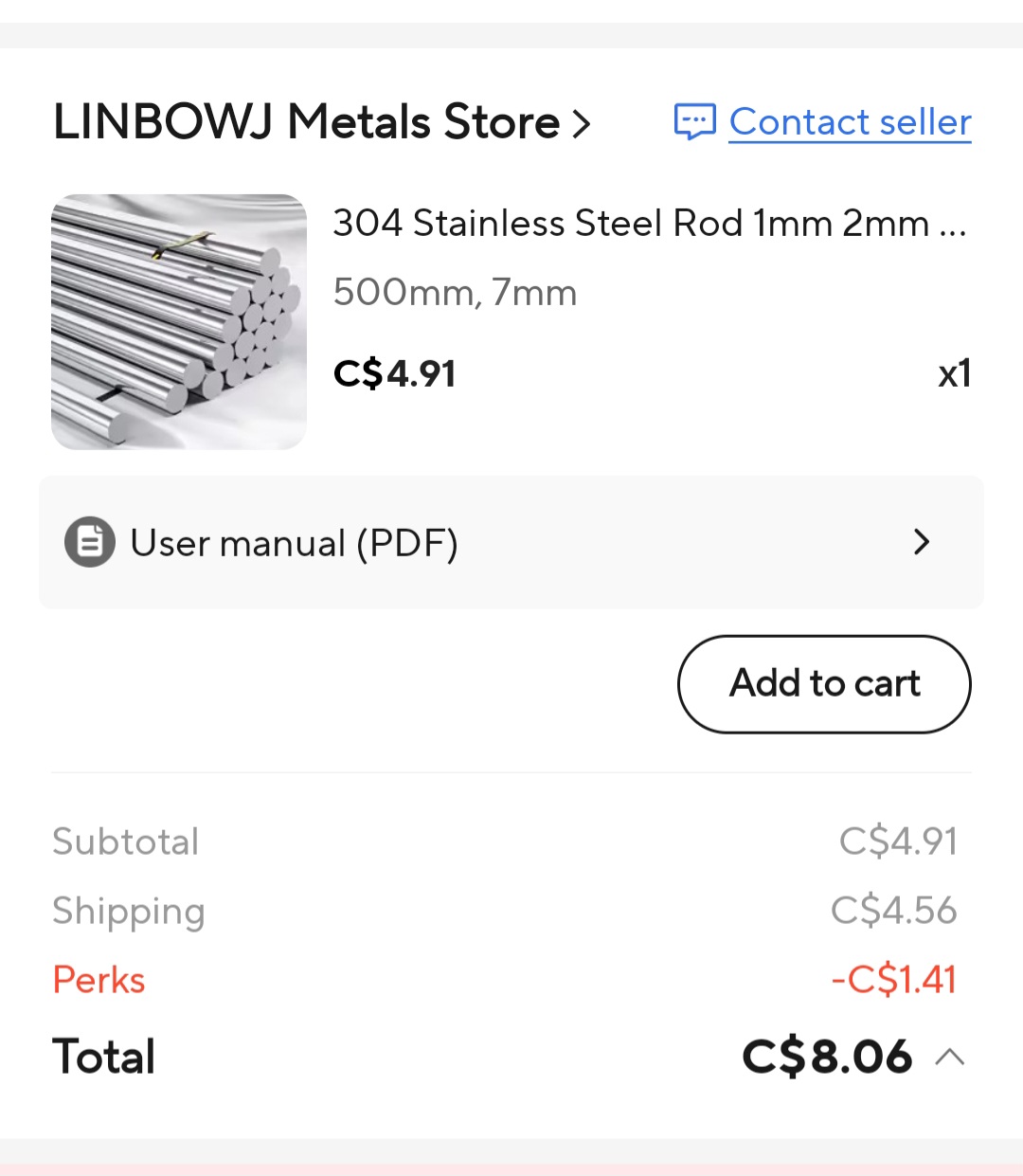

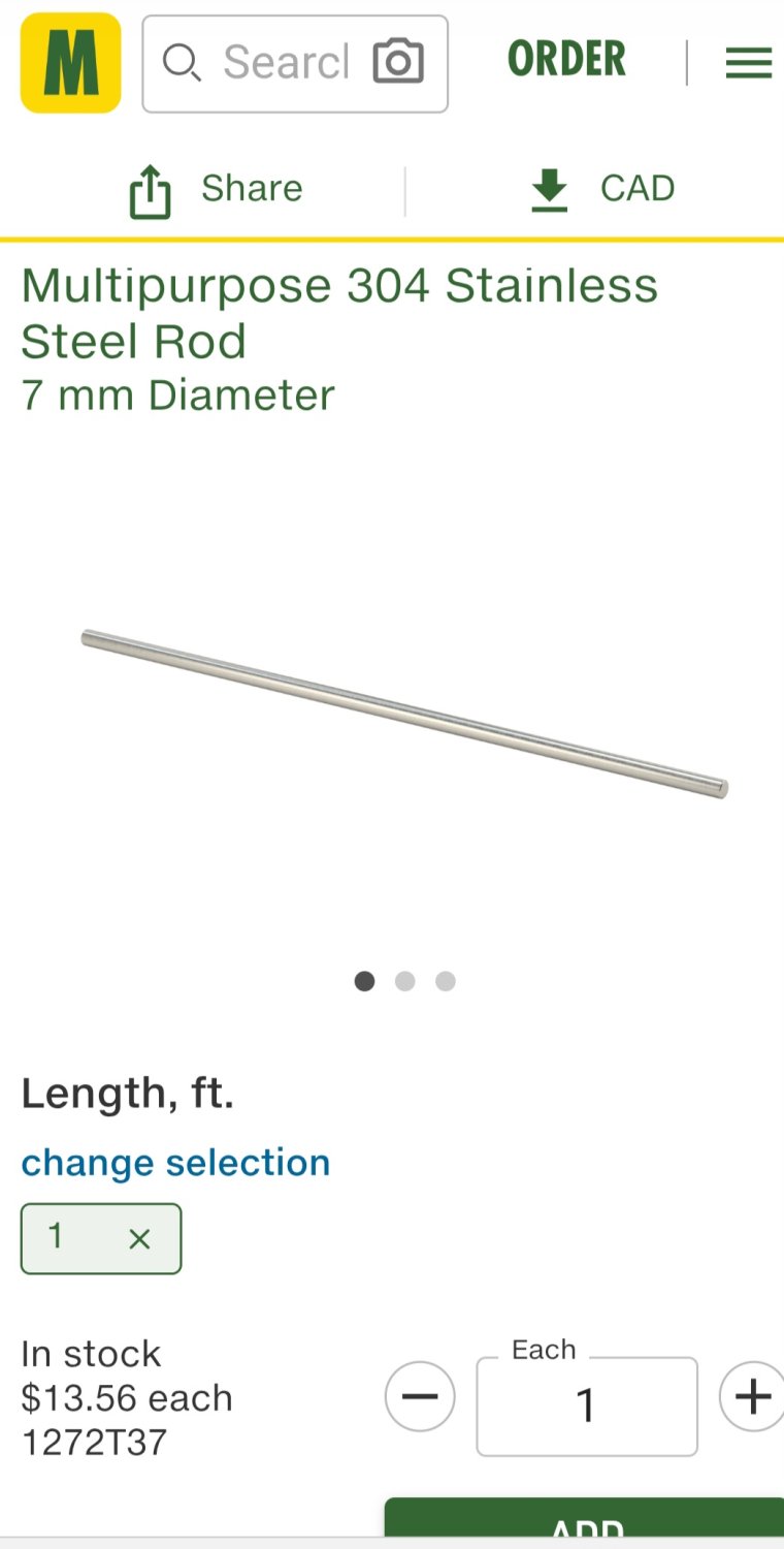

You need to go to the mcmaster carr website and look at their steel rods and compare what you bought to what they offer, that'll give you an idea of how strong they will be at that price point. That would be an ugly accident to have those rods break or bend. I have had some pretty good bounces on mine and no issues yet but my bike is suspended.
I checked out the McMaster Car website.
I found a similar one foot long 304 stainless steel 7mm rod for $13.50 but then there's shipping, tax, duty, and maybe tarriffs?
I order directly from China with Aliexpress to avoid all that.
I didn't bother checking out all the different types of metals available.
The 304 Stainless Steel seems to be a good quality metal?
My Chinese version might not be quite as good, but I'm sure it's better than the spring steel?
Bending isn't so bad.
I actually bent the seat rails on my first ebike. I just used a crowbar, a vice, and a Sledgehammer to bend it back into alignment. 😁
It's been fine.
Yeah, I have a full suspension ebike with a Suntour seat post as well, so there's not much "shock" or "jarring" going on, but I don't trust spring steel in general.
I get the impression that it can snap without warning and I trust the stainless steel to do quite a bit of bending (if any at all?) before it would snap?

Mcmaster Carr is expensive to ship, their downside. I just ordered some brass bolts from them and they sent a certificate of what was in the brass, ever see that from china? And a lot of their stuff originates in the USA it seems. Take your SS rods and give them the stress test before you install them. I would have used the spring steel before the ss rods with no reference to heat treatment or strength. You don't have to buy from mcmaster carr, just use it for comparison. You are prob buying something along the strength of a grade 2 bolt if they haven't done anything to the rods. Good luck:)
304 stainless is soft, and isn't rustproof, either.
I don't know squat about metallurgy, and was hoping to avoid that rabbit hole if I could?

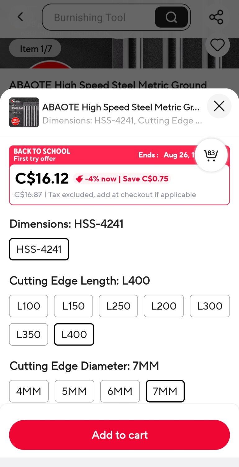

What about this,..??
High Speed Steel ?
Is that a better choice??
I'm kinda thinking that the seatpost clamp is my weakness link right now??
My whole seat looks like Sĥit,..
It looks so Damn Wrong !!??
It's too bad that I'm Really Liking the geometry so much, or I'd just ditch the whole idea.
It just looks so wrong, but it feels so right.
Until it breaks, then I'd probably end up all broken myself. 😁
I could ditch the SR Suntour seatpost and go with a regular ridgid seatpost, but its brand new, and I kinda like it.
Or I could just mount the seat directly on top of the rear rack?
That might work?😁
