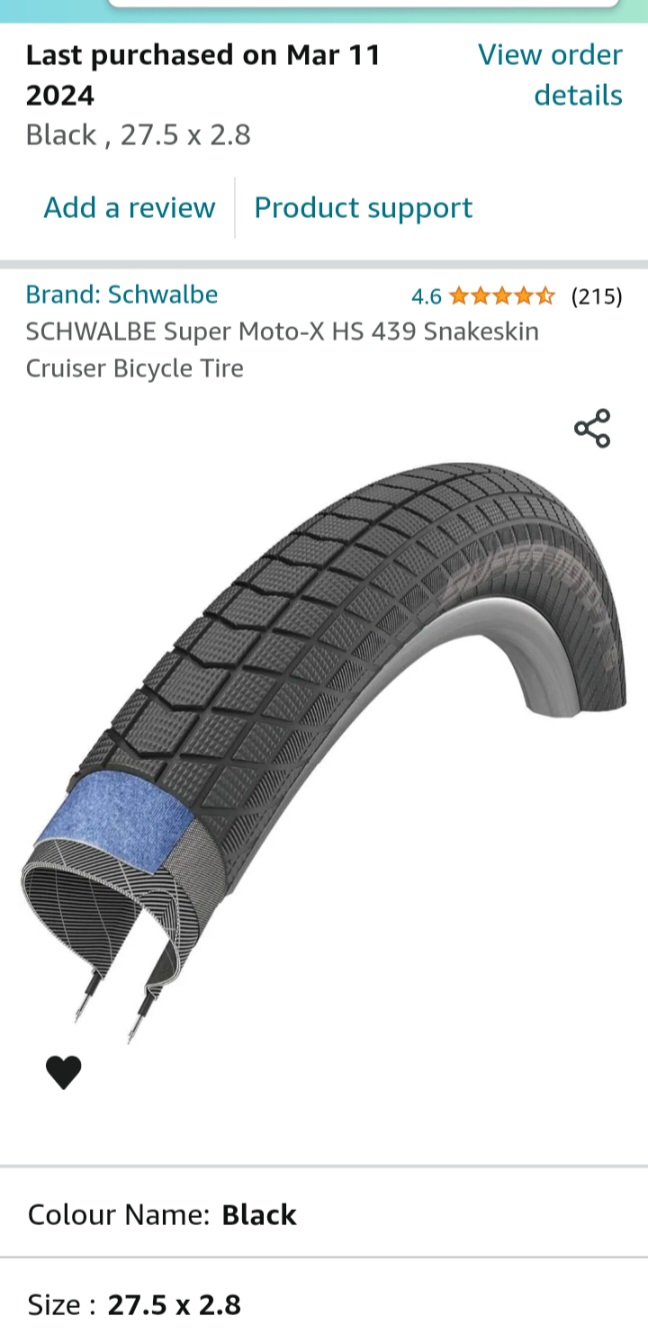

I can comfortably do about 25mph now without stressing anything and would like to get that maybe a little closer to 30mph. Not sure I'd want to go any faster with the Johnny Watt 365 tires as I don't trust their road traction. I'm wondering if I should give the Super Moto X a go.. but then that would make my off road adventures more treacherous.
So maybe for now having a speed limiting set up might be safer.
At the moment my thoughts are this...

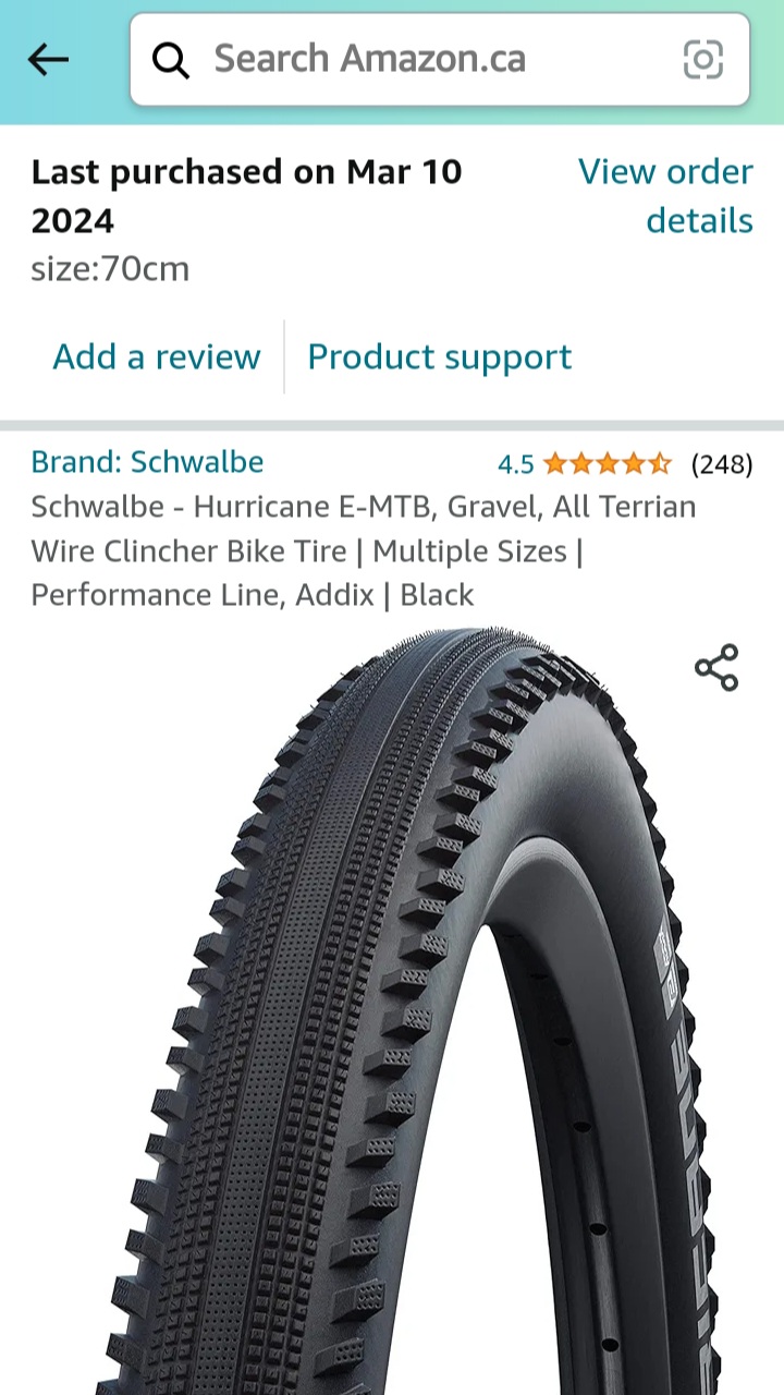

I decided to buy Schwalbe Hurricane as a compromise between a street tire and an off road tire.
The tread design just makes sense to me, but that's just speculation on my part.
A review of the tire said that the transition from the smooth rolling street tread to the knobs takes some getting used to, but I figure if I don't try to lean the bike over trying to corner on the street, I should be fine?
If the tire slips out in the dirt, the knobs won't hit so hard but you've got some traction when it starts to slip away?

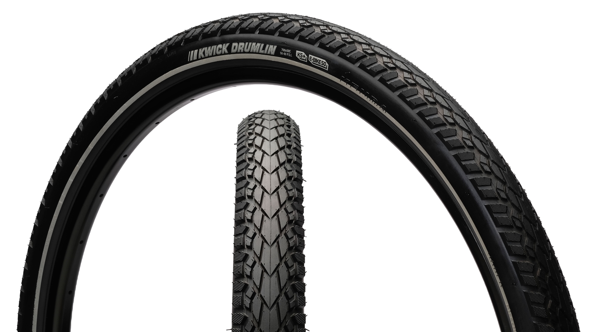

On my other bike I really liked these Kenda Kwick Drumlin...
Much better road traction than the JW.. but I'd have to say a little less off road. They're very quiet with low resistance and eBike rated with flat protection.
It's finding your size that's a problem.

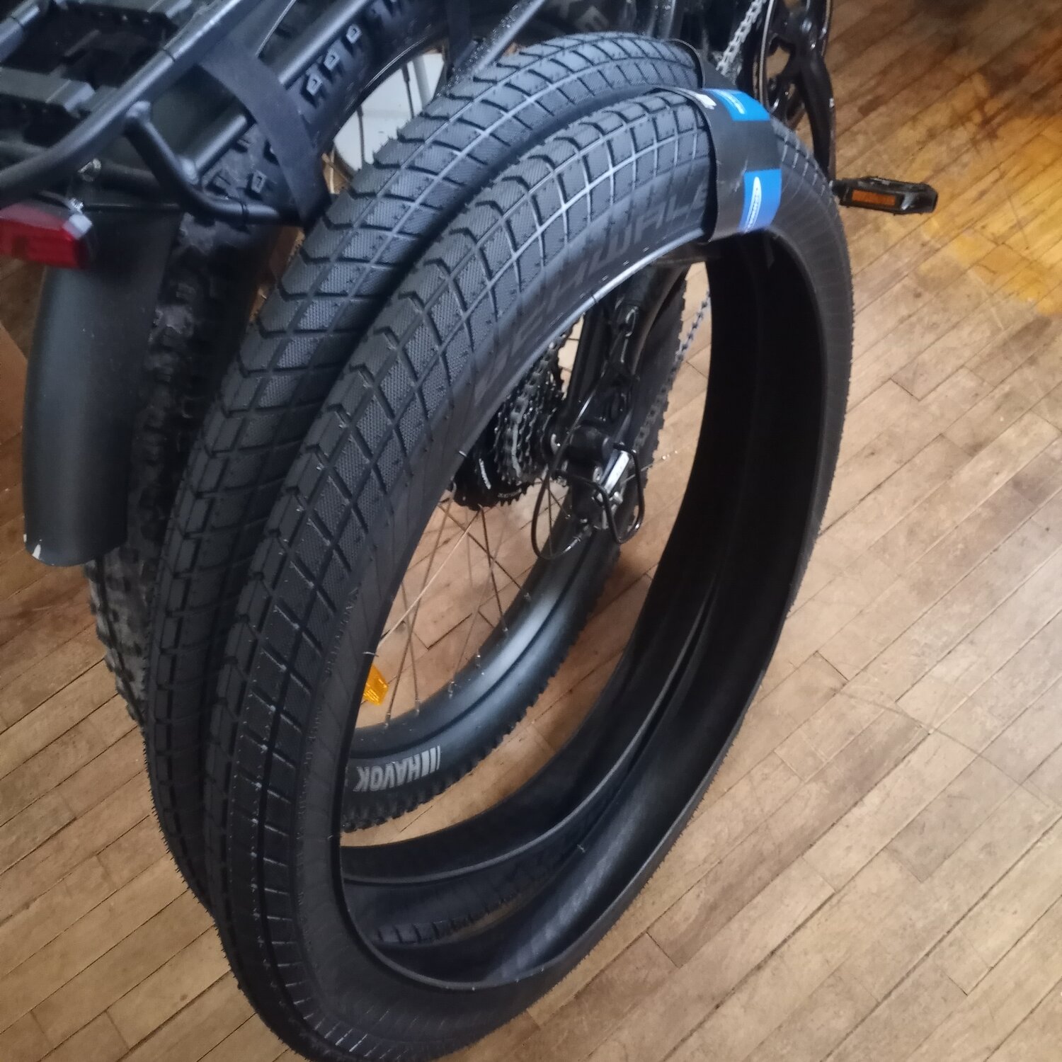

I bought something similar for my new ebike.
I HATE knobby tires.
Way too wasteful,..
They are only bicycle rated, but I figure that the Ebike rating relates mostly to speed not weight.
I could be a 300 pound bicycle rider.

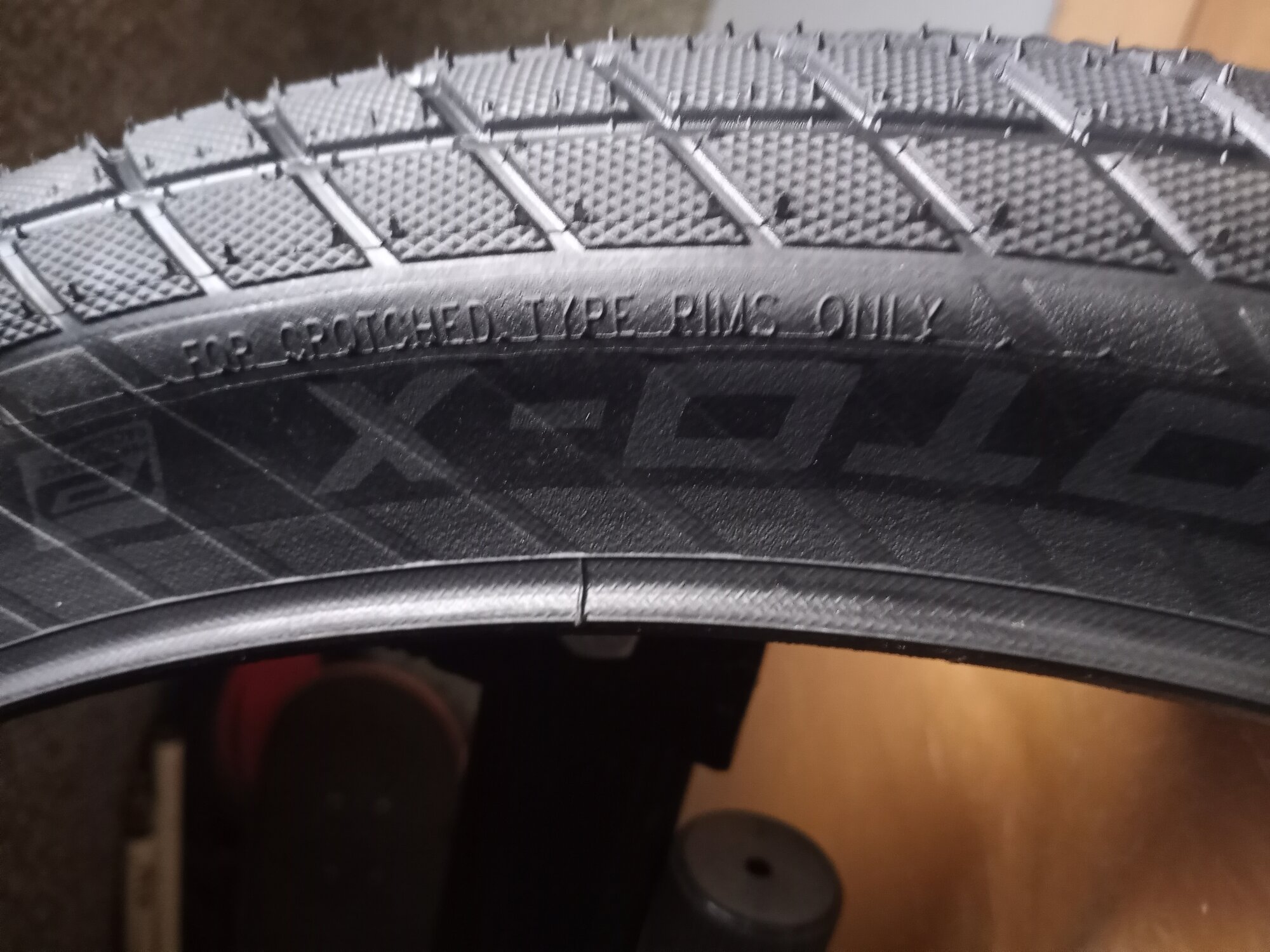

I bought a Voltbike Outback.
It came with knobby Kenda Havoc 3" tires.
I sure hope that my rims have a crotch, or I'll never get the damn tires on the rims. 😂
