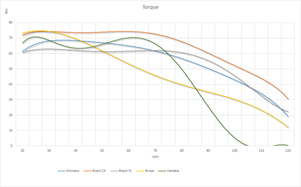

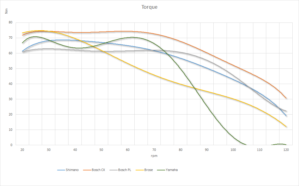

This is a very outdated chart.
Now, please tell me: Which exactly Brose motor? What year?

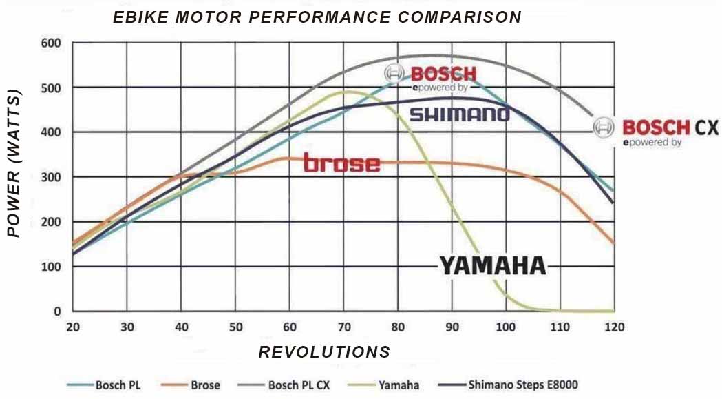

stefan, it doesn’t matter exactly what motor, or how outdated the chart is. the simple fact is that even modern electric motors don’t produce exactly the same amount of torque at different speeds. obviously you’d have to agree that if a motor produces 100nM at 75rpm it is unlikely to also produce 100nM at 150rpm (twice the power) or 300rpm (four times the power) for any sustained length of time.
here is another one :
you can clearly see that torque is nearly constant from 20-60 RPM, so the level of power is a straight line sloping up. past 60rpm, power starts dropping at different rates which clearly illustrates that torque is no longer the same. if torque was fixed and power = torque x speed, the power curve would always be a straight line, which it is not.

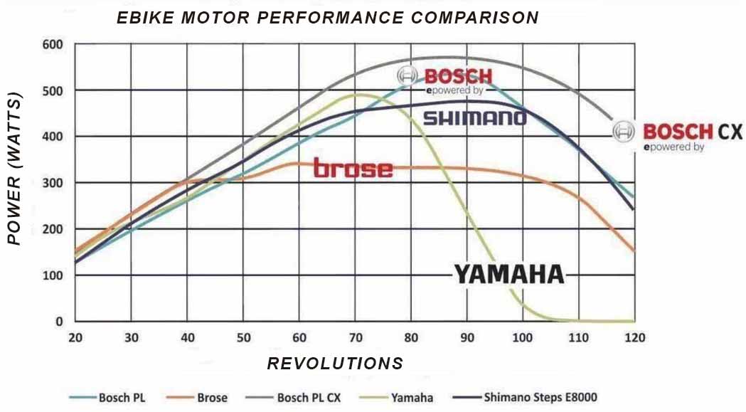

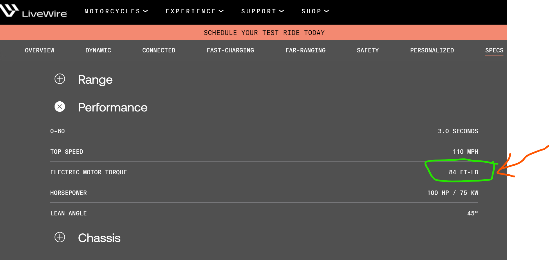

Have a look at this Torque rating for Harley Davidson Live Wire E-motorcycle. This machine produces 75,000 Watts of power and yet rated for ~115 Nm of torque!!
Using the E-bike motor logic you are alluding to, this motor should produce thousands of Nm of torque!! and this is not the case. More over, the problem is exacerbated by motor manufacturers quoting torque at the spindle, not at the rear wheel.
You can check this for yourself. I can give you 100's of examples like this. Torque and power-ratings for E-bikes can be very misleading.
Ravi, I think the angular speed given for the e-motorcycle is related to several thousand rpm? The principal question for a mid-drive e-bike is at which rotating part the rated torque is given by e-bike manufacturers.

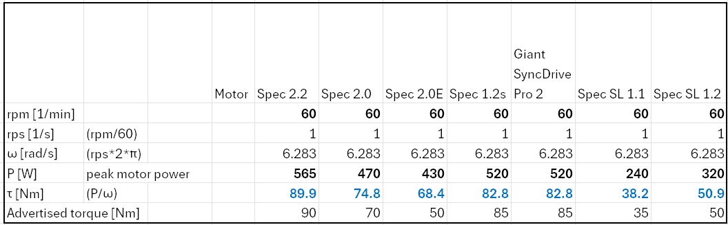

Gentlemen,
Please discuss with these hard numbers.
Specialized and Giant both use the 60 rpm figure to calculate the e-bike motor torque. Then, the marketing department chooses whatever looks better on paper. I am sure Bosch or Fazua or TQ do the same.
Specialized has given 90, 70, and 50 Nm specs for the latest motors made by Brose. As you can see, the less powerful 2.0 and 2.0E motors are actually stronger than advertised. However, put these nice 90, 70 and 50 figures in the advertising material and everyone just dreams of the most expensive motor... :)
@Ravi Kempaiah: Do you know the actual mechanical peak power of your 120 Nm motor? Please do this simple calculation and tell me what the actual torque at 60 rpm would be. Any idea about the electrical efficiency of that motor, that is, the actual maximum electrical and mechanical power?
