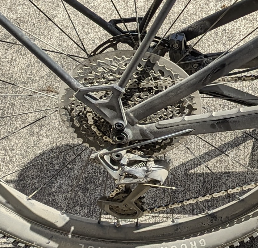

Had the bike on a stand yesterday and figured out that the rear caliper mounts were 2-3 degrees out. Took it to the LBS where I took delivery and they had it fixed (re machined the mounts parallel to the axle) in about 20 minutes. They told me it was a common problem, and the design of the bike made it tricky to get the tool in there. I'm looking forward to hard braking down a steep hill to see if this cures the surging I was getting. It definitely cures the rubbing.
