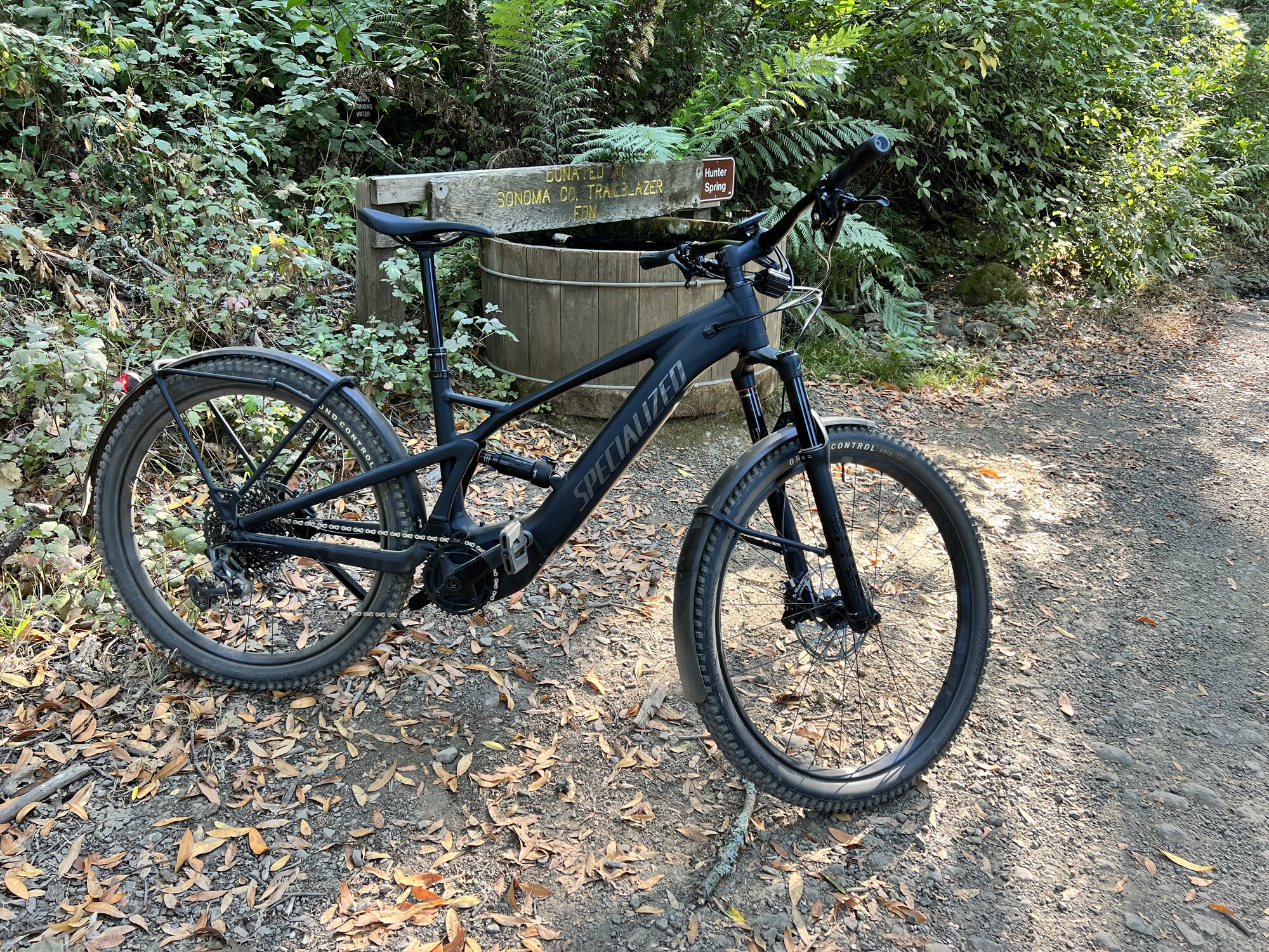

Anyway, I just drove up to my shop and bought the Tero X 6.0 today, took it right to some trails in Sonoma, CA for my first ride. I had an absolute blast. One thing I do think i'm going to do right off the bat is definitely shorten the fenders as you suggested. Might even take the front one off as it's not working well with my hitch rack.
