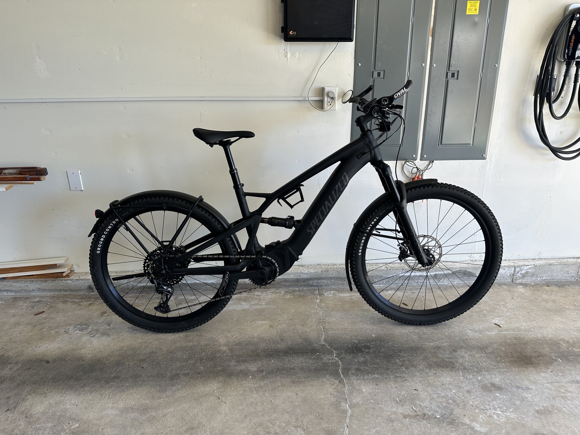

Thanks for the info, I tried a medium tero x but reach felt like way more than my BH Lynx 5.5 medium so I ordered a small frame, I am 5'6" and they said I can back out if I don't feel right with size.
Wife has a dropper post now and that is great, mine doesn't so I have a toppeak rear seat post mount and now will most likely want a pannier of some type

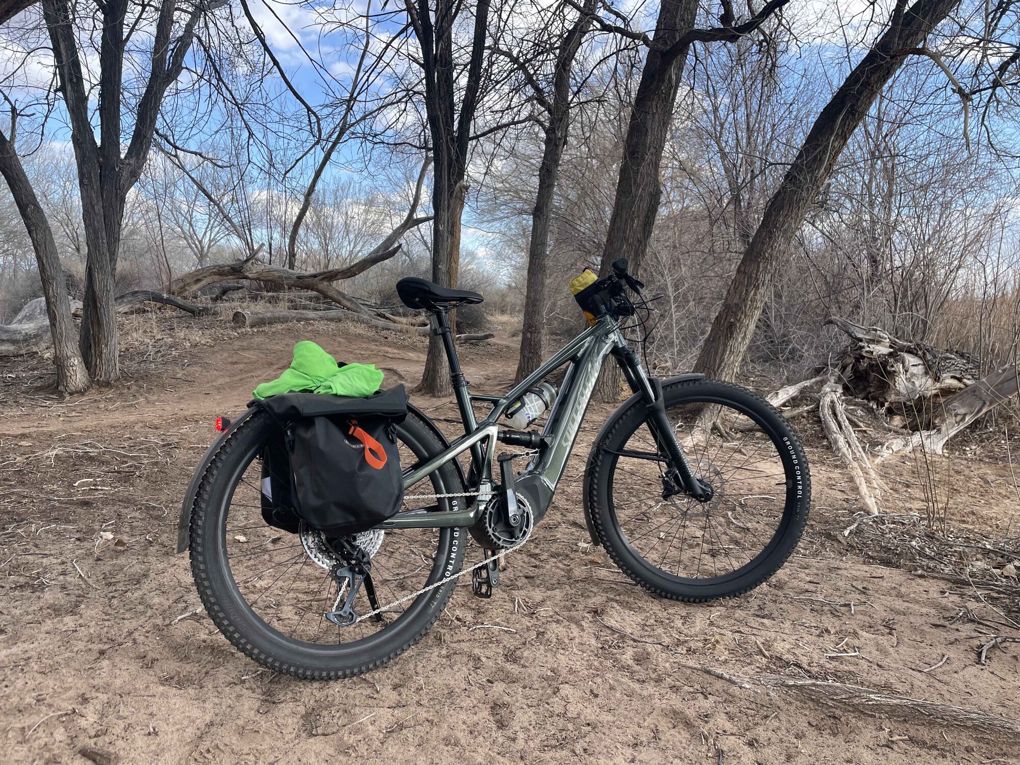

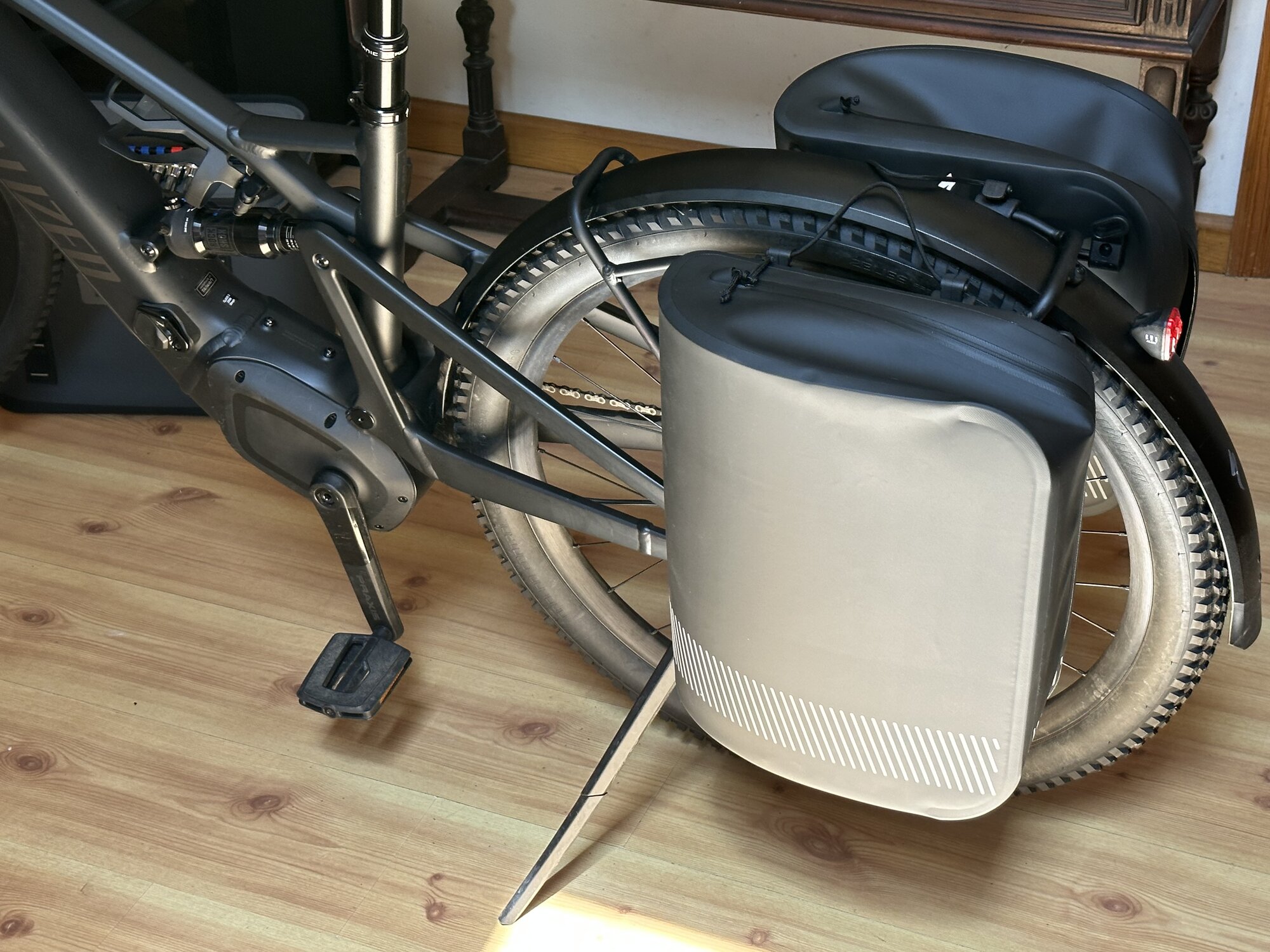

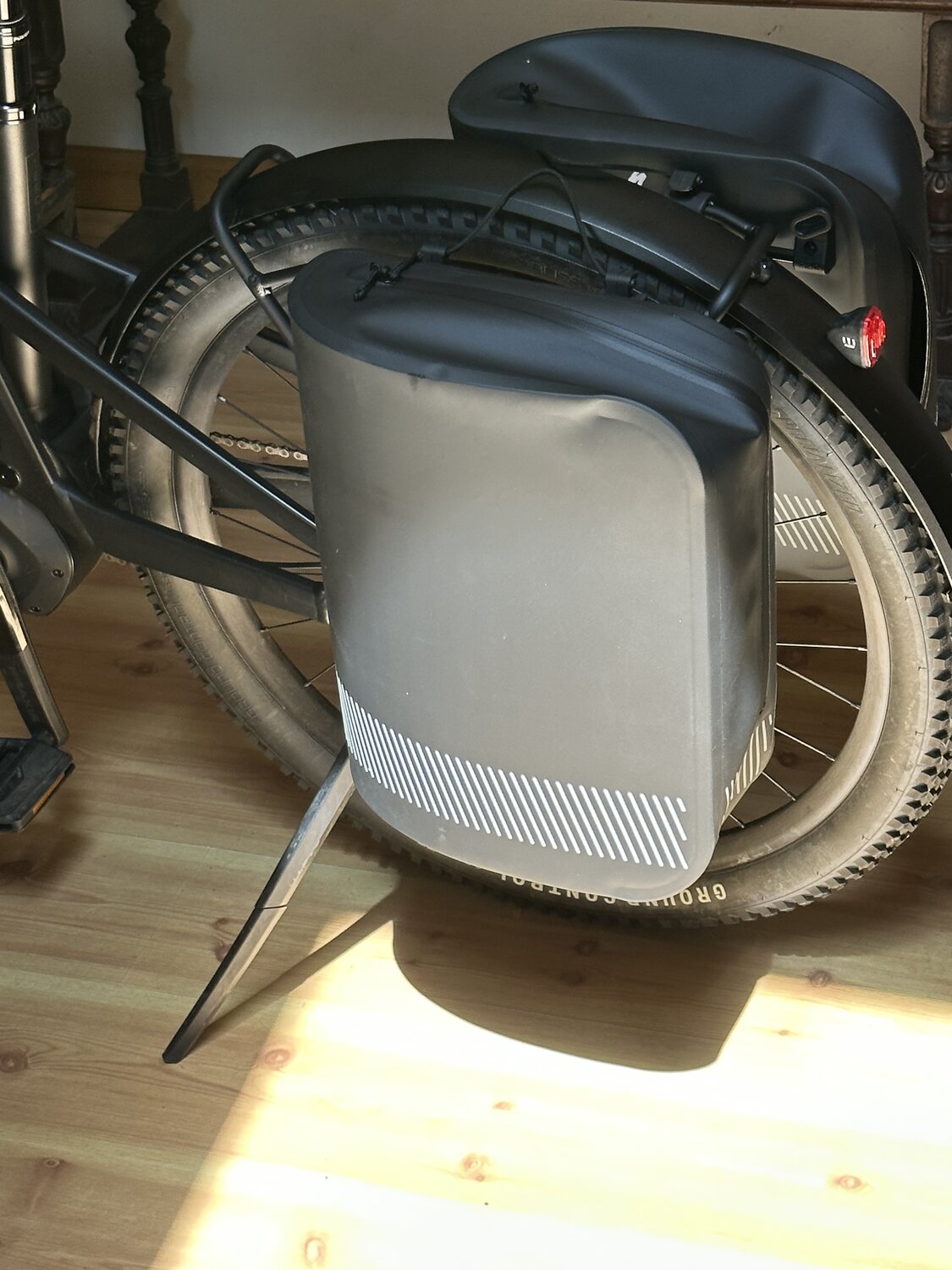

I Have both the 6.0 and recently installed the bags. Was the binding with the zippers? They do seem to require some effort out of the box. I attributed that to being new. The pull is a little small-with the bag empty it seeps to pull the bag rather than close zipper. Haven't filled them yet. The fit is great and not a sound heard when riding. Basically I anticipate the zippers to operate smoother with some weight added and with some use. Supposed to be waterproof so that may play on.
Good luck with the 6.0

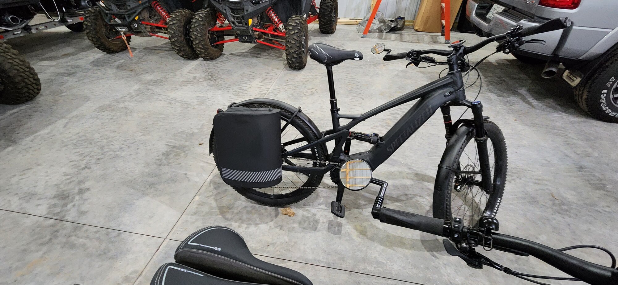

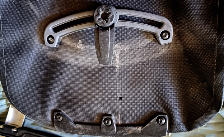

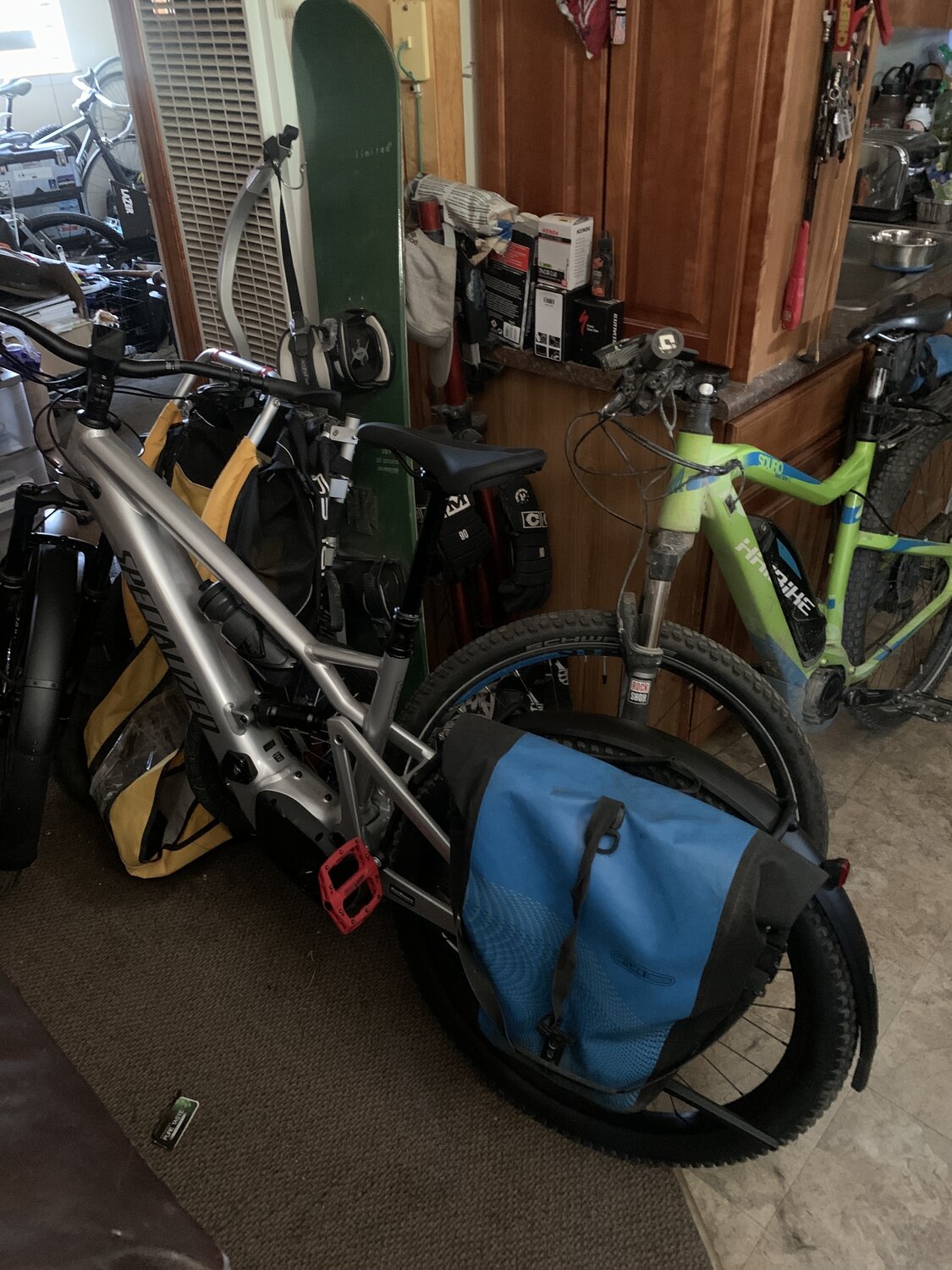

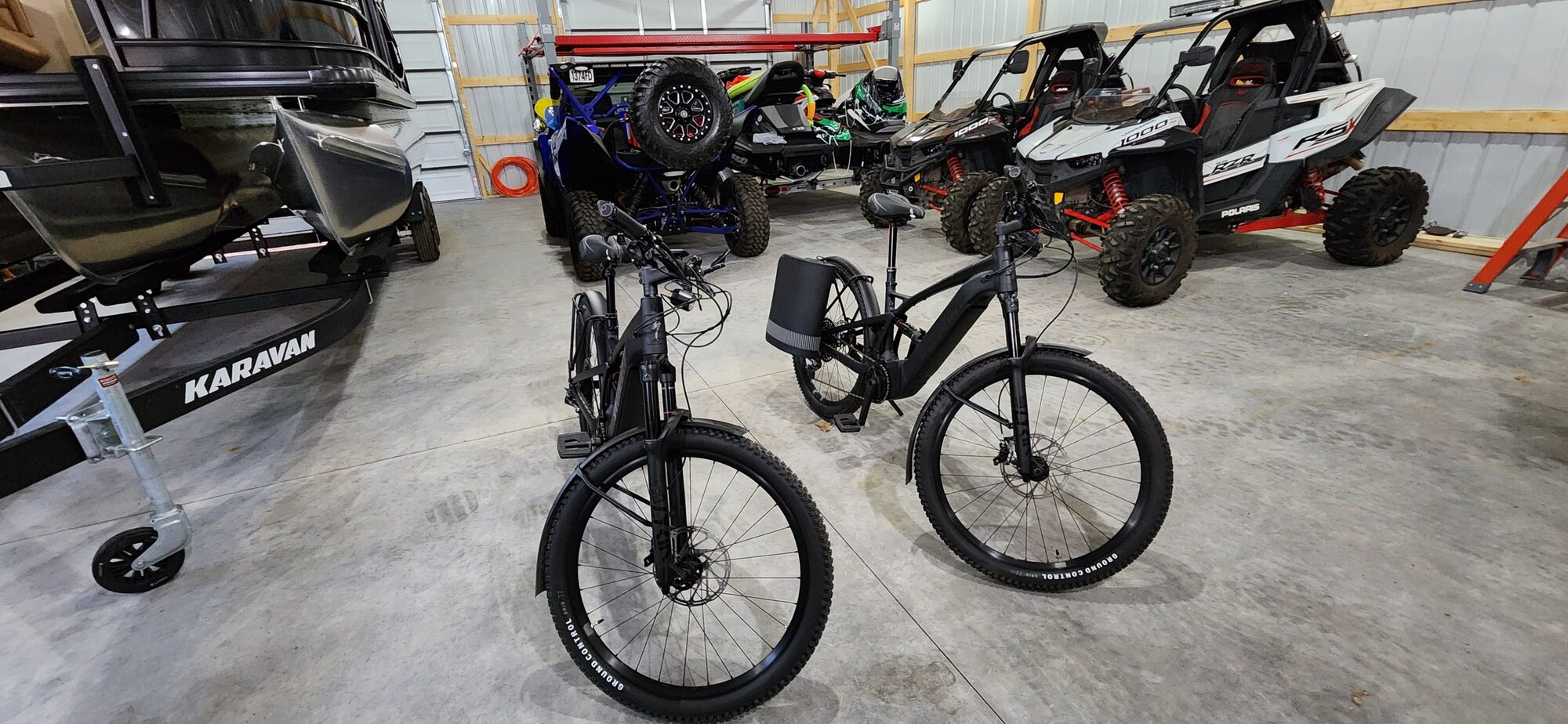

Ok so I just got a Specialized Turbo Tero X 4.0, large this week. I have some Ortlieb bags that on my first attempt didn’t fit. After looking at what was going on I flipped the bottom swivel clip bracket 180 degrees. Now my big 40L size Ortlieb bags fit. I’m replacing the old bags I have with a color that looks better on my bike. I’m now confident that they will fit! You just have to have a torx/ star bit, hold the mounting nuts on the inside of the bag with your hand and undo to bottom swivel clip bracket slider. Flip it 180 degrees and reinstall the torx screws. Easy as that. Greynews for me because I was not liking many of the specialized bags or the smaller bags.
A photo how the rear of the pannier looks like now?
I think there may be enough room for a few more bikes in there. ;^)
Haha yeah if you look in the left side of the back room there’s another 2 specialized, a Kona, a bianchi and an Ellsworth. Many years of bikes. I hate getting rid of them. They all have separate uses but my new Tero X will be my daily driver.
Whoops I don’t even know if you were talking to me. Either way more bikes! Lol
Man, Toys-R-Us… will you adopt me, please?
Bags look great… nice adapting.

Thank you so much @ecbiker for your idea! I did the same to my Ortlieb Vario v2 pannier/backpack to fit a Vado SL EQ rear rack.
I'd like to make some corrections to your procedure:
  • The inner nut might be difficult to be held by fingers for unscrewing it. The nuts in my pannier had two (I think 4 mm) hex sockets. I inserted a hex bit into one of the sockets from the pannier inside, and that gave me a leverage to hold the nut during removing the screw
  • Yes, the screw socket is T10 but it is also possible and more practical to use a flat screwdriver of a proper size (there is an extra notch in the screw head).
I secured the screw with Loctite Blue (243).
A great idea! Thank you again!

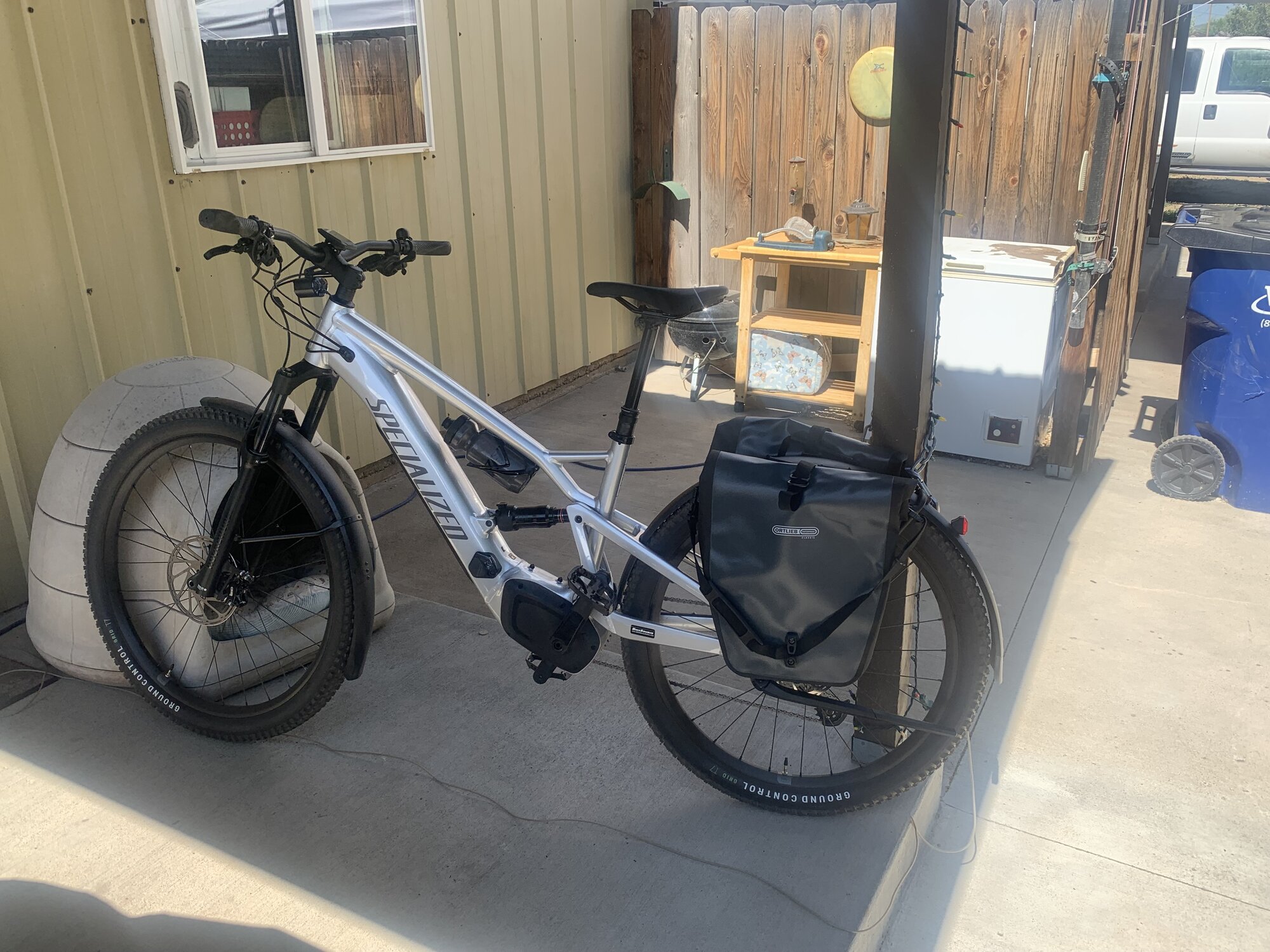

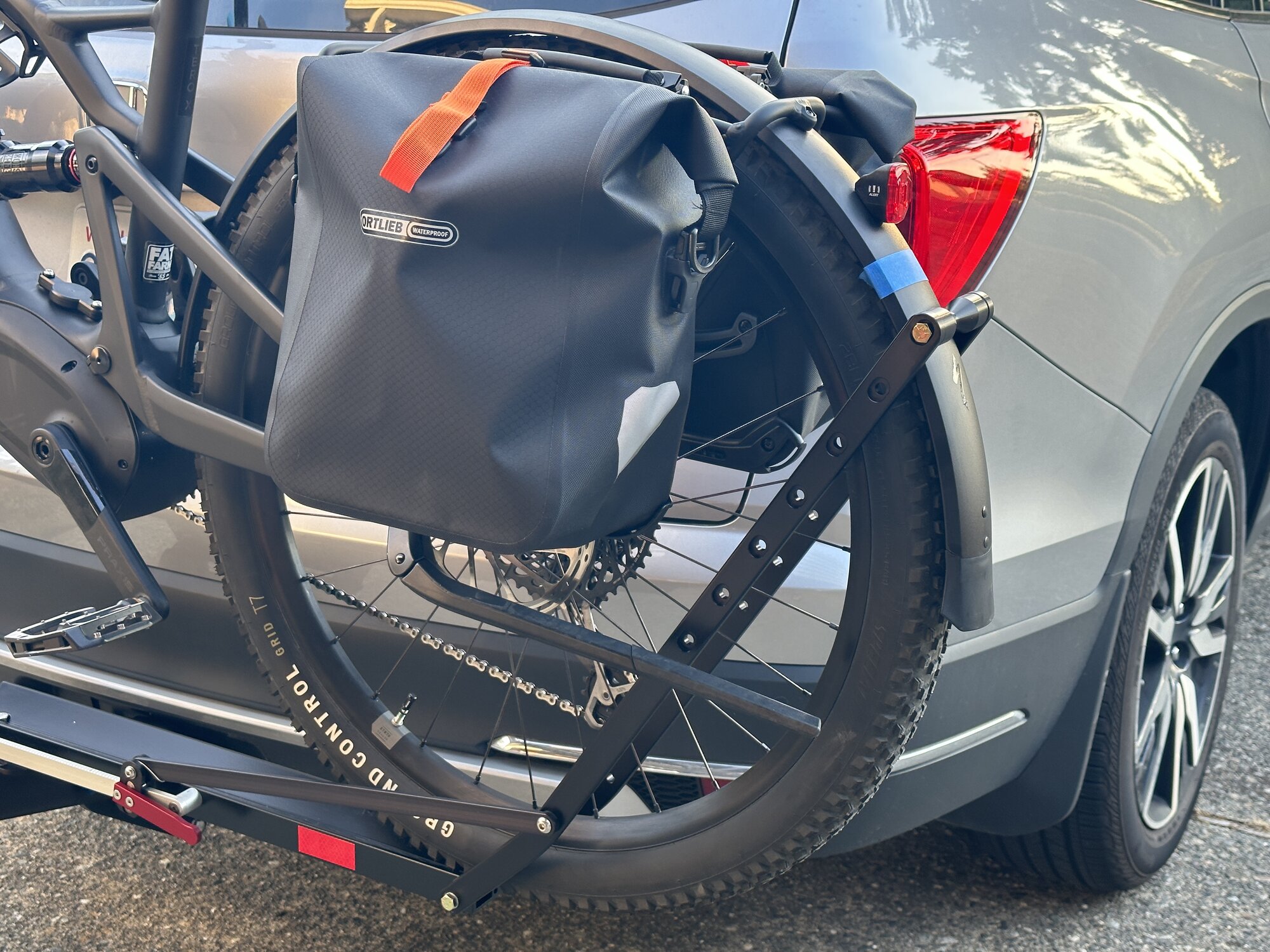

I just got my brand new Ortliebs today and did the mod/ they fit perfectly! One thing I noticed though is tuck the pull strap that releases the bags under the strap or something bc it kinda gets close to the tire underneath the fender.

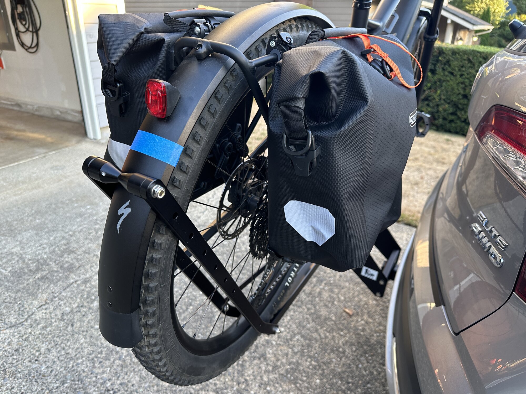

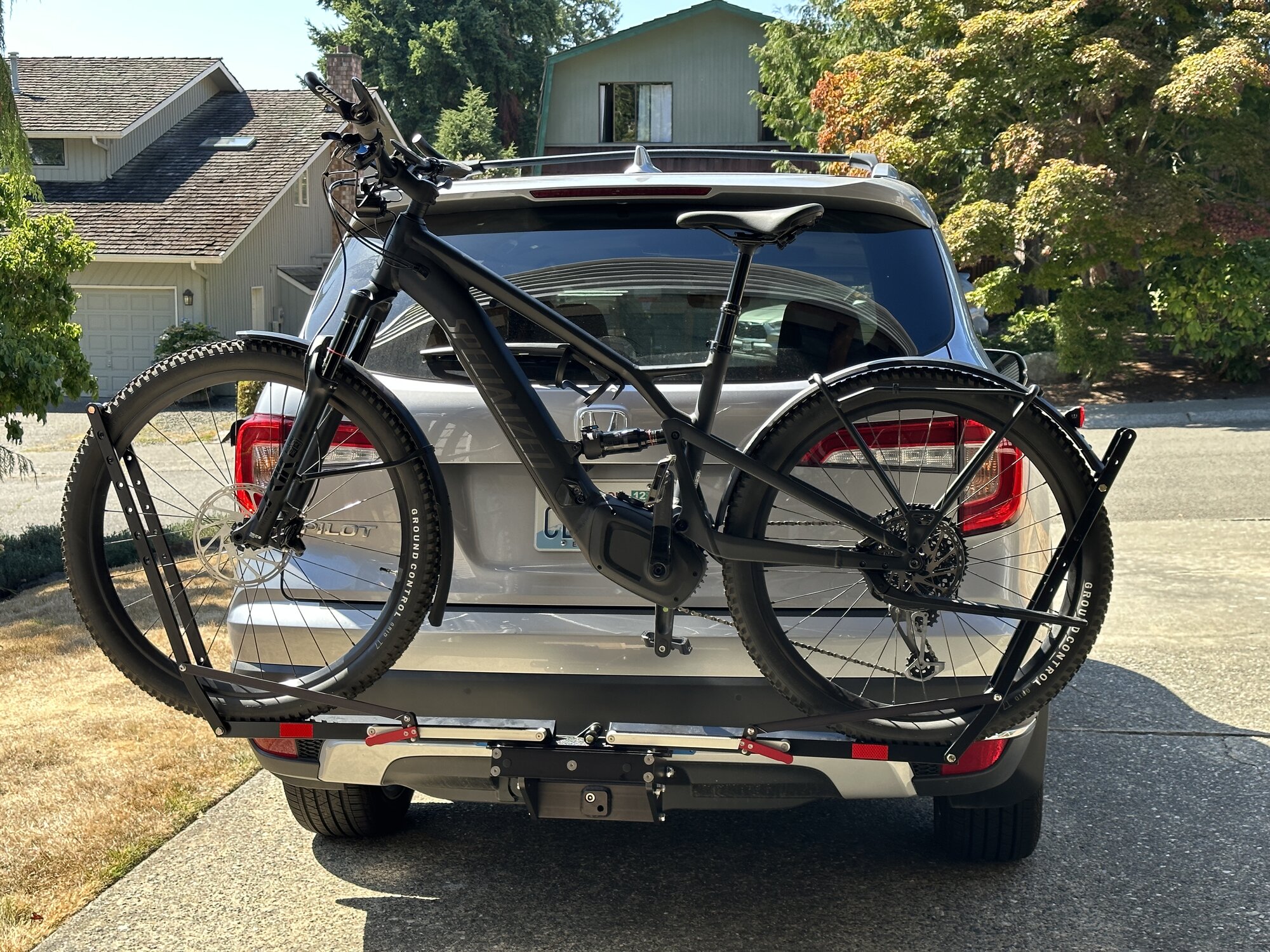

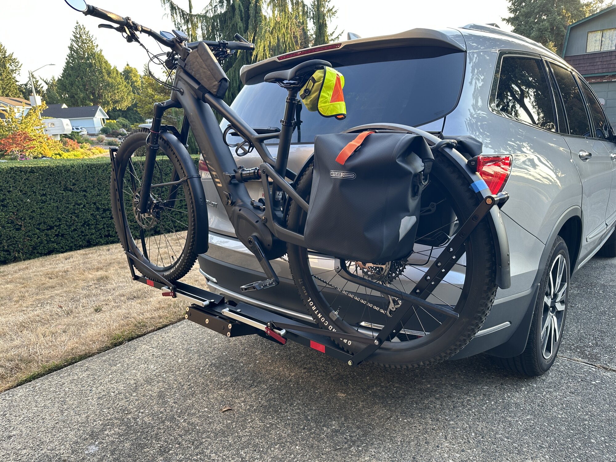

I have Ortlieb Gravel Panniers and they fit nicely. The blue table was marking where I trimmed by rear fender so the 1UP Hitch Mounted Bike Rack would work with the fenders. Works well.
