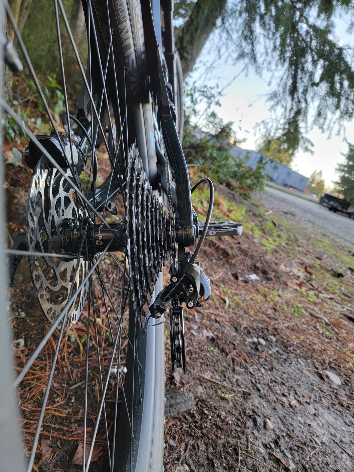

Hydra has landed!
Bling…

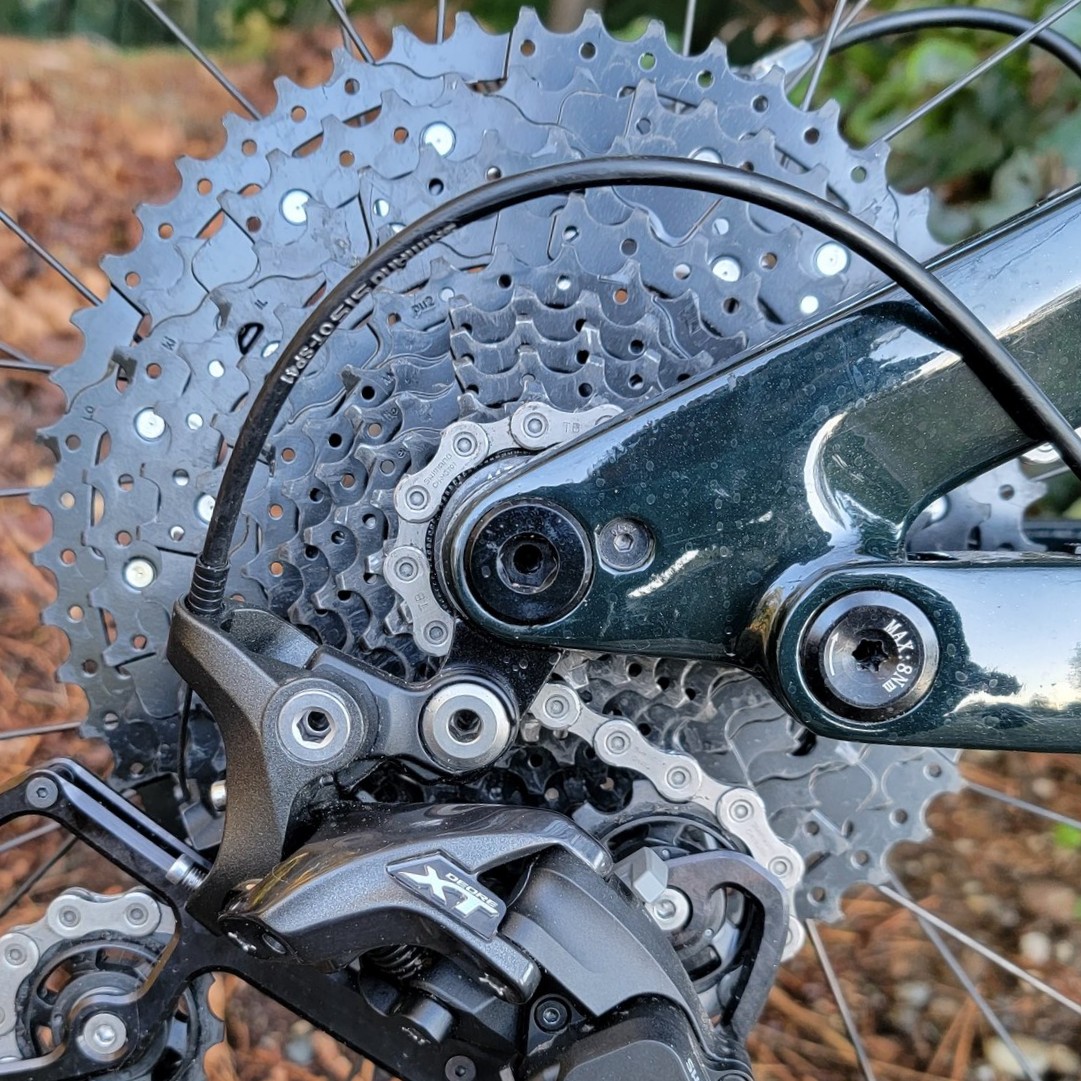

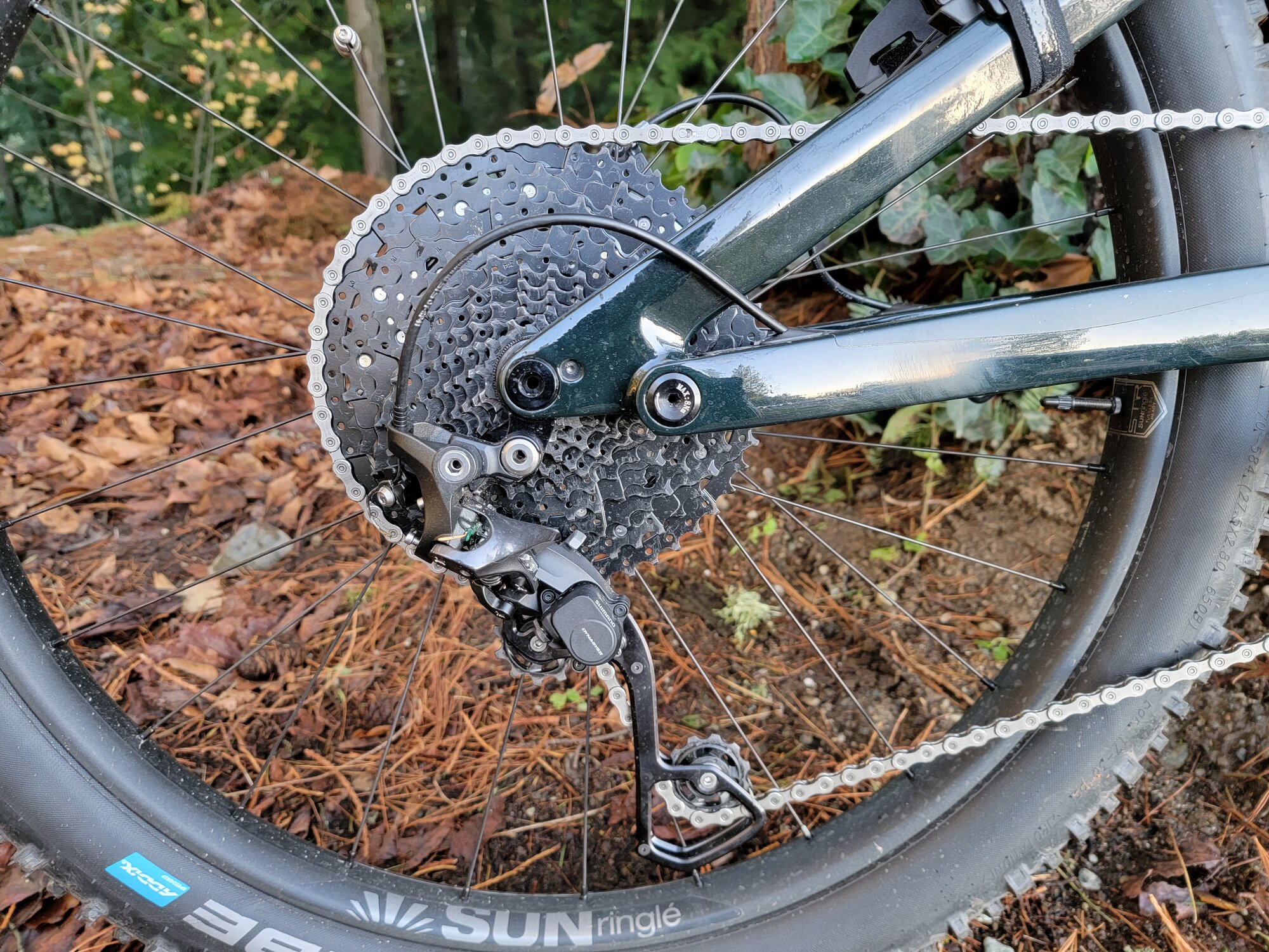

Note when you install the cogs, make sure the side where the 'stepping' goes the whole length of the... thingy... on the gear - the sides facing you in the picture - are installed facing outward away from the cassette. I installed them the other way around and noticed the big pulley could rub a little against the little lip in the cage.

Probably won't fit on the 8100 - not listed on there at least. If the length, axlie diameter/length/pitch, pulley position, and stopper pin placement are the same then you could try it out, but you definitely want to check for interference through the range of motion. The cage is a crazy close fit on the 8000 already

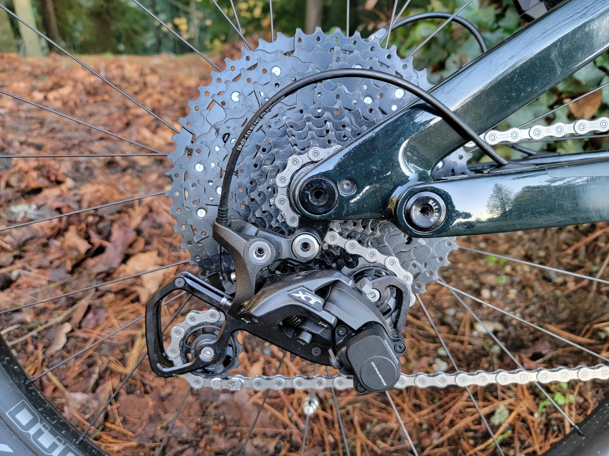

I didn't realize my derailleur hanger was bent during shipping until I put the M8100 on. I had to straighten it for perfect shifting. So, beware that the M8100 is less forgiving of misalignment.

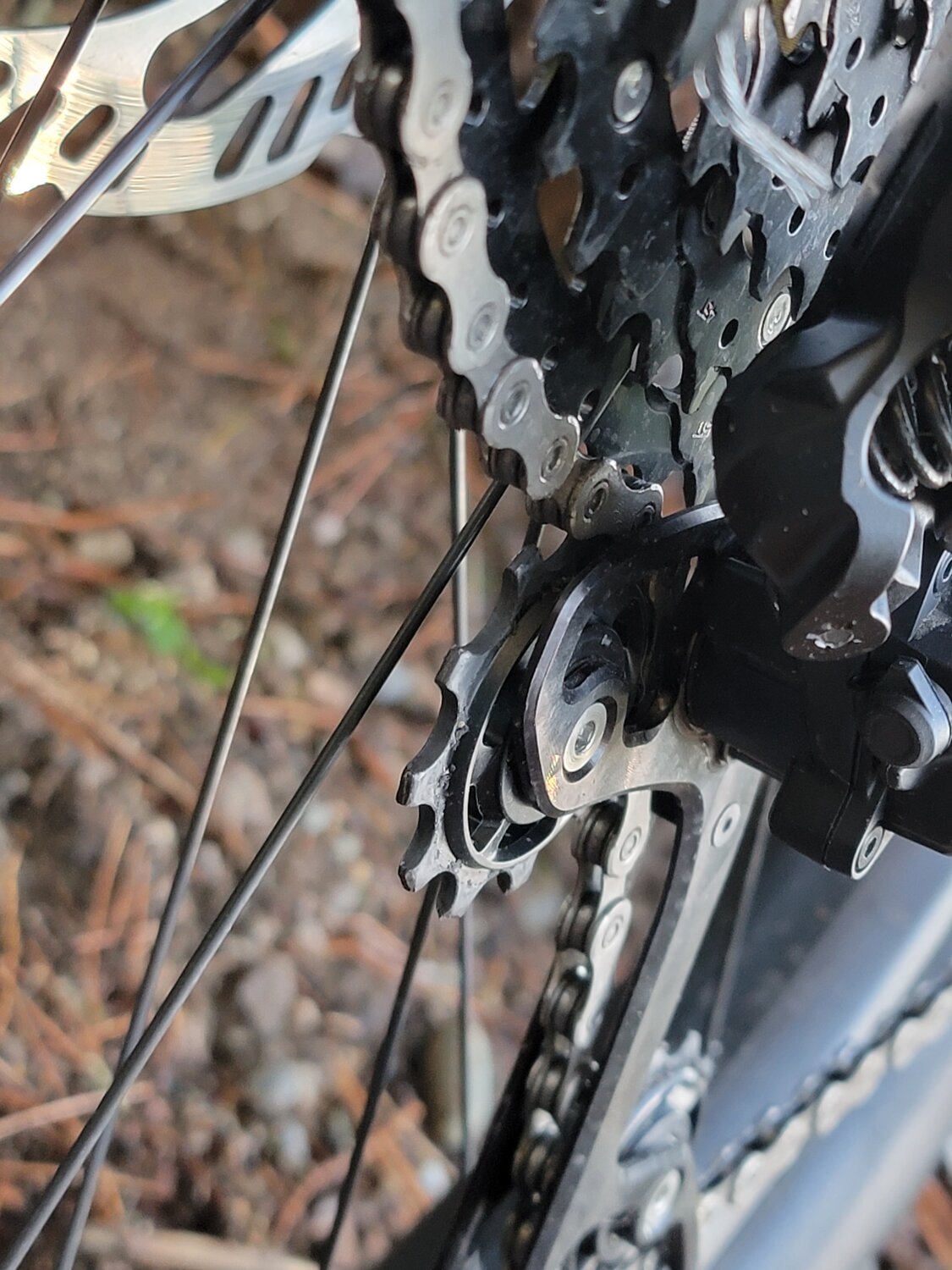

Another couple of pictures of the spacing in lowest gear, it's pretty close but I didn't notice any issues and I hardly ever use that gear anyways lol. Thanks to all for the help in solving these issues. Hopefully I'll have some rain free days over the break to enjoy it but I'm not holding my breath.

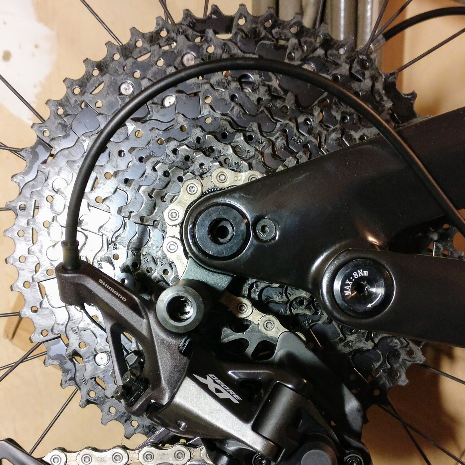

I just rode it for maybe 6 or 7 miles and had zero skips. Climbed some big hills effortlessly and just enjoyed riding it through the woods and on some streets nearby. Absolutely loving how it rides now!
That’s amazing news @kwseattle! Just becuse I have to hear it, you are using the 11t cog at speed without any skipping? Would you remind me on how much you pushed the front chain ring out again?

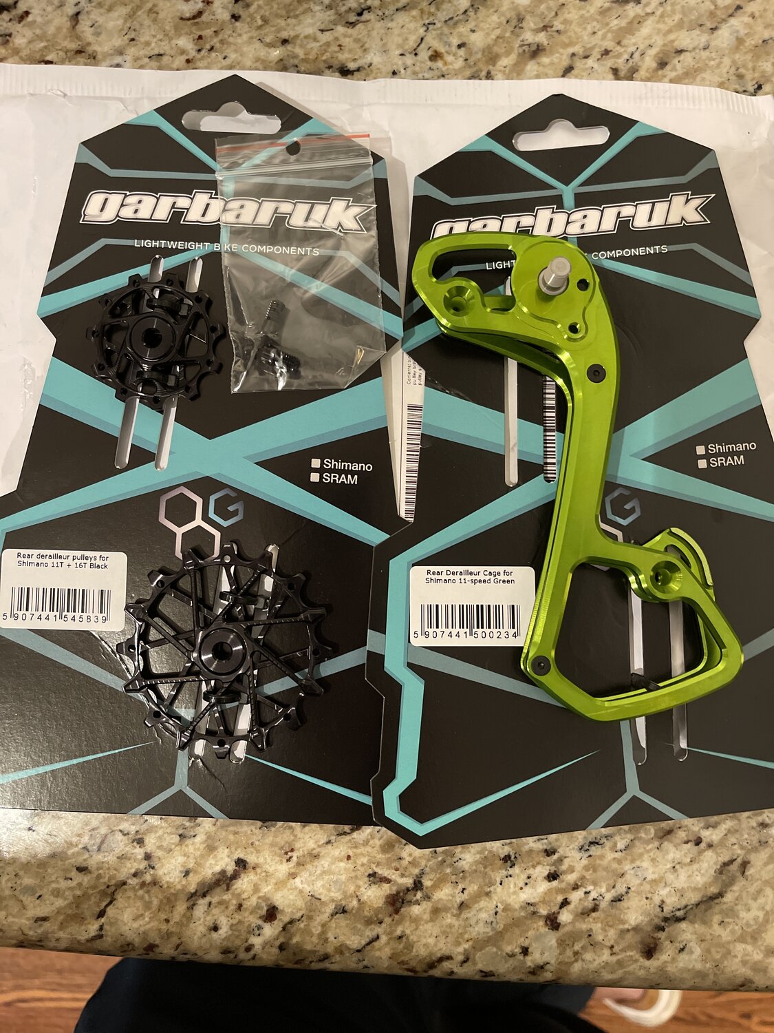

I’m sitting on the Garbaruk cage and pulleys and the M8100 has arrived as well. Two options to test.
Yes, using the 11t at full speed, pedaling hard, full assist in sport 5! No skips! I hit speeds I'm not allowed to discuss lol.
I flipped the front chainring to the outside of the spider, and added a 2.5mm spacer from Wickwerks (https://wickwerks.com/products/1x-chainline-spacers/) between the chainring and the spider. I added a second set of 2.5mm spacers on the outside so I could keep the chain guard. I found some 16mm chainring bolts on Amazon that I'm using.
