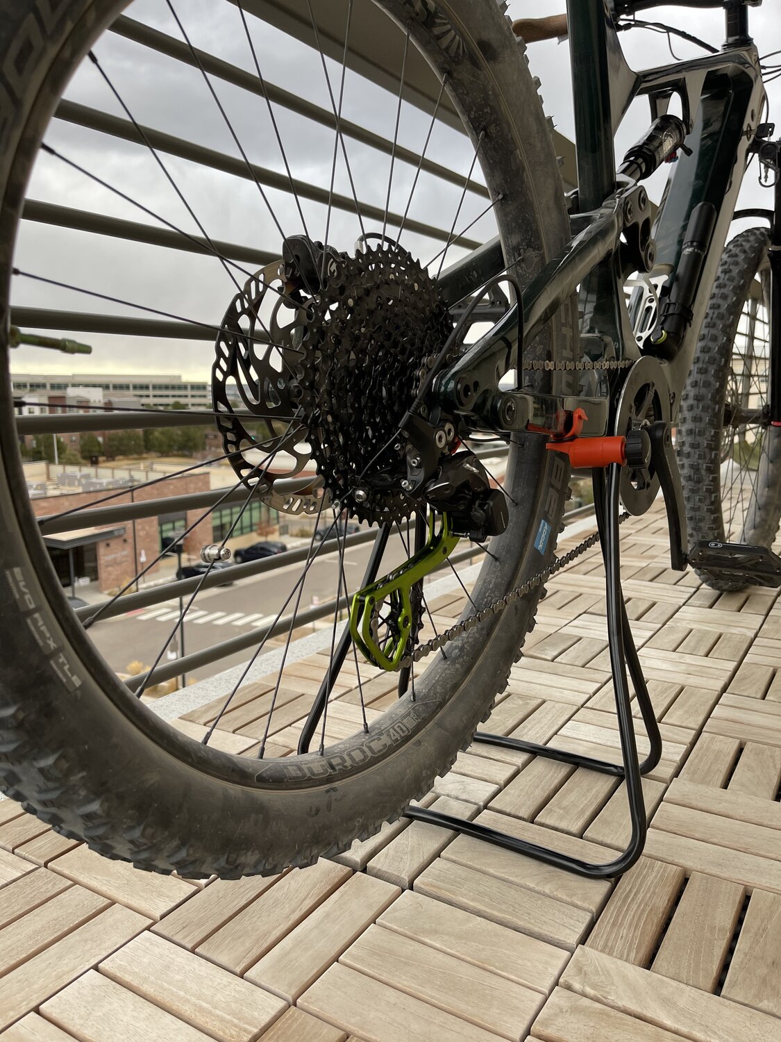

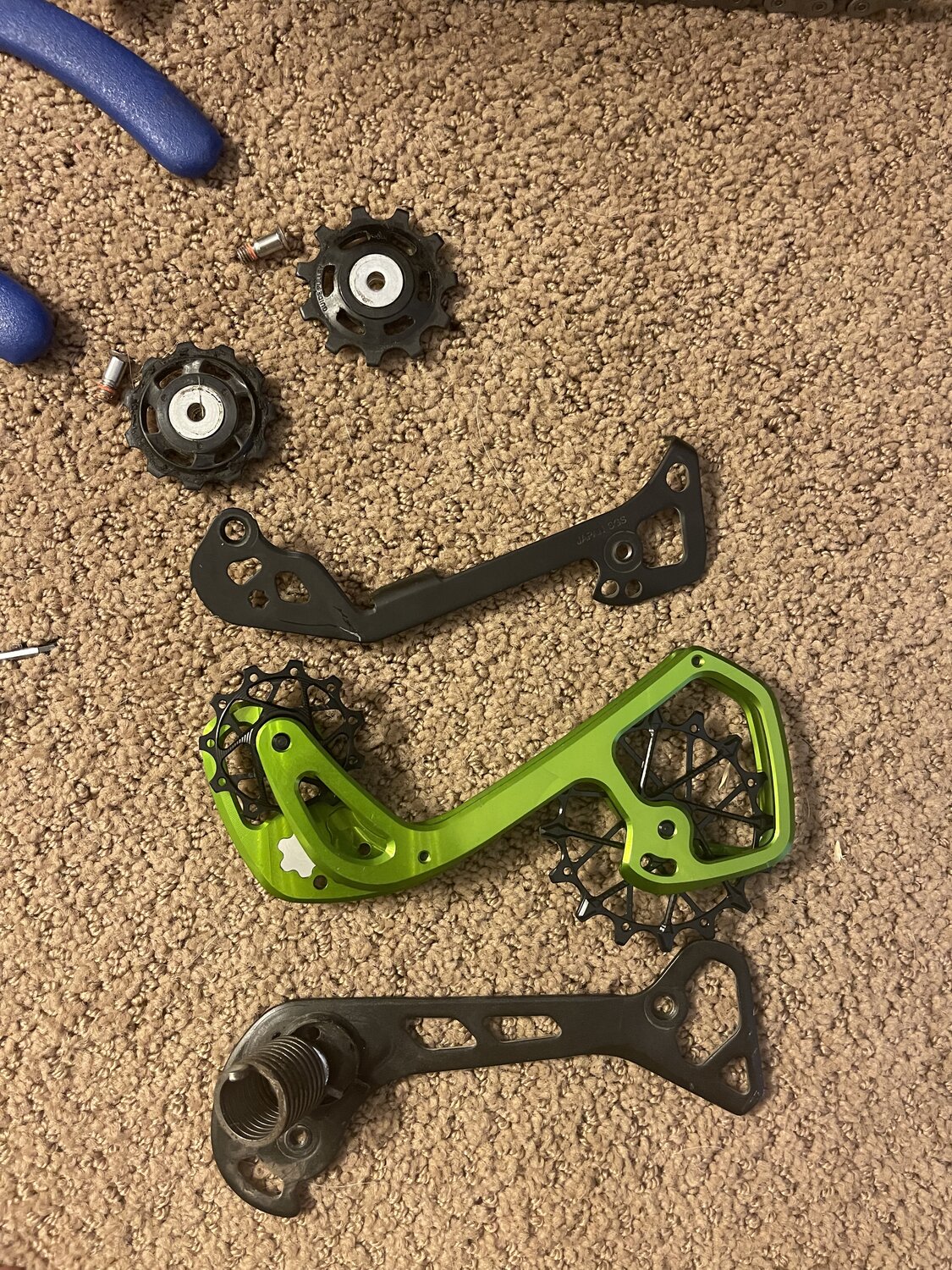

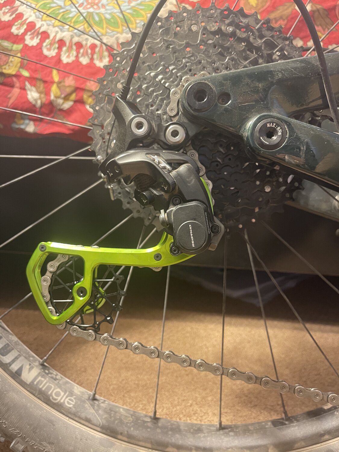

Quick update. Decided to install the Garbaruk cage and pulley system just to see impact. I still need to do a lot of adjustments to the derailleur but snuck a quick test ride in and seemed promising. 20 - 24mph with just a skip here or there. Looking forward to getting it dialed in.

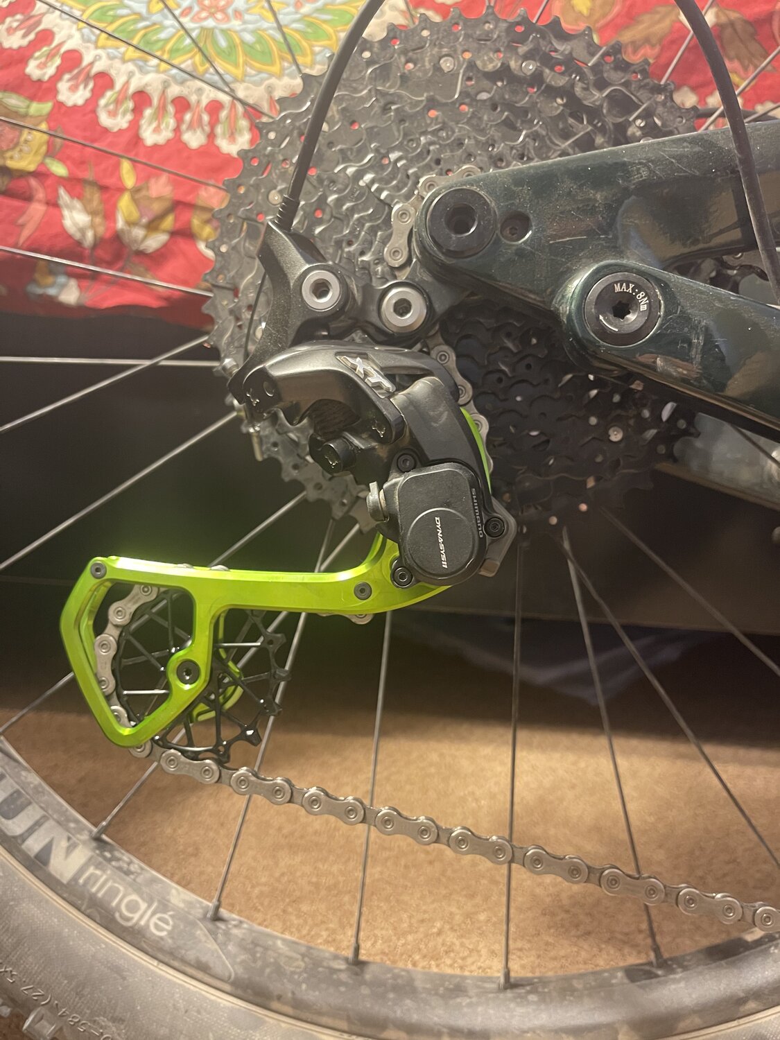

Wow I love that green cage! The eBay seller I ordered mine from only had black, but I would've ordered green if I could have so it would match my paint.
You need to adjust your B screw a bunch to get better wrap around the smallest gear. That will help significantly and was what finally fixed the problem for me. I stopped when I started losing tension on the bottom.

I just rode another 15 miles today, ZERO skips. I rode a mile or so of trail through the woods, then the rest on roads (with some steep hills) and paved bike paths. Took my battery from 80% down to 30%. I'd say that's fair given my steep hill climbs with level 2-3 assist. Still waiting on Innotrace, but I really want to lower the assist levels in 2-5 because just assist 1 is 500 watts on the meter. Level 2 goes up to 1000w, and level 3 1500w.

Yea, I have a lot of adjustment to do. Just glad even just ‘slapping it on’ has made things more positive. Really the first time I’ve ever touched a derailleur so working through it. Appreciate the good work you and @TDA78 have put into fixing this issue on the Hydra.

Check out this Park Tool video on Derailleur adjustment, this got me in working order! He didn't go super in depth on B screw but I just ended up adjusting it a ton until I started losing tension on the bottom, like I mentioned. It was very helpful for limit screws and indexing though!

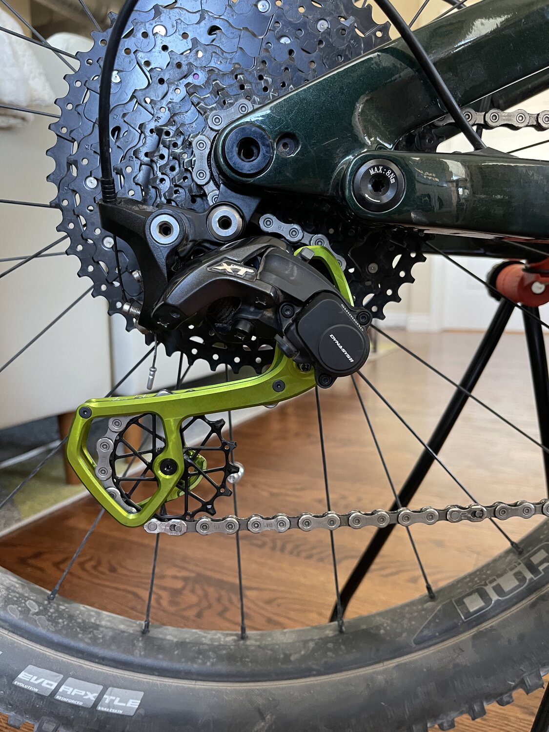

Ok… it’s done for now. Flipped the chainring to the outside of the spider which definitely helps with the chain stay rub. Spacers to retain the chain guard. Sort of by accident ended up replacing the bafang 44t chainring with the Wolftooth 44t which is a lot lighter - not that it matters. Garbaruk cage and pulleys…
After a better test ride I would say that although the bike still isn’t completely happy when using the 11t cog, it’s very much improved, and with a little more fine tuning the skipping will be hardly noticeable. Thanks to all who helped here and contributed experience and knowledge @kwseattle @TDA78 @loamoaf and @Deacon Blues
