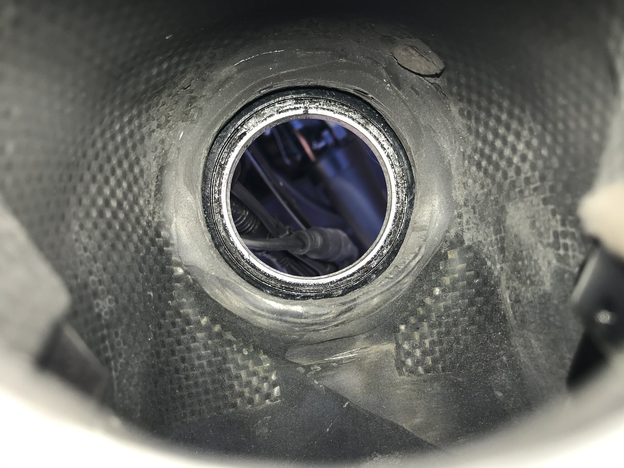

Wiring question. i was checking to see if the 2 red higo plugs for the brake cut offs were stuffed in the head tube of my hydra.
they were curled up along with another wire that looked like it was snipped off by someone, or accidently when assembling the bike.
see attachment drawing, it is approx 1 foot long and on the motor side of the splitter . anyone out there know what this might be for.
not sure if it got cut by accident

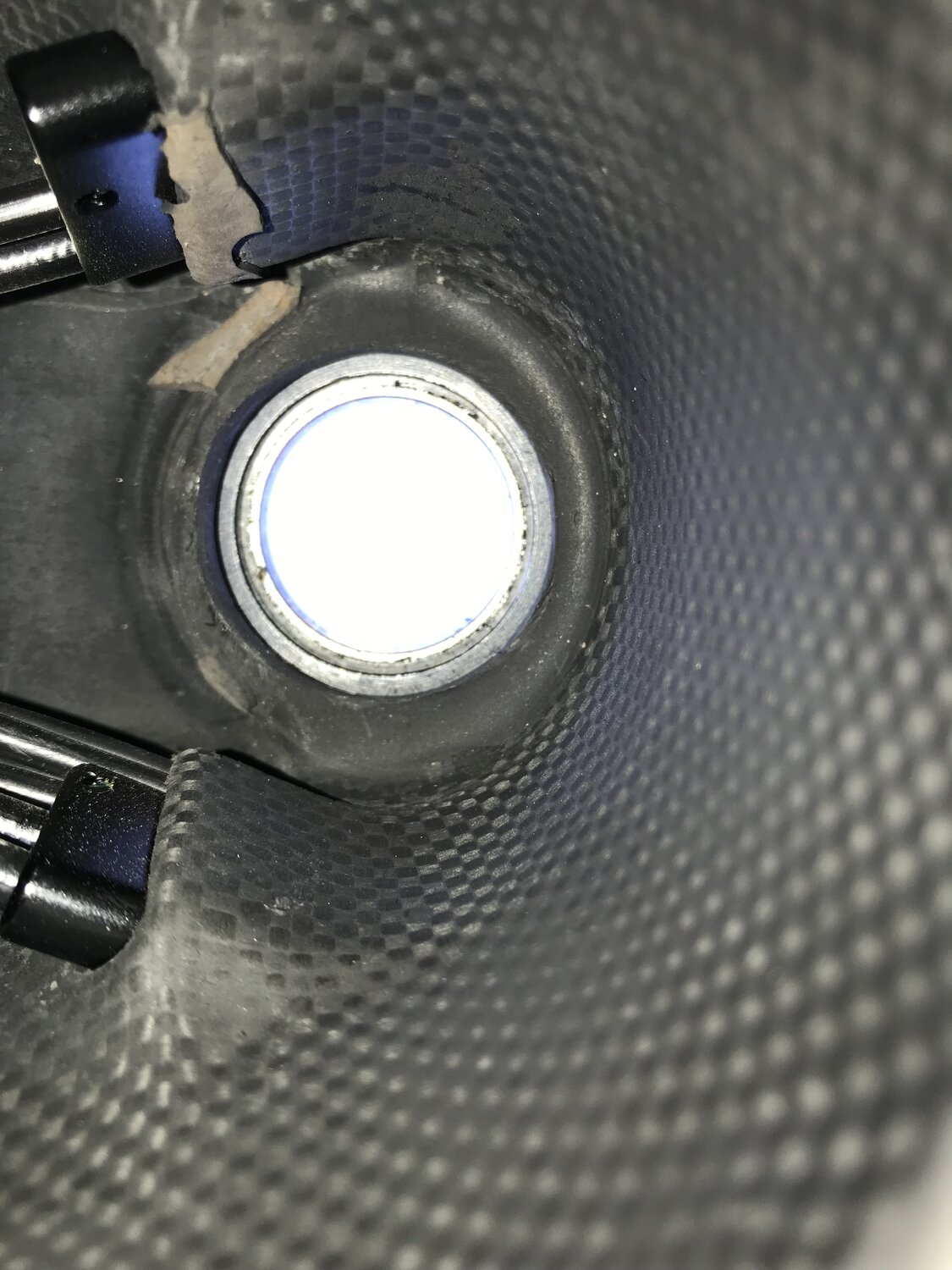

Light??? I have the same in my frame. Took out fork and noticed it too…. (What it looks like inside!)
IDK!
-BB
hello BB, it is on the motor side of the splitter which suggests that it came from the motor harness ??????????
it is not for the brake cut offs, as they work.
Yes, and why I am thinking LIGHTS with the Bafang light button and claimed light chip we are all missing....
Else IDK...
-BB
Not sure same thing but the m600 motor has a wire that will directly plug into bafang battery packs. Supposed to help with monitoring cells.
there are also a couple light wires.

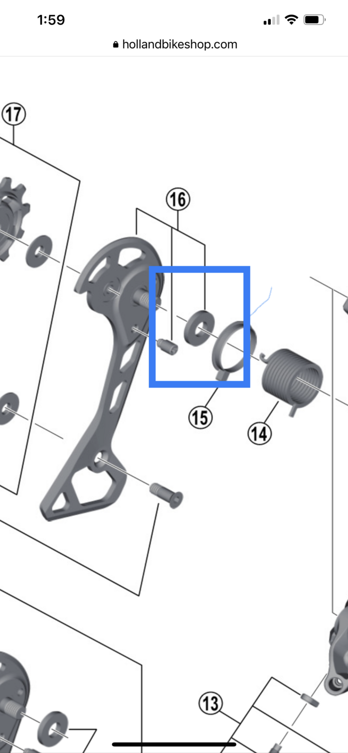

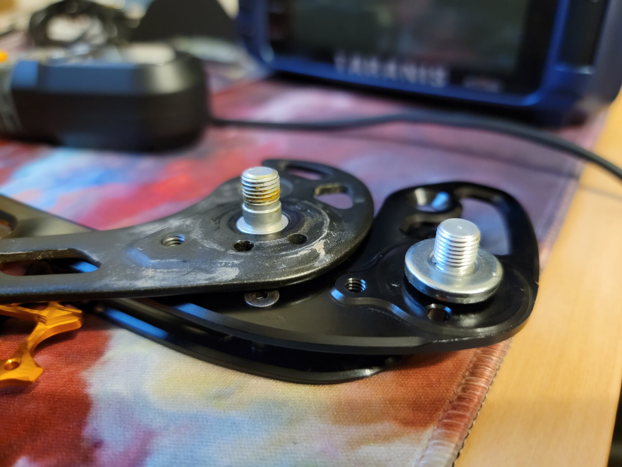

The big bolt cage pivots on, the stock cage has a big washer/bushing on it, is that supposed to be reused? It doesn't really seem to fit?
Doh sorry I'm dumb, I should have cleaned up these parts first.. some piece of dirt or something was preventing washer from just sliding on and I thought it wasn't fitting. Cleaned them off with paper towel to see better and then it just slid on, hah.
