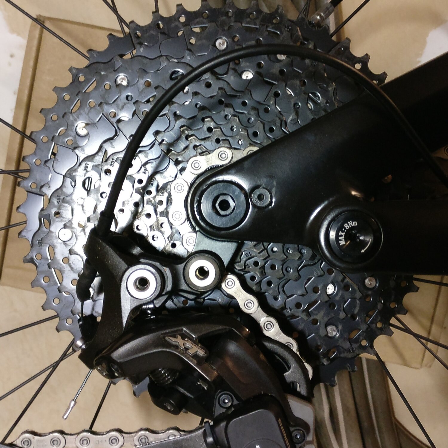

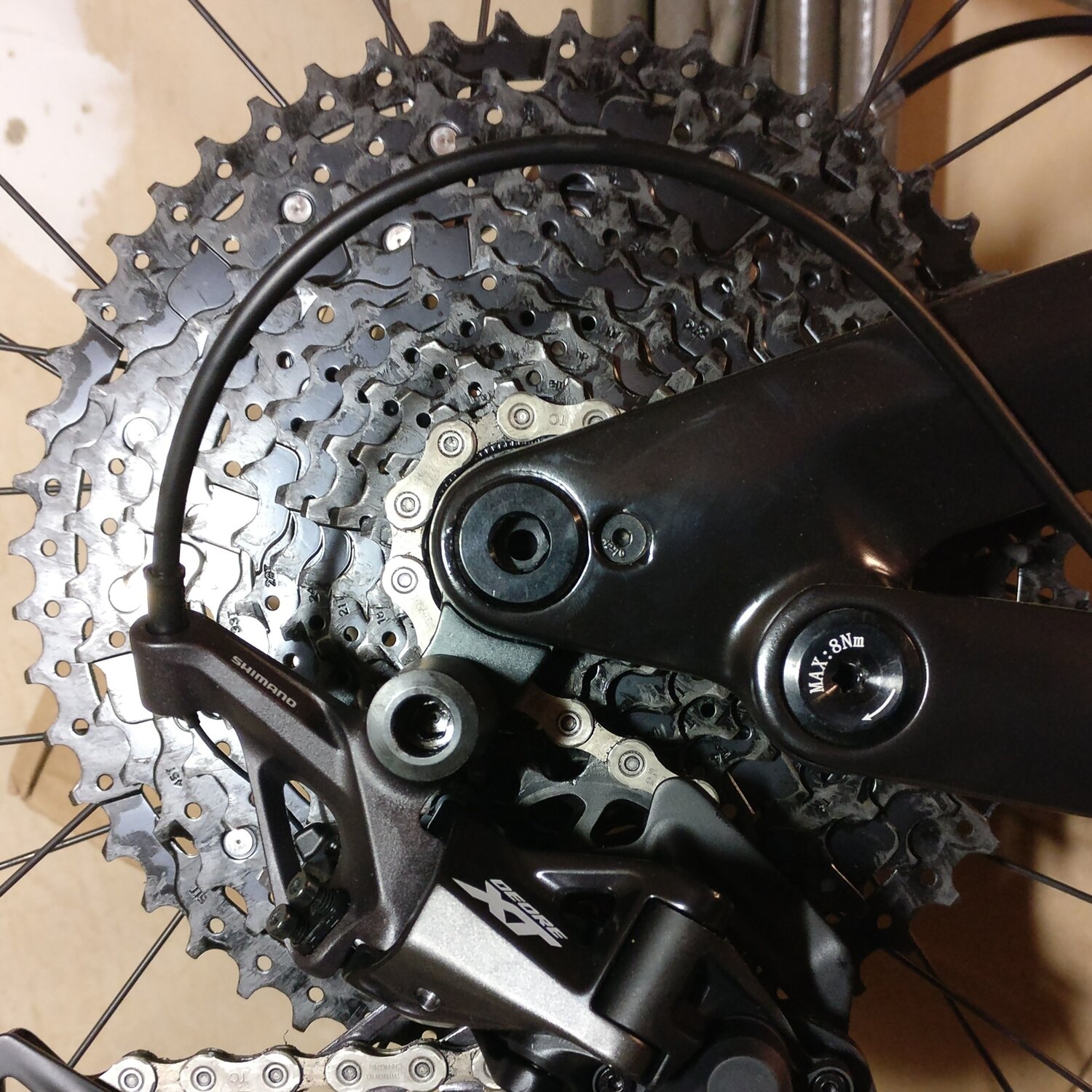

I tested the M8100 derailleur with the 11-51T cassette. I could only make the 11T skip once on two passes before the battery hit the 50 amp shut down. The B screw is adjusted closer than recommended. This is only a problem if you're pedalling slowly and downshift 4 gears at once causing the cage to crash into the cassette.
Here is the supplied M8000 for reference.

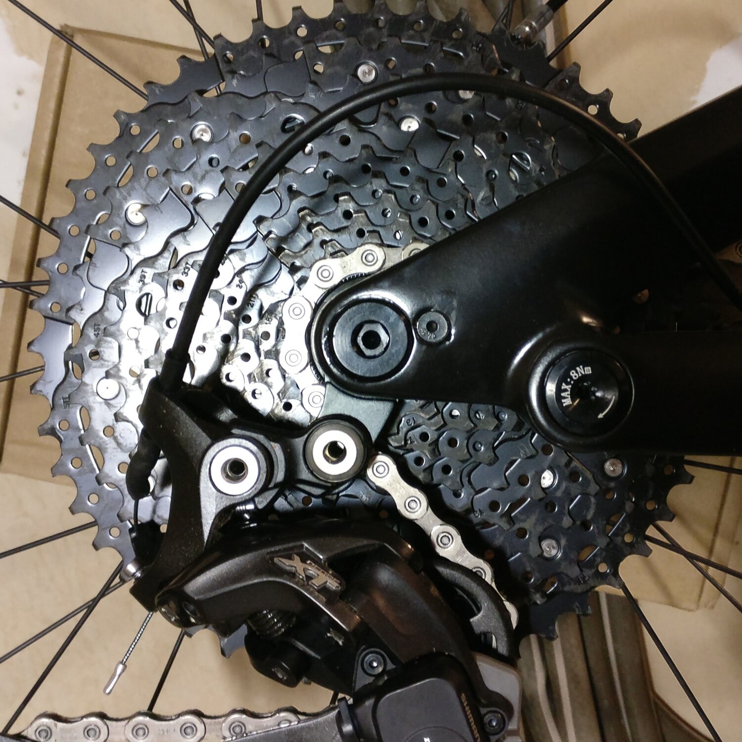

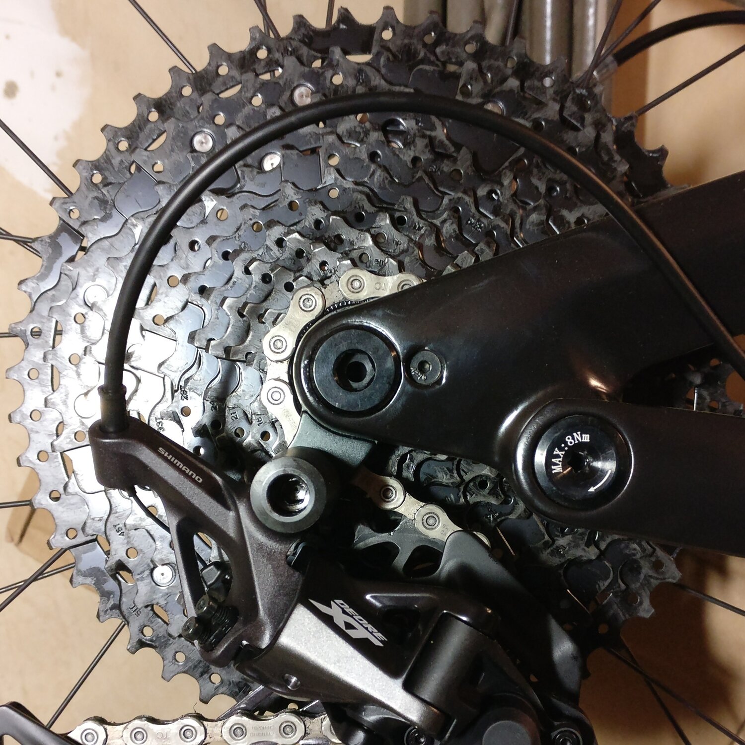

Can you tell me what I'd look at in these to photos to see the difference and how the 8100 reduces skipping.

@Lsthrz take some pictures and compare the 8100 cage to the Garbaruk cage if you haven't had the opportunity to cancel your order for the Garb when they arrive. More than likely a very similar position of the guide pulley (the one closest to the cogs in the cassette)
@Deacon Blues look at how close the guide pulley on the 8100 is to the cog compared to the 8000. If you were to adjust to get the close on the 8000, it would run into interference issues on the taller cogs. Draw a straight line where the chain is straight between the two (cog & guide pulley) and if you rolled the 8000's pulley back along the chain to the same general position the 8100's is, there would still be a wider gap between the the gears. An easier way to spot the difference is look at the chain link's position where it crosses behind the derailleur hanger. The 8100 is getting at least 1 more tooth of engagement as well. What's the range of your 8000 cassette? If it's 11-46T or smaller you shouldn't need the 8100
