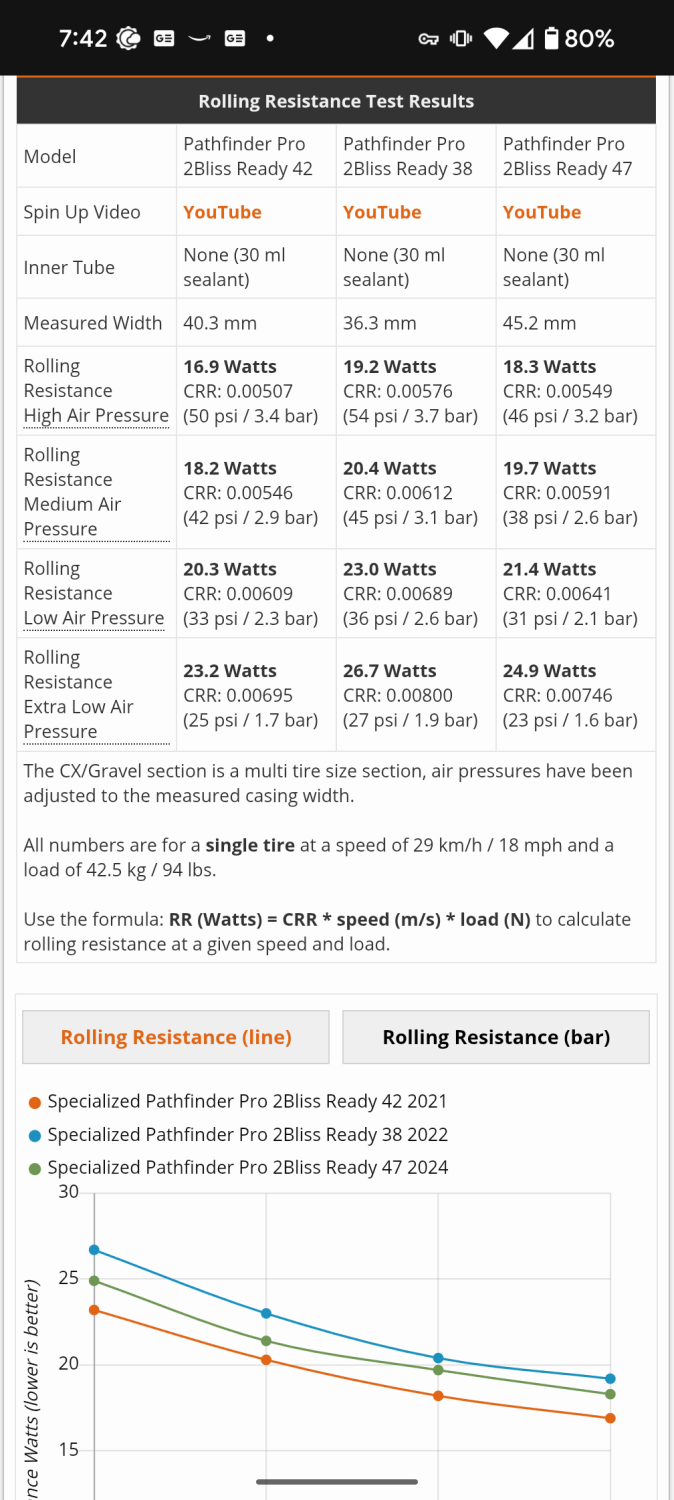

Per BRR, Crr = 0.00641 for the tubeless 47 mm Pathfinder Pro at 31 psi. But Crr = 0.00689 for the 38 mm version at 36 psi. That's a 7% difference! Unfortunately, need to pay to see the 47 mm Crr at the 38 mm pressure.

And that's the rub - how do you even compare tires of different sizes with so many variables. But comparing at the same pressure would not make sense (you would get an even greater difference in favor of the 47mm). Higher volume tires take lower pressure to reach similar comfort/stiffness. That's why BRR scales the pressures with measured width.
One of my issues with that is they use rims with 17.8mm inner width for tires from 30mm all the way up to 50mm. Modern gravel bikes are going to have rims at least 24 or 25mm or even wider. The 47mm on an SL2 rim would have measured wide enough the BRR would have used a lower pressure for the 'low' pressure. Anyways it's a slippery slope to try to control all those variables and come up with a precise result. At least you're not trying to compare tubed and tubeless tires on BRR - that has its own issues there.
Thanks for that comparison table and graph. I don't think all those worms would fit in just one can.
I know that in 2025 we're way past all the old rules of thumb regarding Crr and tire width and pressure. But it's still interesting that the 42 mm Pathfinder had a consistently lower Crr than the 38 mm at corresponding pressures. What do you make of that?
Problem is, if there are no good rules of thumb left, and available Crr measurements are also suspect, any hope of quantifying rolling resistance differences between bikes is out the window.
I agree, there's either a problem with the data, or the tire compound has changed over time. It would help if BRR tested multiple samples of each tire. Also, the 2 older tests were run with tubes and then the tubeless Crr was later calculated when they updated test protocols.
From the BRR conclusion of the 47mm test(2024):
When it comes to rolling resistance, the biggest version of the Specialized Pathfinder Pro falls right in between the 38 and 42 mm sizes. We're unsure if we can draw actual conclusions about the rolling resistance based on our samples. From the looks of it, and because our samples are from 2021, 2022, and 2024, we suspect there to be a manufacturing tolerance, as the numbers just don't seem to make sense.
This is more the type of result you would expect, but these are all from the same recently updated lineup and tested within 10 months of each other

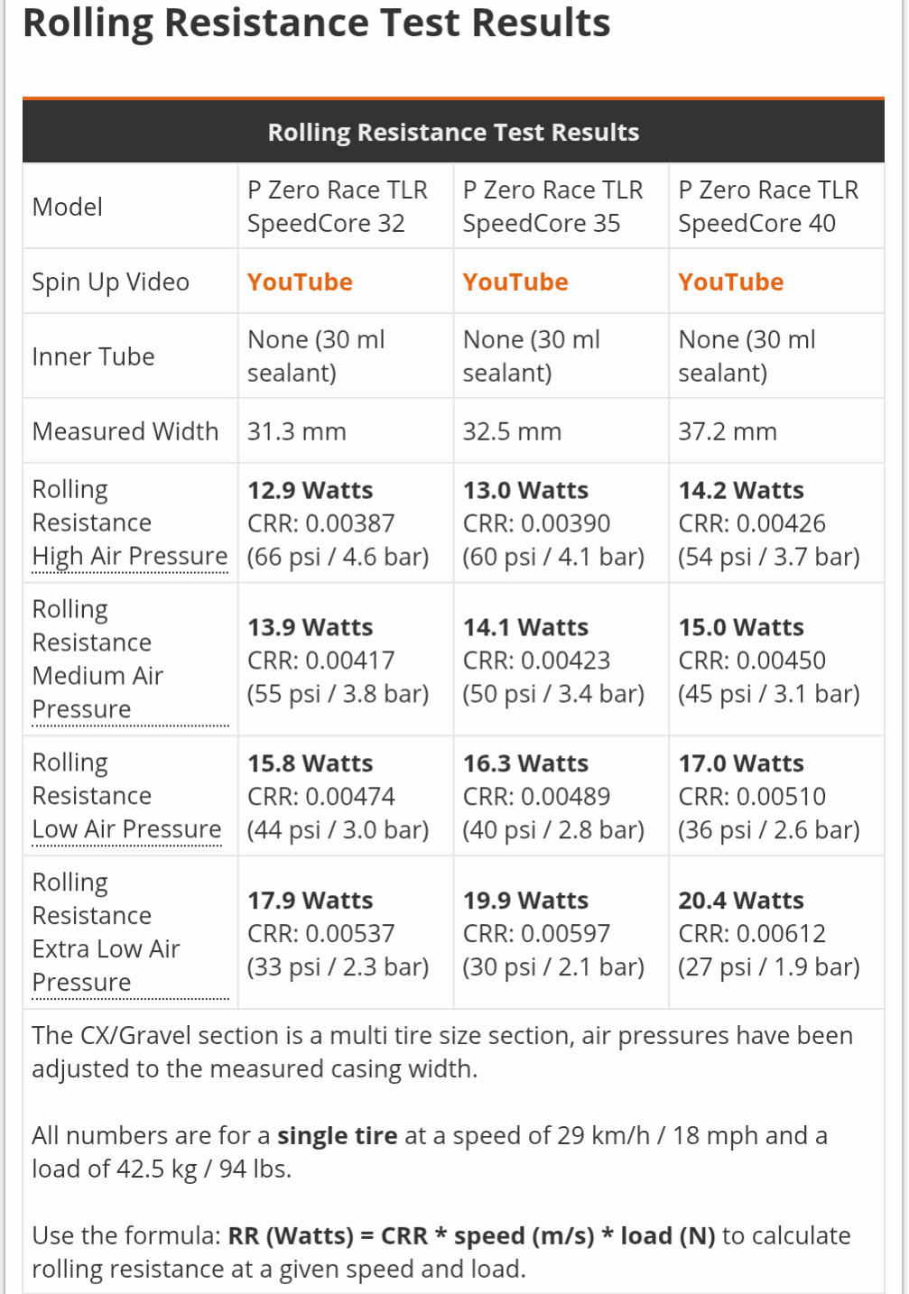

Sure would be fun to try those 40 mm P Zeros on my SL at 45 psi, but too much offroad around here for routine use.
