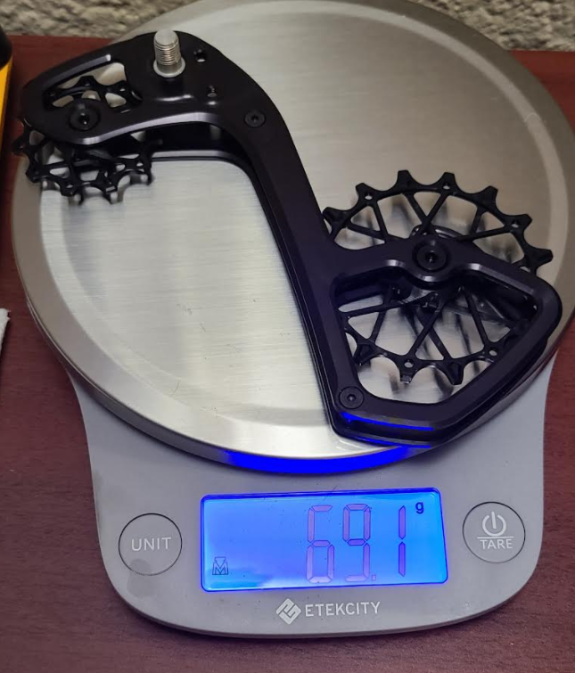

Wow that looks amazing! I definitely might have to pick up some of those pulleys soon...

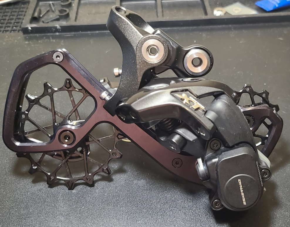

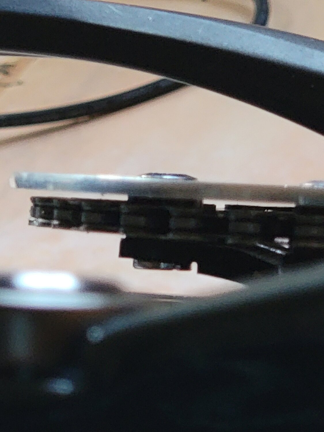

I just finished swapping my chainring to the outside of the spider, and included some 2.5mm spacers from Wickwerks to space it out even more. I used an additional set of spacers to keep the guard in place. I used a ~16mm set of chainring bolts from Amazon. The chain cross is significantly reduced in the highest gear, so I'm hoping that fixes the skipping! I also need to adjust the derailleur limit screws because I can visually see that they're off - I should probably do a full derailleur adjustment. I'll try and work on that a bit before my next class because I think that might be contributing more to the chain skipping issue now.

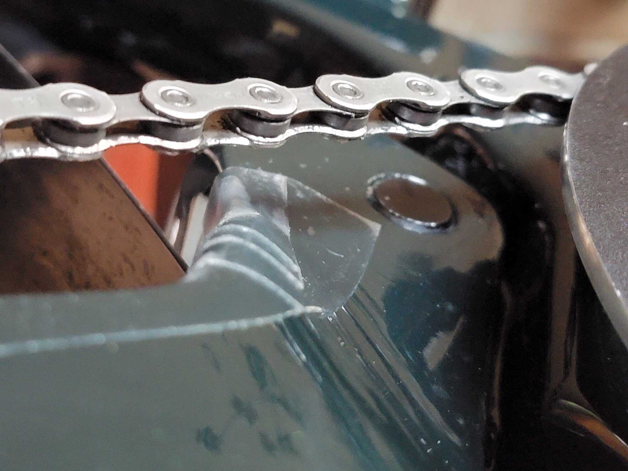

The chain also has much more room between itself and the chainstay which is what I was going for, @pushkar I think in future builds you should consider mounting the chainring on the outside with some spacers to prevent that chainstay rubbing issue - and place some protective film on that part of the chainstay as an additional protective measure.
Kind of hard to see, but here's a closeup of the chainring and spacer stack.

Deacon did you try flopping your chainring outboard? Even without the spacers it should help the situation and if it does then you could surmise that the spacers to get it set properly would correct it completely. You shouldn't need the cage for skipping but more for getting enough engagement on the smaller cogs to not tear them up (if you have your b screw adjusted to clear the tallest cog properly) - 2 separate issues that have semi-similar symptoms. 'tick-tick-tick-tick-tick-tick' vs 'tick-ticktick-tick-ticktick' if you want to get into the technical jargon of it all

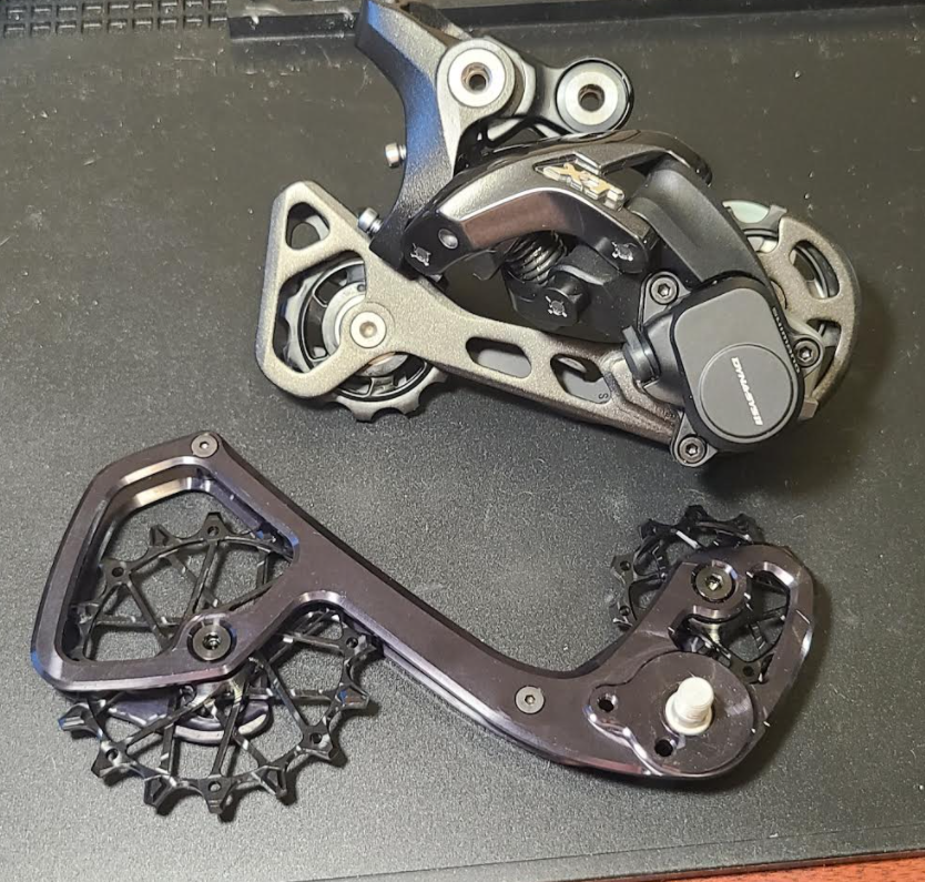

Second that! I just got this in today used and cheap. I have the full system with the big pulleys on its way from Garbaruk (not as cheap) as well. Seems the chainring spacing is the bigger issue though.

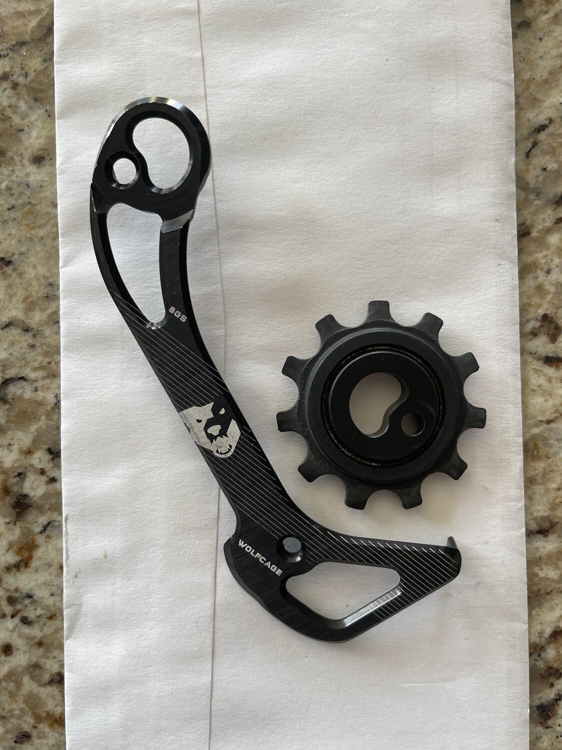

@Lsthrz take note the eccentric pulley on the Wolfcage won't work the same with the Garbaruk pulley in its stead - you may want to check the fit with the stock pulley on the Wolfcage as well as it may not be big enough to take the 16T pulley. Oh wait I just read you have the full Garb setup on the way too ha. The Wolfcage reuses half of the original cage (easier install without removing the derailleur, when swapping the Garbaruk cage on mine it was clear you can't really swap the whole thing while keeping the derailleur on the bike). So you luck out without having to go through the full derailleur setup on yours.

In other news, SUCCESS! The chain cross is much better in all gears and the skipping seems to be almost entirely eliminated in top gear. There were a few slips on the highest gear but I think I just need to play with my derailleur adjustment some more once I have more time, it's not perfectly aligned yet.
Summary for anyone else having this issue:
  • I swapped my chainring to the outboard position on the spider and added a 2.5mm spacer.
  • Replaced the Shimano Deore XT (M8000) derailleur cage with a Garbaruk 11 speed cage.
This has appeared to resolve both the chainstay interference issue and the gear slipping issue.

Improving a design that has the chain eating into the carbon chain stay and an inability to use all the gears smoothly on a bike is just valuable feedback to WW. I haven't seen anyone (recently ;) ) on this thread vilifying @pushkar or the Company. In fact, I'd say it's been a pretty positive 'how can we make this better' input from a number of us.

Using the b-screw to get nice and close to the little cog should help with skipping but there's definitely a limit to what can be asked of such a tiny cog, but cool to hear it's mostly solved. My chainring came in the other day and it looks like I need some 2.5mm spacers to get the chainring on the outside of the spider as it's directional and only has standoffs machined into the ring for mounting inside the chainring. Trailforks seems to help with finding ebike-friendly trails. Looks like in town it's St Edwards State Park & Blyth. You could try your luck at Soaring Eagle too, but I'd try to find if there's any "No ebikes" signs there first. I haven't been in a while. I'm currently trying to snag bobcat I bumped into on a camera trap at St Edwards, it's a nice park but idk how the mtb trails are - but they are ebike friendly. That's probably where I'll be test riding before I set out anywhere else since it's so close. Mukilteo & Whidbey look like they have some decent mtb trails open to ebikes as well. Sucks that a lot of what I see with the filters is mostly access roads or super double triple black diamond kill yourself moto trails.
