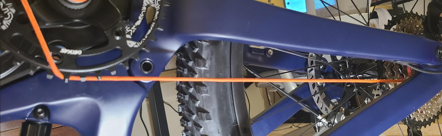

Check out the chain cross on my bike:

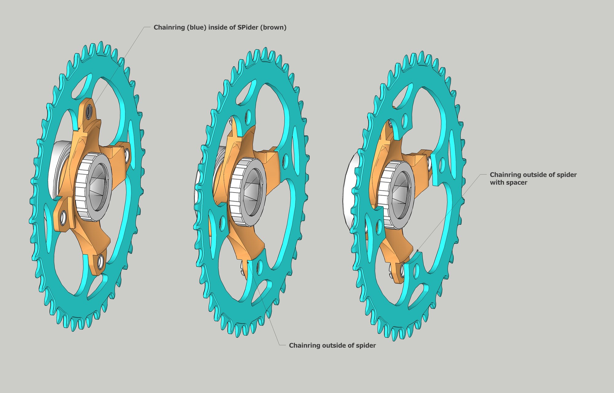

I agree with the others, if your chainring is mounted on the inside of the spider, you definitely want to start by putting it on the outside and see where that puts you.

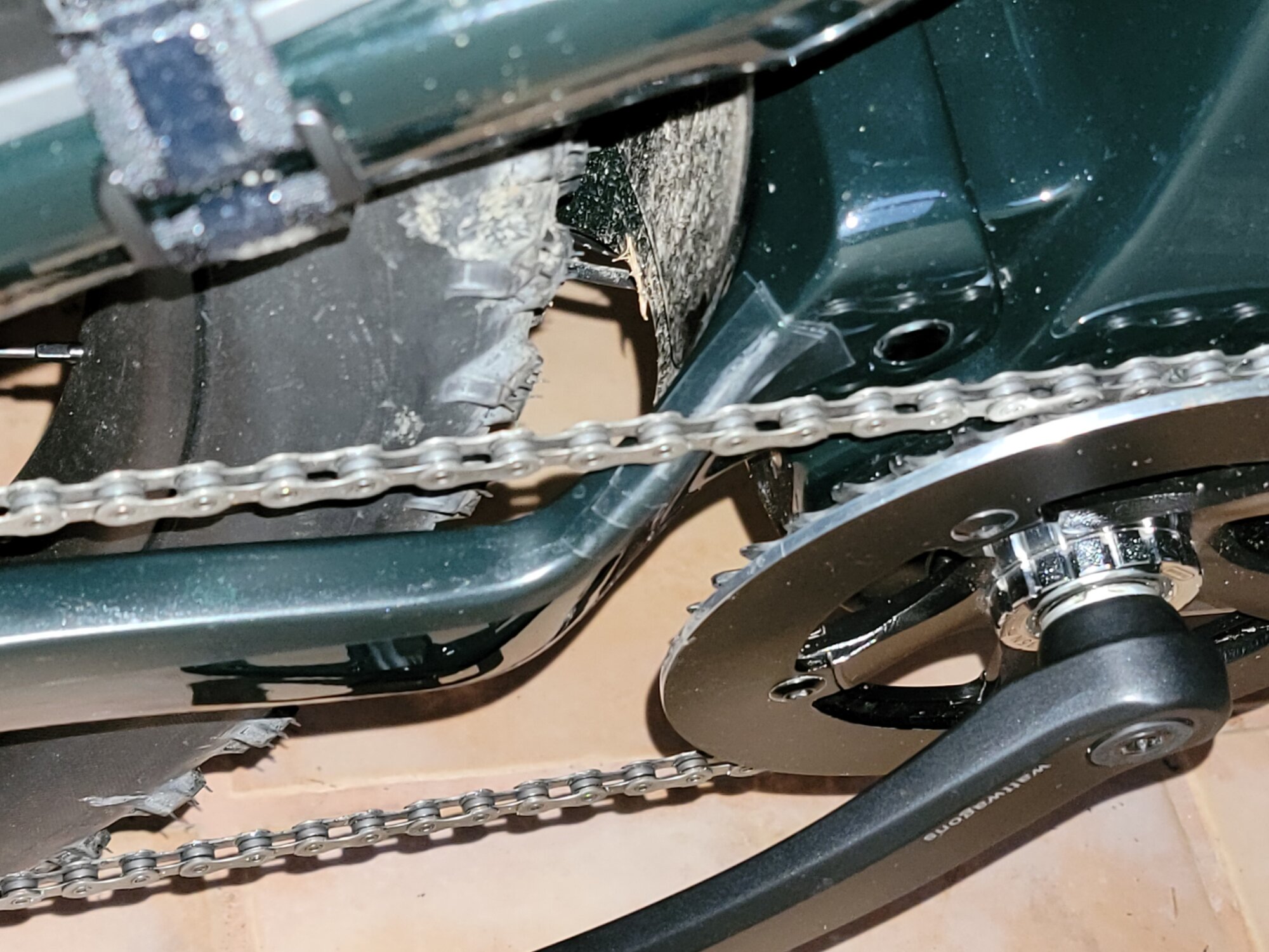

Yeah I'm going to be looking for spacers to see if I can eliminate or reduce this issue. I'll probably wrap some vinyl over the chainstay to protect it for now.
Definitely check if your chainline looks the same as Deacon Blues'. Moving the chainring to the outside may reduce or eliminate your rubbing issue.

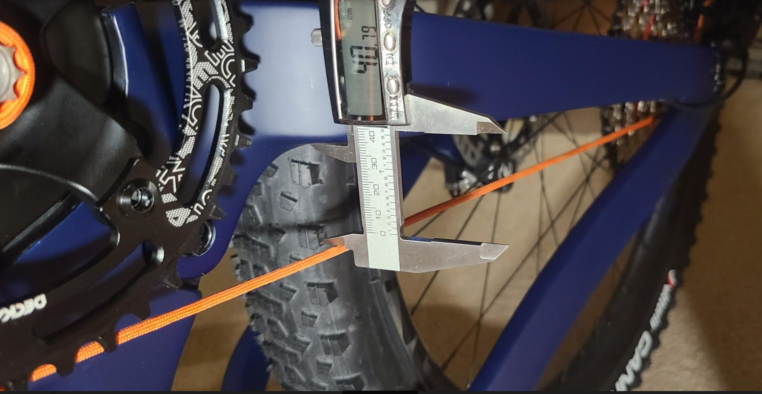

Holy crap @kwseattle that chain on the CF is exactly what terrifies me about the tiny tiny clearance I have on my frame on the 50T chainring I have. This is what mine looks like with the rear suspension fully extended (paracord instead of a chain since my new groupset is on the way and this is my backup M620, but you get the idea...) - I've got a whopping 40mm where it crosses the stay! Note the frame is intended for a 184x44/185x45mm shock, but I'm running a 190x50 with a single offset bushing with a 2mm offset, so it's extending the suspension are just a teeny tiny bit more than it would stock, meaning I have less clearance than I normally would. This is on the 11T cog of the 8spd I'm switching out

Butyl tape (think like dynamat) will do wonders to protect carbon stays from chainslap but you probably need something with backing to cover the butyl or it'll collect lots of dirt. I think there's some rubber foam tapes kind of like mouse pad material that are nicer but I've not reached that point yet

This brings up the question though... how many other Hydra riders are out there sawing their chainstay off?
Yeah I've got some clear vinyl that I put elsewhere on the bike I'm going to use in a couple of layers in that spot.
After I'm finished messing with my throttle I will take a look! I need to see if I can flip the chainring to the outside, I found a cheap spacer kit which should help as well. I might also increase the sag on my rear suspension or reduce the rebound rate to help.

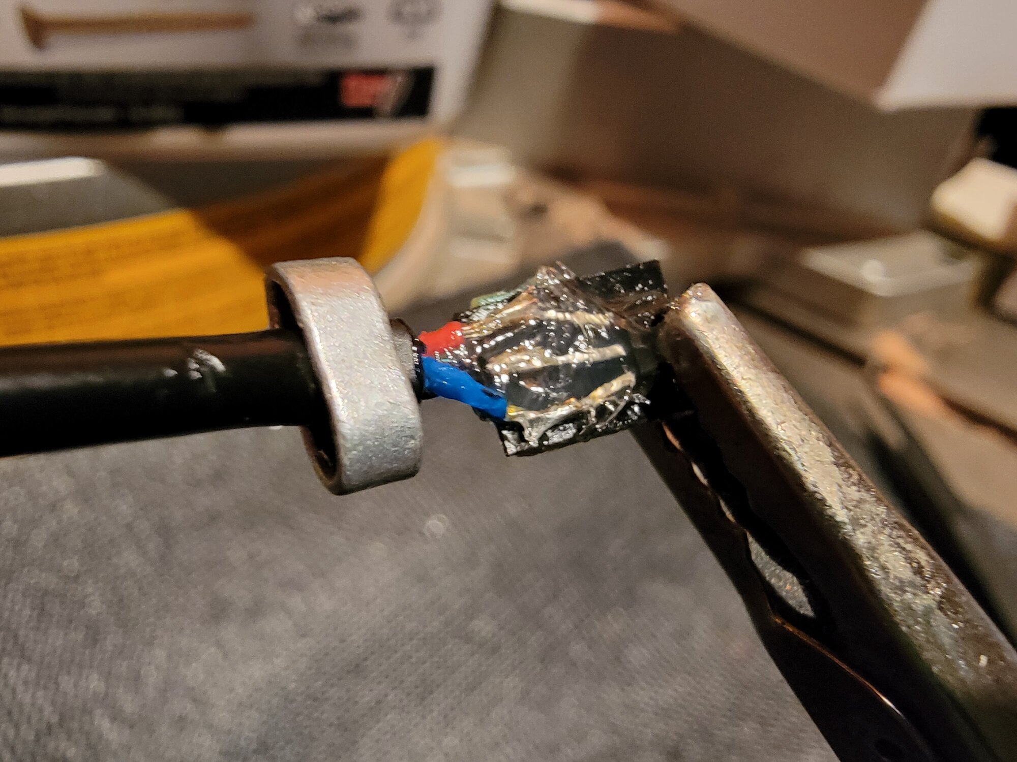

Since it's raining like hell today and I'm off, I decided to take on the hall effect sensor in the throttle like @Jayaznpride did on his bike. I reused the little board for mounting purposes (I was going to solder the new sensor onto it but I ripped off some of the traces). Once the silicone is dry I will mount it back up and test it.

I'm quite frustrated, to be honest. Paid ~$6500 for a bike that was 3 months late, slightly the wrong color, scratched, and eating itself. I'm hoping WW can send me a spare rear triangle (or just the chainstay since it's a two piece assembly) that I can install after I resolve the issue. I'm not sure if the carbon is forged chopstrand, unidirectional, woven fibers, or what, but slicing the outer layer of fibers certainly will cause a stress riser that could become a safety issue down the line as my skill level improves and I start thinking about more intense/advanced terrain. Don't want that chainstay snapping on me.
My chainring is mounted on the inside of the spider - I was going to try and swap it today but I don't have the proper tools to remove the crank arm. Doing some research it seems like there are several different styles of mounting systems, I won't be entirely sure how this one works until I've taken it apart at least once... If anyone has some insight on what tools I'll need and how to pull that crank arm off I'd love to hear.
I put one layer of film over the crank-side chainstay and 3 more layers on top of that where the chain was rubbing. Hoping that buys me some time to fix the issue lol.

What is the spider? How will it look on inside vs. outside?

Though before going to that trouble, you might try and see if you can do it without removing the crank. The last time I had my chainring off, I didn't remove the crank--I was able to just wiggle it off (after removing the pedal of course). I have different crank/chainring though so it may or may not work for you.

I was going to try that but realized I won't be able to mount my chainring guard, I just ordered some 2.5mm spacers and longer bolts which I can either use to space out the chainring MORE or keep the guard. If I had ordered two sets of spacers (which I probably should, it was only $7) I could have 5mm of extra space and keep the guard, but then I'll need 15mm bolts and I already ordered 12.5mm bolts lol.
My new Hydra frame rubs in the exact same area as well. Not as severe as yours (yet) but worries me as I expect with the steep trail riding I do that I will be in lowest gears often where chain rub will be the worst. Will be very interested to see how your spacing efforts work out.

Why can’t you put on some frame protection to hide the scratch? Not every bike comes with protection on the chainstay but they do sell it aftermarket because most bikes need it. Life is full of things where there is give and take. If you want a perfect bike that was put out in more than 10,000 units which affords them money to have dedicated people working on quality control please buy a traditional turbo levo etc. Pushkar‘s bikes are not perfect and they are going to take some tweaking. They are however massively powerful and a much better fit for someone who has a need or a want for that.
I actually already did add protection and posted a picture a couple of replies ago.

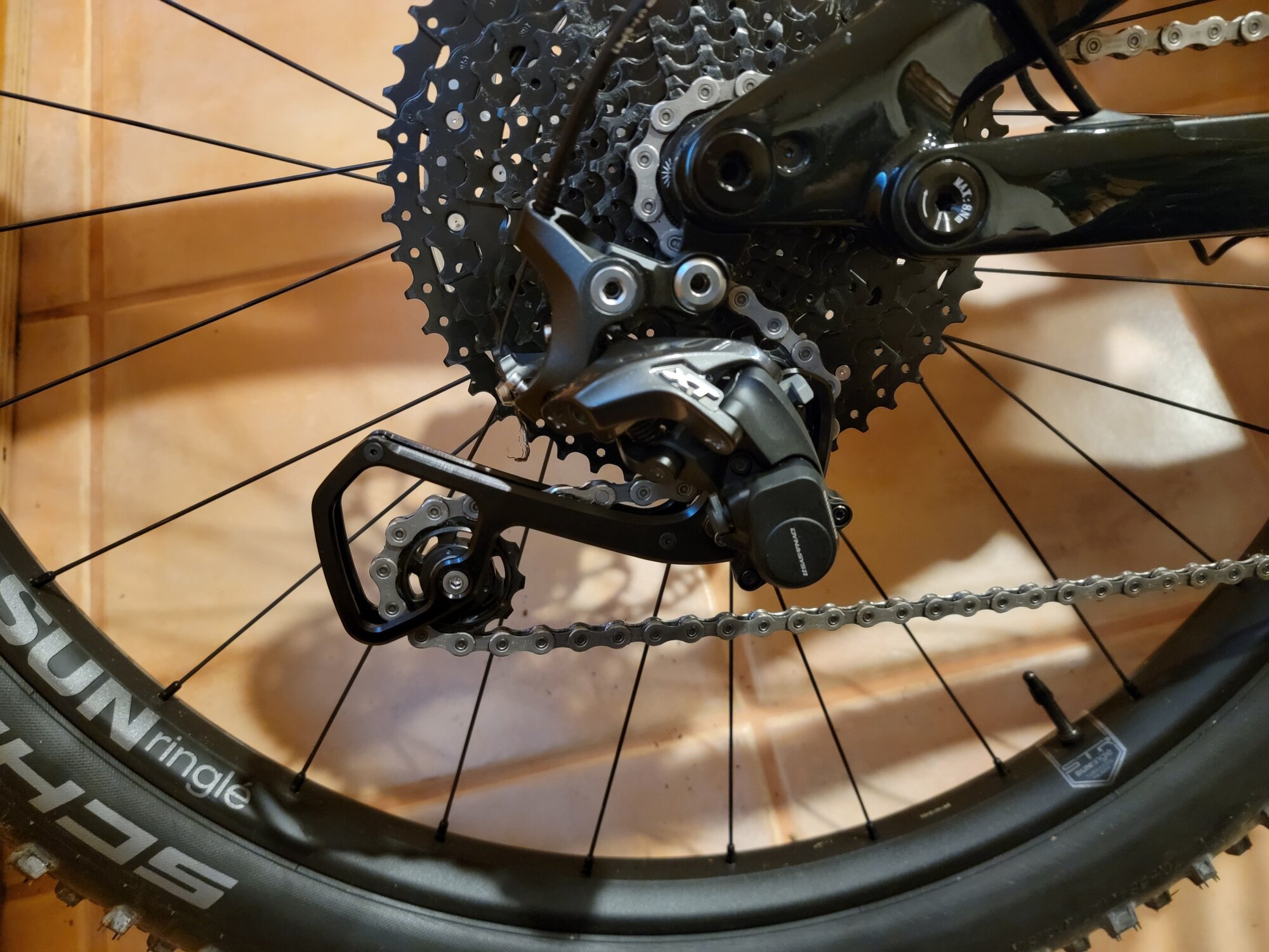

Mounted up the Garbaruk derailleur cage... not too bad, but since it was the first time I've ever taken apart a derailleur it took quite a while. This derailleur cage is pretty thin and light, I'm a little nervous it'll get bent at some point but I've never had it happen before so...
I bought some reusable KMC master links so I can swap it out so I'm not reusing a potentially compromised Shimano one. This video covers a very similar derailleur model:
I've not yet gotten to test ride it, but I think I still need to adjust the shifter cable tension a bit. I'm not sure what the benefit of a larger tension pulley is (the ones Garbaruk sells), so I didn't buy one. Excited to see how it helps!
