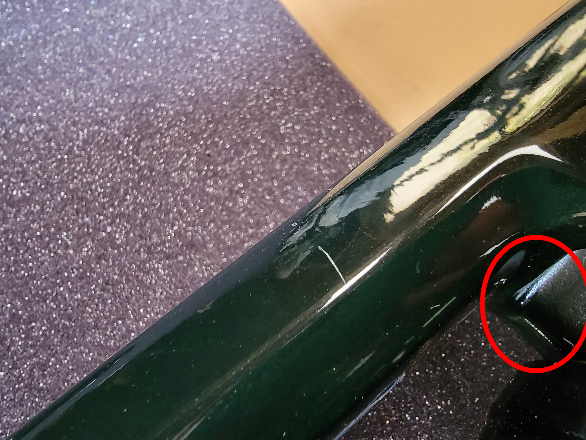

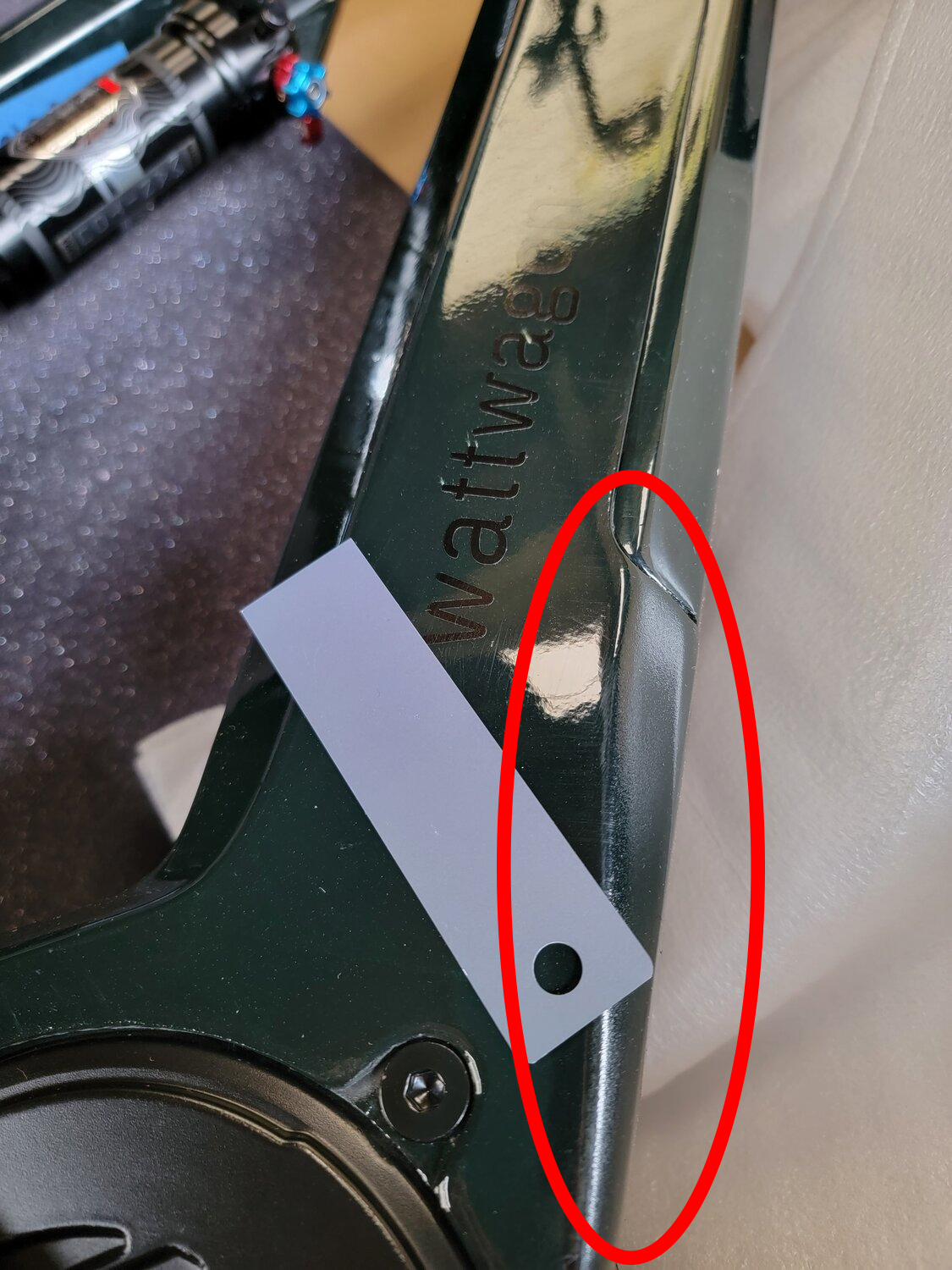

Not to mention the chips, scratches and all the detritus in the clearcoat. Who is painting these now, stevie fucking wonder?

This is suposed to be a NEW, premium ebike, do what the f*ck you want with your bike but STRAIGHT OUTTA THE FUCKING BOX it should look NEW.
I also feel sorry for your kids cos you blatantly don't give a s*it about anything.
I do admit the paint quality is less than stellar and for the price I paid for this bike I would've liked a cleaner finish. Again, I think I'd rather have the bike now than wait another 3 months. It's going to acquire scratches, scuffs, and marks because of rocks flinging up from those knobby tires and drops/falls. I'll take my random orbital polisher to it with some automotive grade finishing polishes to see if I can clean up the scuffs.
