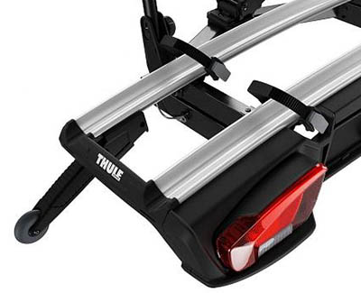

Do you know if the rack is capable of taking two Homages? That would be around 60kg right?
Chris, I think the answer is ‘Yes’, providing you load the bikes nose-to-tail. The handlebars are high so it is likely that there won’t be conflict between handlebar and saddle - another good reason for a dropper post.
The two bikes will be approximately 60 kg. Also consider the tow ball capacity (2 bikes + rack).
David
The maximum weight for that rack is 60kg. If you remove the batteries, locks, water bottles and bags, you'll be well under the limit. I remove saddles as well...keeps off UV, rain and sticky fingers.
Two accessories to consider:
  • ramp – to make loading each ebike easier;
  • loading wheel (9173) – to make moving the rack easier.
The only problem I've had is with the rack rotating on the tow ball; a rack for a square-section hitch would solve the problem.
The main reason that I did not choose a folding rack was my concern that it would be difficult to roll the front wheel across the midsection of the rack.
I have the easyfold 2. I never use the ramp. Perhaps in a few years. For now, lifting my Homage up on the ranch is no strain. Also I stabilize the whole assembly with a pair of nylon straps attached at the u-bar on the rack
