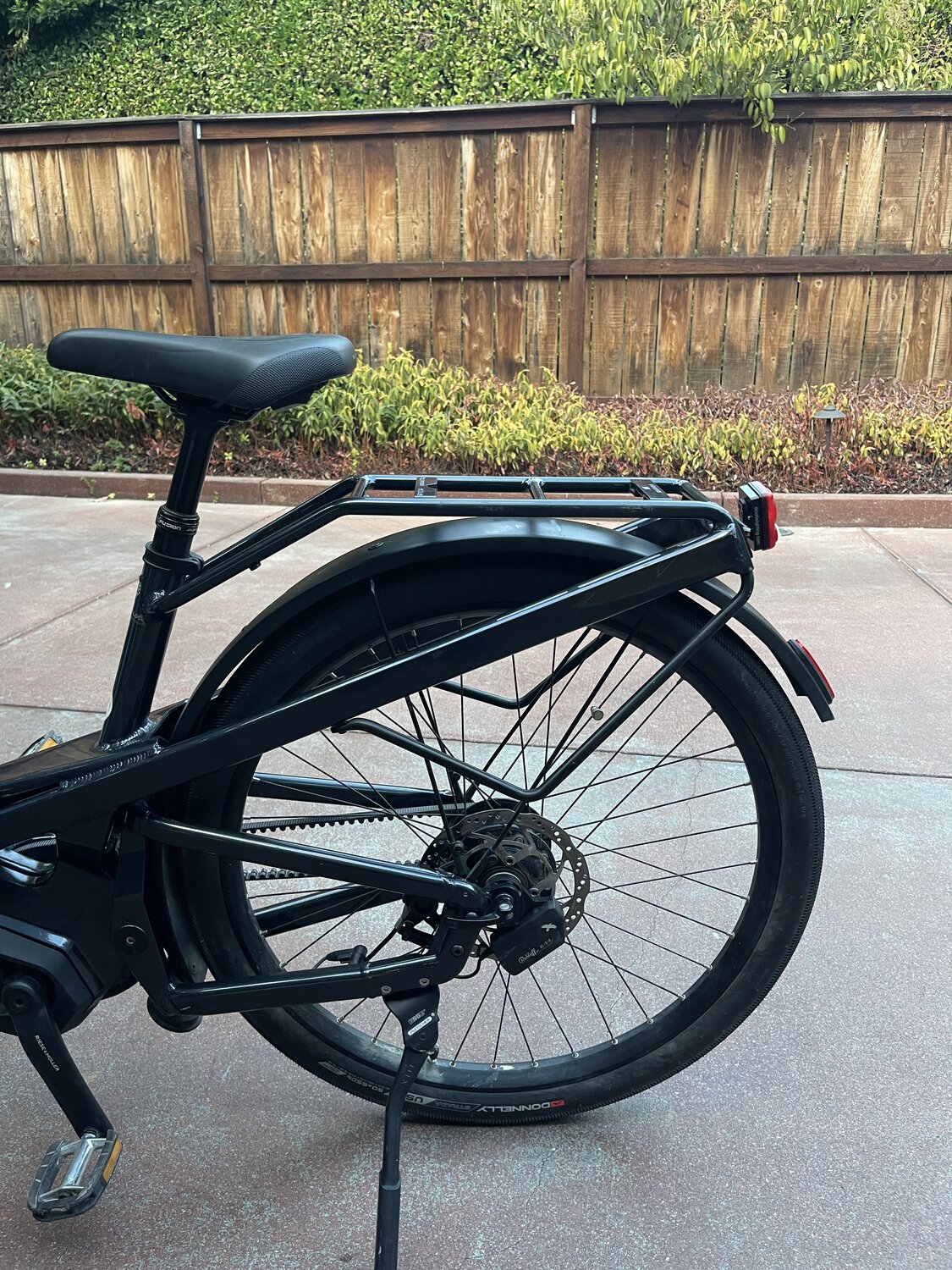

Homage after 2 years:

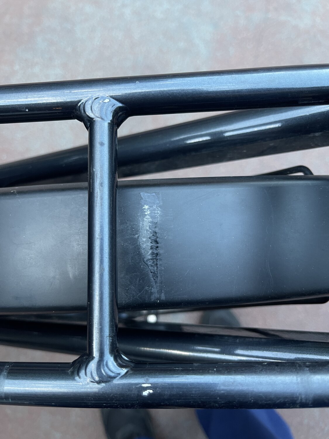

I believe there is a design flaw in the dual battery, 49 inch Homage which I purchased in September of 2021. The clearance between the rear rack and the rear fender is minimal, specifically 0.75 inches (19 mm) unloaded (no rider, no load on the rear rack) and with 150 (!) psi in the suspension strut (Suntour). The initial manifestation, within weeks after purchase was a cross brace on the MIK rack pushing down on the fender and then the fender attachment bolt inside the fender pressing down on the tire. This created a wonderful abrading sound on bumps. I fixed this by adjusting the fender attachment struts to increase fender-wheel clearance and tightening the strut fixation nuts. This still left an abrasion on the fender:

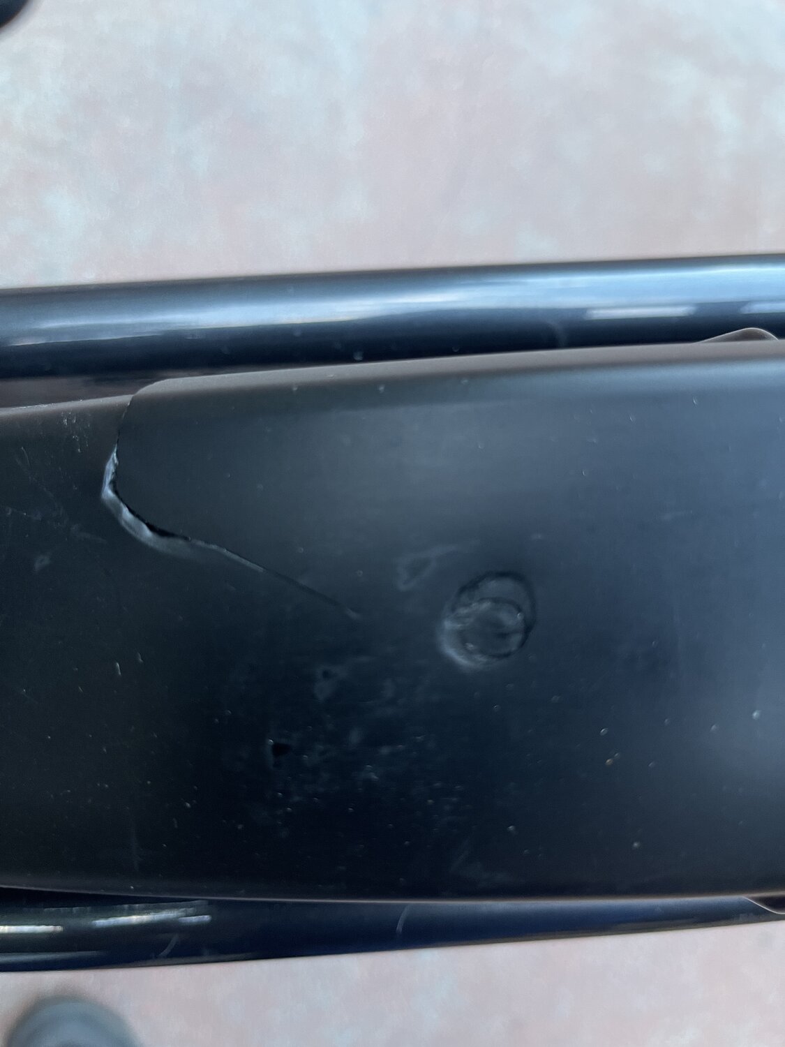

Next, on a big bump, the bolt on the underside of the fixture holding the Abus lock impacted the fender and cracked it:

ok, I believe this may not be the design flaw you think. I mean it is a flaw, but not the one you're talking about.
I've got 18months on my Homage. Same size as you. Dual battery.
When I first got it, everything was great (except for that stupid gear button from Rholoff) but the rear Suntour shock lost its seal about a month into ownership. I had to take it back to the dealer and get it replaced.
The thing is, when the original one was failing, the rear wheel fit up into the rear rack in exactly the way yours is in that photo. Replacing the rear shock fixed it immediately.
As soon as I can afford it, I'm replacing the rear shock with something better. But my point stands. Get that shock looked at, I'm 99% sure that's your problem.
It may be that in putting 150 psi in there, you popped the (frankly not very good) shock's seals. I'm not saying this is your fault, that Suntour is not a good quality shock.
The larger frame sizes should not have this issue due to the much larger clearance between rear fender and rear rack (Abus lock holder removed):

It is most likely rear shock pressure. Check pressure matches your total rider wait. Your bike should have come with a shock pump/ pressure guage. Failing that you might need the rear shock replaced.
Clamps, I suspect you are right. The timing of the difficulties are in synch with what you experienced. Furthermore, I am unable to "lock out" the rear shock, strongly suggesting that it can't hold pressure. BTW, I only recently put the 150 psi in try to lift the suspended portion of the frame. It didn't do much - another clue. The troubles I've documented ante-ceded the 150 boost. To Jay: shock pressure had previously been adjusted appropriately to load. All roads lead to failure of the rear shock. Thanks for the input, guys.

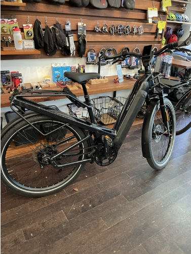

One more piece of evidence that it's the rear shock, and I think this is diagnostic. I found this picture of my bike on delivery. Rear rack to fender clearance is "normal" and unlike what I have now (see picture above).
Thanks again for all the input.
Yes, I really do believe it's just the shock now. If you can get it replaced under warranty, do so. If you can afford an upgrade, I'm told it's worth it. I'm gonna do it once I can spare the cash.
Failure of the Suntour rear shock is obviously not an isolated issue. This begs the question of whether Riese & Mueller have changed their equipment specs for more recent builds.
