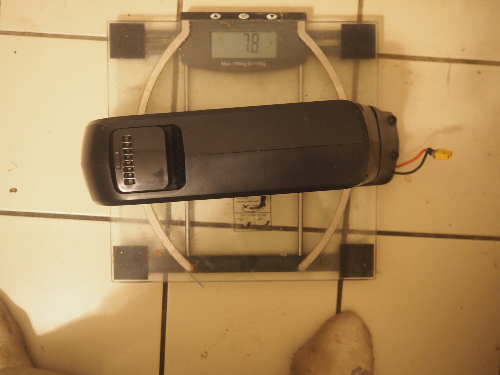

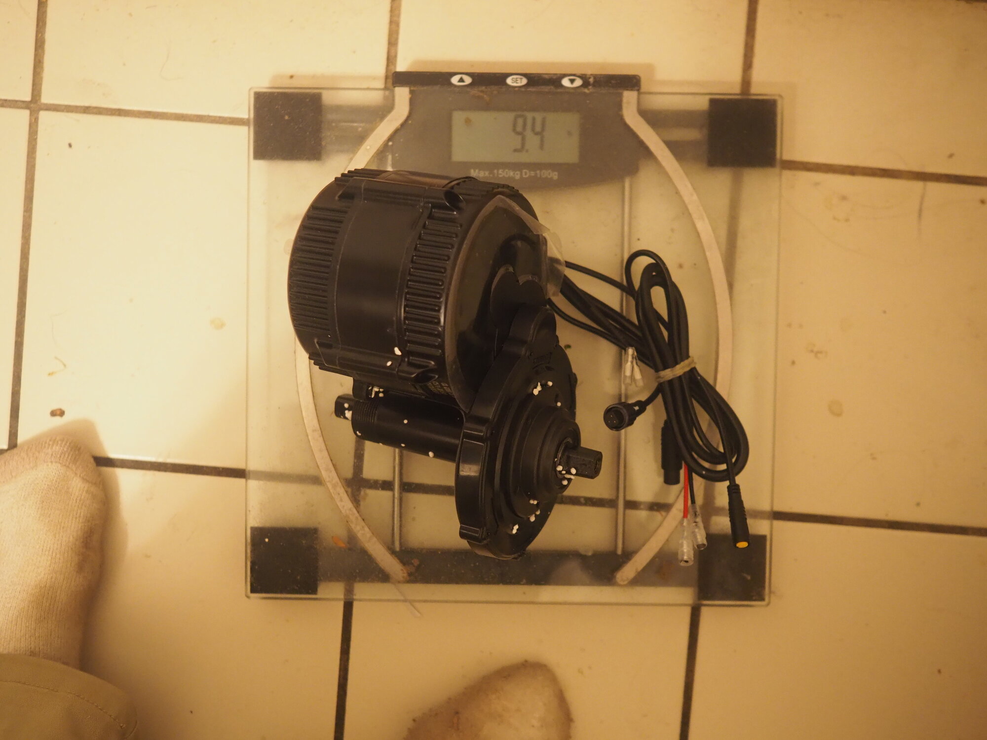

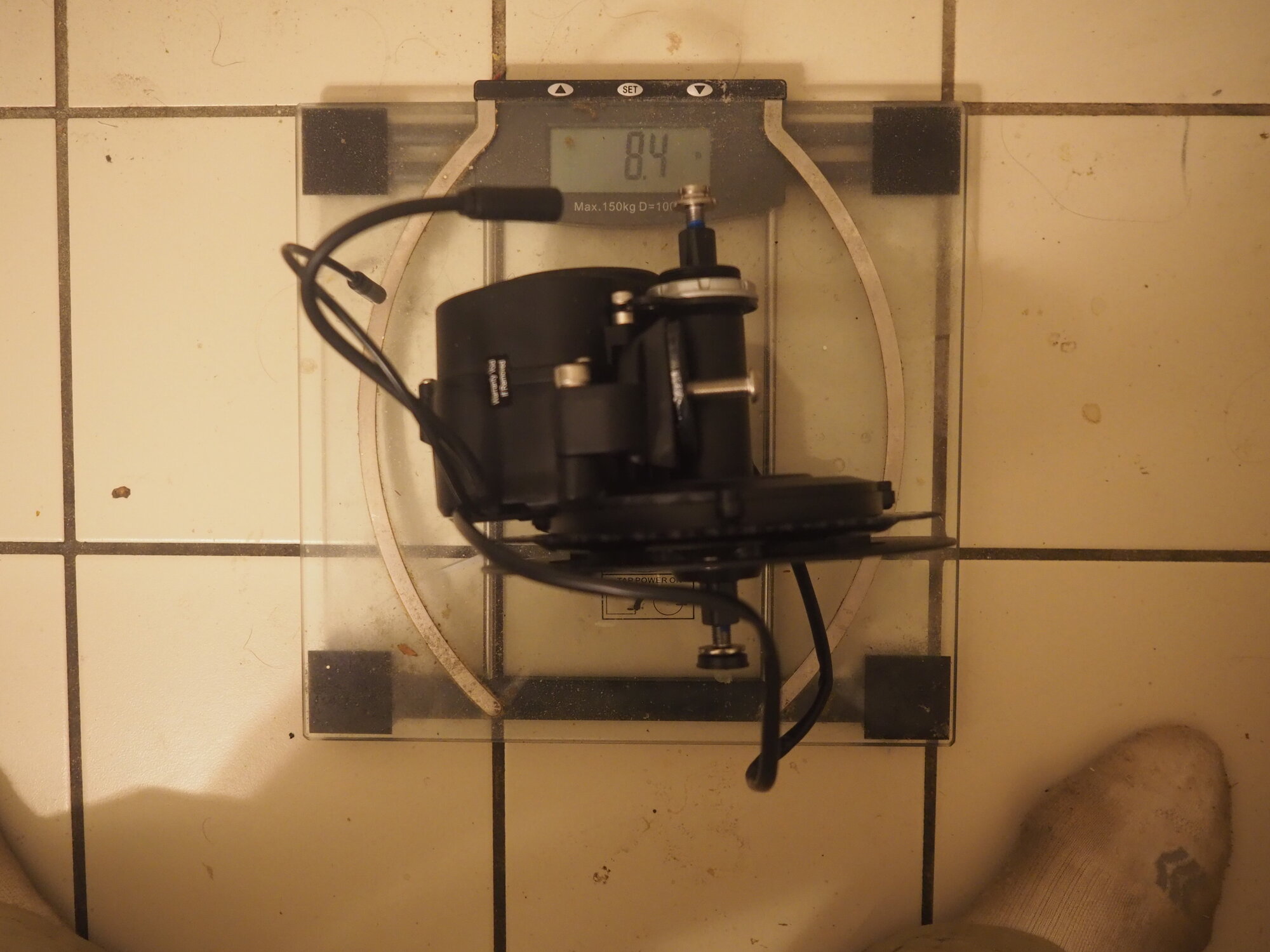

The Trek 6000 is 31 pounds? A BBS02B middrive is 9.4 lbs w/o crank/pedals. This hefty battery is 7.8 pounds. That gets you in under 50lbs and under $1000. I paid $410 for the Bafang BBS02. Happens to be a home cooked $100 battery, but budget $500 for a good one.
The Bafang is like a V6 conversion though with 750 watts, and it's not torque sense. Tell you what, if I owned a Trek 6000, the Tongsheng TSDZ2B might be my first choice. Torque sensing and around 400W per my butt dyno, but more like an assisted bike/ It's also $100 cheaper, but it's more touchy. I like it with user loaded OSF firmware, and if you aren't up to that, you can buy it preloaded from a US source for waround $500. It will preserve the character of the Trek., if you're into character. A non rider would prefer the Bafang.
Both have throttles (optional).
I'm sure you can find a builder in Denver. Otherwise, I'd suggest a real electric Trek.
