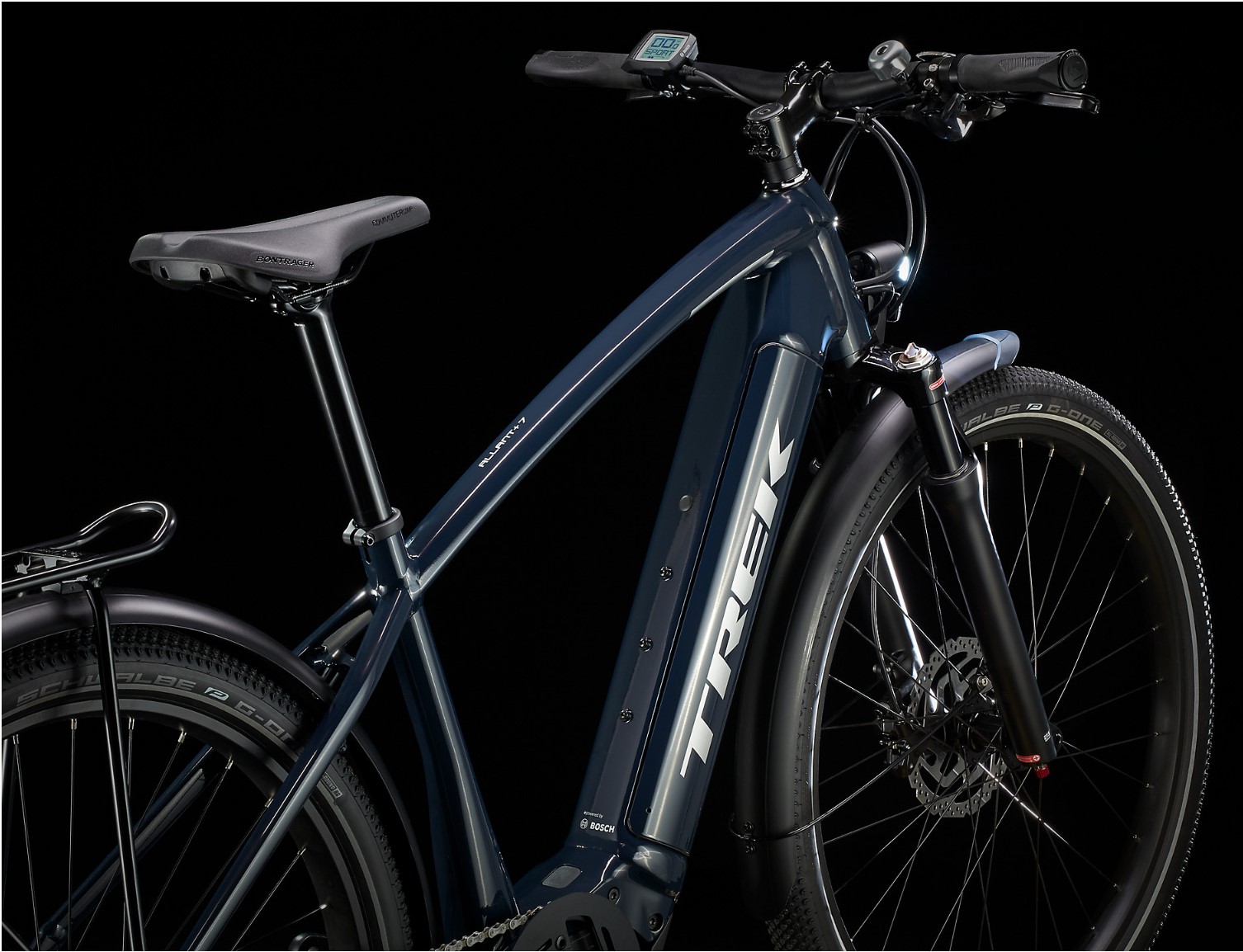

The Allant+ has quite a lot going for it: Gen 4 CX Bosch motors on the 7 and 8. 2.4” tires. The 7 has a front suspension fork. Trek has dealers all over so probably the easiest to find and service. Downside is the non adjustable handlebar stem.
The Verve has older/weaker motors.

I own an Allant+7 and love it and I recommend you take a test ride. I weigh about the same as you and the Performance CX works great for me. That said, one of my wrists takes a hit because I’m old and it’s not the most upright sitting position. I added bar-end risers and that helps a bit. Maybe a different stem might be doable.
BTW, don’t forget that Bosch is releasing a significant update this month that will increase the torque significantly.

@Dallant - yep the Allant+ 7 is still on my list. I must say it looks so much better in that photo than on the Trek website.

QT..Just to let you know the only mods (if you can call them that) are the Trek base suspension seat post (ok but nothing compared to others), Serfas E-Gel seat (which I really like), Topeak under seat bag (a cheap but good bag), the bar ends and tape. I did also move the light up to the handlebar level, which was very easy and I really like. I have ordered the OneUp composite pedals to go with my new 510 Freerider MTB bike shoes. Oh, and I added the mirror.
