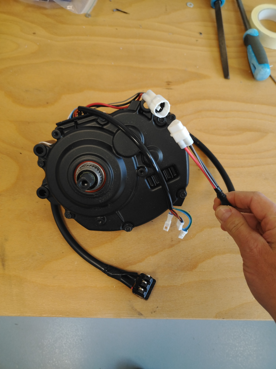

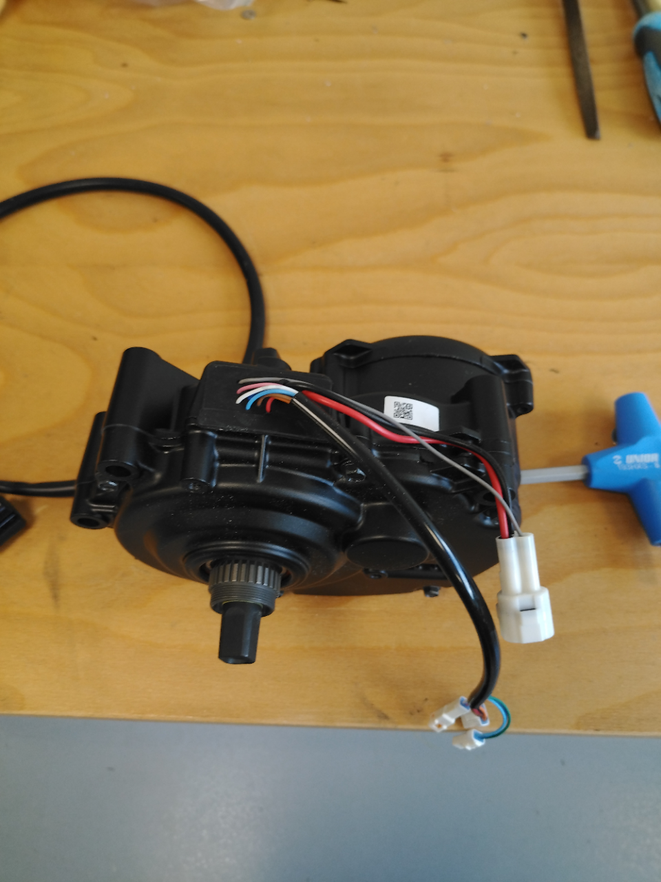

Sounds like a problem in the wire harness which leads from the Yamaha DriveUnit to the battery. For this DU the connectors are on the toppart of the DU, so this one has to be tilted downwards to get to the cable connectors.
Capacity of the battery can be read after pushing the battery button for 30 seconds, it will show the current cap for this battery, 1 led is 0-24% 2 leds 25-50% etc.
I suspect this battery cable has an intermittent contact. Its the one coming from the battery pack and leads into the DU
the cables on these DU are on the topside, so the du should be tilted downwards to access them.
