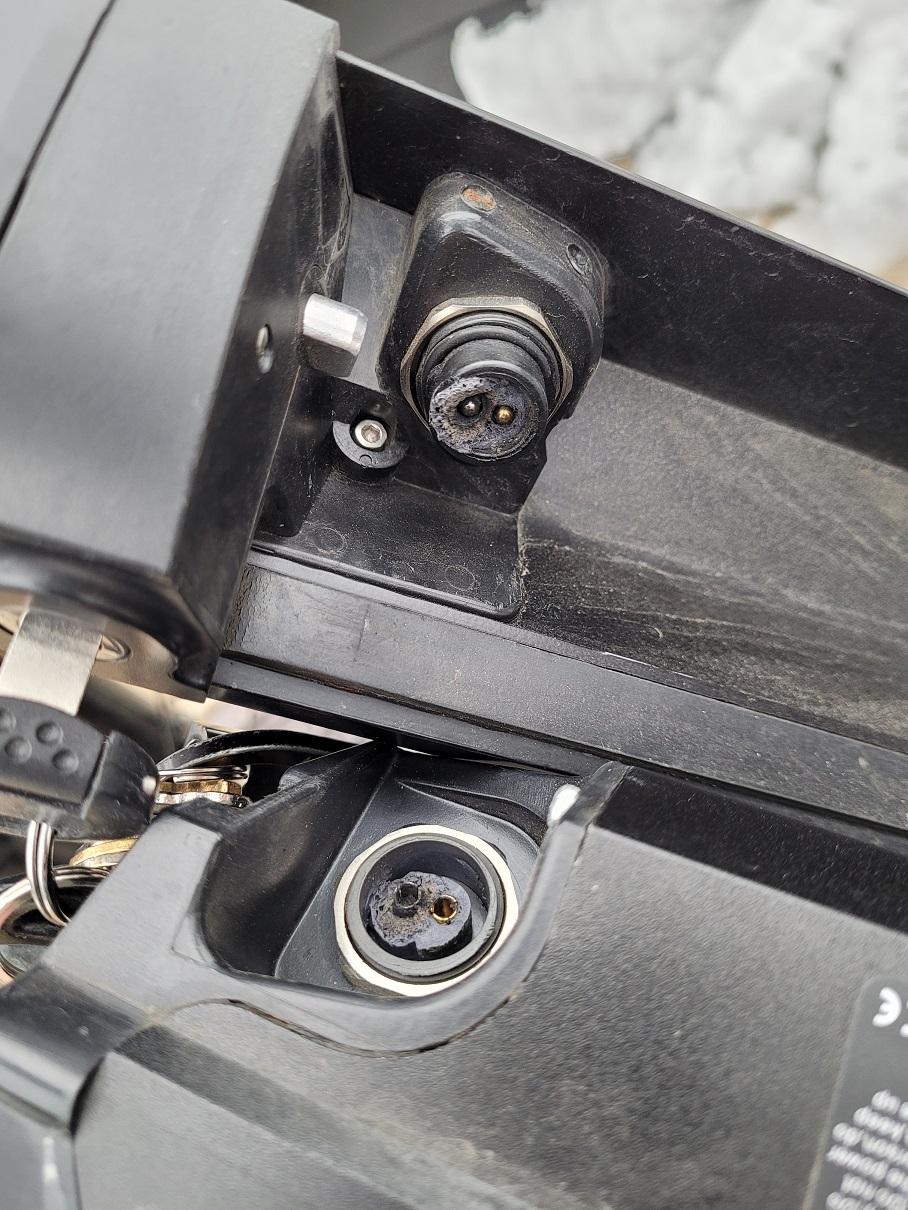

12/14/2020Sudden voltage drops to 40's along with battery gauge depletion on display & feel to motor & then few seconds later back to normal. Happens randomly sometimes during a ride & sometime after powering on.
12/16/2020Broken spoke rear
12/16/2020Noticing some clutch engagement issues may be time for a new one.
12/30/2020Power drop issue now permanent took battery off & connectors are melted.

Youth, it looks to me like you've had some arcing in there, probably due to a loose connection, unless it was slightly misaligned from the get-go. I didn't read all the way through your (excellent) log to see if there were signs of a growing connection problem. The only fix I know of is to replace those parts. I can't tell from the photo how badly the battery side of the connector was affected. I know that the parts for the frame side of the connector are available, through Juiced or AliExpress, and if you're reasonably handy, you can do it yourself. I don't know how difficult it would be to swap the battery side. I myself would put in a ticket with Juiced for an answer to that question.
I've had symptom this past month so it wasn't always like this. Have read now that other have had the same issue & it's likely what you described with the arcing. I'm considering trying a repair with leftover parts from my old Cross Current gen 1, but I don't have much experience soldering. The reddit post I saw on this also mentioned that Juice was willing to repair it after warranty, but then never got back to him.

7/8/2020Applied purple threadlocker to rear brake lever screw.
7/9/2020Lower leg service on Rock Shox Paragon replaced oil, but kept seals & foam inserts.
7/13/2020Removed & cleaned cassettte at work due to needing extra leverage with shop tools to get overtightened lockring off. Put light oil in back & front of freehub while cassette was off & no change in gritty sound.
7/10/2020Replace unreliable CCX OEM rear light with B&M Topflight Senso.
7/16/2020Purple threadlocker didn't work trying blue material insensitive
7/23/2020Clutch slippage felt.
7/28/2020Put 3oz Orange Seal in rear tube.
7/31/2020Chain jump high speed bump
8/4/2020Clutch seized
8/5/2020Clutch seems to have un-seized itself.
8/9/2020Swapped to OEM Kenda rear tire after sidewall/bead 1" bulge discovered in Marathon Plus likely from riding flat.
8/20/2020Rear flat & Orange Seal Endurance did not seal on a nail but leaked out of tube into tire. Will try regular Orange Seal next.
8/21/2020Coming up on 8th ODO reset.
8/21/2020Rear wheel noise for over two weeks now. Suspect lack of tension spokes.
8/25/2020Orange Seal Regular put in rear tube .
8/27/2020Continuing noise from rear is likely from crack in spoke hole.
9/15/2020Swapped to rebuilt wheel with DM24 rim.
10/5/2020Swapped front disc pads with old ones with less wear.
10/6/2020Chain jumped to outside.
10/16/2020Swapped one rear pad with a use less worn one.
10/21/2020Replace front & rear pads with Truckerco Sintered Metal
Changed rear tire to Schwalbe HS 492 47-622 tire
Changed front tire to Schwalbe HS 492 47-622 tire
11/30/20209th ODO reset
12/3/2020Kickstand came loose
12/9/2020Applied blue loctite to kickstand screws
12/9/2020Install Tannus armor on rear wheel with new Schwalbe inner tube.
You can get replacement connectors at - ElectricScooterParts.com, very reasonable, but You might want to find out why they
fried in the first place

Just got my RC-S and the first thing I did was coat those terminals with silicone dielectric. My opinion is that 52 Volts is sufficient to cause sparking if the battery is jostling. If I were doing much off asphalt riding I would also wrap the battery with an Ace Velcro wrist brace, which I do on my R1U 700. Time will tell if there's any benefit to this precaution. BTW, your record keeping is awesome
Defintely using dielectric grease this time if I can get it fixed. Just never bother using it because it's been working all this time & the battery seemed secured.
Youth. Same thing happened to my CCS. I bought the parts from reention. The one on the frame is plug and play. You have to open the battery and solder the other connector though. Take pictures. Watch a few YouTube videos on soldering. Be careful not to arc flash, as I did! After I soldered mine I had a friend at radio shack check it out. It worked, but I ultimately bought a replacement battery on eBay and converted the ends to Anderson connectors. I use the juiced battery on a DIY recumbent. Has the juiced battery lost some of its umph yet?
I'll probably buy them from Hilleater since I got my clutch from them before if the ones from my old CC battery don't work. I've been trying to keep the charge around 80% through these 2 years, but have been doing 95% this past fall/winter because it does feel like I've lost 15 to 20% capacity.
