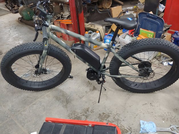

I ordered my Bafang kit from eBike Essentials. This is not a promo for them. However:
1. The parts are all stocked in the US although almost all of them are made in China.
2. The website tells you upfront if a part is out of stock.
3. I ordered on a Friday and it was shipped Monday and I had it that Friday.
4. The phone is answered by a person who has English as a first language.
5. They have a good guarantee which I didn't need to use.
The cons were:
1. The instructions could be better and clearer.
2. There are links to vids but see #1
I made some stupid mistakes but I got the job done. You don't need to know anything about electronics because all the plug ends are color coded and different so that this plug will only fit that plug. My advice is to do this yourself. For about $1600 you will have a kickass powerful bike and it's your bike. If you want more climbing ability then order the small front sprocket, if you want high top end get the big one. Also trying to order this and that from China direct just scares the crap out of me. And lastly, you probably don't want to try to get a bike mechanic to do the conversion for you. Most haven't and will be as slow and clueless as you. If they have then that might work out.
