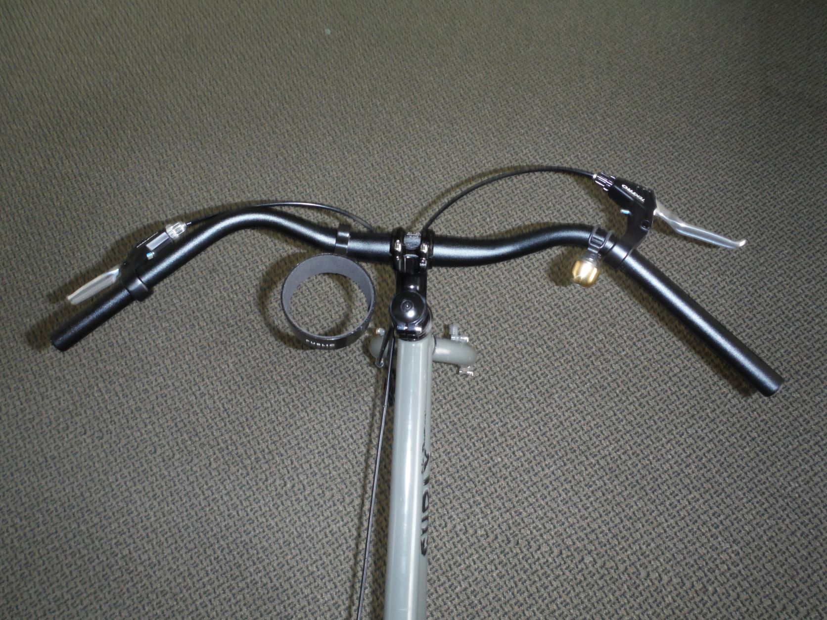

I just saw them for $339 on eBay including shipping. Obviously it would need the fat BB extension or a Fat HD. I would change everything including the headset. As for unusual I am not sure. The overall frame length is nearly twice the reach? The freewheel is a 14-28 on an off-road bike? The tennis ball for snow?
Note the orientation of the handlebar stem vs. the front rotor :D
Got it. So, is it a F-up or an on purpose for reach. On Target a guy gave a 1-star because the fork he assembled out of box was backwards and the cables were all messed up. One former boss would say he could assemble a bike out of box in 15-min. He did this backwards fork every few weeks just to show me. They wouldn't shift and the brakes rubbed. The brakes would be uneven and up in the air. I was expected to meet his proven assembly time standards. The pedals would be stripped and sideways in the crankarms. That was at Dick's Sporting Goods, where the group cheer is 'We are Dicks.' He would then put all the plastic trash in the cardboard bailer. 🤣 🤣

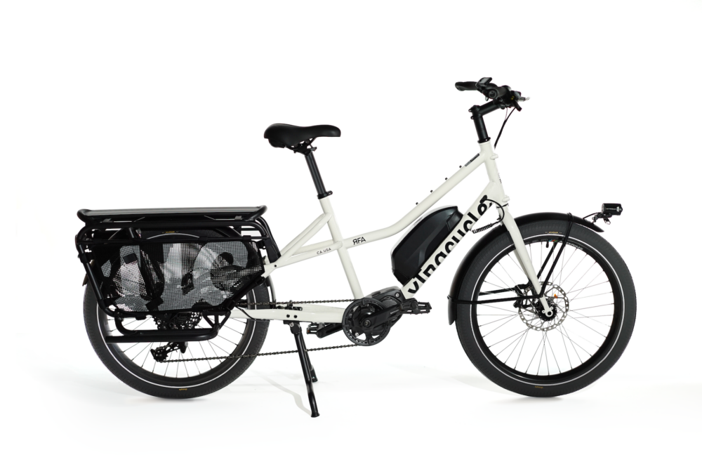

Surly Skid Loader and Xtracycle RFA are steel frame midtail cargo ebikes with strong motors and rated to carry up to 400lb
The Skid Loader was just released a couple weeks ago and made for a lot of discussion in the Surly group on FB. Biggest ding against it is the damn thing is priced at effectively 5 grand. Plus it has no throttle which the OP stated he wants. The Skid Loader is aimed more at urban apartment dwellers who have to muscle the thing up stairs and park in limited space. Its too bad they don't make a non-electric version as that chromoly frame would be every bit as good a donor for an aftermarket motor as is their Big Dummy and Big Fat Dummy.
