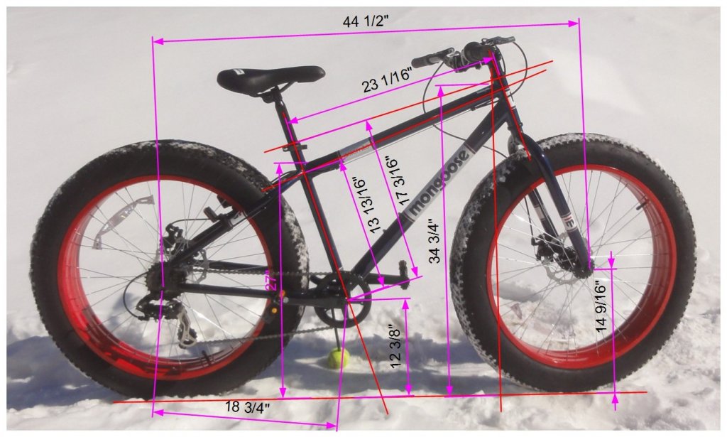

You know what is a very commonly done cheap conversion bike? A Mongoose Dolomite. Low end components throughout, but a strong chromoly frame that you can beat the hell out of. You can get the whole bike on Amazon for $260 and upgrade stuff from there. Its perfect for a 160 Nm BBSHD.
A big drawback about building a bike for some people is that you can't whine. I find it empowering. Big guys should get cargo bikes. They are all set for heavy duty.

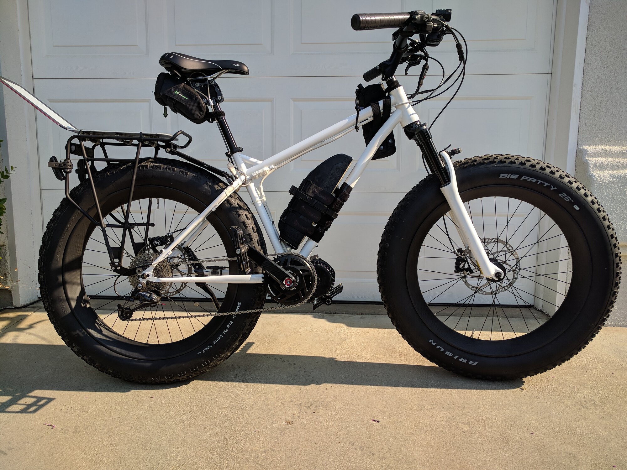

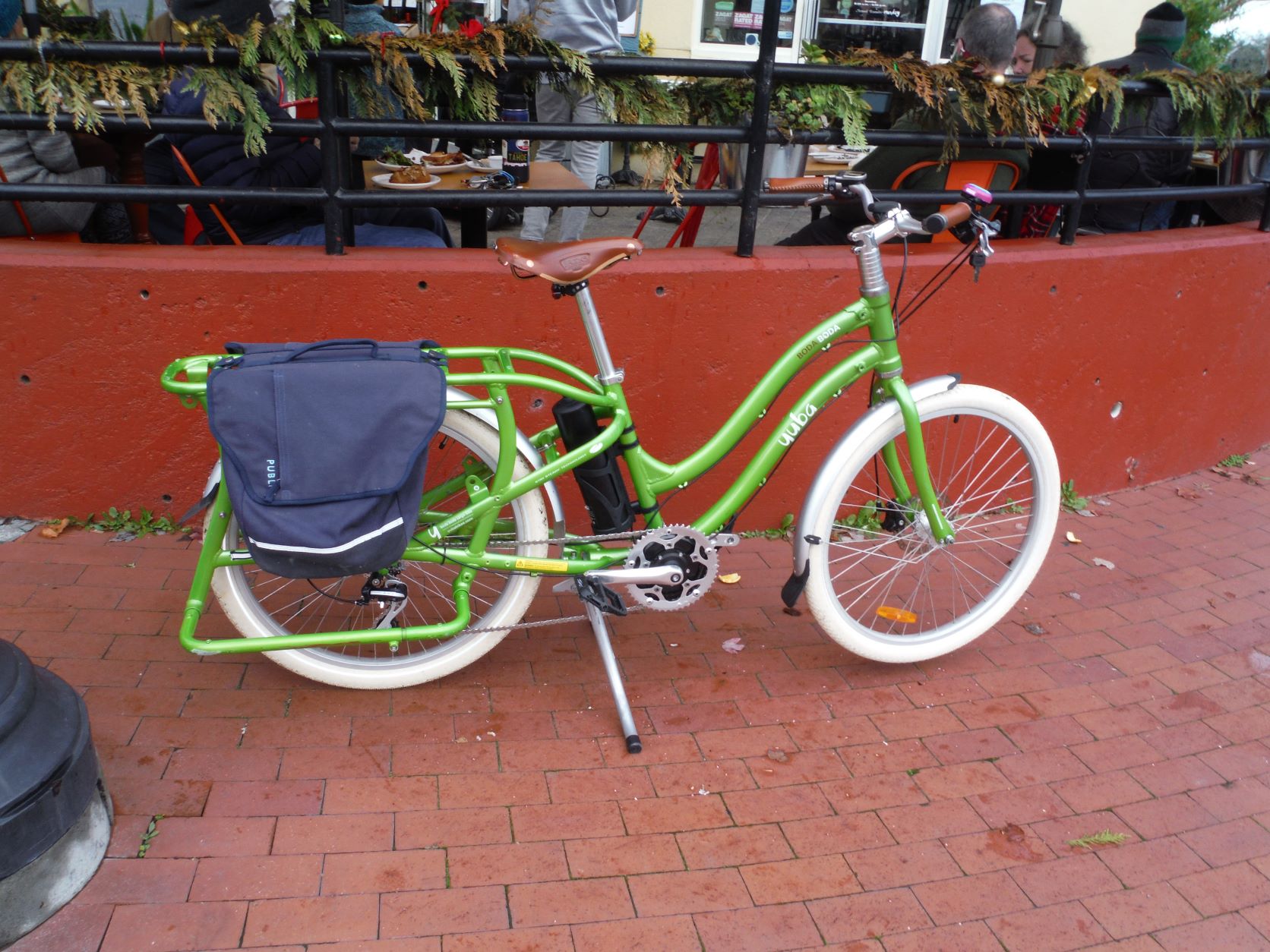

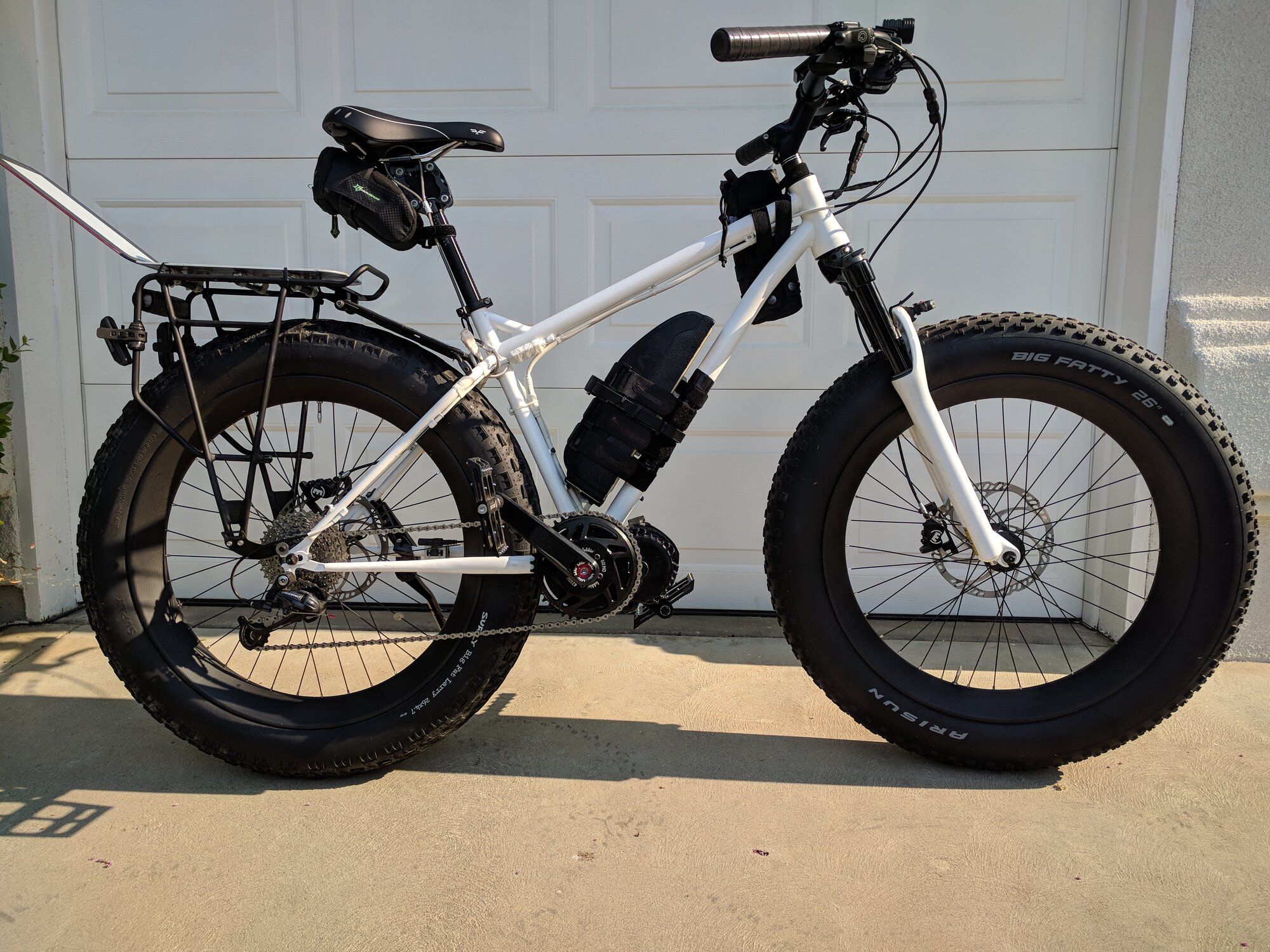

Something like a used Boda Boda is super sturdy, lightweight, not too big and mid-step. Then convert it with any level of components you want. Look at this axle, hub, and spokes.

You know what is a very commonly done cheap conversion bike? A Mongoose Dolomite. Low end components throughout, but a strong chromosomal frame that you can beat the hell out of. You can get the whole bike on Amazon for $260 and upgrade stuff from there. Its perfect for a 160 Nm BBSHD.

I was surprised to see Dolo's have almost completely gone back to their pre-covid price point. $260 now. Was $199 originally and grew to over $500 recently. I've been sitting on this pic for years for reference someday if I build one, which looks like never now. Notice anything unusual? :D

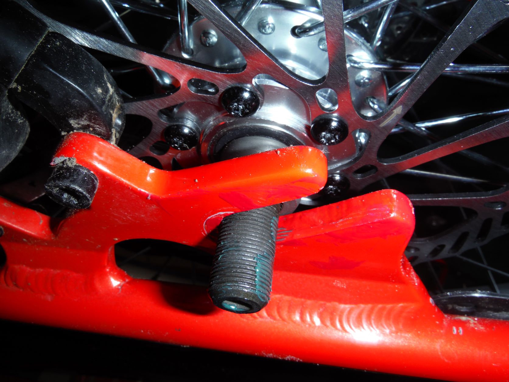

Sadly we watched scores of customers use the Dolomite without any upgrades. Scary!
I just saw them for $339 on eBay including shipping. Obviously it would need the fat BB extension or a Fat HD. I would change everything including the headset. As for unusual I am not sure. The overall frame length is nearly twice the reach? The freewheel is a 14-28 on an off-road bike? The tennis ball for snow?
