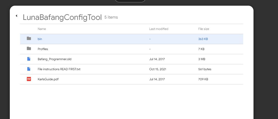

Im getting ready to apply he Frey "Smooth Tuning" but I dont have a Torque Tab. Anyone know how to get that to show up using the Bafang Programmer?
When you look in the program folder... There are 2 different .exe files.
One has the word Torque in it. That's the one you want to run.
When I clicked to download everything, there is only one programing file...see attached picture.

I think your best bet is to read the "other" tuning guides and see if any of them have links that still work. You can read about them here:
I personally recommend the EggRider V2, as that makes the iteration cycle much faster.
Copy that, I did pick up the EggRider V2. Just showed up today actually. I have a lot of reading to do...
