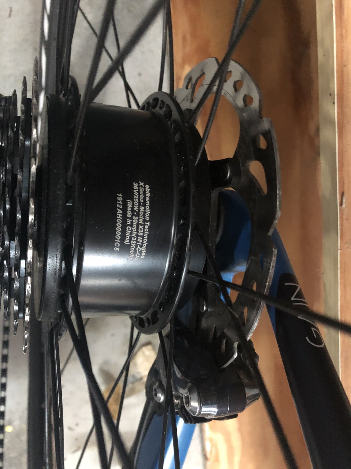

My wife has the Orbea gain F40. It's a great bike and has allowed us ride together at a reasonable speed. However it's the UK 15mph version and would be perfect if it was the 20mph version.
It's been said that the only difference is the dealer programming setup. But her motor has 25kmh marked on it. Can I ask anyone with a legitimate 20mph bike to confirm what their motor has marked on it, as it may be hardware as well.
Thanks so does look like different motors dependant on regional laws and not just dealer controller programming.
Now it would be interesting to know if one of those faster motors would just plug and play on the slower bike.
It should be all in the motor. There is nothing but the battery and connecting wires in the frame.
