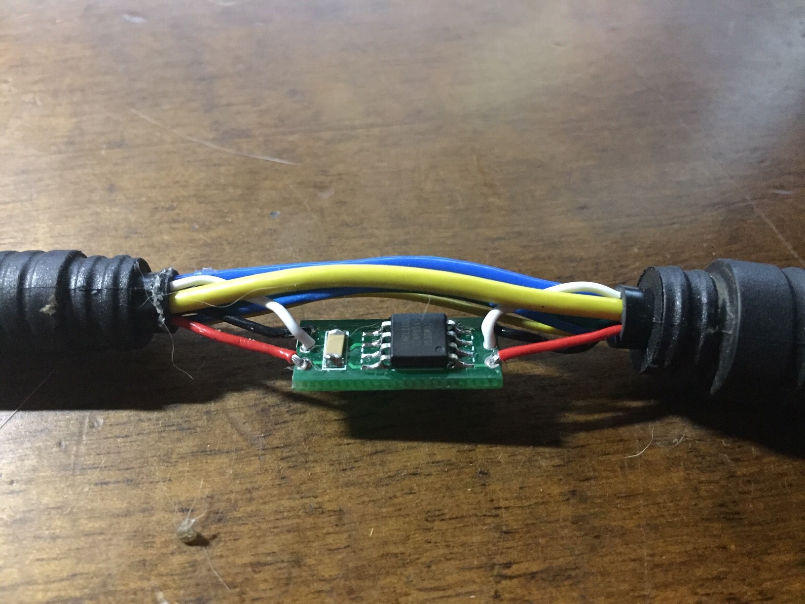

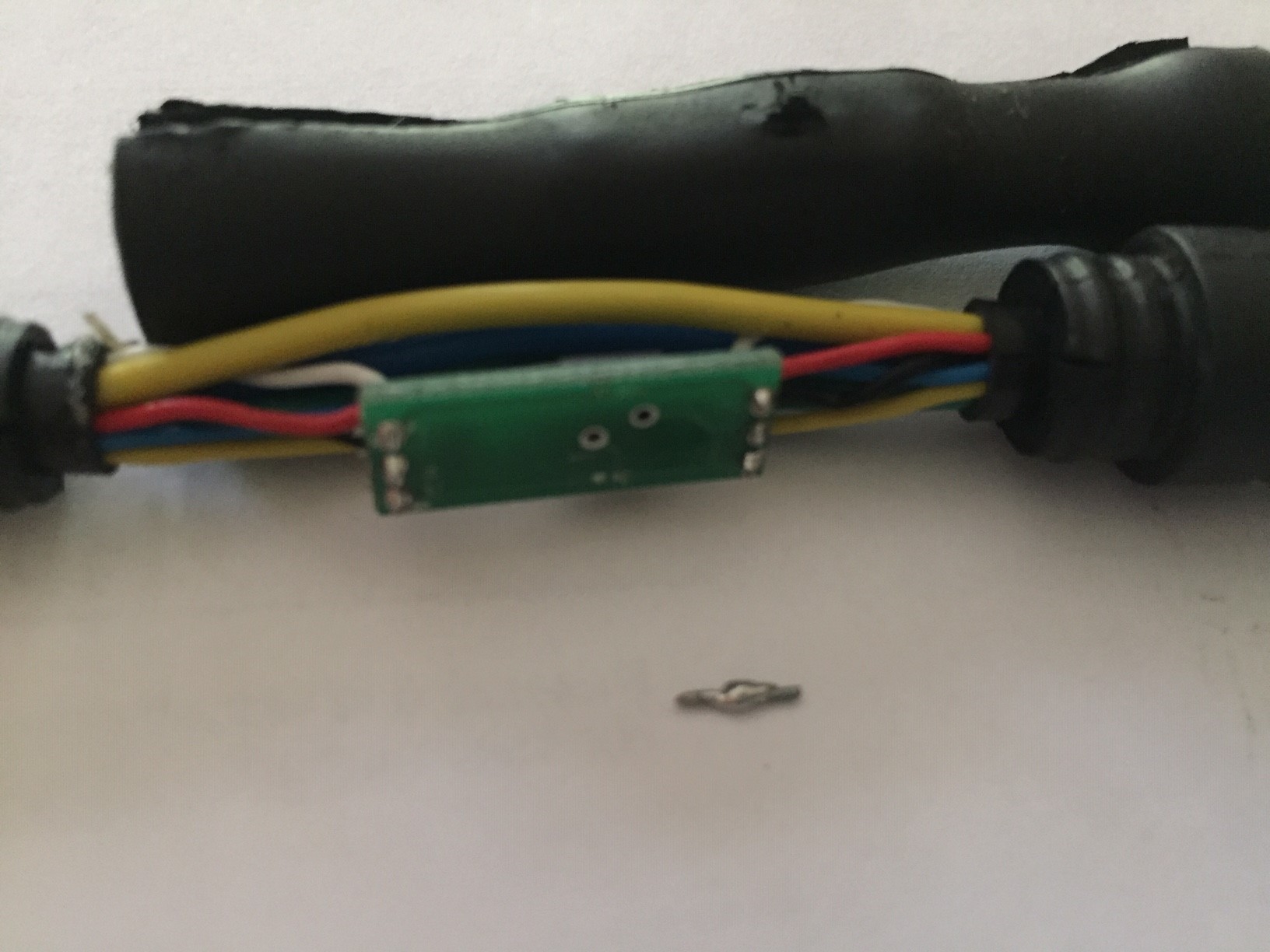

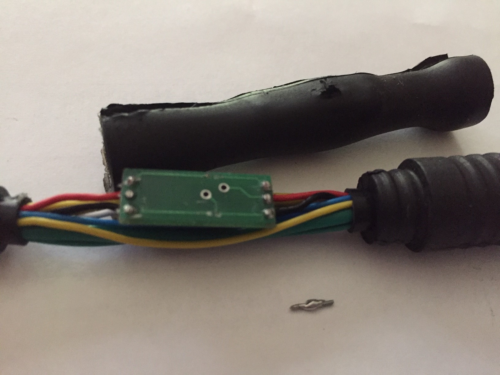

hi , here 2 pics of the Volabike dangle , which worked perfectly until recently, but it is out of order, because the protection is not great

Did it get damaged due to rider error? Or just fall apart?
Could you please make a picture from the component's side, so we can get an idea about electronic design?

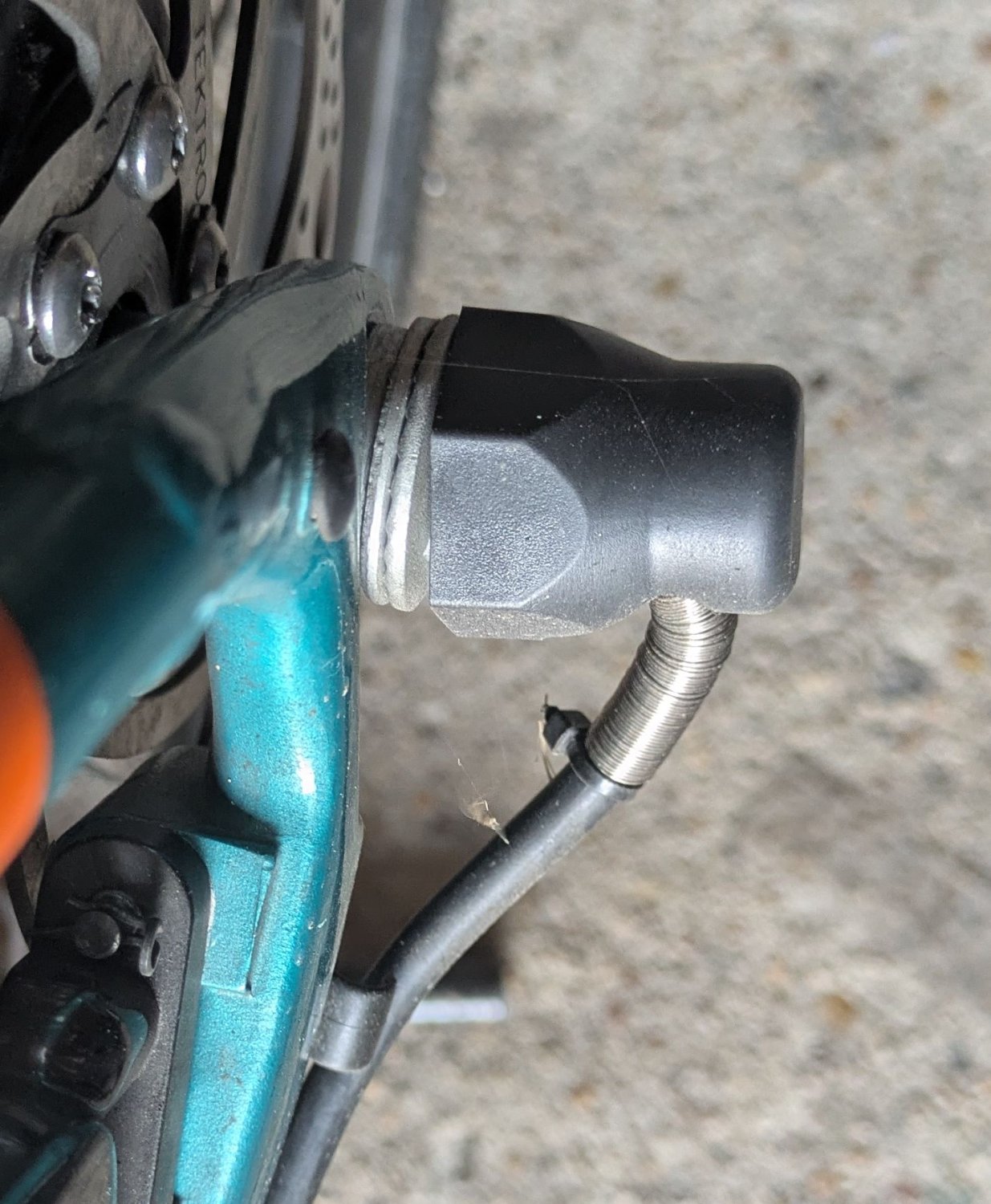

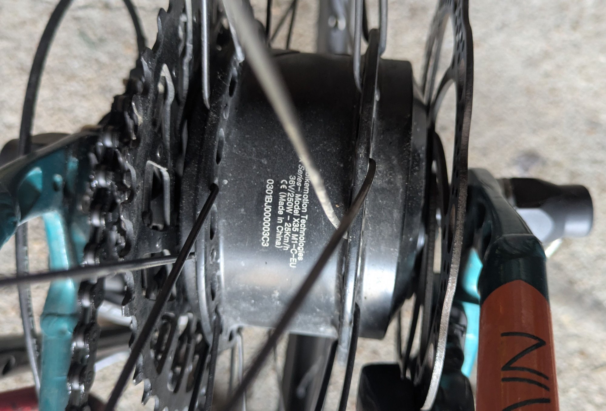

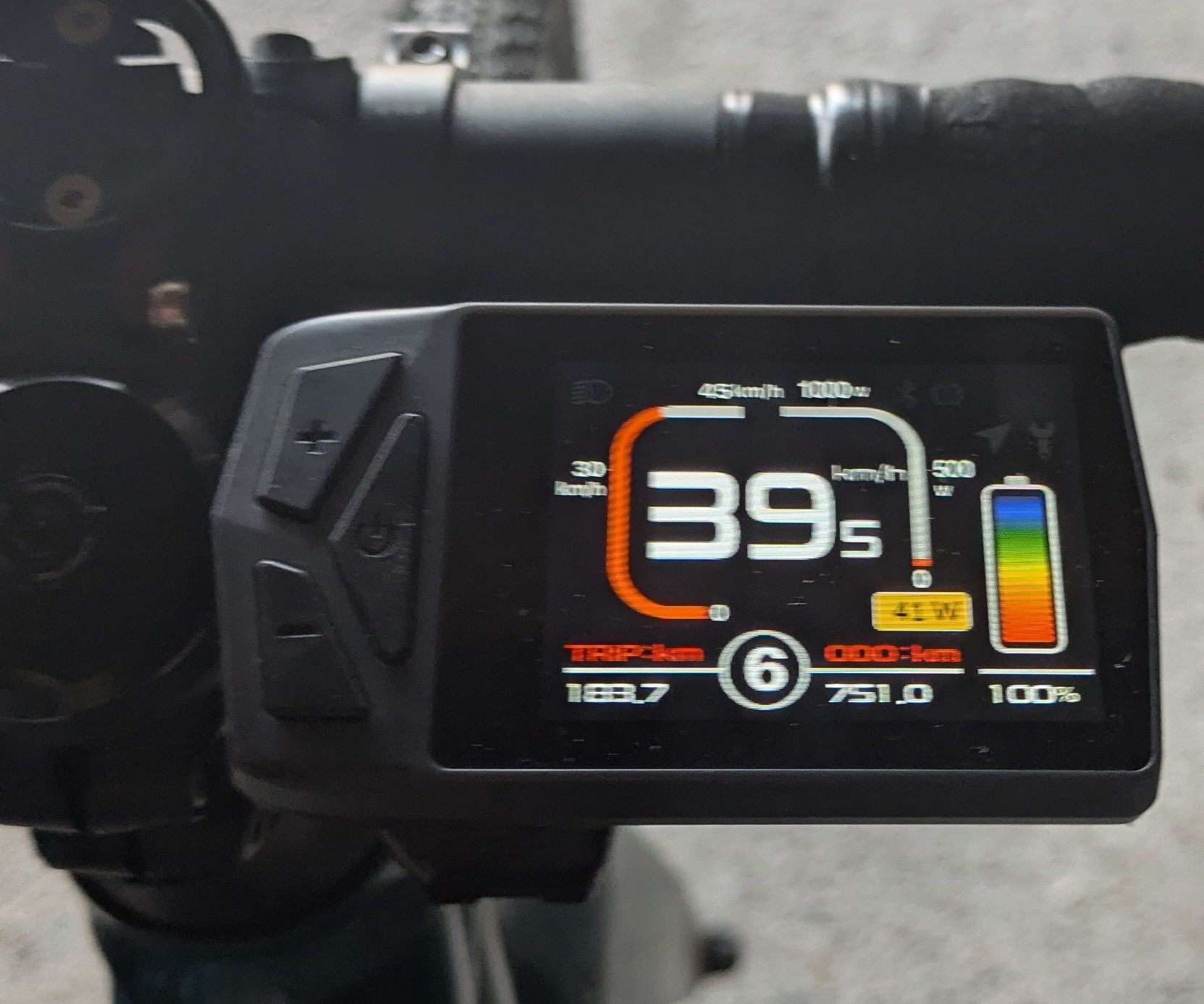

Hello,
I have try with SpeedFun Ghost but it's around 2km/h extra. It's not efficient and expensive for 2.... I try an another solution and now I can go up to 35 km/h due to my speed limit record in my display. I will post more photos
Hello
Here are the photos

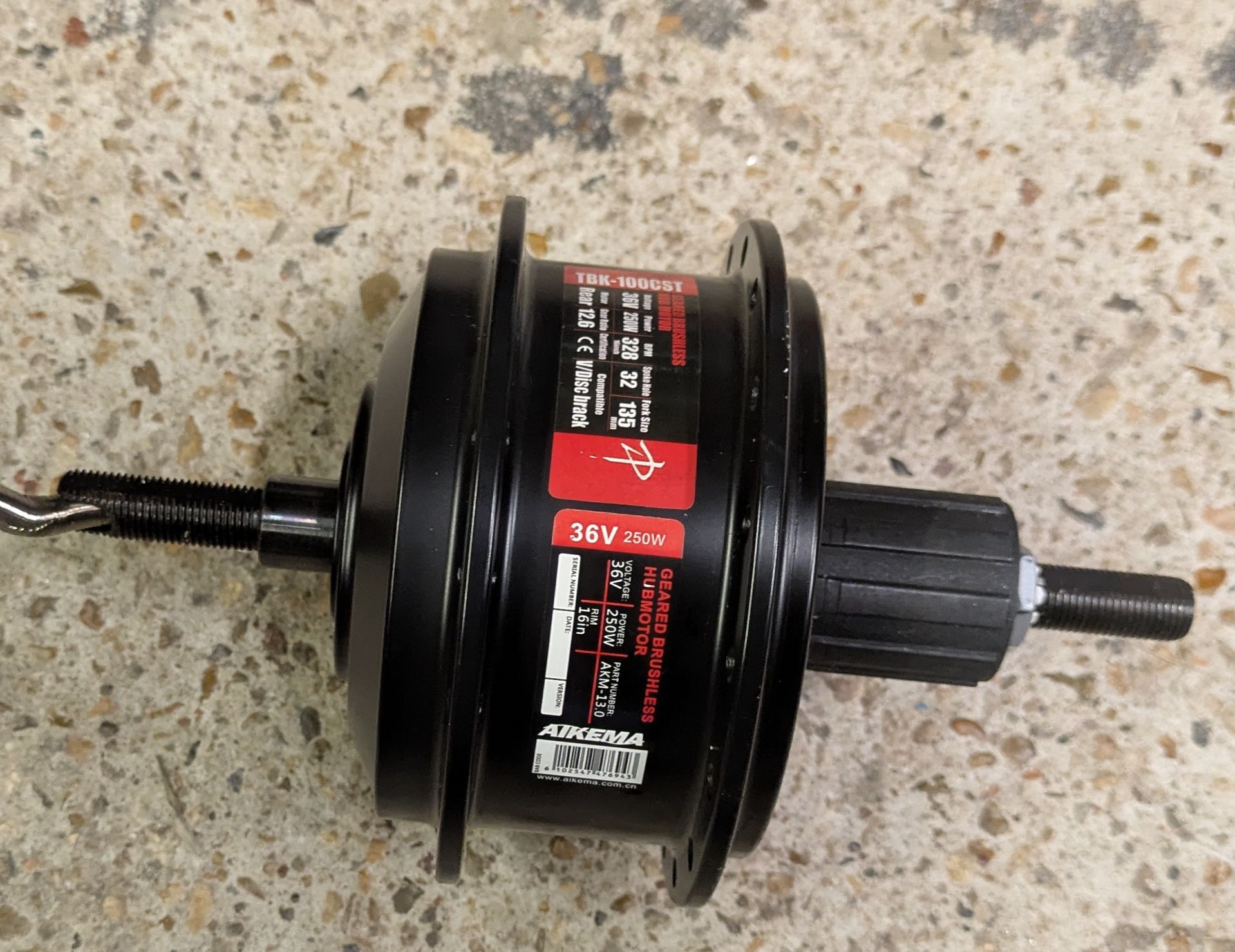

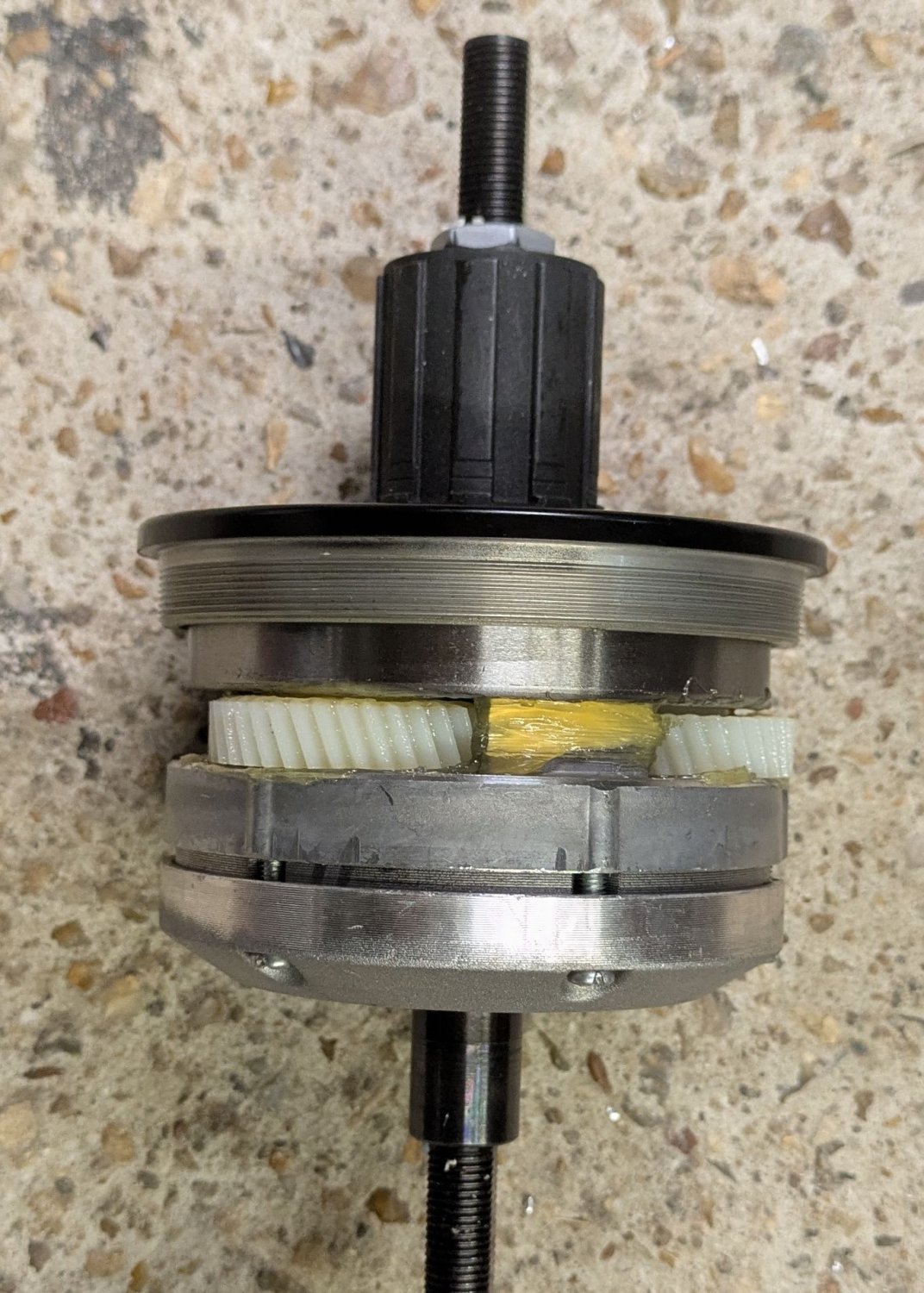

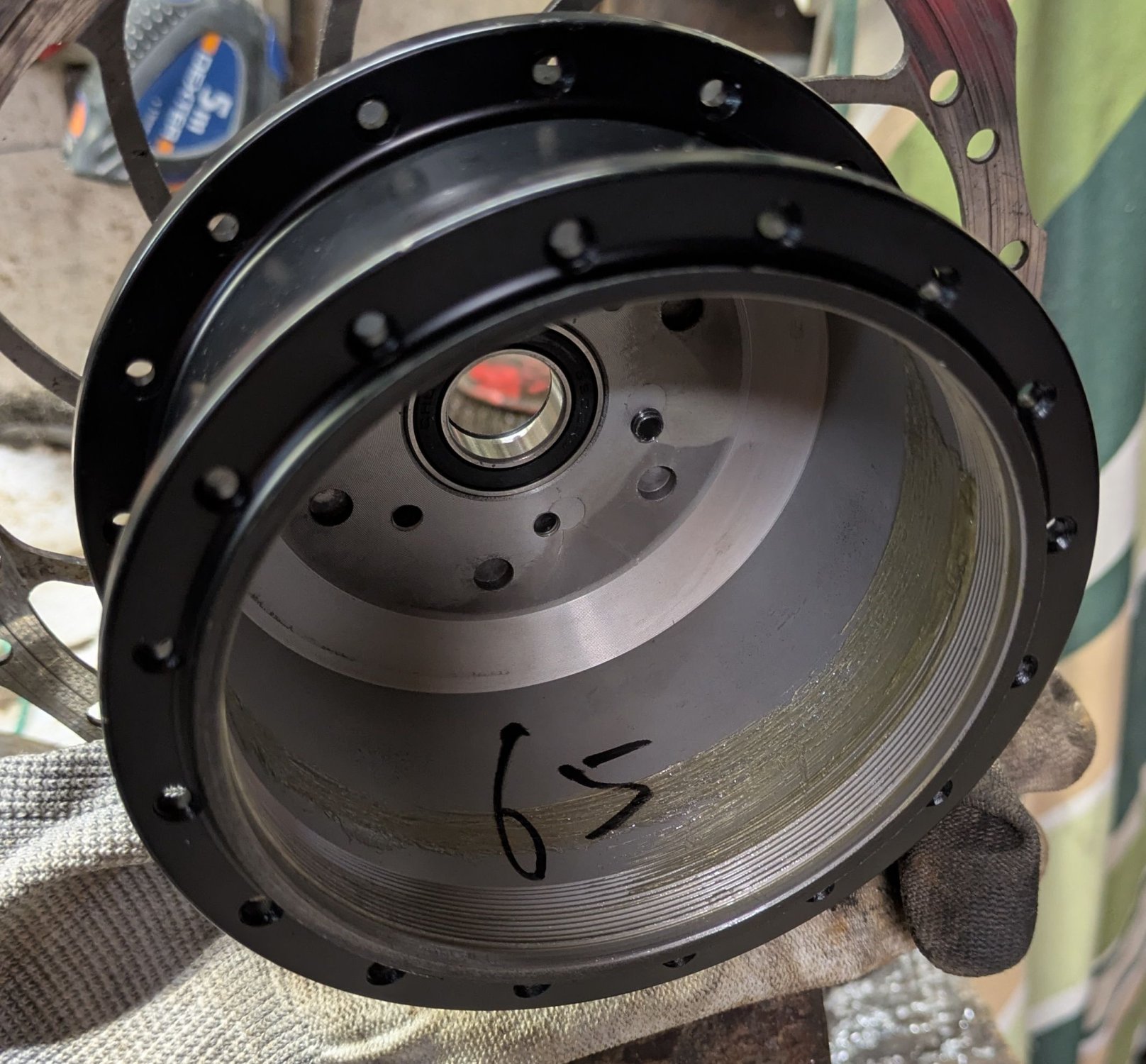

Hi
The original hub is a 201 RPM max. The hub is available in a 328 RPM 9-speed version. I didn't change the hub, but I did replace the internal electric motor and the freewheel body 11S. It's work well
