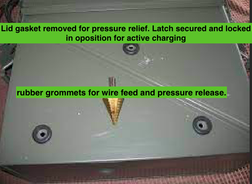

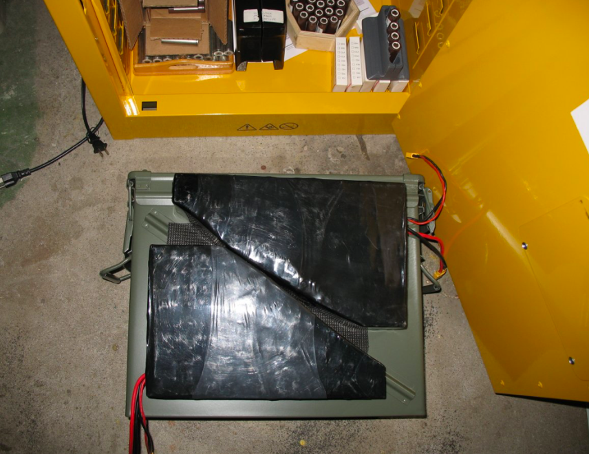

That’s simply not true. I’m truly disappointed that you would promulgate disinformation. I made it clear that it was the number of packs that inspired safeguards in my basement shop..
The guys having issues are messing with home made battery packs, charging multiple packs at a time, or otherwise using "creative" methods/technology. If you want to try something like that, cautions are a darn good idea, just in case your ideas are not.....
I thought I stated "production bikes" pretty clearly, no?That’s simply not true. I’m truly disappointed that you would promulgate disinformation. I made it clear that it was the number of packs that inspired safeguards in my basement shop.
Whose aftermarket battery came with a manual and instructions?
A simple event like a dropped pack can lead to a pretty little explosion when charging. How many OEM SUB $2000 factory direct bikes have Bosch level protection and sophisticated BMS? I’m sorry my friend but you’re being naive.

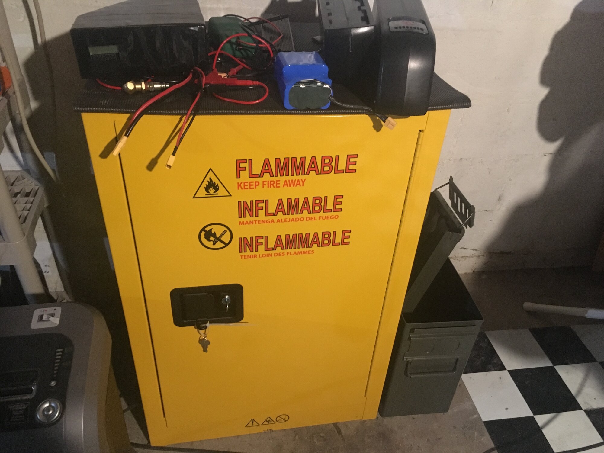

A safe steel container or containment ought to be minimal. Even then anyone without a fire plan is being naive as well. You read ES remember the moderators fire?

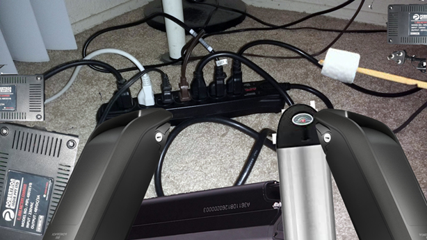

A charger plugged into a power strip?Is charging two 36 volt batteries factory made,on a power strip safe? Nakto batterys.
Thomas, you're welcome to be cautious as you like, but to sit there and try to scare people with production bikes, using suggested charging practices per owners manual, into being as cautious as you prefer, is something you can count on being called out on every time I see it. As can EASILY be seen by the lack of reported fires nation wide, your cautions are overkill, period.No, period. Do we think those budget OEM batteries are not a risk? Naïve.
Power strip has circuit breaker? Better than extension cord. Your chargers probably get hot like most chargers w/o fans. Don't put the chargers on carpet, etc.Is charging two 36 volt batteries factory made,on a power strip safe? Nakto batterys.
