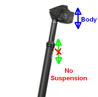

There is one more thing.
By installing a dropper, the user gives up the chance of using a suspension seat-post. There is only one suspension dropper seat-post I am aware of (PNW Coast) but that very seat-post has never provided any reliable suspension for me (a wrong design, I think).
For this reason, a dropper makes sense for a Full Suspension e-bike if the rider is looking for maximum ride comfort. (That's why the R&M, Specialized and Giant SUV e-bikes I mentioned are dual suspension).
Rockshox does make the XLPR 27.2mm dropper with some suspension. Only 75mm of travel, though. Made fir gravel bikes but could be shimmed for mountain bike use.
Our Apollos are full suspension so no real need for a suspension seatpost.
I looked at the picture of the XLPR. The major design flaw of such suspension seat-posts (same with PNW Coast) is these do not translate the vertical moments of the rider's body into the axial seat-post movements. It will not work well.

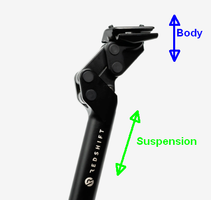

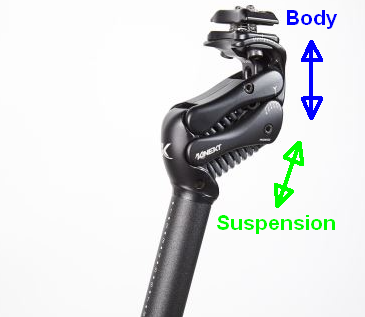

Cirrus Cycles Kinekt 2.1 works OK. (Not a dropper).
Redshift ShockStop works OK. (Not a dropper).
RockShox AXS XPLR, PNW Coast, other... Friction is killing the suspension action.
