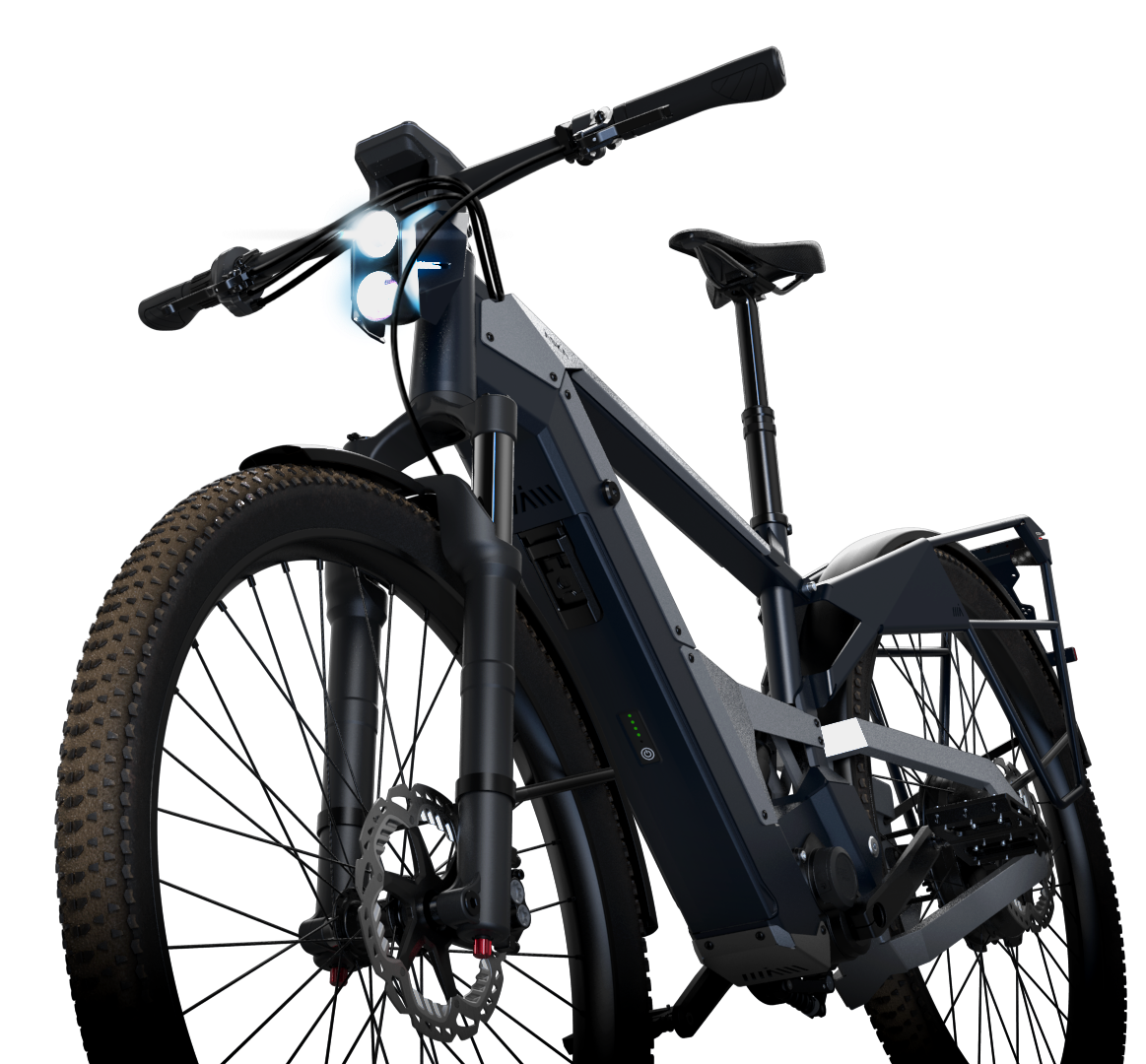

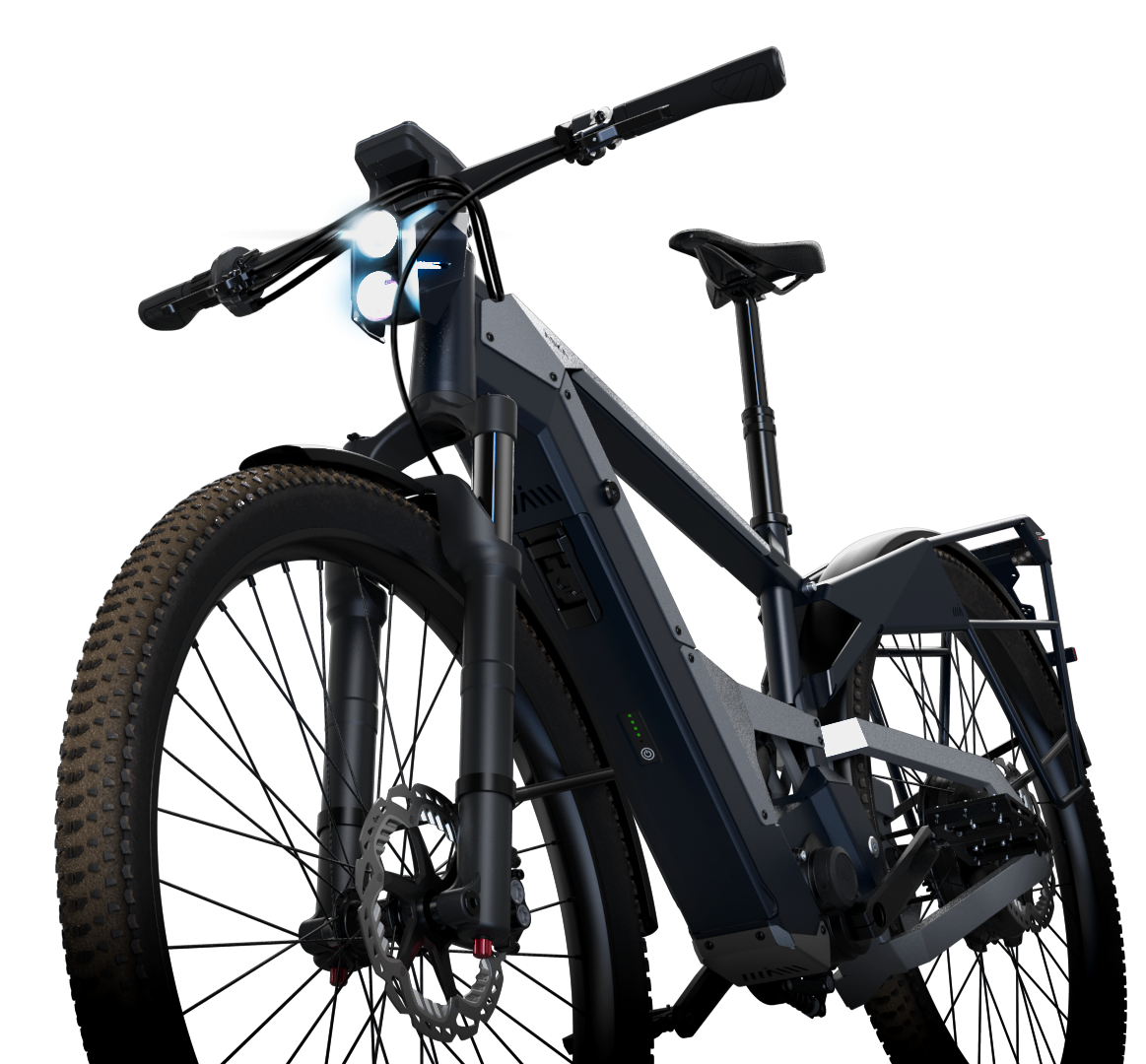

Super nice design and integration... take my money! ;)
Gag. Form over function. I hate that. It looks so nice, but you are inconvenienced by its design just to make it look good. Non-removable battery, so you have to schlep the bike to where you can plug it in? One button on the top tube where you have to push it over and over because there are no separate up or down buttons? Lights built into the handlebars and seatpost, preventing the use of an under seat bag or handlebar bag or basket? Never mind that you cannot aim the front light, or change the handlebar to any kind without losing the light. Also, if you are short, fugetaboutit. They only offer a small size of 53 cm and you cannot lower the seat much without losing use of the lights built into the seatpost.

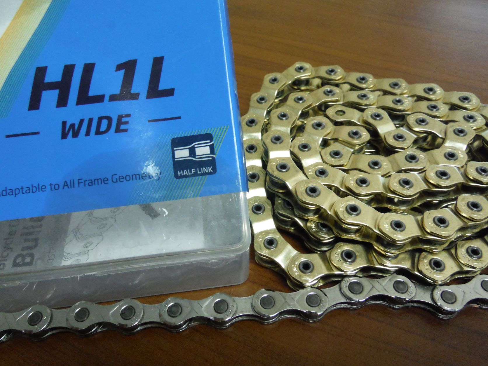

I am working on one now that IMO has a winning combination of a 7-pound mid-drive, to HL1L Wide chain, to an IGH. Why I like it: The mid-drive has the weight low in the middle of the bike for handling and power gets multiplied by the gears. The HL1L Wide chain is about as strong as a belt but less expensive. Finally, the internally geared hub is low maintenance, smooth, and can be shifted at a stop. This chain will need tightening after three-days. Then again at three-weeks. After the break in period you are good to go.
Here is the difference. The plates, rollers and pins are much more robust. Stresses are distributed, blunted over a larger area, not focused, or cutting. Though not for race day these are stronger chains made to last trouble free like a belt. Belts are also wide and strong so they last. But these chains are about $20 to replace. An e-10 is $55. A Gates belt is $70 but requires a proprietary chainring and cog. Those are big bucks.
On a belt drive though i would think you are not replacing the cogs very often or i would guess ever for most people? Just the belt for frequent riders or off road riders.
True. I replaced a Nexus IGH cog yesterday. It was $5. A Gates cog is form $70 to $270. At the lower figure you could buy 14:1. Grit will grind a Gates. It becomes a sanding belt. That is why there is a popular replacement parts market for them. Then there is the labor. After replacing a second cog the process is second nature. Easy.

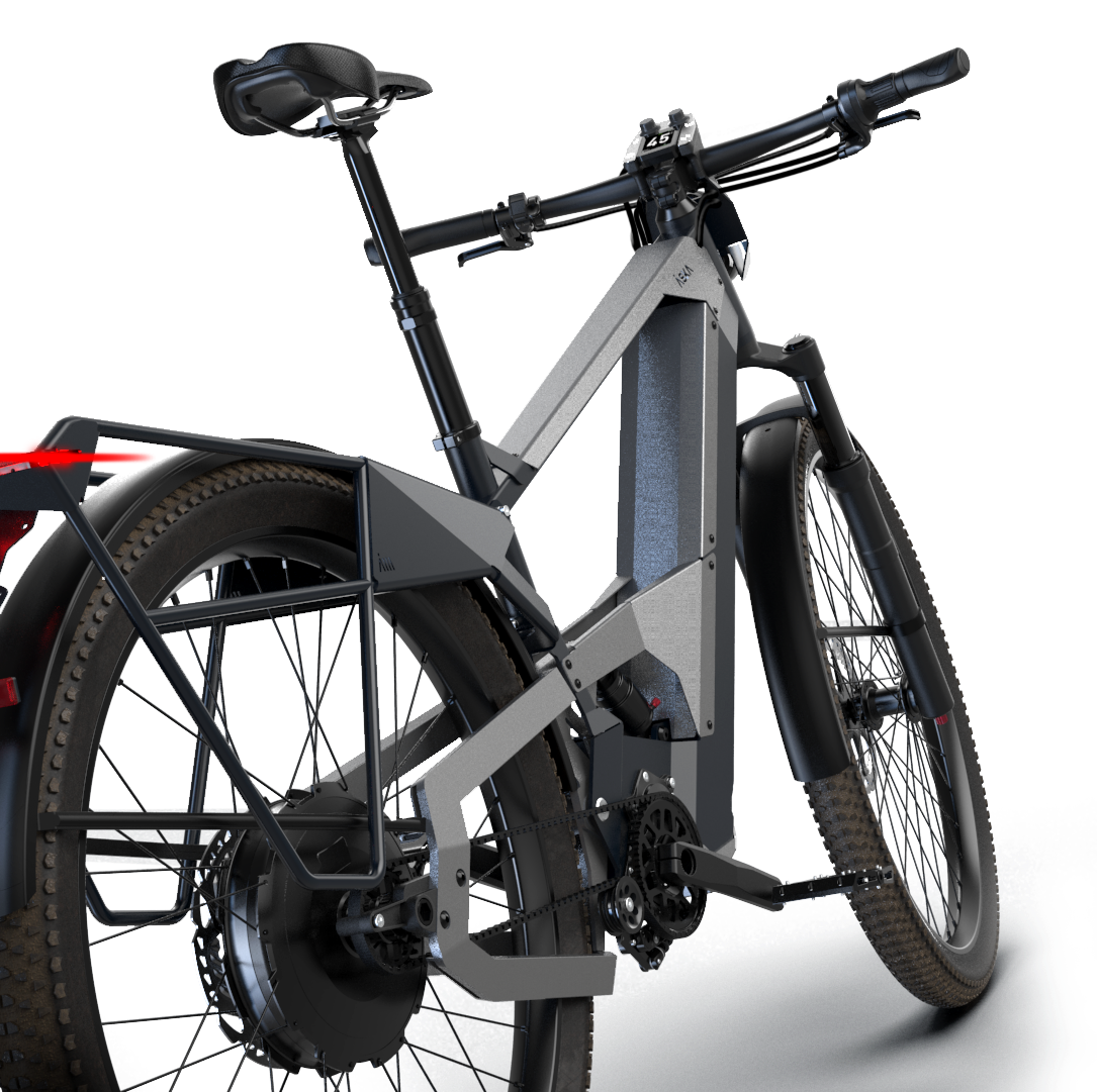

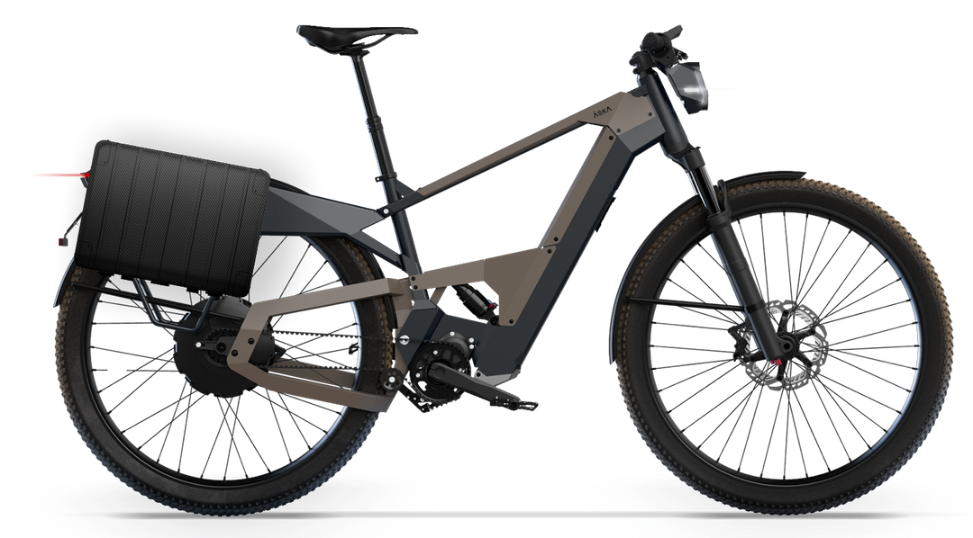

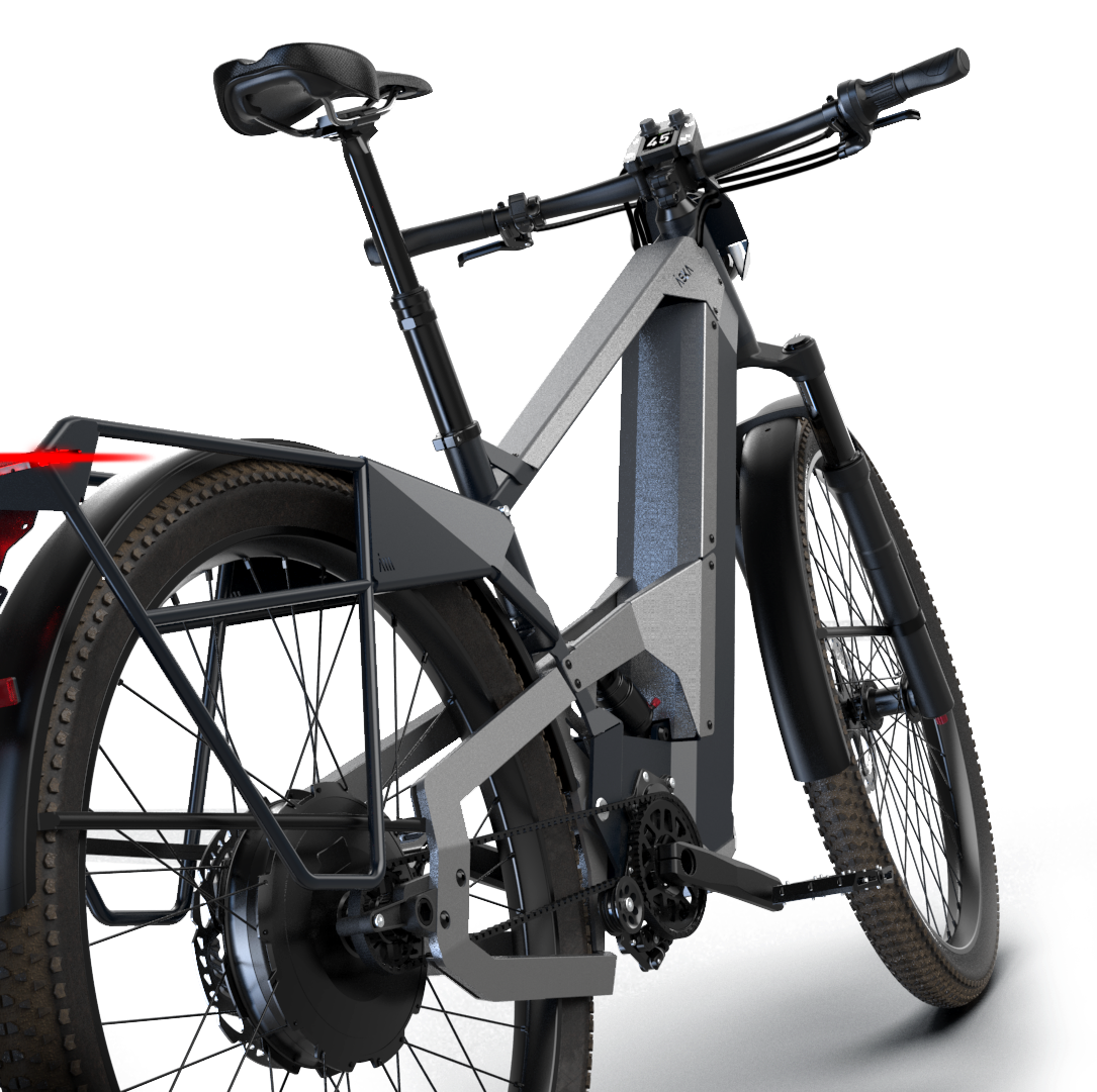

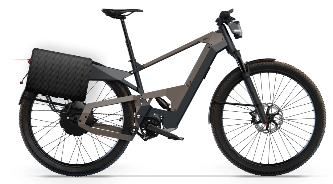

I thought this bike was very impressive both from a utility and design point of view.
ASKA Super commuter.
Right from full-suspension + Gates belt combo to Pinion drive system. Oh, it has dual suspension and the rear rack is fully suspended. Everything is thought out very well.
This is what a high end commuter should be. Unfortunately there are no such offerings in the states.
It has only one drawback, if it is corrected it would be the perfect commuter bicycle.
I thought this bike was very impressive both from a utility and design point of view. ASKA Super commuter.
Interesting frame with no apparent welds (ok perhaps the top tube to seat post area?), mostly stamped components with fasteners?
I wonder what the cost and weight penalty is vs. the shipping, lower cost assembly and supportability benefits?
Could different size bikes be accommodated by only changing out a few frame components? (that could be a huge benefit to a manufacturer these days)
