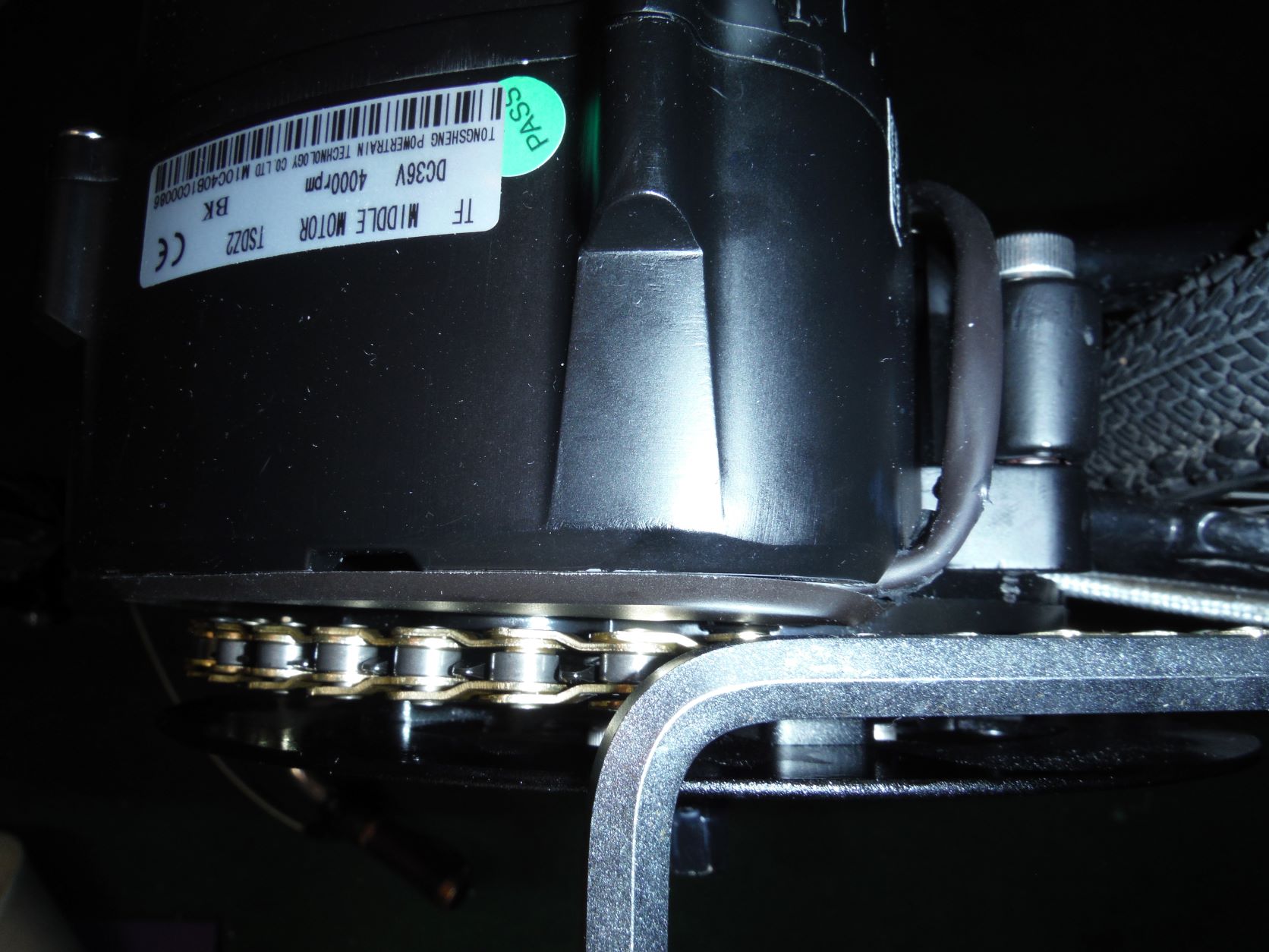

Here is the difference. The plates, rollers and pins are much more robust. Stresses are distributed, blunted over a larger area, not focused, or cutting. Though not for race day these are stronger chains made to last trouble free like a belt. Belts are also wide and strong so they last. But these chains are about $20 to replace. An e-10 is $55. A Gates belt is $70 but requires a proprietary chainring and cog. Those are big bucks.
I have used a half-link chain like this on a Cyclone and it was amazing for strength. But the one thing the belts do that I fell in love with when I had mine (past tense... I sold it) was the total lack of grease. Despite the *dramatically* increased parts cost you correctly point out, as well as the fact they are not as maintenance free as many think when you factor in extended use, given my druthers I'd rather have a belt on. But that means I need a Rohloff and that means we're talking a $2000 drivetrain. So I'm still using chains.

I am theoretically attracted to the pinion with belt notion. And then there is the coolness cachet of it. It just seems that in the real world it is overly complicated and overpriced for what it does on the upside. Then there is the added weight. Here is an 8mm hex wrench on top of a half-link chain. The outside of the chain is just wider than the tool. I am about to use ceramic premium dry lube on it. This lube is slick and does not attract grit. My friend Nathan is working on his wife's Gates bike today. Two fingers of the rear sprocket have broken off and a third is about to go. They are brittle aluminum alloy. For now I will go with the steel cogs at $5 each and keep it simple.
