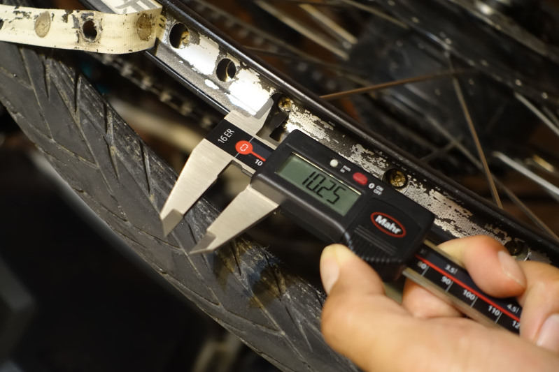

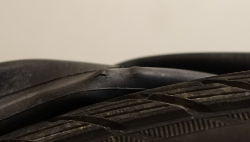

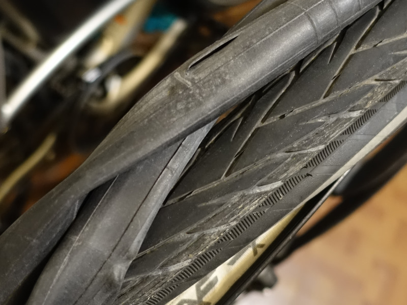

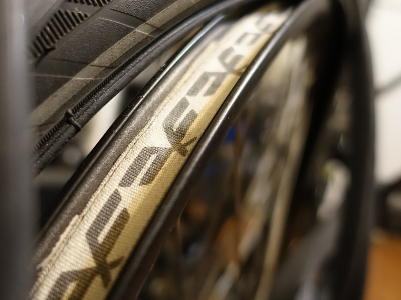

Anyone one else have continuing issues with rear flats? I'm on my 5th or 6th inner tube now. It was ok for about 2-3 month & then I suddenly got two flats recently after having to deflate & re-inflate to replace a spoke. The blowouts came soon after this. Luckily this happened not during riding, but rather while just sitting at home. I don't feel anything sharp there, but they occurred in the same area on the valve side. After the first time I doubled up on the rim tape, but that only lasted until today. I think the issue is the high pressure the rear tire is subject to causing the inner tube to bulge into the rather big spoke holes. What I don't get is why the bulges are so close to each other. Maybe the inner tube is also shifting? The 17mm rim tape here is the Performance bike brand Made in France (Velox?). The front tire has been no problem with the stock tire & rubber rim strip. I run around 60-65 PSI. I'm going to look into maybe plastic rim strips next. My previous 26" wheeled e-bike came with them & had no issues through 10,000 miles. What would be ideal though would be plugs for these spoke holes.
Anyone one else have continuing issues with rear flats? I'm on my 5th or 6th inner tube now. It was ok for about 2-3 month & then I suddenly got two flats recently after having to deflate & re-inflate to replace a spoke. The blowouts came soon after this. Luckily this happened not during riding, but rather while just sitting at home. I don't feel anything sharp there, but they occurred in the same area on the valve side. After the first time I doubled up on the rim tape, but that only lasted until today. I think the issue is the high pressure the rear tire is subject to causing the inner tube to bulge into the rather big spoke holes. What I don't get is why the bulges are so close to each other. Maybe the inner tube is also shifting? The 17mm rim tape here is the Performance bike brand Made in France (Velox?). The front tire has been no problem with the stock tire & rubber rim strip. I run around 60-65 PSI. I'm going to look into maybe plastic rim strips next. My previous 26" wheeled e-bike came with them & had no issues through 10,000 miles. What would be ideal though would be plugs for these spoke holes.View attachment 11429 View attachment 11432 View attachment 11435 View attachment 11438
That's the best rim tape available, definitely contact support at Juiced- they will help.
It could be the tubes getting pinched between the rim and tire when you install them. It can take a while for the tube to fail when you do that. I always put some air in the tube so it's pretty firm before I put the tire on to protect against that happening. I doubt it's the rim tape as it looks fine to me. That slight depression is normal and isn't going to cause repeated tube failures. If you are convinced it's the spoke holes I would suggest Veloplugs covered with rim tape.
It could be the tubes getting pinched between the rim and tire when you install them. I always put some air in the tube so it's pretty firm before I put the tire on to protect against that happening. I doubt it's the rim tape as it looks fine to me. That slight depression is normal and isn't going to cause repeated tube failures. If you are convinced it's the spoke holes I would suggest Veloplugs covered with rim tape.
The tires with these rims are so loose that I can install & remove without tire irons which surprised me when I first took off the tire since I;m use to having to use them with my other bikes. Also scares me since the inner tube will blow out the tire if not careful to make sure it's seated evenly all around by the bead. So not likely a pinching issue. It's a bit tough to see but the depression in the one spoke hole where the inner tube is bulging is a bit deeper then the other holes. I think plugs would fix this, but the holes are over 10mm in diameter so too big for the stock veloplugs. I'm just gonna try some Ritchy snap-on rim strips next.
The issue is a small bit of the deflated tube gets trapped between the rim and tire bead and you can't see it. Once you inflate the tire it starts moving around and eventually fails in a similar fashion to a pinch flat. Your second picture of the failed tube looks like the tube was caught between the rim and tire bead. Some guys go around the tire and push the bead towards the center of the rim before inflating to make sure the tube isn't caught in there. I like putting some air in the tube so it's not possible for it to get caught. I can't blame you for trying a new strip if you keep getting blowouts though. I got some cloth rim tape to put on when I get my new Schwalbe tires. I think I'll install them OVER the stock plastic strips to reduce the dimpling if that is indeed the problem.

I'm looking at the two pictures of the blown tubes and wondering if the tubes are the correct width to match the tire and rim, those look a bit too narrow. If you try to use a tube that's too narrow for the tire, it's vulnerable to a pinch flat or to rolling around on the rim when it shouldn't. It is always a good idea to add a bit of air in the tube before putting it inside the tire so the tube doesn't twist around and lies flat but not really that much. Too much and you risk pinching it when you install the tire on the rim.

I do inflate the tire a little so it has some volume to avoid bunching inside the tire. What you see in the pictures were the same issues I had with most of the flats in the beginning when I got the bike which I thought I had fixed through deburring the spoke holes & switching to the cloth rim tape. My patch jobs would actually bulge out like that & eventually fail in the same spot.

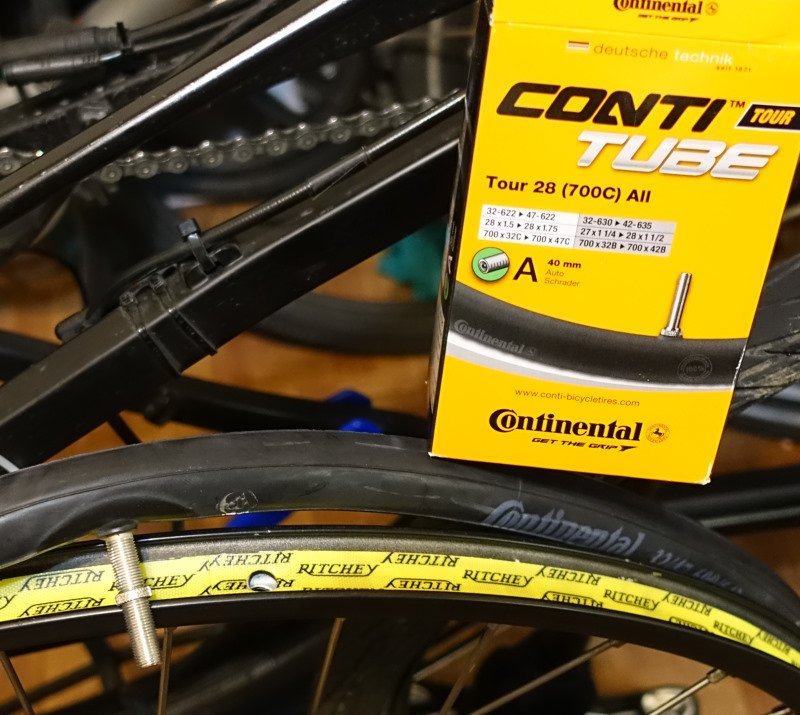

I bought a park tension meter to try to work this out on my own. Waiting to see if they can provide a tension spec for this unbranded rim. Currently the drive side is 130 Kgf & 100 on the other side. Also gonna switch to Continental Tour 700x32-47 inner tubes hoping that better quality inner tubes help. I do wish the rear did used normal gauge spokes because what I've read about them in some endless-sphere threads 12g spokes are unnecessary. I'm about 40lbs heavier & the the stock $140 Velocity DYAD 36 hole wheels on my non electric commuter have been bombproof riding through much of the same conditions. I'm approaching 3,000 miles on my CC.

Got my rim strips & new inner tubes today. Going back to the Giant tubes I could feel a thick seam between the bulges where they failed. The made in China Conti's feel uniform all around so the quality of those other tubes could've played a part in their failure.

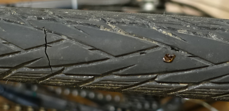

After getting it all installed I noticed this on my Schwalbe Energizer Plus HS 427 tire. One big gash & a piece of glass that both cut all the way to the green integrated liner. Luckily the liner looks to have kept it from slicing the carcass and it's not bulging out so I'm hoping I won't have to replace it.
Replace it...

Replace it...
Though the tire is likely still good since the casing isn't compromised I probably will replace it just for peace of mind. I can see the slice cut into the greenguard liner. Also on 2nd thought I should've gone with the Schwalbe rim strips instead of these Ritchy's as they're only 17mm wide whereas Schwalbe's come in wider widths that would cover all the way to the inside walls.
I only see Schwalbe selling rim tape. I think 15-17mm is what you want anyways. It just needs to be wide enough to cover the spoke hole area. That 25mm rim tape is meant for wider mountain bike rims. With those plastic rim strips if it's too wide it will curl up at the edges and expose a sharp edge.
