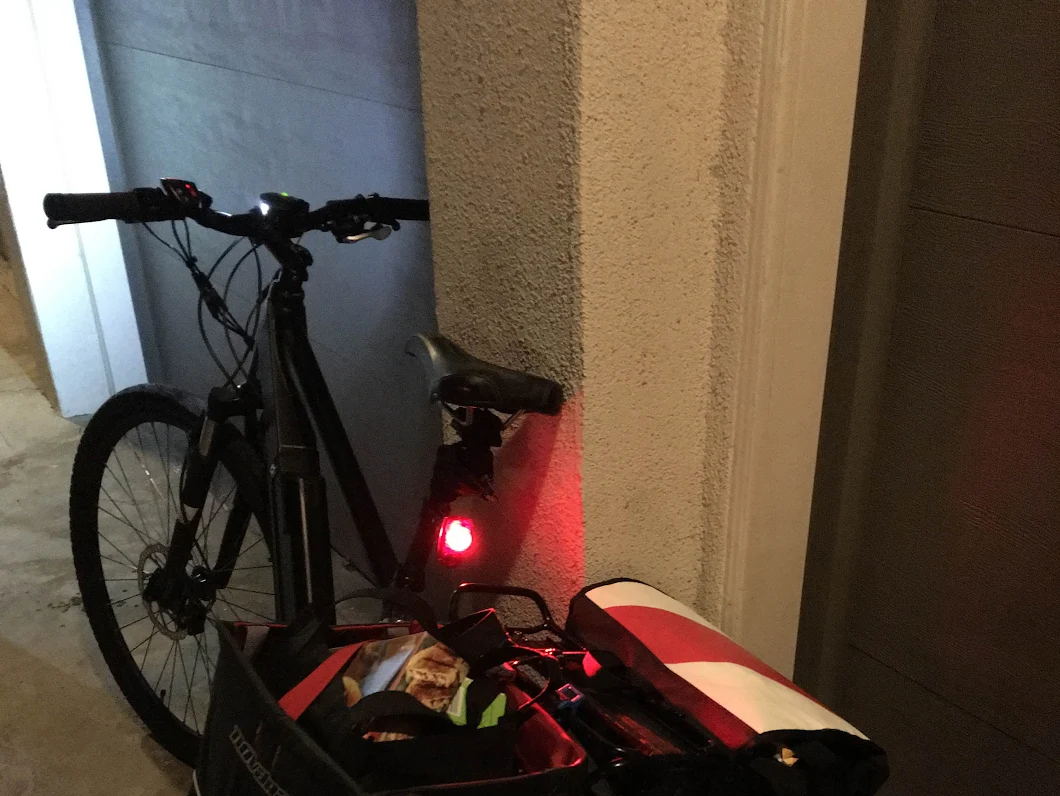

Here I am getting groceries on the Cross Current. Bike is very stable with 40lbs. on the back. I have the MTX Trolly Tote I can slide on top of the rack with two panniers installed to carry even more stuff.

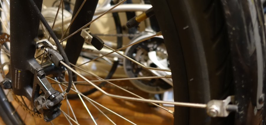

2nd question I'd like to install sks velo 55 fenders but the front fork doesn't have any holes to mount brackets? What do I need to do it?

I don't have a Toppeak rack, but the drive side dropout does stick out more due to the torque sensor. Also the holes on the dropouts aren't aligned for perfect rack mounting so what you're seeing is normal. I use a different rack with some mods to get it centered.
The fork has these mounts & one through the arch which may be plugged. For the fork legs any strong piece of L-shaped material with two holes drilled in it.

Itsmejson, I have a write up in the juiced bikes page with one option for centering the mtx rack. I also recommend using p-clamps for your front fender. I had some 1-1/4" p-clamps I bought from a company called velo orange here: (Link Removed - No Longer Exists)
Youth, I did not realize those two plugs could be removed to mount a fender. It would have made life easier because I have several l brackets laying around.
I checked my fork and I don't have any of those points I'll take a photo and post later.

The mount points are on the back of the fork. I have them on mine. I go by the battery meter on the bar when the battery is under a load. Once it gets down to 2 bars you're pretty close to empty. Even when the battery is almost totally empty it still shows 4/5 bars static battery voltage.
