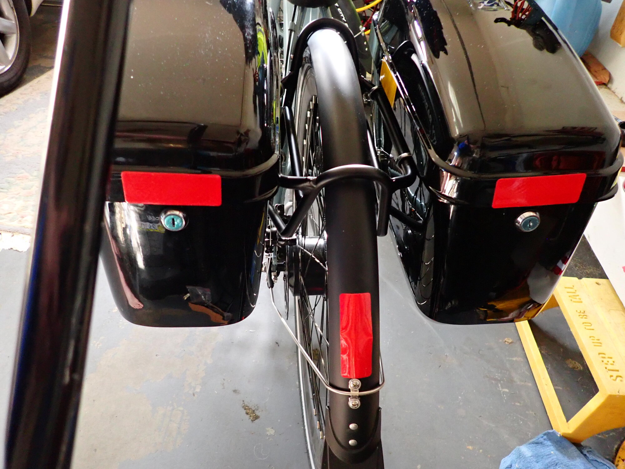

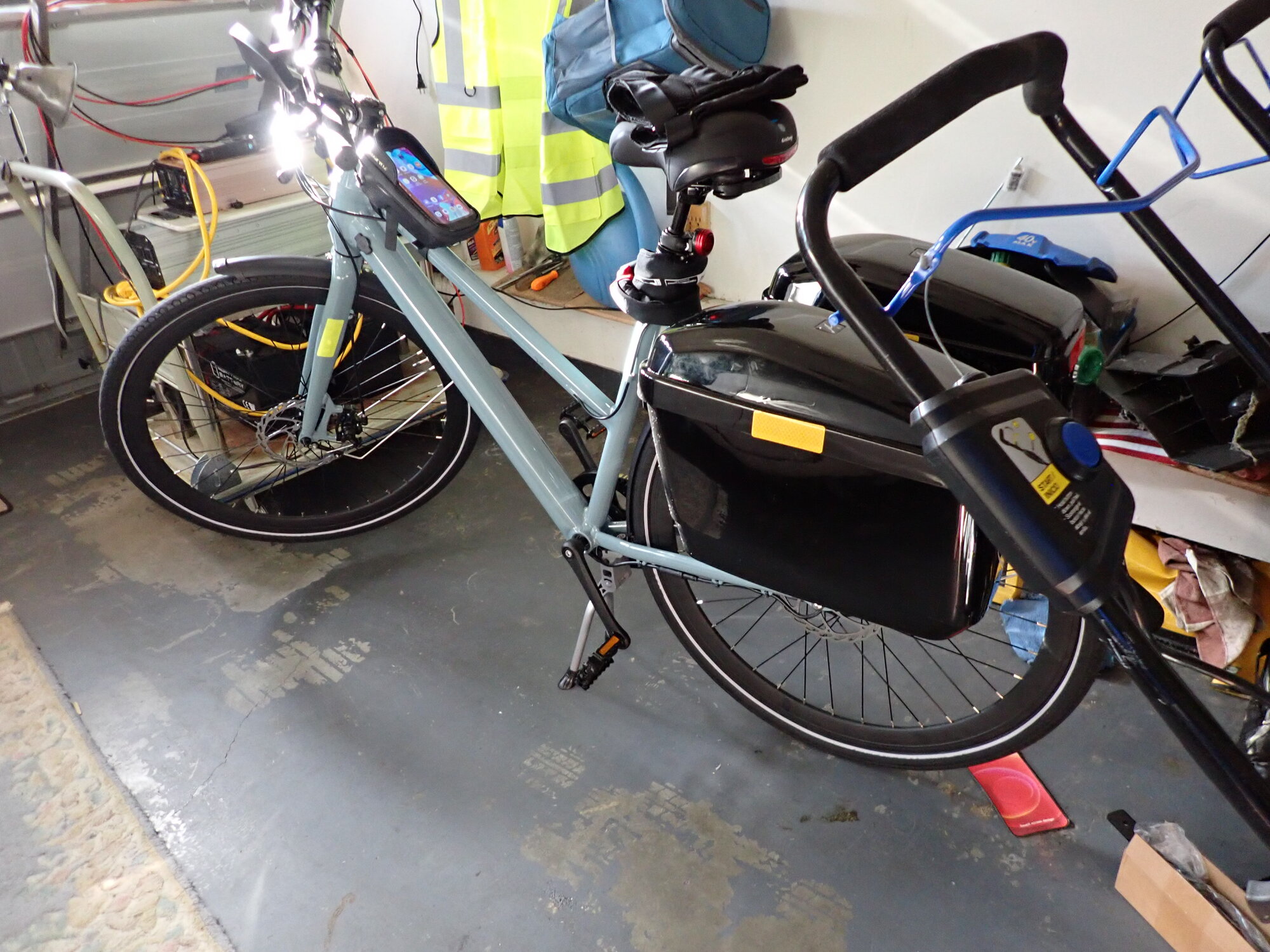

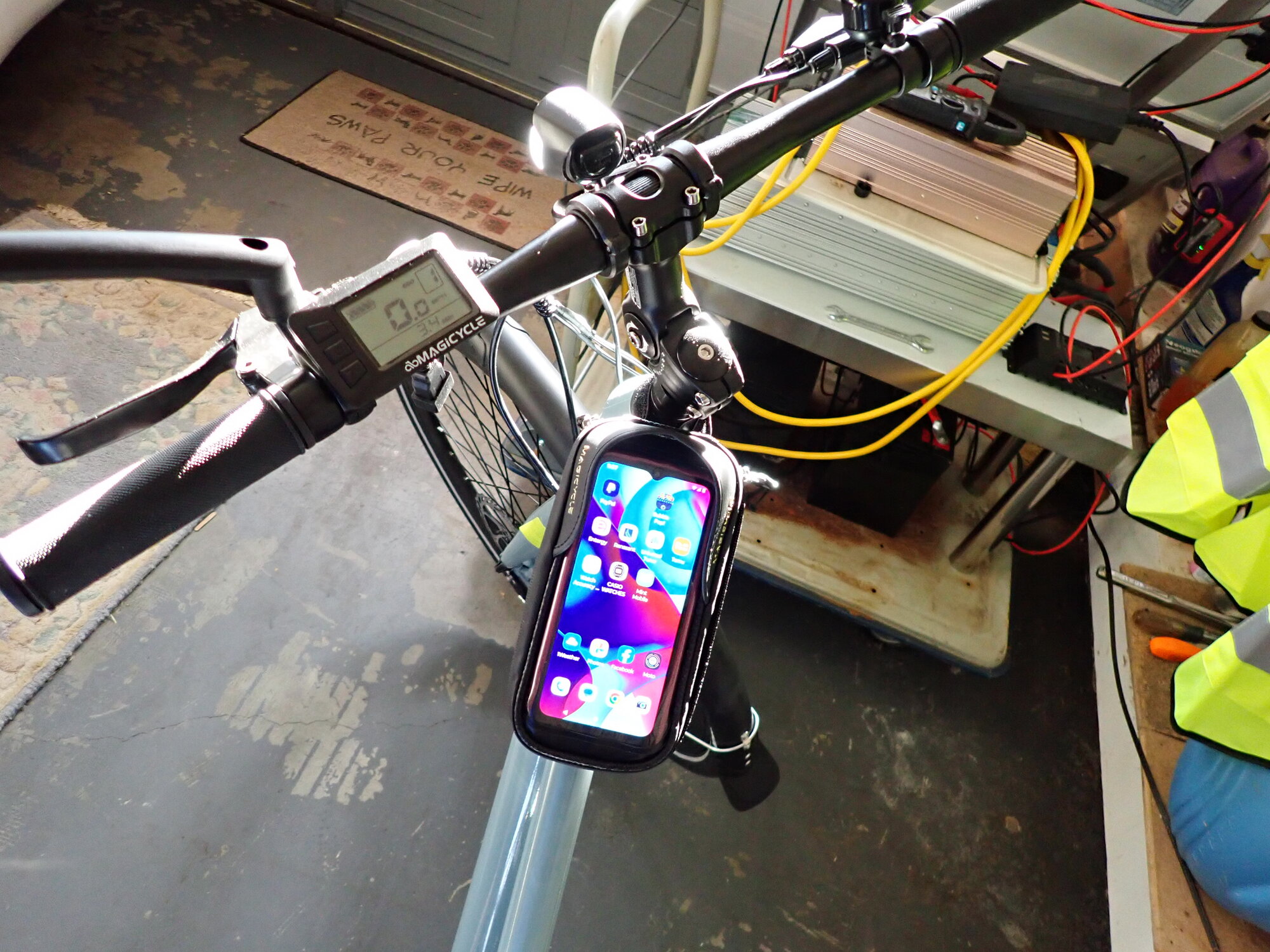

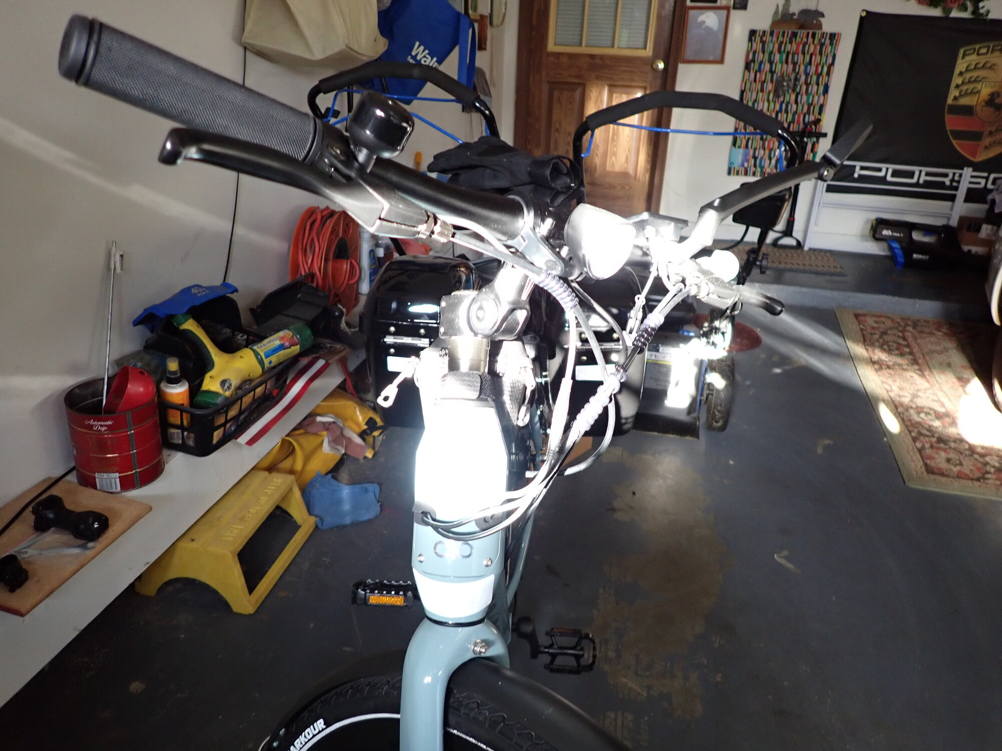

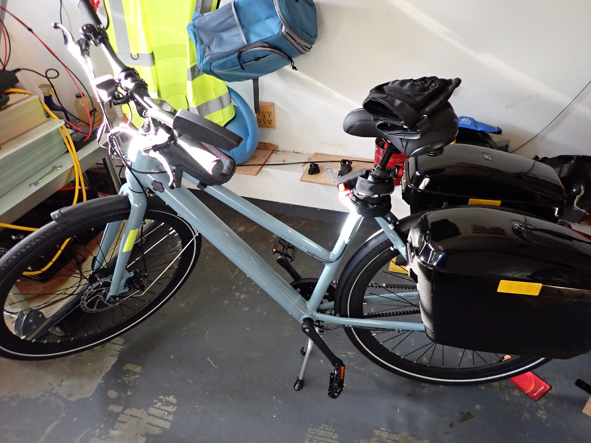

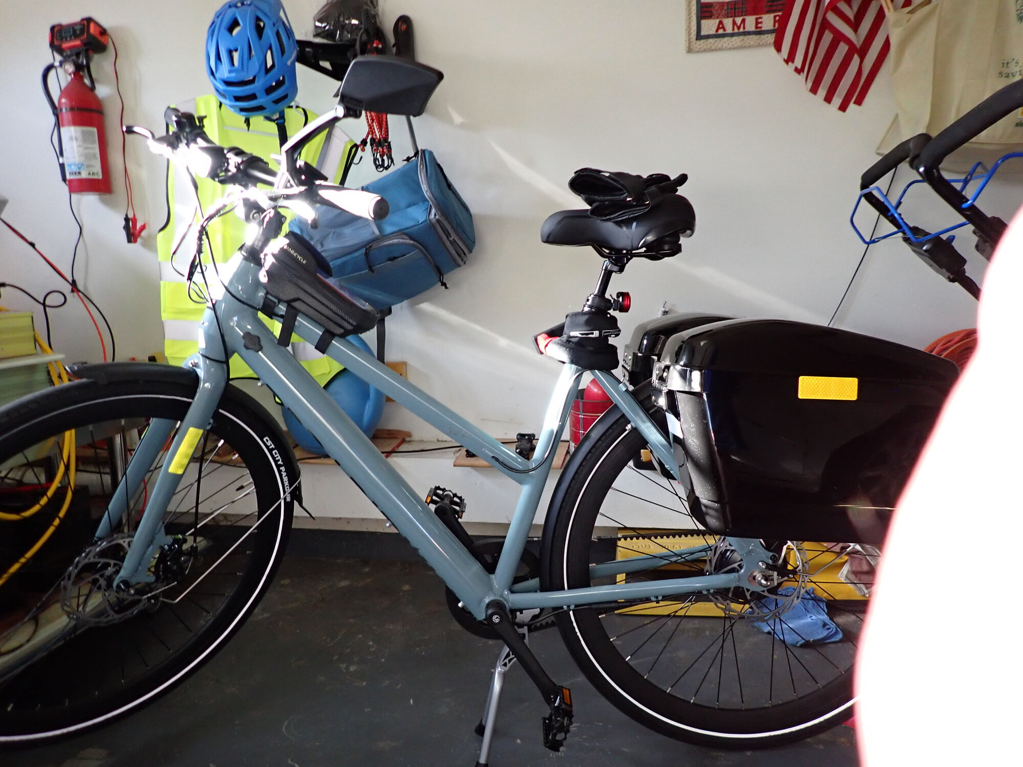

So I think it is a great bike for your wife to try. I got one and live in a hilly neighborhood and can go up the steepest hill in pas 2 or 3. Most of the time pas 1 is enough and great for no effort peddling. Then she can add things if she wants. On mine I changed the seat and added a suspension post. Also added an adjustable handlebar riser so I can sit more upright. The waterproof phone bag is from magicycle. I tried some soft panniers for grocery runs but did not like them so I switched to some locking hard cases. The only issue she might have is starting up if stopped on a hill but other than that the single speed belt drive is quiet and maintenance free.
Used code M60 for $60 off sale price.
