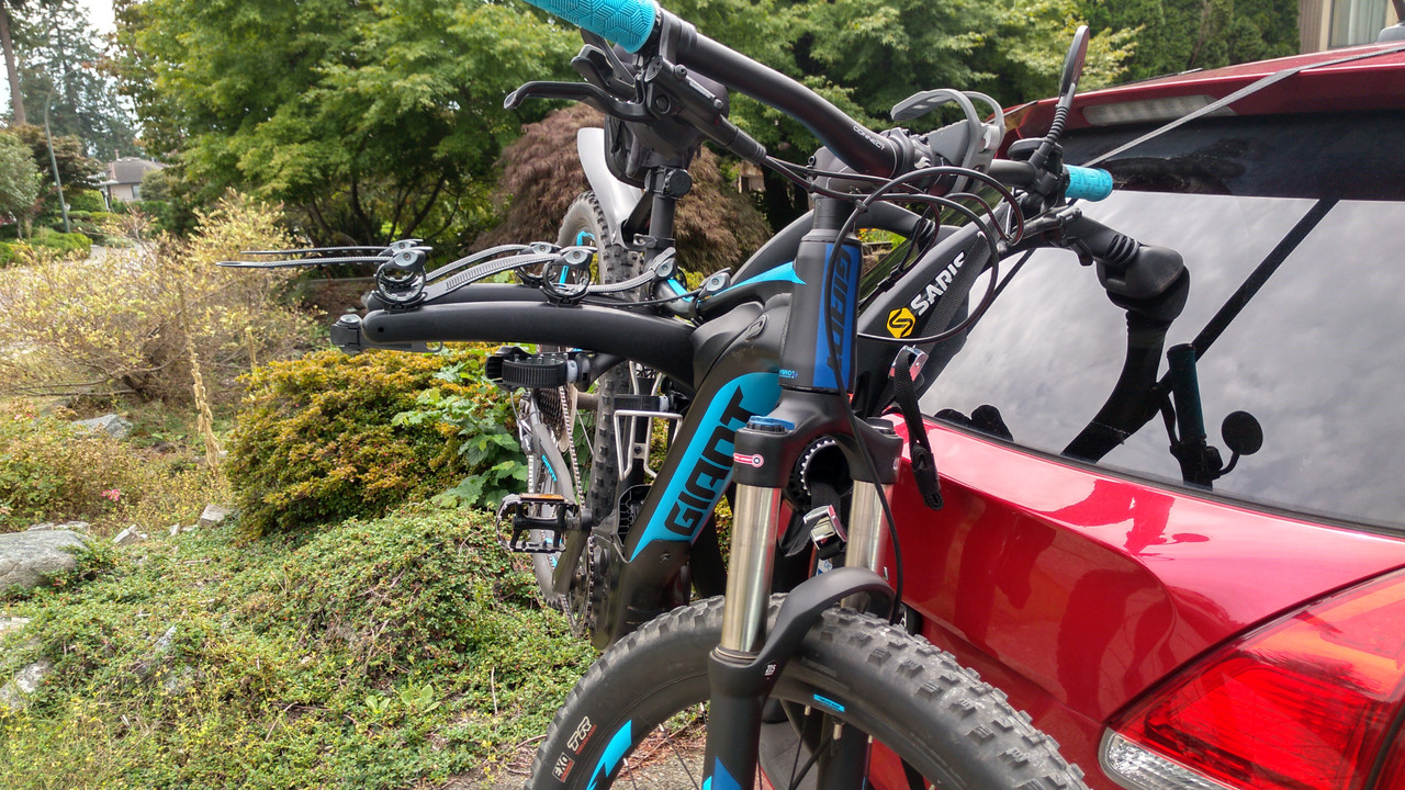

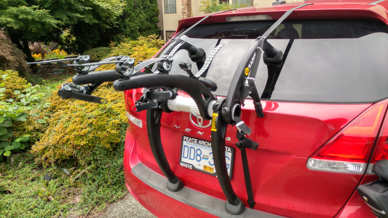

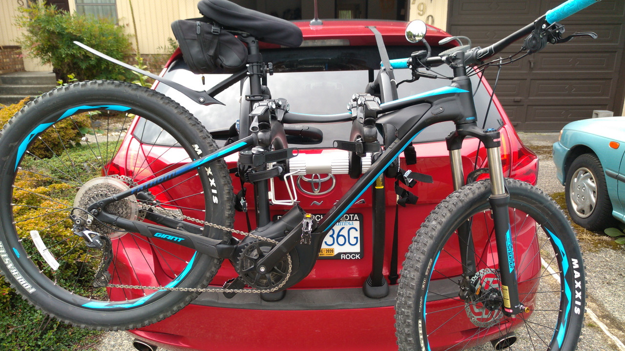

I just got my new Saris Bones EX 3 bike rack today, and it's a massive improvement over the old/tired one I've had for 25 years or so.
It's rated for 105lbs so I'm good to go with my ebike and a buddy with his acoustic bike. The old unit was tenuous at best.
Others will of course extol the virtues of hitch or roof (not so much for ebikes I suspect), or other types I've missed.
Here's my new Saris...
Let's see what you've got!

Excellent observation, and one I took into account as well.
My use case is for two bikes, and my ebike will always be the first one racked, and closest to the vehicle which always minimizes weight issues.
I know I'm "taking a chance" as it were regarding the 35lb per bike stat, but based on how this thing works, and how I've used previous devices I believe I'll be good to go.
It's built like a tank, and the bottom feet rest on the bumper. I went for a drive after install with the bike on, and purposely turned corners swiftly, and over speed bumps a little too fast. Works a treat!

But I wanted to ask you about the rear fender you show in your first post. It looks like it clamps to the seat post? I've got a couple of bikes (non e) that I still use and they have no fenders. The kind of fender you show looks like it MIGHT work for me.
