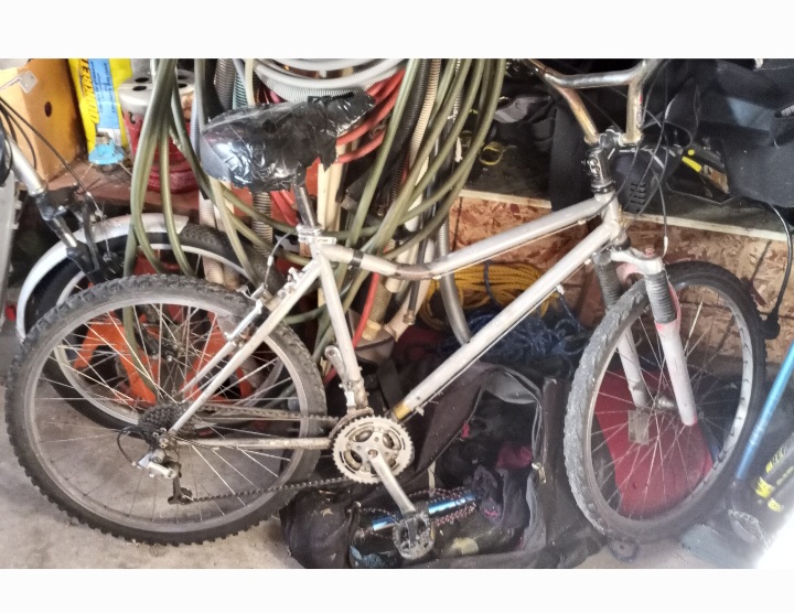

I recently had to use my MTB while my ebike was down. I then remembered why I’d stopped riding it in the first place. I tried raising the handlebar about 7-8” to try to make the MTB frame more comfortable for me to ride, but even like that it's not as good as my ebike. Maybe with some pedal assist I could spend more time on the MTB.

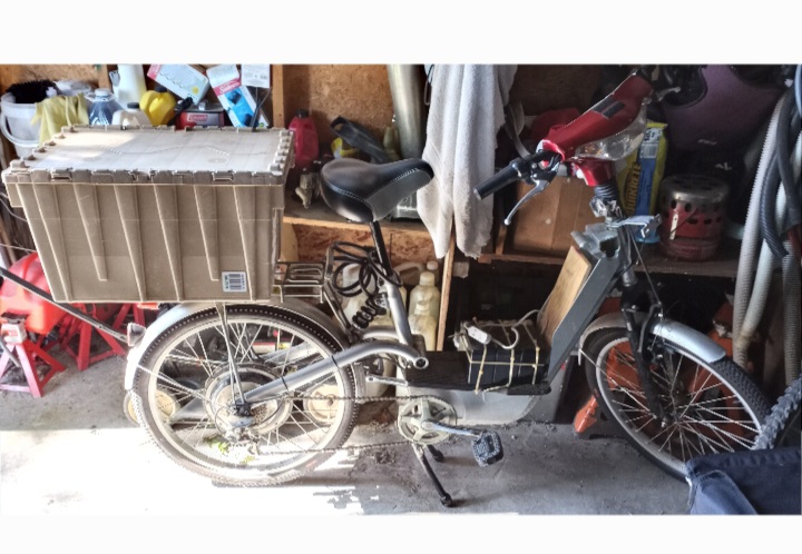

I still have a Blast riding this old piece of crap,..
I rode it to the grocery store today through 6 inches of fresh snow.
I loaded the box with 70 pounds of groceries and rode it home with legs sticking out as outriggers the whole way.
It was sliding around and wobbling all over the road.
What a Hoot. 😂
I don't ride this one anymore, but only because it ain't got no power,..
It's still a Great Bike with it's customized frame geometry (hacksaw, blow torch, sledge hammer) refurbished seat (duct tape) and new handlebars (found them in the garbage). 😂

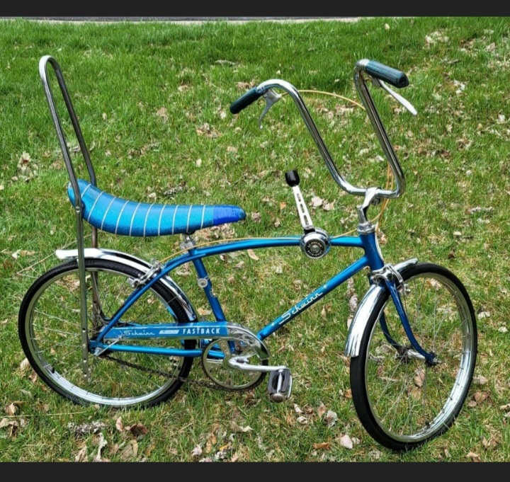

I had one of these for a while in grade 5 or 6.
Complete with the banana seat, sissy bars, and three speed shifter.
It was The Cats Ass at the time !!
I should gets me another one and electricate the hell out of it?
All I'd probably need besides a motor, battery, and throttle, is a longer seat post?
(I used your new word in a sentence, but my spell check was pretty Pissed Off about it.
I had to retype it three times. 😂)

I had a Raleigh Chopper in the 1970s. I agree, these bikes would’ve been a riot to electrify (electricate). Heck, that Sturmey-Archer shifter could be replaced with one of those 5-speed Bafang hubs we were talking about elsewhere! The shifter could be hooked to a controller to vary pedal assist!
,.. that Sturmey-Archer shifter could be replaced with one of those 5-speed Bafang hubs we were talking about
Actually the 5-speed Bafang hubs turned out to be just hubs, so they would have to be a mid-drive setup, but the two speed auto rear hub motor might work ?
EDIT: The bike already is a 3-speed IGH, so all you need to do is add a mid-drive or bottom bracket motor.
Then both the rider and the motor can take advantage of the IGH.
IIRC, you had to pedal backwards while shifting gears, so you could hook up a cadence sensor to idle the motor while you're shifting and pedaling backwards.
Hah! Perhaps you didn’t have a lot of experience with those ‘60s-‘70s Sturmey-Archer hubs… :)

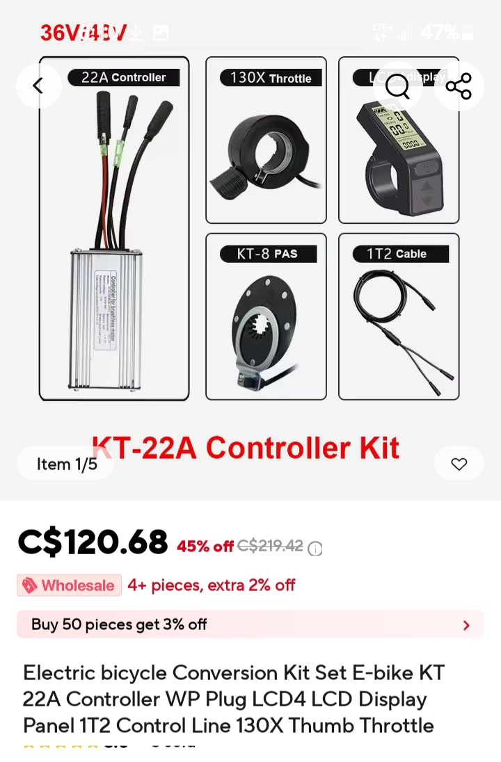

The price of building an ebike yourself isn't all that bad, providing you can build or procure a motor wheel, battery, and know how to solder and crimp. Plus, all the usual bicycle stuff, because if you build on a used bike it's best to rebuild it before you motorize it.
And you might end up with a very capable ebike. Just don't try to sell it and expect a price commensurate with the time and expense you invested.

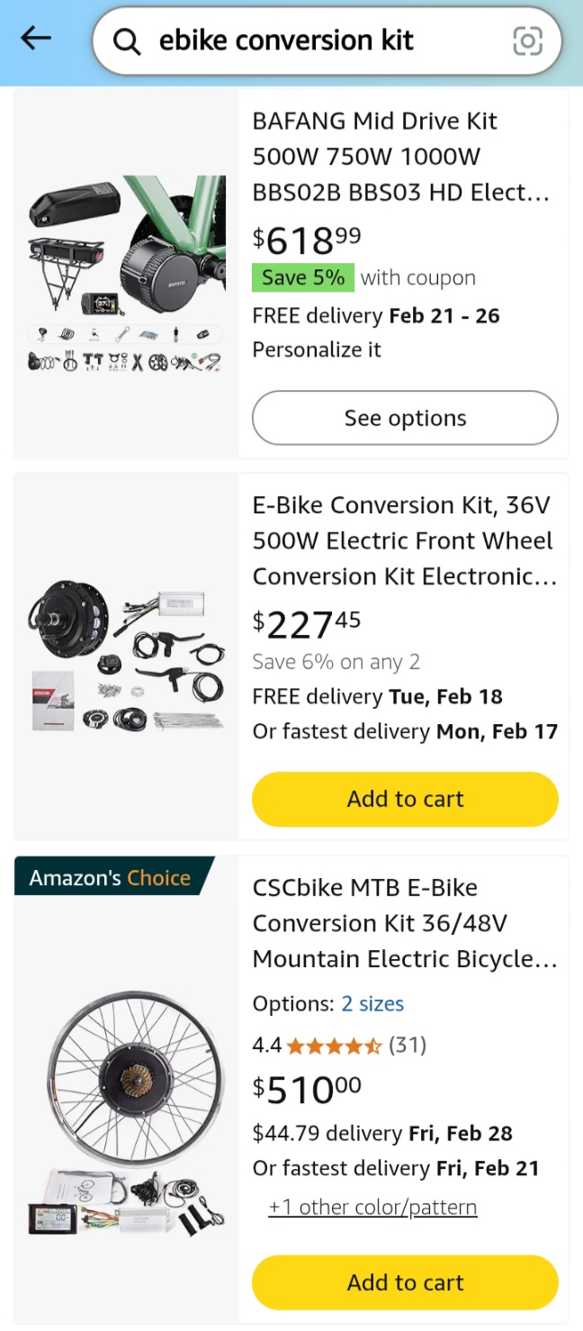

They have complete kits too that are almost plug and play that can electrificate almost any bicycle to a "mid-drive" (bottom bracket) or hub drive,..
And you can get a "bricked" hub drive ebike for almost free, then bring it back to life with a new controller and display, without too much cutting and soldering. (Hub motors are all basically the same with 3 phase wires, 3 color matched Hal sensor wires, a speed sensor wire, + 5V and ground. (Some rare hub motors have a temperature sensor wire as well.)
You might need a new battery if the original battery is "bricked" and proprietary.
It shouldn't be too hard or expensive to save a dead e-bike from going to the landfill.
