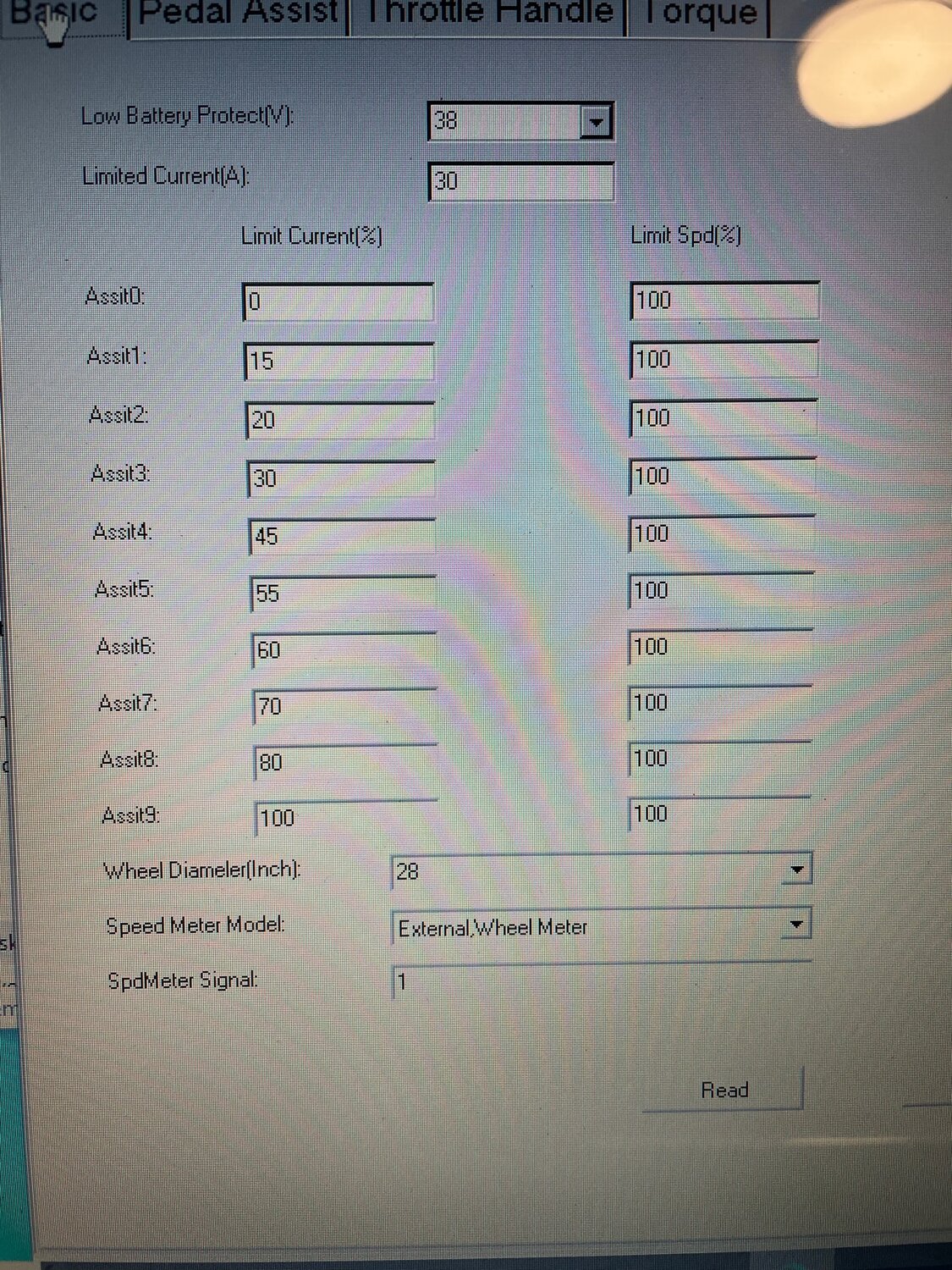

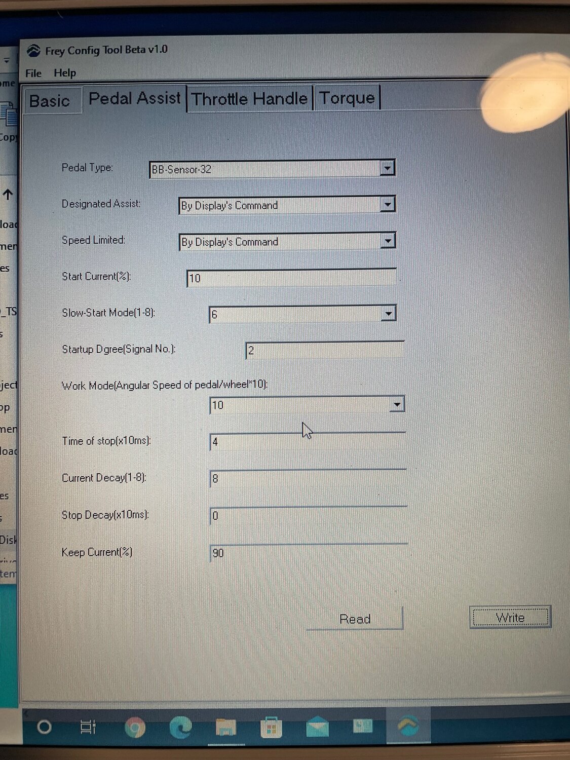

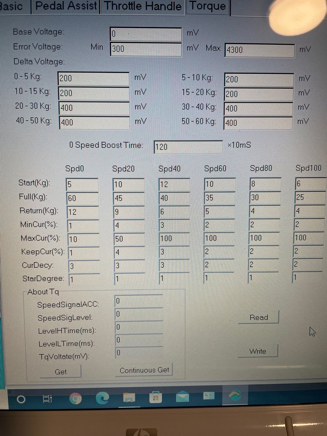

Got out for a ride, got rained on, my hands got really cold because I didn't have on warm enough gloves and quite frankly didn't have a great time. I copied the PZ tune to the number and right away I could tell it wasn't going to work for me. My route starts out of the driveway down hill and you run out of gear pretty fast. However before I did I could feel the motor surging on/off and the pedal feel was decidedly biased towards cadence sensing. I almost turned back because of it but decided to ride it out to see how the other aspects were.
After ripping up the road a mile which I usually do in 4/5 to get it out of the way, it is only the first 1/4 mile that is downhill, I turned onto the logging road entrance and that leads to a long uphill and once again in mode3 that I have been climbing this hill in the pedal feel was decidedly cadence sensing. I only did a small amount of trail ride, less than planned, because it just wasn't feeling right to me and so I stayed on the gravel. I am sorry Prophet but I will be going back to my most recent settings as so far they have felt the best to me in regards to natural pedal feel with no surging.

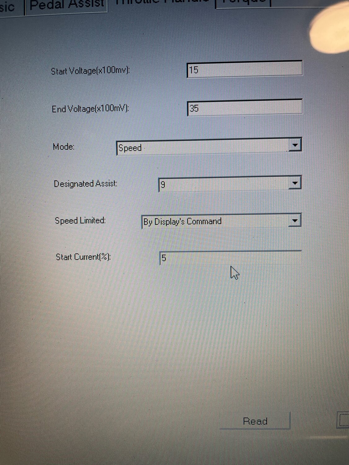

Throttle is set more powerful than I had mine but not as much as when stock but I'll go back to my old settings where I can mash the throttle all the way down from a standstill and have a nice take off speed/torque. I don't use the throttle for other than that and a walk assist so I don't have it set to operate at higher speed.
Still was getting a cutout at low speed /high torque (just when you need a bit of power) with the PZ tune and I think I know what to mess with there and will try that when putting back my other tune. It's not a big deal because a blip of the throttle keeps you going but shouldn't be there I know.
