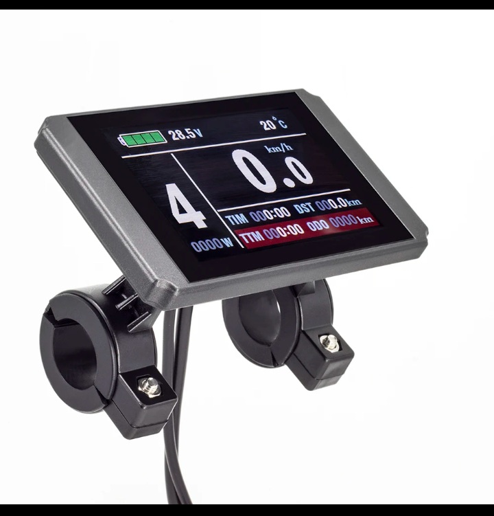

I went with the slightly older color display thinking that I wouldn't like the 3-D effect of the newest model.
I didn't want the USB port, so I saved a few dollars.
I'm thinking now that I would have liked the newest model better with the graphic display.

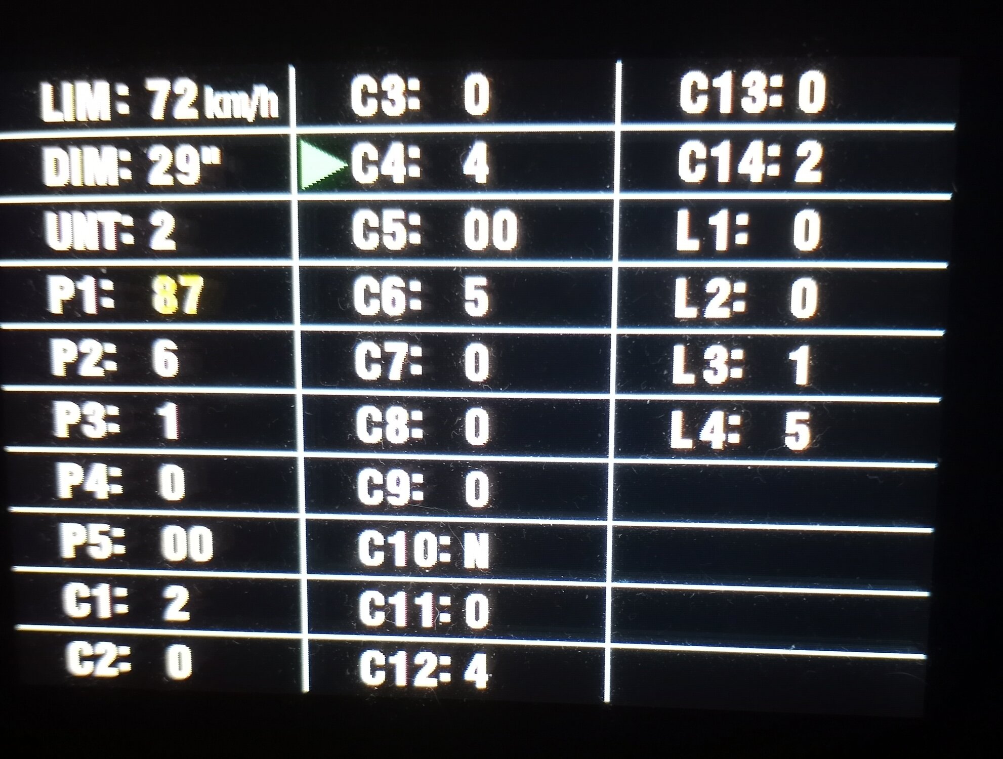

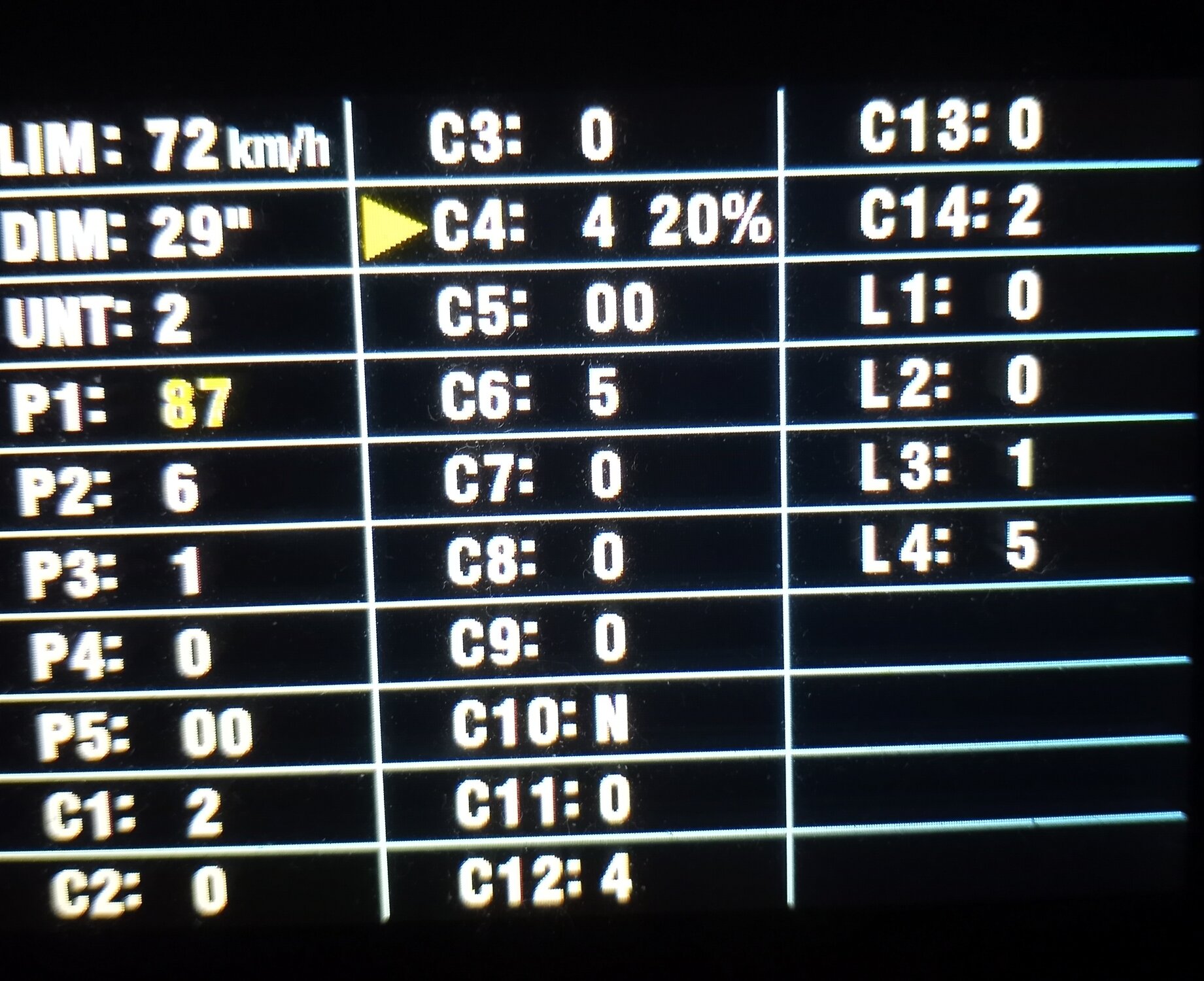

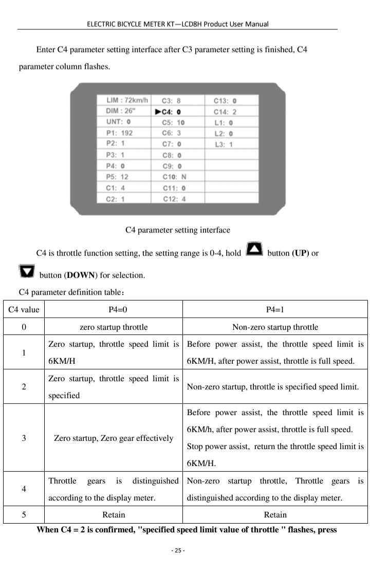

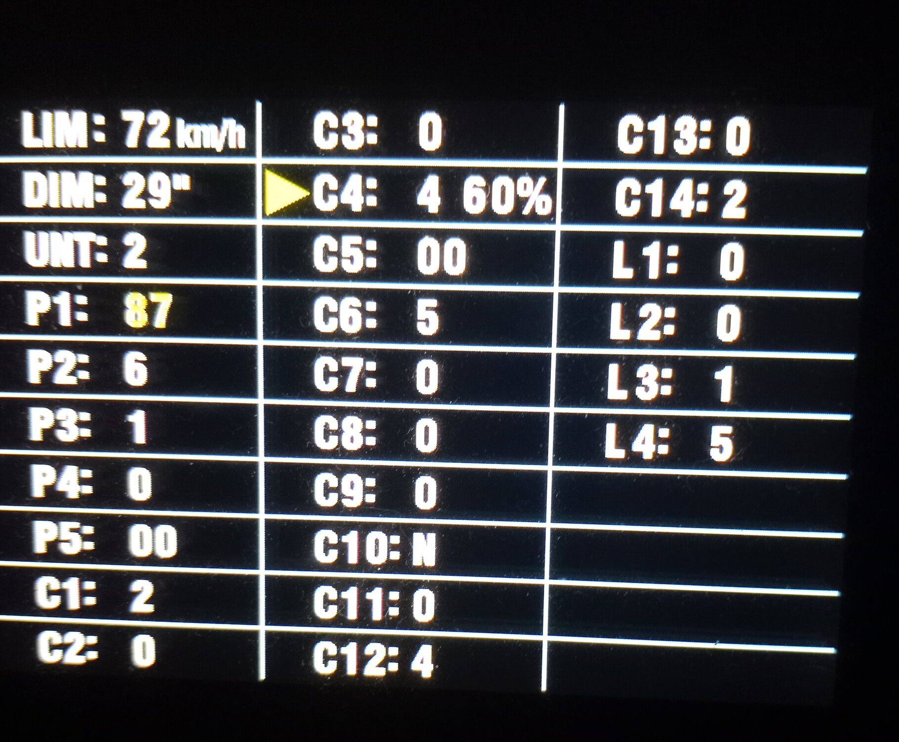

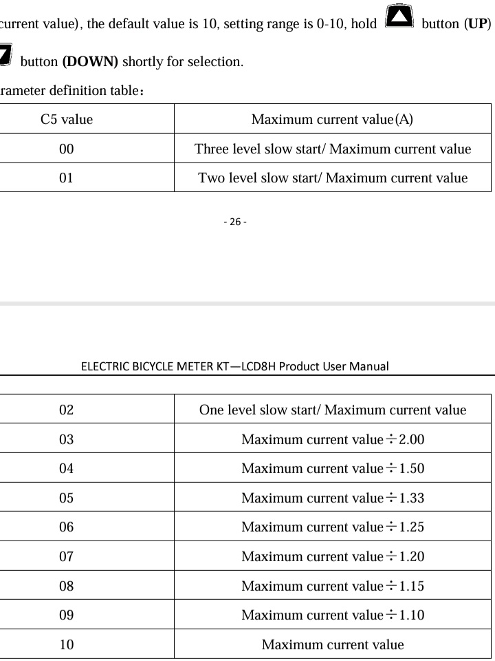

I like the color display. No issues seeing it and it looks better. Can you explain this C4 setting to me? I went riding in the mountains yesterday and having C5 at 10 was no good. The power was so much I couldn't not keep the front tire on the ground and therefore couldn't turn, (climbing hills of course). I turned C5 down to 2 for slow start, then maximum current and that helped. But having pedal assist being adjustable would help also.
