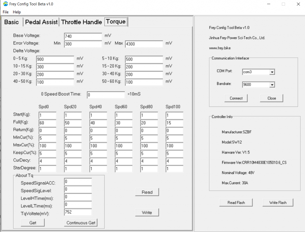

Hm, I just noticed that I never posted my most recent tuning, here!
Rather rude of me, since this was one of the first places I ever saw the "Smooth" config linked!
Starting from the "Smooth" tune, test riding it a bit, tweaking a few settings very slightly, & testing+tweaking+testing+tweaking & so on...
Here's what I've come up with so far!
(I think it's a significant improvement over the "Smooth" config, but I'd like to know what others think!?)
electricbikereview.com/forums/threads/bafang-ultra-alternative-settings-for-basic-pedal-assist-throttle-handle.37440/post-502980
Frood.el file attached below, for use with Frey \ Bafang Config Tool: (Feedback appreciated!)
EDIT: ​
This config is for a 45 MPH max speed limit. ​
(As set by my display.)
If your speed limit is not set to 45 MPH, the Torque settings will be applied at different speeds, accordingly.
Any difference in max speed limit or gear ratios, results in different optimal values on the Torque tab!
Best results will always come from calibrating your torque sensor's Base Voltage, & then test riding any changes on the Torque tab, specifically for your bike.
  • Frood_version_2022-01-18.0342pm.MST.el.zip

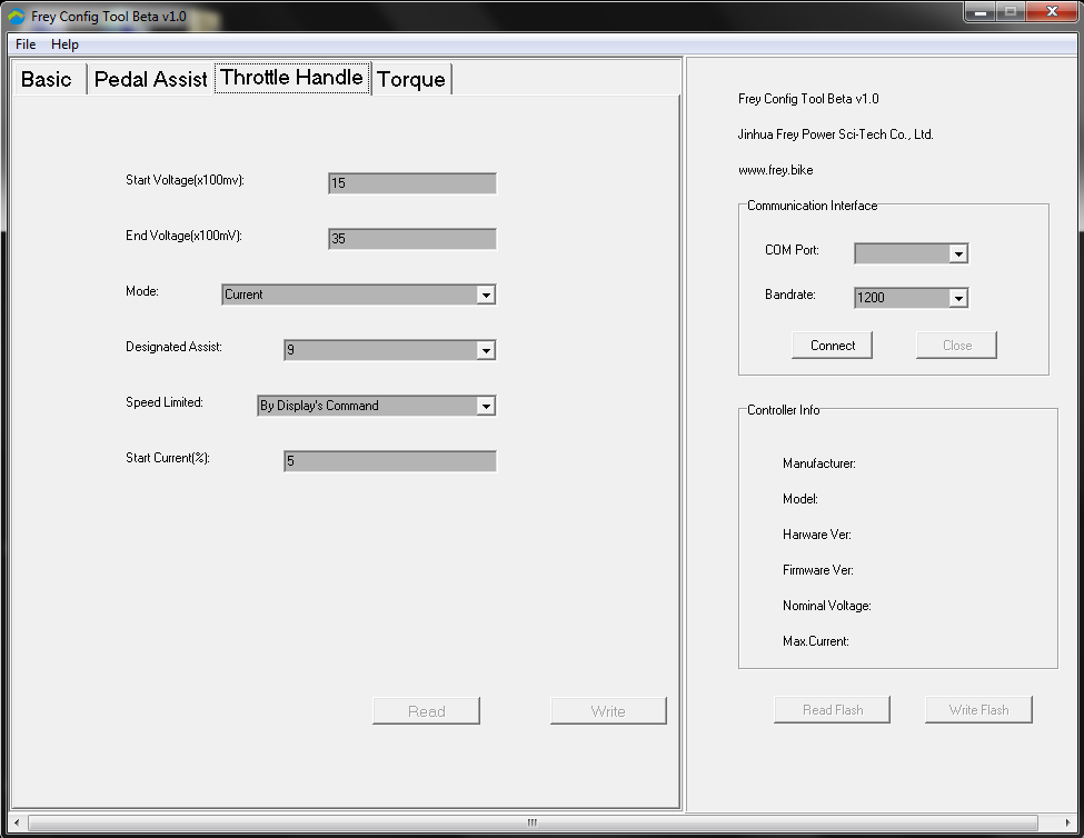

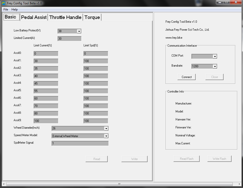

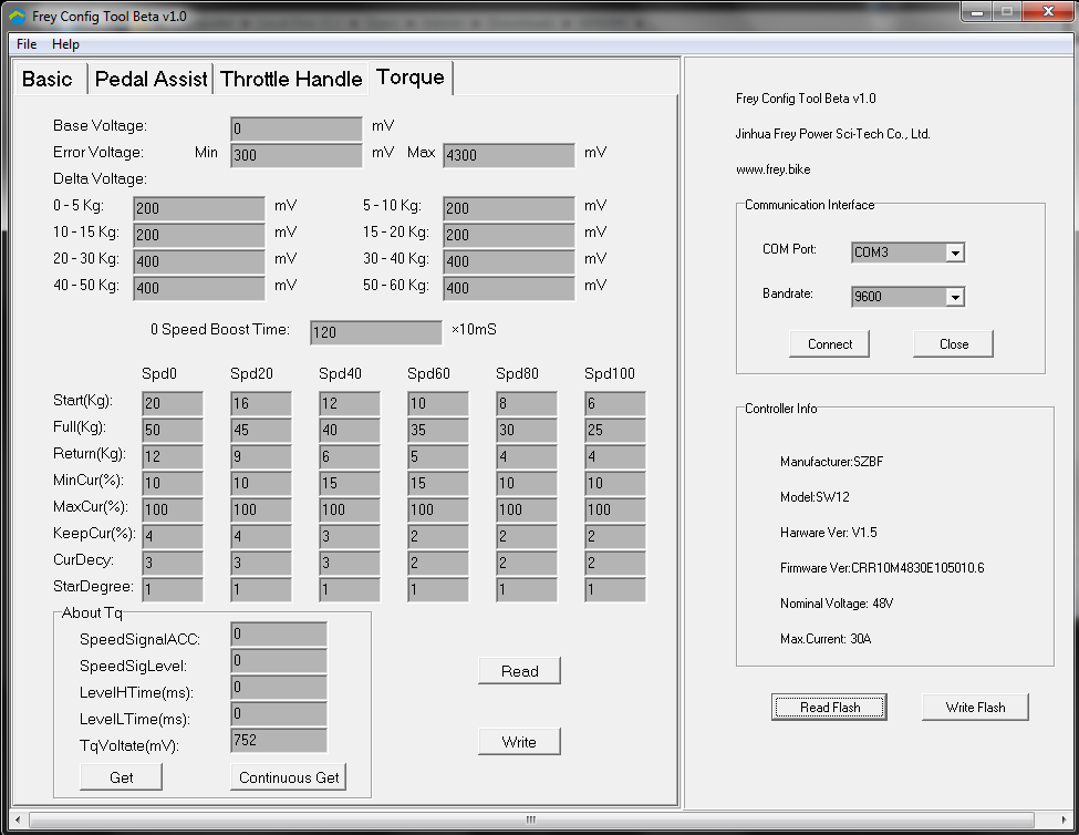

Original default "config", WITH NO TORQUE SENSOR CALIBRATION:
(Do NOT use this! Also, do NOT tune your Bafang Ultra with Base Voltage set to 0!)
^Note the Base Voltage is unconfigured, at 0 mV!
This will cause 0 Kg of pedal force to read as ~19 Kg!
Additionally, that's nearly 33% of sensor range, lost!
Correct mV values for Base Voltage are around 758 mV!

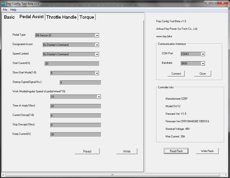

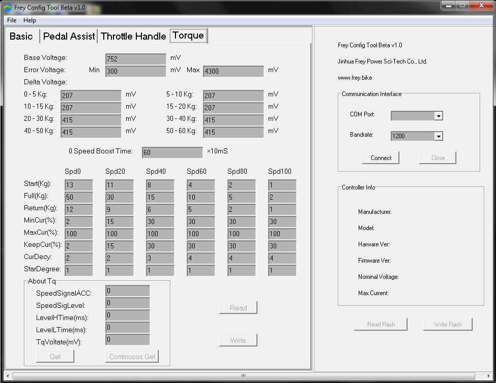

"Smooth" config, WITH BASE VOLTAGE SET, as posted at frey-bafang.patransformers.com by Michael:
^Note the Base Voltage in "Smooth" tune, is set to 740 mV.
Base Voltage should never be left at zero!

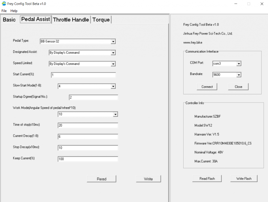

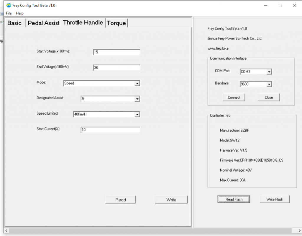

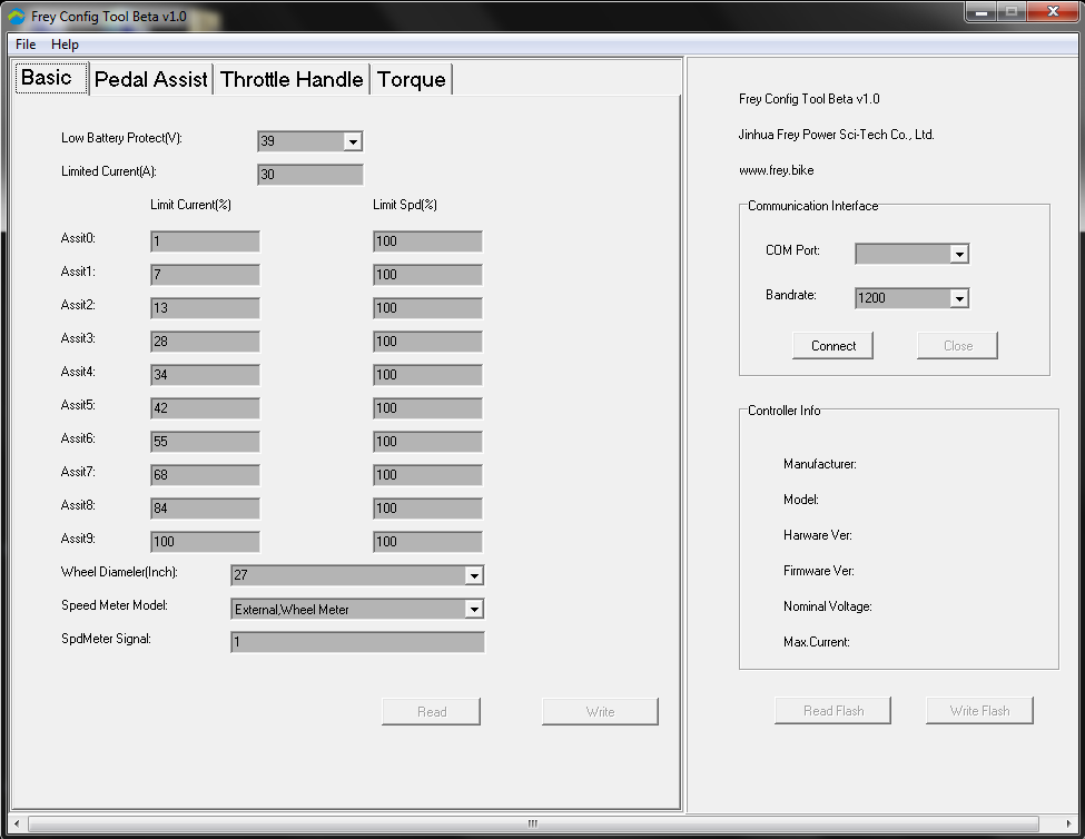

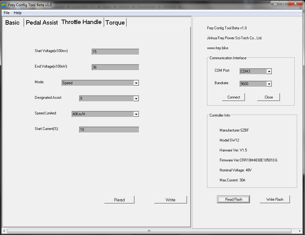

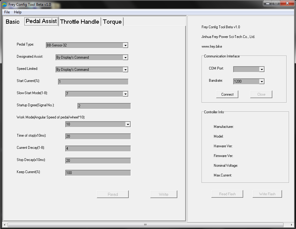

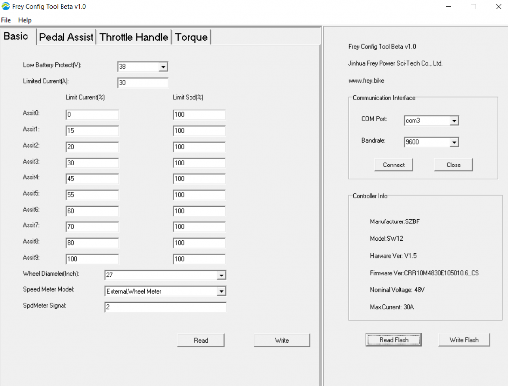

My current "Frood" config, as of 2022-01-18: (based upon observations from the Smooth config)
^Note that Base Voltage calibration has produced a slightly different baseline sensor value. Your "TqVoltate(mV)" may vary!
Also note that the Delta Voltage spans have been widened slightly, to make fuller use of the sensor's available reporting range.
Additional configuration notes:
1) On the Basic tab, I have set the LimitCurrent% for "Assit0" PAS level, to 1%, instead of 0%.
This allows use of throttle, with PAS 0 selected.
This also effectively gives the user six PAS levels in Eco mode, & six Sport modes, instead of five.
If less than 1% assist level is desired, the ebike can be ridden while powered off! (Works great, "infinite" range! ; )
2) Any torque settings affect all PAS levels proportionally.
A percentile value set on the Torque tab, will be a percentage of the percentage specified for that PAS level.
My "Frood" config, is optimized around PAS 3 Eco. (& no, PAS does not cut off at low pedal torque!?)
The "Smooth" config, is optimized around PAS 5 Sport.
Whichever PAS level you optimize for; each level away from that, is progressively farther offset from those "optimal" values.
3) Due to a bug in the motor-controller firmware's sanity checks performed before storing a new configuration,
KeepCur% (on the Torque tab) cannot be set higher than MinCur%.
This is in error.
Correct implementation of the sanity check would ensure that KeepCur% is higher than MinCur%.
(MinCur% is intended to be the floor value; KeepCur% is intended to be a value between MinCur% & MaxCur%. Unfortunately, the sanity check is reversed.)
This affects ALL Bafang Ultra motors with UART controller. (No word on whether it's resolved in the CANBus controllers.)
This bug cannot be corrected without a firmware update (from Bafang, ideally).
For comparison to a correct implementation, refer to the sanity check for StartCurrent% & KeepCurrent%, on the Pedal Assist tab: StartCurrent% is the floor, & KeepCurrent% must be a value between StartCurrent% & 100% of the LimitCurrent% value for each PAS mode between "Assit0" & "assit9".
Fortunately, this is a relatively minor bug, which hinders fine tuning but does not entirely cripple it.
If you place orders with Bafang often, please request a firmware patch to resolve this bug!
That's it!
This current Frood config is adjusted to be much gentler than the Smooth config, & in my testing, gets more mileage, more appropriate response to my pedal effort, & still goes like a beast in PAS 5 Sport. If anyone is willing to try it & give feedback, I'd really appreciate it!
