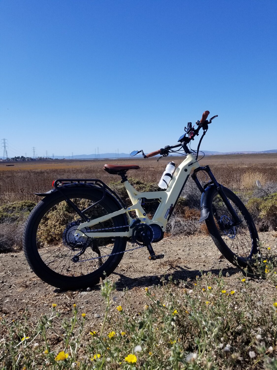

I tuned my Frey CC with the Ultra motor to the Smooth Tune and have never regretted it. When I first got the bike about a year ago, It was really to fast at the lower PAS settings. It was a real blowtorch. I'm 81 and it was a little too much to handle. I felt unsafe even though I am very used to flying aircraft upside down or hang gliding. The Smooth settings really make a positive difference for me. I understand everyone has a different requirement on what they believe their bike should feel like but this Smooth tune is something I am happy with. It very is controllable at low speeds now and I feel much safer. Last week, a 25 mile jaunt.
I have read conflicting info on that. Would love to know some genuine experience of doing so.
My bike has the original Uart Buss. My only problem in configuring the motor was finding the com ports. I ended up using com 3. Other than that it was a walk in the park to tune it.. Next want to try and change some of the Motor Settings using the Android Program Speeed. Some Guy (brilliant programmer) named Marcin Koppa made the program but I don't know if I will screw up the ULtra by changing some of my present settings. I do know his program works wonderfully on Bafang BBS01 to the BBSHD but it does not do torque serrings. Maybe this gentleman will make something for the Bafang Can buss at a later date, or at least make his present program work with the Ultra, Uart motor.
