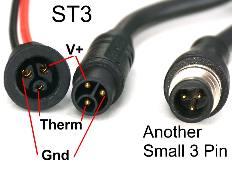

I cannot believe i cannot buy or properly fabricate a charger for my Aventon Aventure - It has been sitting for over a month now and I've ordered over 200 worth of various connectors (closest being the 100 charger with the ST3 connector from Grin, it did not work at all. I will pay top dollar but Aventon offers NO HELP AT ALL! If anyone out there has ANY suggestions for me - I will reward !

Are you saying the battery will charge if it is fitted with a female barrel fitting that doesn't have a sensing or handshake terminal? Were you able to make this work? Another member has stated that the battery won't charge without the handshake from the charger. See this thread Charging Connector for Aventure? It would be a great help if this works.

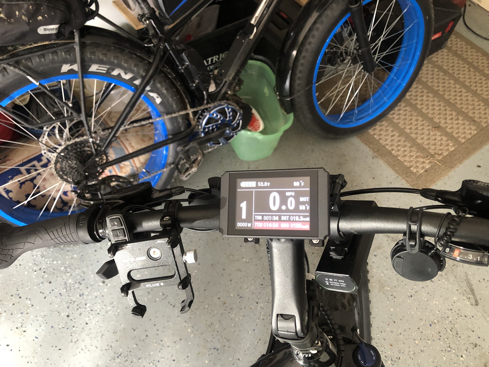

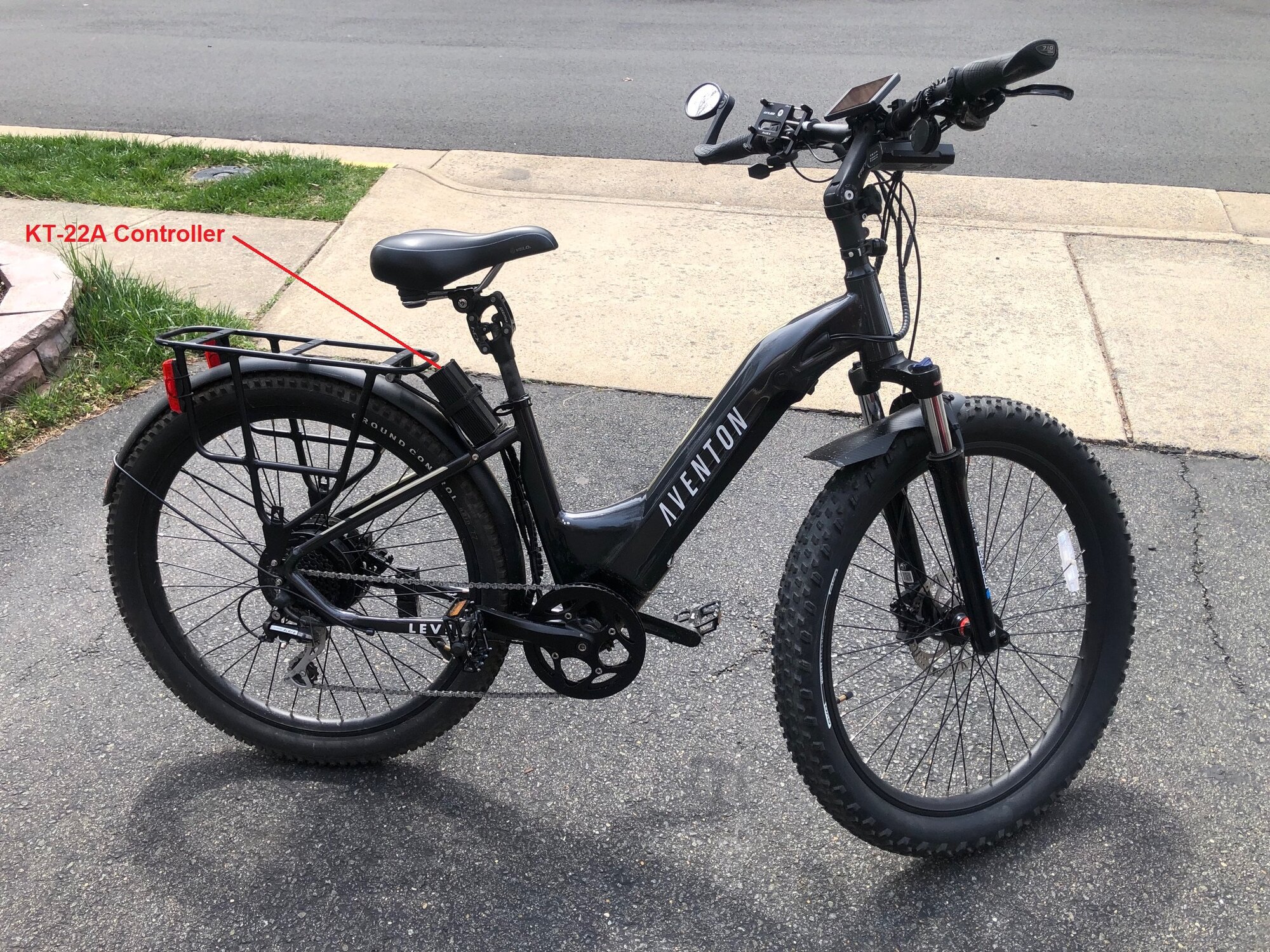

I installed an exterior mounted (on the rack rails beneath the seat) 22amp KT Controller and KT LCD8H Display on my wife's Aventon Level. Rides much smoother, quieter, more powerful, and has 3 profile settings for the PAS levels (gentle, med, sport), and throttle on startup which my two Levels did not have. Several more programmable parameters, and a plug for a rear light. KT also makes a 17amp controller that will fit inside the downtube. I am going to install a peak 55A Grin V4Baserunner programmable controller and Grin Torque Sensor on my other Aventon and see just how much that little Shengyi rear hub motor can take.
We do a lot of mixed paved trail and off-road (grass/dirt) riding so I changed out the tires. Installed 2.8" on the rear, 3.0" on the front, running at 20psi. The bikes run much smoother and can run the same trails as my fat bike.
With the new controller and tires, my wife's Level can keep up on the off-road with my 1400 Watt Fat bike and my buddy's Sondors Rockstar. It cannot climb the same hills from a stand still, but I am going to remedy that with an 11-42 rear cog set.

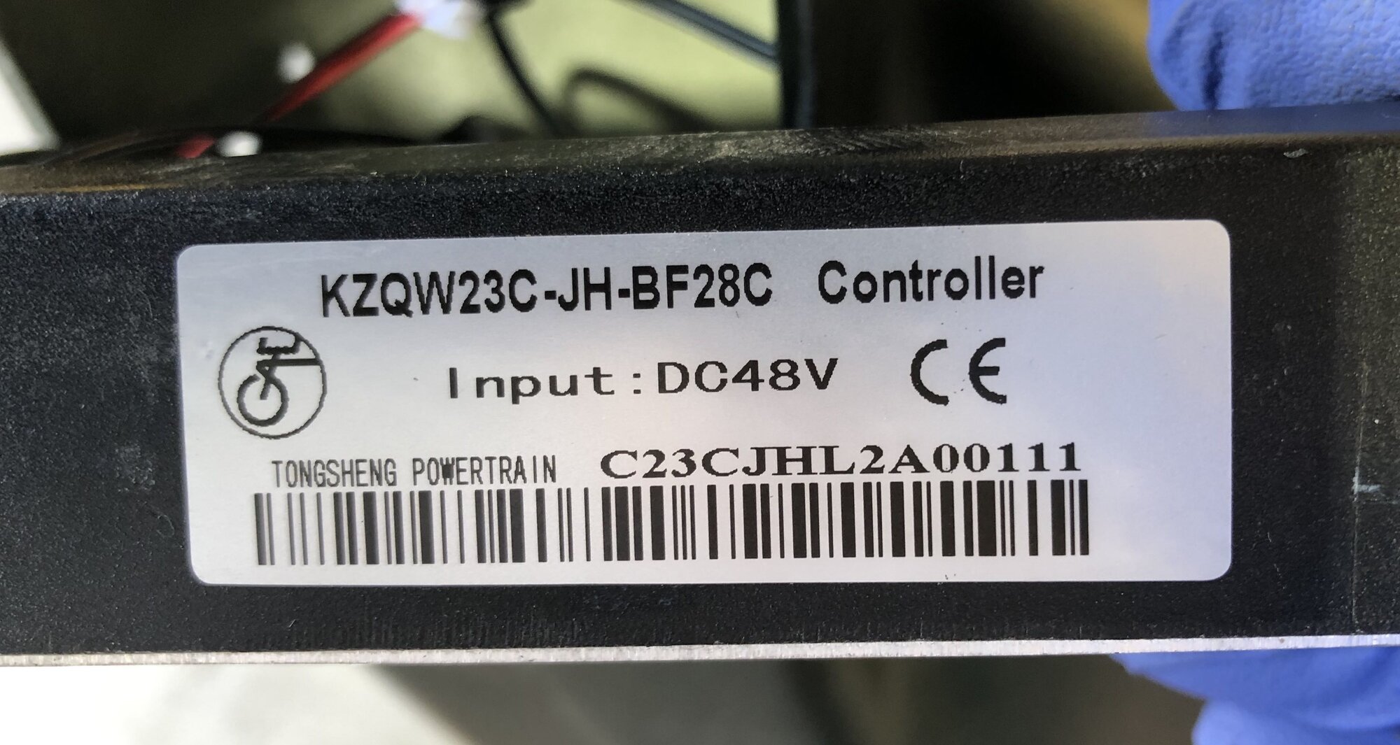

After extensive digging, I believe the Aventure controller is made by Aikema. Here is a link (https://www.aikema.com.cn/en/product/product-36-19.html) to what I believe is the equivalent Aventure controller. It is rated at 18A according to the website. For comparison, attached is a picture of the label on my Aventure controller. All of this to say that I think a KT 17A would work (small enough to fit inside the frame) but it is missing connections for the front and rear lights. I found a KT 22A Waterproof that might fit inside the frame, but there are no screw attachments to keep it in place, and it has just one light connector that would have to be adapted. It would be a very tight squeeze. The brake cables interfere to some extent and can't be moved. Existing controller dimensions are 100x64x32mm. I found one on Amazon Australia with the exact connectors needed, but it is too big to fit inside the frame. I might consider another controller, if it has good performance, the proper connectors, and fits inside the frame.
